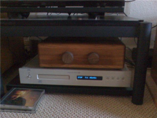

So tonight I tidied up my wiring and swapped out that 220K for 2x 270k in series = 540k. So, most of the sibilance is gone, I've spent the last few hours listening to all my usual tracks and while theres a hint of it there, its much reduced. I found some dale 221R in the box tonight so I might sub those in for the xicon and see what the difference might be.
Theres incredible depth to this preamp. I'm getting some of the best sounds ever from my system with this right now. I think that if I can make it just a shade smoother....
Bear in mind i'm using fostex speakers in a horn so they will be absolutely merciless when it comes to sibilance or harshness. If you have a fabric dome tweeter or similar, you most likely won't ever notice anything.
Its quite a preamp - really something else. Just to underline my comments, its obvious that the bit of sibilance is a characteristic of my build rather than the DCB1 per se.

Thanks for reporting your steps. This is very useful to the ones who gonna build. In a system concept much can interact, tone up, or mute enough. Especially on speakers with some break up modes around 5-10kHz, you must be careful with all those details we discussed. The DCB1 has been through proto testing so to know from enough people if there is some characteristic issue or not. That gives us the information to know what too look for or not in the first place. Since you are at a good point, even when you are accustomed in using a Lightspeed in a regular B1, not applied in your DCB1 yet, that is a good sign. Even if you did not like it at all, no worries. No egos here. Just DIY.🙂
