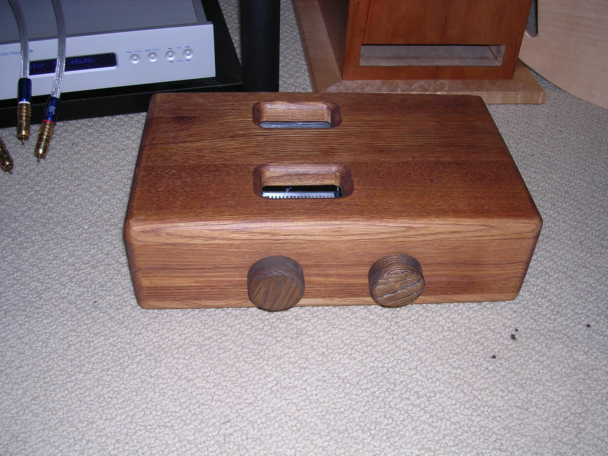

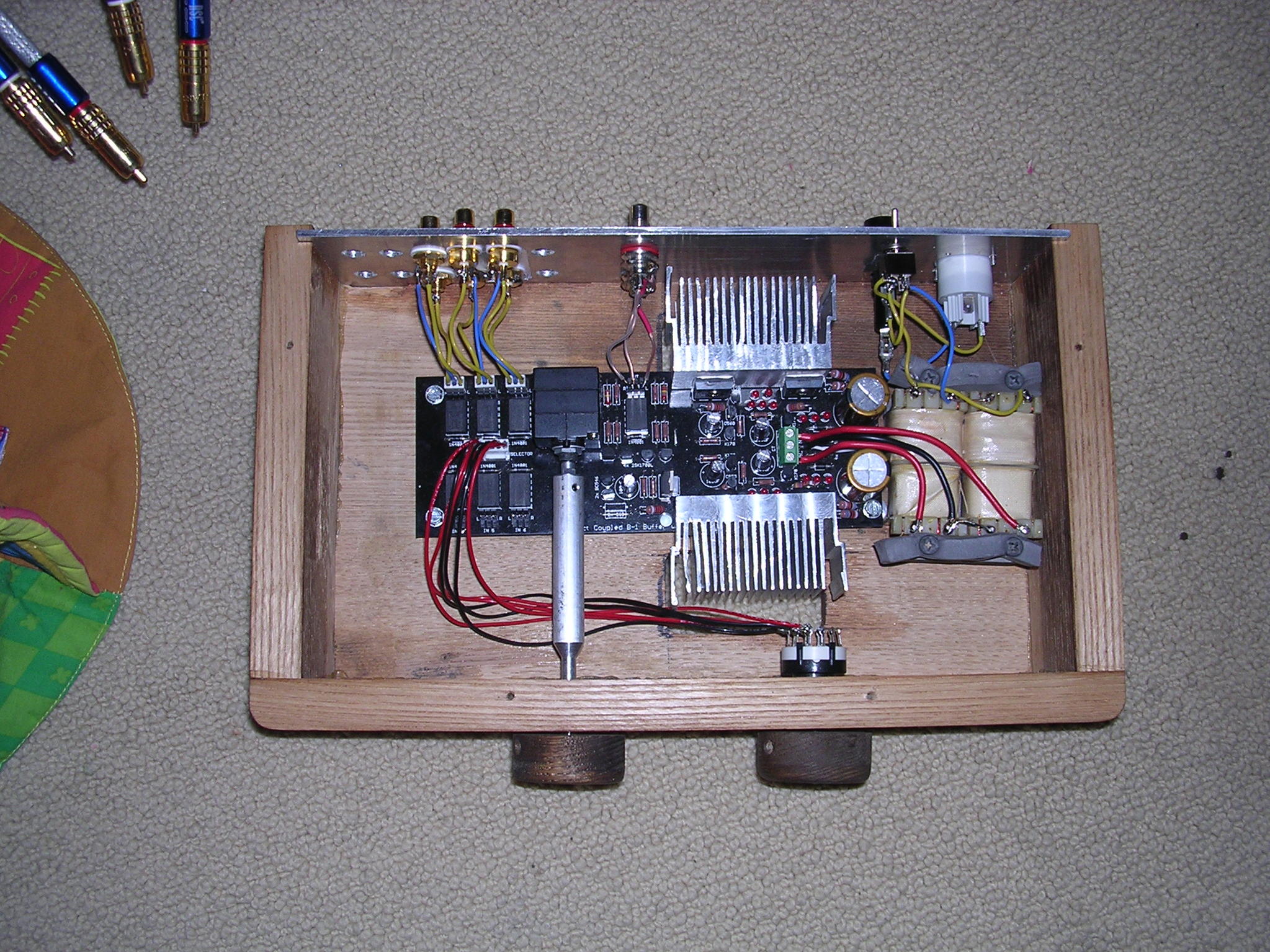

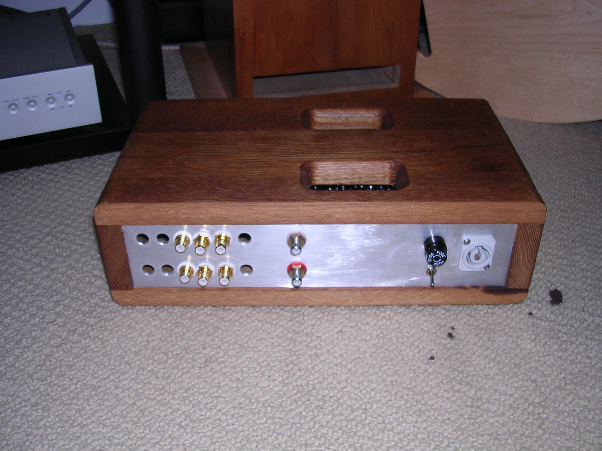

Just an update on my proto board build. I ran into some issues with the pot I was using. It appears to cut in and out on one channel and I just decided to replace it with one of the ebay stepped attenuator. I do have the case done. I am missing 3 sets of RCA connectors, but that doesn't stop functionality. I don't really need 3 inputs anyway. So, for now here is my build.😎

Very nice - beautiful construction . I would have moved the board nearer to back plate to keep the inputs very short. How do you find the sound ? And What size Pot 10K/20K?

First one in a custom case! The dice starts rolling, and its a wooden one. Nice work. All best.

That looks great! Very nice indeed, yep I love it. It will run cool in a hot desert with those heatsinks and air holes top and bottom. Well done, thanks for the pics.
With so many boards you given out there, expect from cigar box, to bronze and gold accent box builds.

10-20k will work fine. The sound is very nice, very good in fact. My lightspeed is the best preamp I had heard. Adding this to it took a way a little and gave a little. I hear them as the same quality now with one being better for some music than the other. Soundstage gets W I D E with the DCB1. Clarity is improved over even the Lightspeed. Voices got 2D instead of 3D while depth of the perceived venue increased. Weird but thats the way I hear it. But depth of the venue got really really deep. One recording I felt like I was back 30 rows and then remembered this recording was made from the soundman's seat and it probably WAS 30 rows back. Incredible.
