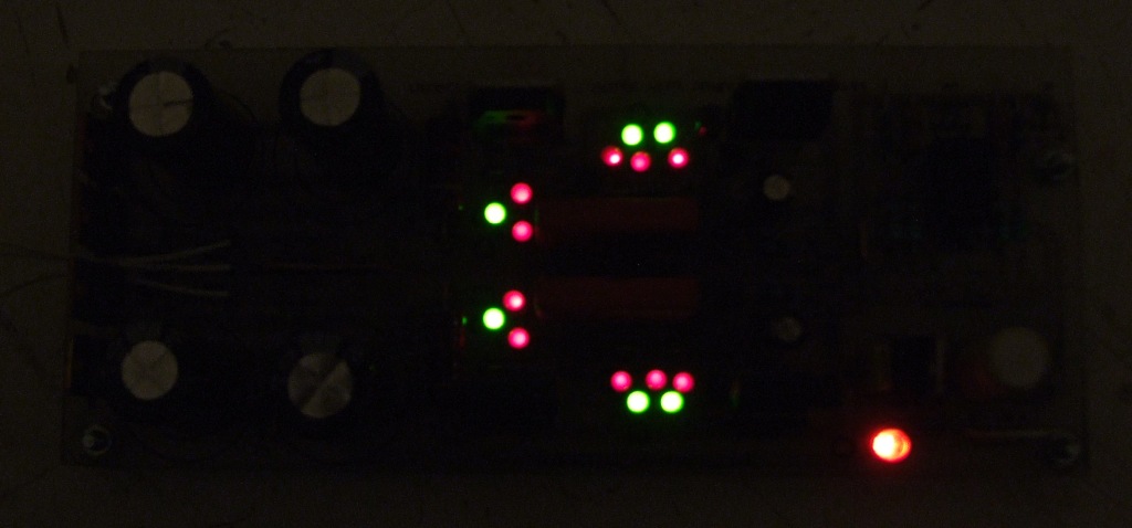

I've been using the high "unmatched" Idss 2SK170BLs for the current sources for the LEDs. Most of them are running between 8 and 10mA.
I was a bit surprised at the final voltages.
I suppose I was looking for exactly 10V as the schematic stated, However they are stable and matched at +/- 9.5V.

I've just fitted the important Buffer FETs.
Not too bad a result - measurement wise. ~3mV on one channel and <0.5mV on the other. That was with FETs matched to within 0.01mA of each other.

The jfets working under Vbe only which form the string of five constant current drains lost 25-30% IDSS VS battery test. Hence the leds lost a bit of Vf each is the voltages explanation. Very good voltages as for DCB1, no further tweaks are needed.
If you will mutually swap the 3mV pair jfets there can be a different result for better or worse. But 3mV is mighty fine. You gonna put an all DC scenarios safety capacitor in the output as you said, so any DC becomes a non issue anyway. Happy listening.

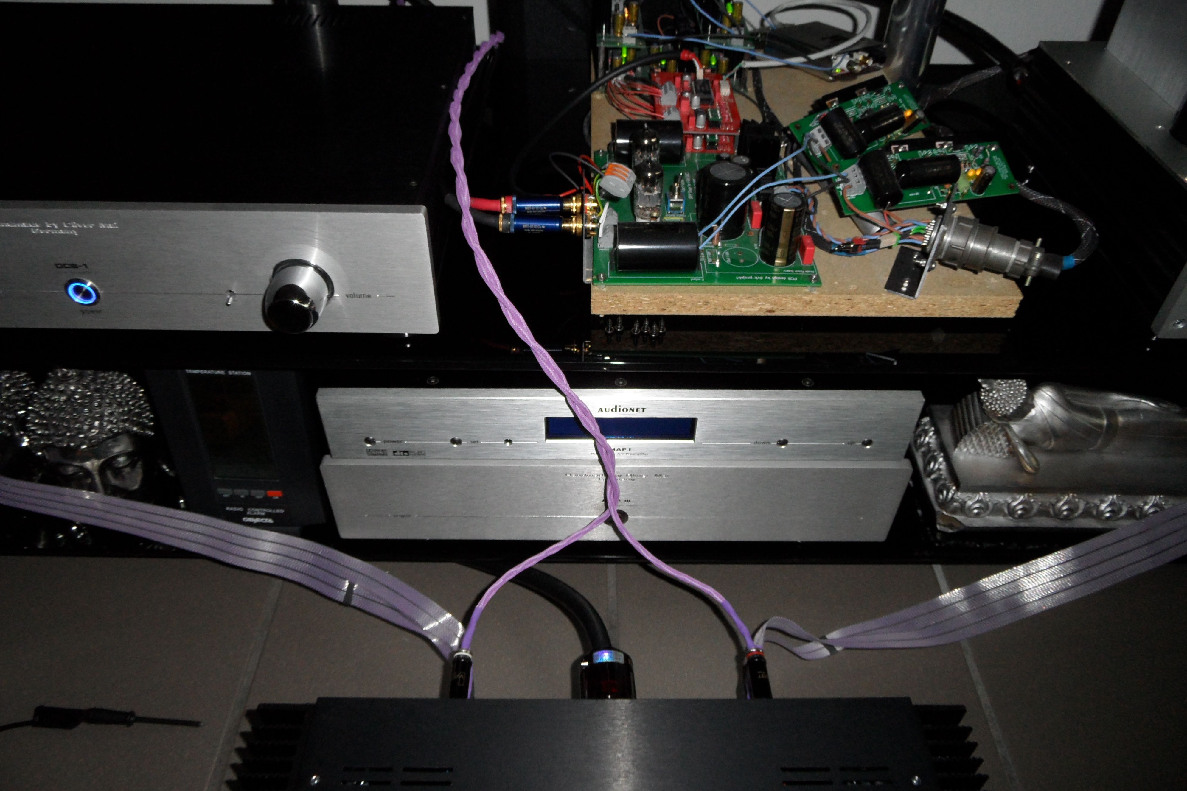

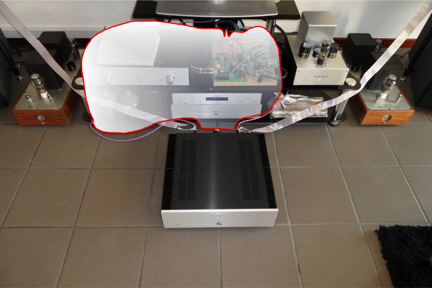

Thanks for your suggestion, but the problem is also with other interconnects, see Post #2458 . A bit better but not silent...🙁
Still, have a look at what I try to say:
[I had this similar problem too when I went from 330B mono's to Le Monstre]
It is these two sides of the loop (L/R) that have to be twisted or taped together.
The output impedance of the B1 is not low enough to kill the inductance . . . completely. (A Kondo stage would do slightly better probably)

Hi Albert,
i tried that. A bit better like the Nordost cables i had tried, but the hum is still there...😕
