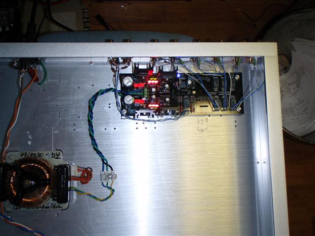

I ended up running 116mA and 122mA, with 3x51ohm resistors. Last time I measured the heatsinks, after running them in the completely sealed case, they were 65-68 degrees. In open air they run at around 45 degrees I believe. They're surprisingly effective. After punching a few small holes in the case, for some basic air circulation, I'm guessing they're somewhere around 50, maybe even lower. Completely sealed cases aren't good for you 🙂
I wish I'd go over 250mA, but I'll leave that for the second board and some proper heatsinking. Not to mention this trafo wouldn't cope with that anyway.

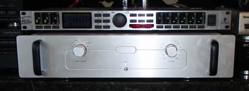

Mine is installed, works well...
(in a fleabay chassi)
Arne K
