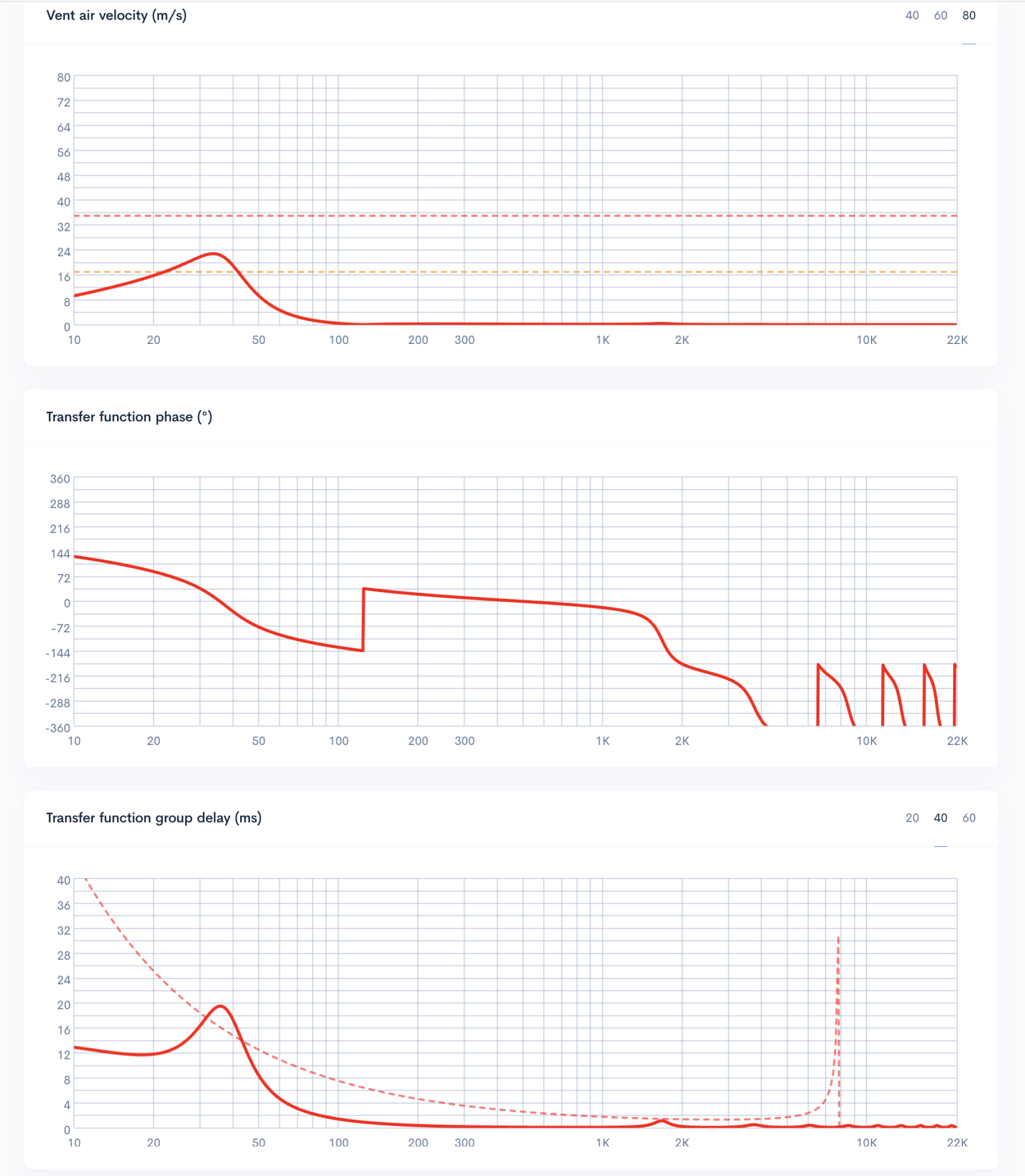

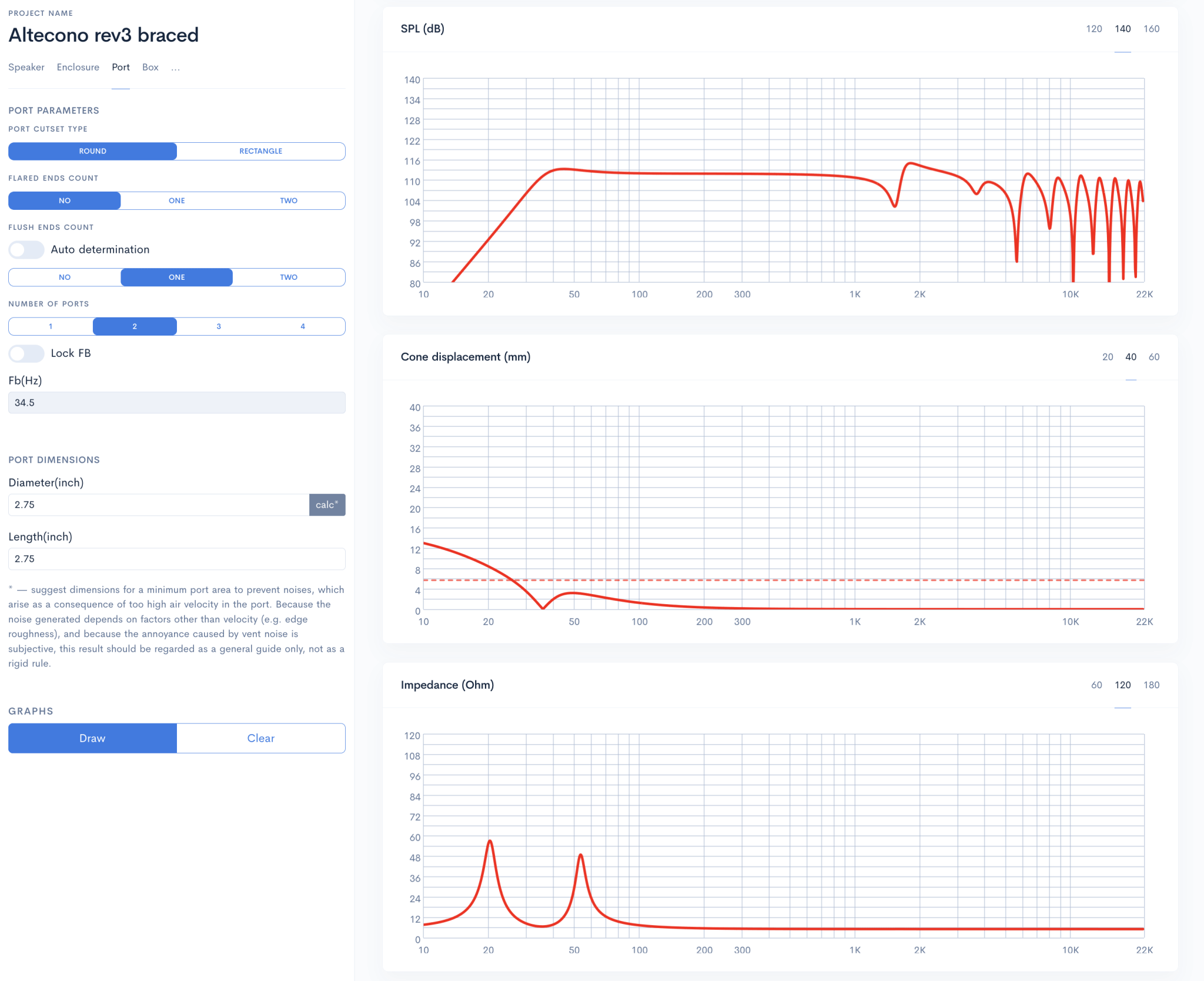

A general project update (for my own edification, if anything):
I've taken some new measurements and calculated the predicted bracing I'll be adding – net volume will be 5.78cf / 164L.
Got some misc. shop tools I needed to cut the baffle.
Plan on using 2 circular ports 2.75" ports for now – seems like the most flexible system for tuning adjustments.
Presumably I need to add some protection to the CD. I haven't been able to find a clear answer on whether or not the minidsp provides sufficient protection on its own.
Also, these speakers are big – currently scratching my head on how to get good measurements. Using the typical farfield formula has these things 16.5ft off the ground, which seems totally untenable.
Attaching some graphs here of the 15PR400.
be gentle with me – i'm still learning to read these!
(n.b. i'm using Speakerbox Lite – will probably switch to VituixCAD once I have a Windows virtual machine sorted.. Apple Silicon is a pita..)
