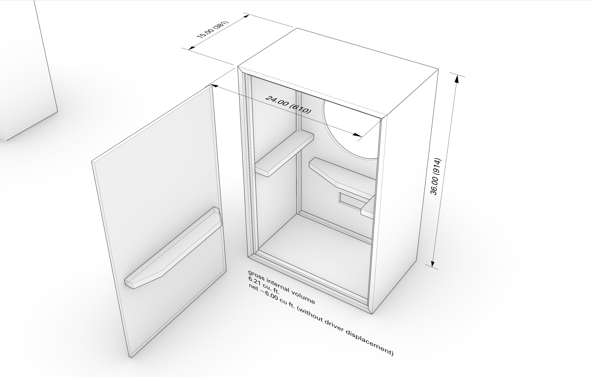

Building a speaker around a 6cu ft enclosure

Unrelated, I got good price on a pair of Faital 15PR400. I'm going to try and model some enclosure and tuning options around that. Two approaches, the raw cabinet with its existing minimal bracing – sort of a "control" – at 6.21cf, and then the two chamber approach.

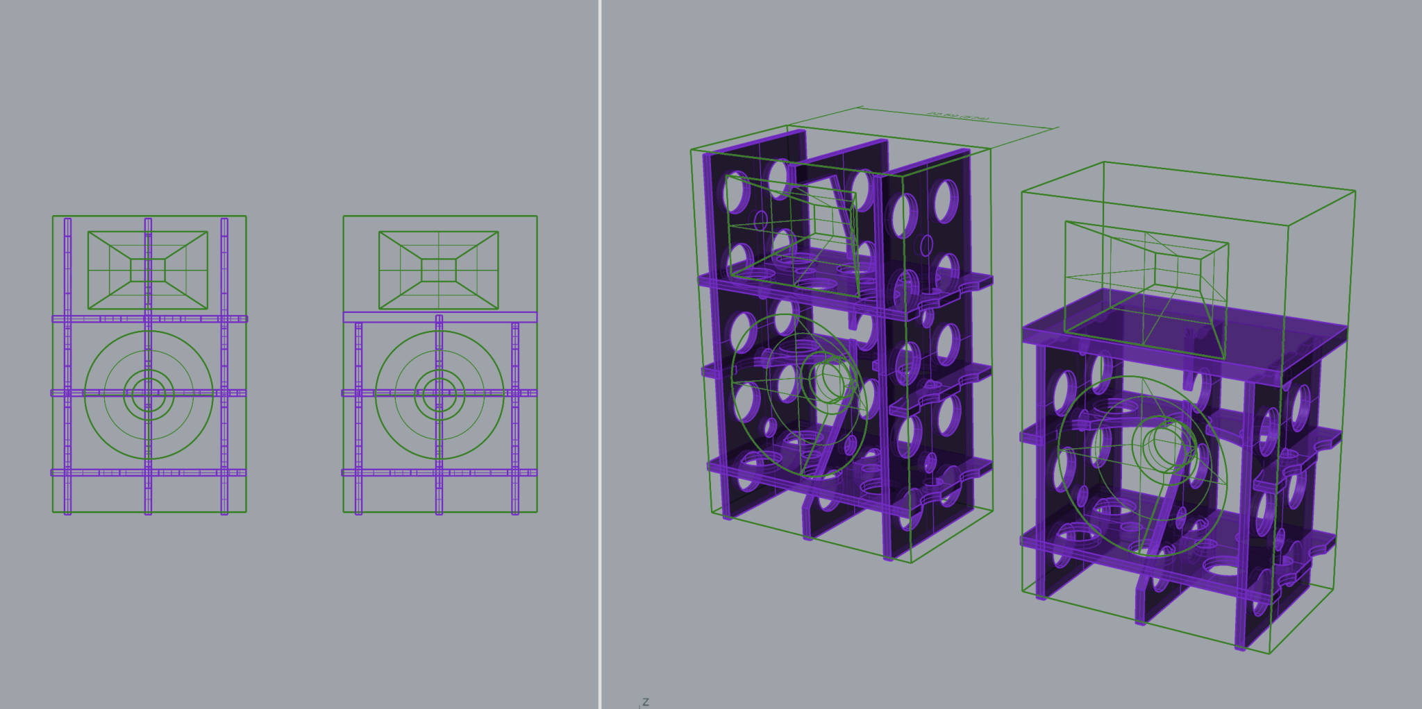

I've taken some new measurements and calculated the predicted bracing I'll be adding – net volume will be 5.78cf / 164L.
Got some misc. shop tools I needed to cut the baffle.
Plan on using 2 circular ports 2.75" ports for now – seems like the most flexible system for tuning adjustments.
