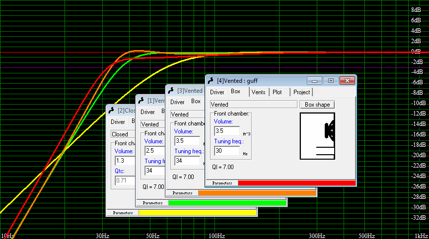

I understand Hoffman's Iron Law stating that if I want low and loud, I need large. But lets say I have certain 12" driver that works well in a 2.5 cu. ft. cab with a port tuned to 34Hz. Lets say I use 3.5 cu ft. cab with same tuning. Of course, the port length will be shorter, but do I gain SPL?
Not necessarily. But if you use a driver that is optimum in 3.5 cf with a port tuning of 34, it will be a higher sensitivity driver.
Exactly.
@ johnr66: Once the driver is in an enclosure, it no longer means a lot of sense to speak of the driver alone, since it is now a "system", entangled with the enclosure volume/tuning. In physics this is known as a coupled double-mass/double spring damped oscillator. Although, one way you can enlarge the enclosure and gain total SPL is by using a tapped horn. Here you can scale the whole design up and gain wide bandwidth SPL.

You'll gain SPL by having a higher Q bass alignment making the transient
response worse. For a 2.5cuft/34Hz alignment that does work well you
generally need a lower port tuning for the bigger cabinet to avoid boom.
Generally if the box is bigger than a good volume you either get a
bass peak, or to avoid a peak you get a tapered / drooping roll-off.
You don't gain a lot with the extra volume over a good volume.
In the example below optimum volume is less than 2.5cuft as
you are dealing with portable equipment, 2 cuft tuned to 33Hz
looks good for a low B 5 string bass, and a 4 cuft / 33Hz 2x12
is always going to better than the same 1x12 in 3.5 cuft.
rgds, sreten.
Attachment is Fs - 25Hz, Vas - 6cuft, Qts - 0.3.
As well as what sreten has written, it also depends on if with the smaller box you are thermally limited but not mechanically limited. If you are thermally limited and therefore have spare mechanical capacity then the bigger box will enable you to use that capacity by not running into the thermal limit as soon.
The theroetical power performance ideal is an intersection of power and thermal limits, in practice this may not be the best sound however.
