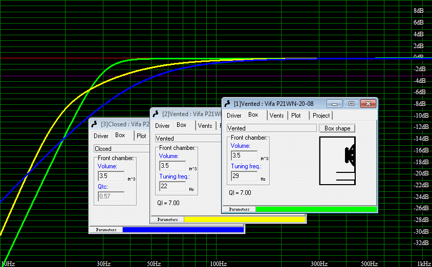

60-80hz punch region, myth or fact ?
might just be a huge mistake or misunderstanding to think 60-80hz is all you need, if punch is all you want
does not automaticly imply you can just ignore whats below, and get away with it
I bet it goes wack, and you loose it all, that way
but it means that you might get away nicely with a closed design, and have the tight bass you want 🙄

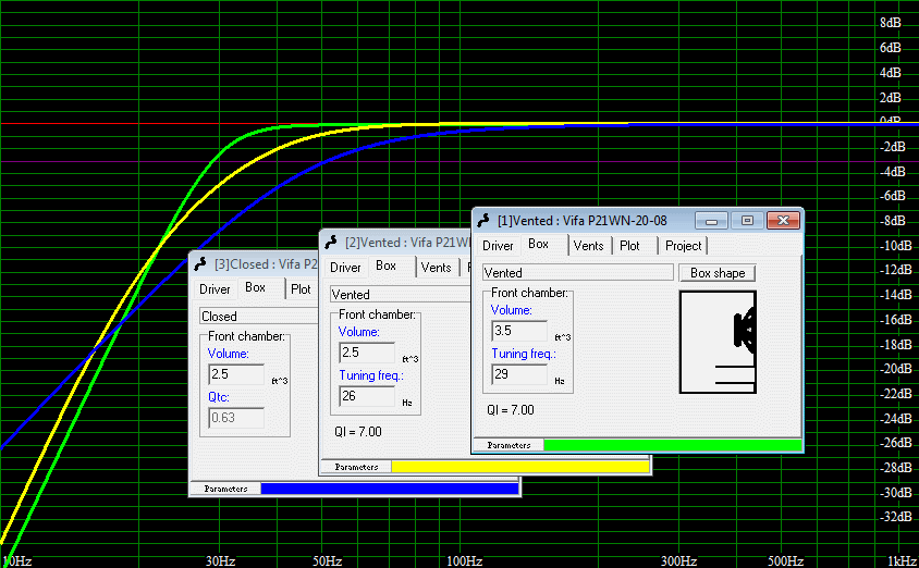

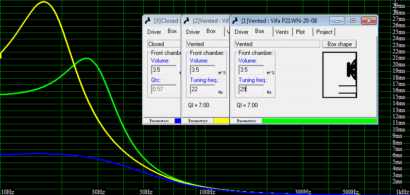

tight sound comes mostly from the frequency response. for this really dry sound you want a woofer that does not play much lower than 50hz and has a slightly rising response, so it is louder at 150hz than at 50hz. also, it may not have huge irregularities like bumps in its response. this is easily done with closed boxes since thats about their natural response. with reflex, you need to be attentive that the low end isnt bumped up, making the sound boomy.
you might also try to experiment with proper bass traps and/or nearfield placement of the speakers for the better direct/ambient soundfield ratio.
How big of a bump do you consider boomy, MaVo? Would a 2 dB bump make it boomy?
