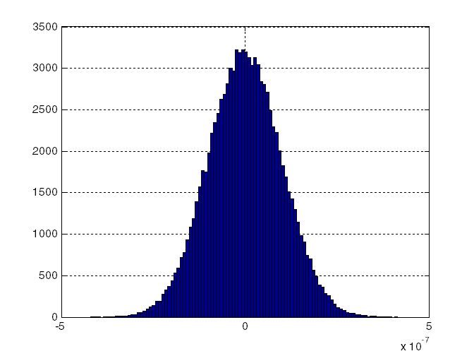

If you think that you can not hear a difference with 10ns of sample jitter, i add a file with 100ns of jitter here.
This is about 100000 more than a crystal oscillator.
The picture shows the histogram of the sampling jitter.
With this example you can hear that the sampling time jitter sounds like random noise, no spectacular modulation effects are happening.

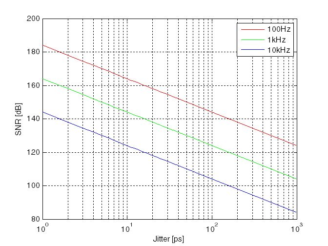

By the way, the math for what jitter translates to in terms of noise floor vs. frequency is:
SNR = 20 log(1/(2*PI*freq*jitter)
where freq is in Hz and jitter is in Seconds. So to get an SNR of 110dB at 15kHz, you need a clock source with jitter less than about 25 ps. THIS is why jitter matters...

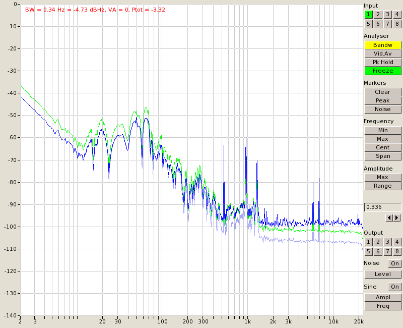

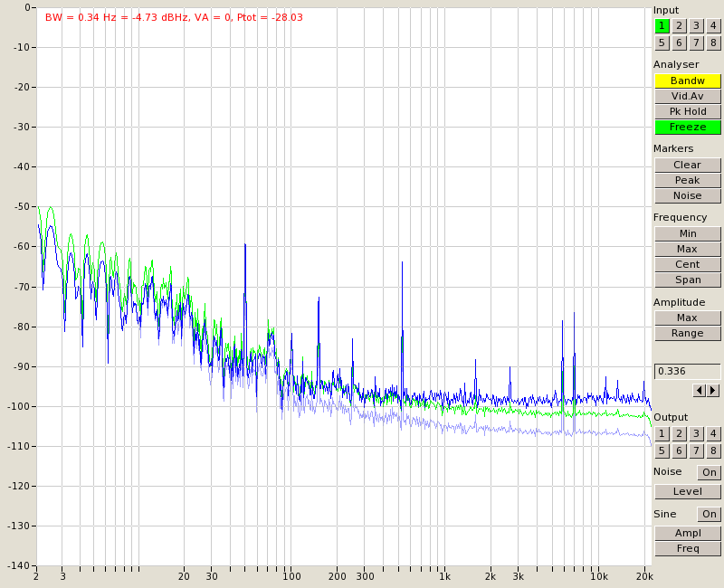

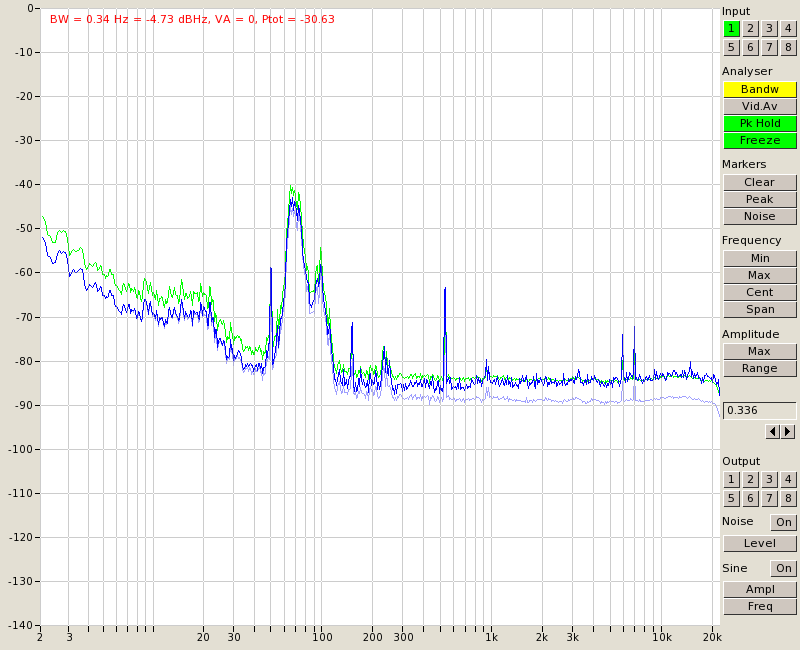

Today I made some phase noise measurements with 2 oscillators and a pll while listening to music, without music and last one dropping the mouse (the computer one!) from 5 cm height.
Vibrations are clearly visible as added phase noise.
To have the phase noise in dBc one should remove 60dB from the yellow curve.
Nothing have been made against vibration, oscillators just sits on the table.
Joël

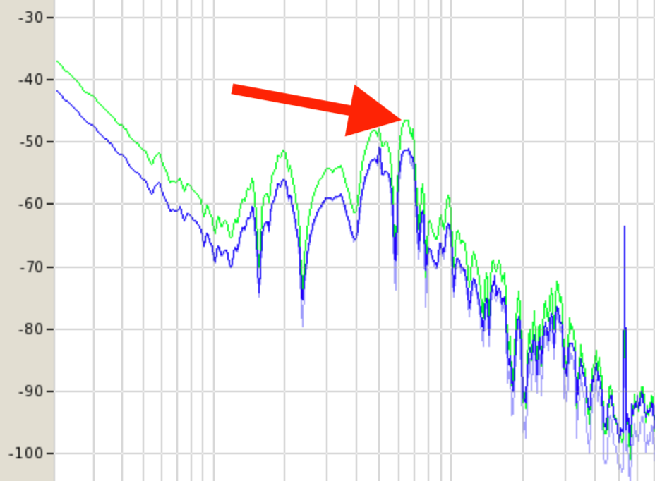

You tell me 🙂 I see a Green, blue and grey(-blue...ish).
Do you play spinning discs och ripped files?
I sometimes has a bit a of a green/red problem 🙂
Green? -> (the arrow is red!)
Thank you, now I can name the colours! I already knew the sky is yellow and the sun is blue. Or something like that, not really sure, maybe it depends on days...?
So green curve is noise within 1 Hz bandwidth, dB/sqr(Hz), blue is RMS voltage in dB and grey-blueish is average when display resolution is lower than frequency resolution.
Joël

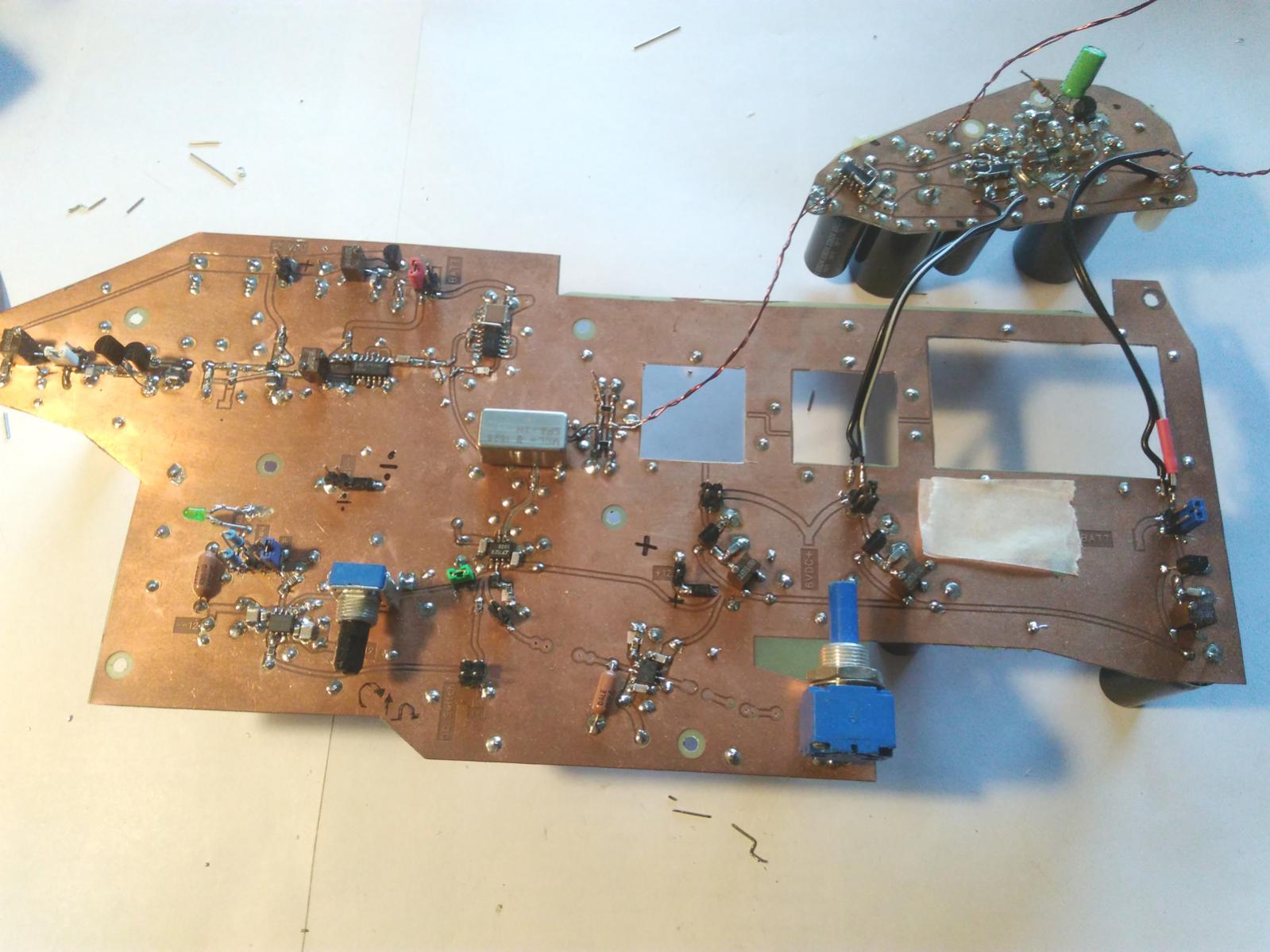

Hmmm ... I realize that Joël is underways with sharing/explaining his system setup (and I am personally interested in what he can say here), however, I would like to add that I have built Herbert Rutger's DC-Receiver with some additional features that I reckon could be interesting in the context of a flexible phase noise measurement system.
My aim with these additions to Herbert's design has been to be able to evaluate most all of the individual circuit parts of an oscillator so as to test and optimize each individual part. FYI I have attached a picture of the DC-Receiver PCB.
As it is I have not yet had the chance to really try out the DC-Receiver (I a.o.t. need a good-enough ADC to input the DC-Receiver's output to my PC) - yet it is my impression that the PCB is correct. It is rather big, though - so as to provide some spacing between the various circuit sections, and also because it fits into a steel enclosure I already have of this size.
That said the ideas with this PCB have been:
- The cut-outs in the PCB are for mounting an oscillator PCB, a squarer PCB, and a divider PCB (right to left - top right corner). Traces are kept so as to be 50 ohm impedances. On the picture is shown one of Andrea's Driscoll oscillators - which I had already and have used to do preliminary tests of the DC-Receiver.
- To supply the DC-Receiver & DUT oscillators/dividers from batteries. Additionally, to also allow for supply voltage adjustment - as a part of assessing phase noise/jitter relative to supply voltages - there are four very simple, low-noise & adjustable PSUs on the PCB. Basically emitter followers with decoupling and an MPSA18. It is possible to switch between pure battery supply (individually for each circuit part) and these adjustable PSUs. Nothing fancy but low noise, no ringing, and reasonably low output impedance PSUs.
- Close to the right side of the ring mixer (metal part in the center) there are two 50 ohm attenuator resistor networks so that precise adjustment of the DUT oscillator output level is possible. I chose to not place a "jumper-connector" (don't know what the English word is) at this place so here a small piece of wire has to be soldered to connect with the attenuator network used.
- Herbert's "listening circuitry" is also on the PCB (bottom right corner with the potmeter).
- Courtesy a suggestion by 1audio the PLL input to the VCO (Herbert's Clapp oscillator - to have a known reference) can also be switched to a fixed voltage set by a filtered trimpot so that any very low frequency influences from the PLL may be avoided.
- There may also be included a divider circuitry in series with the reference oscillator (/2, /4 - above the ring mixer) so as to test frequencies e.g. where two identical crystals are not available.
Well, this is FYI and possibly for inspiration ... Also, should any of you like a copy of the PCB layout you are welcome (e.g. pdfs of top & bottom).

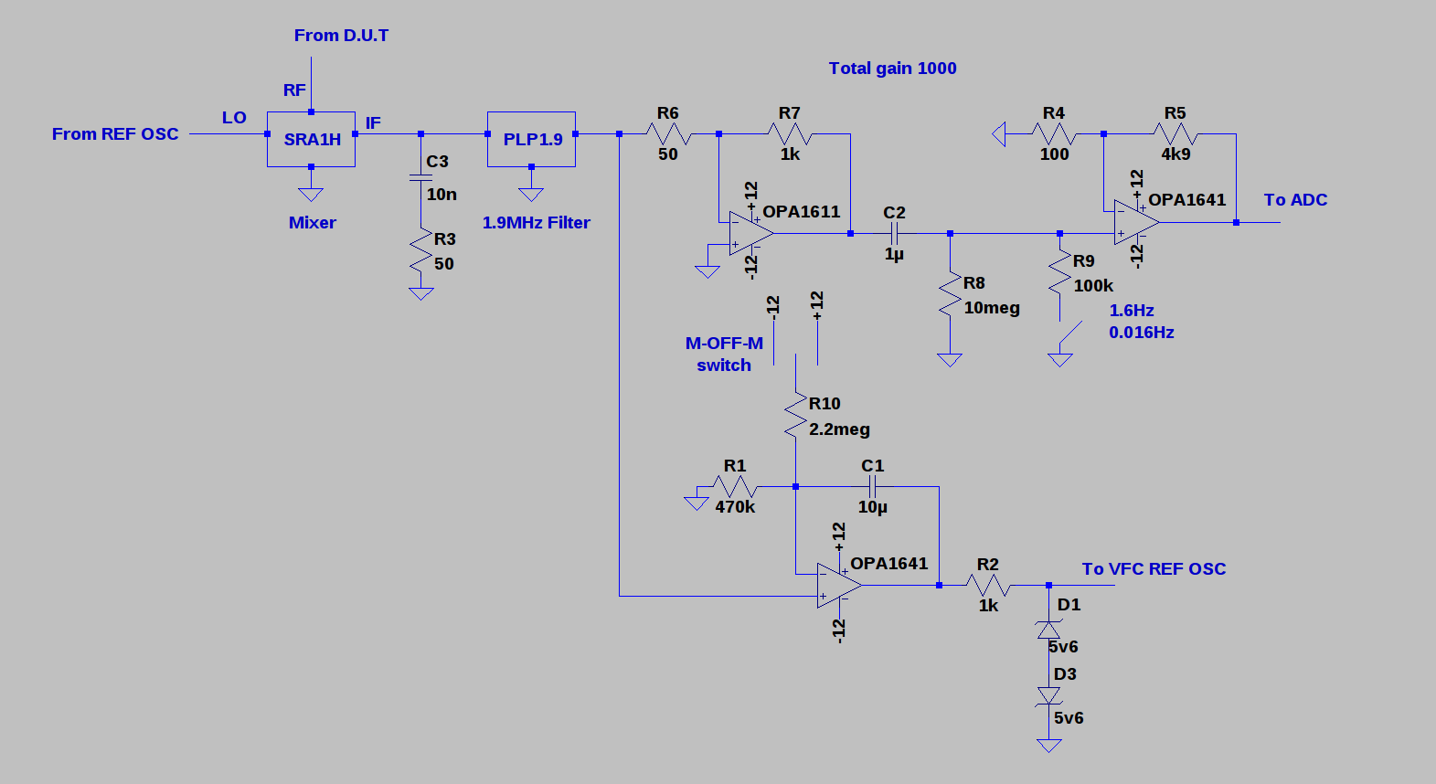

here is the schematic of a phase noise meter.
Actually I use a different and much more complex low noise 60dB amplifier with FET input for high input impedance but finally high input impedance is not necessary.
50Ω loading at DC just change the change the phase to voltage conversion form 0.6 volt/radian to 0.3 volt/radian.
Mixer is SRA-1H form minicircuits, 1.9MHz filter is from minicircuits too.
OPA 1611 is low noise bipolar opamp, OPA 1641 is low noise JFET.
The M-off-M switch is useful to set the integrator output to manually help the PLL locking.
Attached is the Wenzel paper "Low cost phase noise measurement" valuable source of inspiration.
Actually I use a DIY DC coupled ADC. Output is optical SPDIF for full galvanic isolation. Schematic is attached.
Joël
