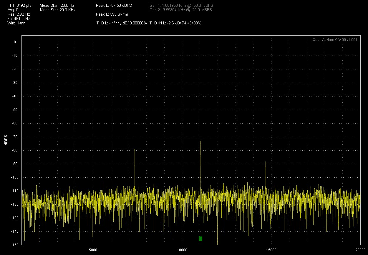

I tried that a few years ago, but didn't find it to conclusive, so I give up on it.
Lots of artifacts and noises. In the measurement loop also the FM front end local oscillator, which reduces the accuracy. Maybe I could try it with a player with a 11MHz (or a 10.7MHz one) clock and go in directly to the IF amp, or since the signal level quite high direct to the demodulator, and see what's coming out.
In the last years I measured about 50 CDP's and DAC's of different level of sophistication (dollar) , playing the Jitter test track on them gives a good indication how good they are. To know the exact jitter level of a clock is important to people who manufacturing and selling them to customers, not to an amateur, unless it is your hobby.

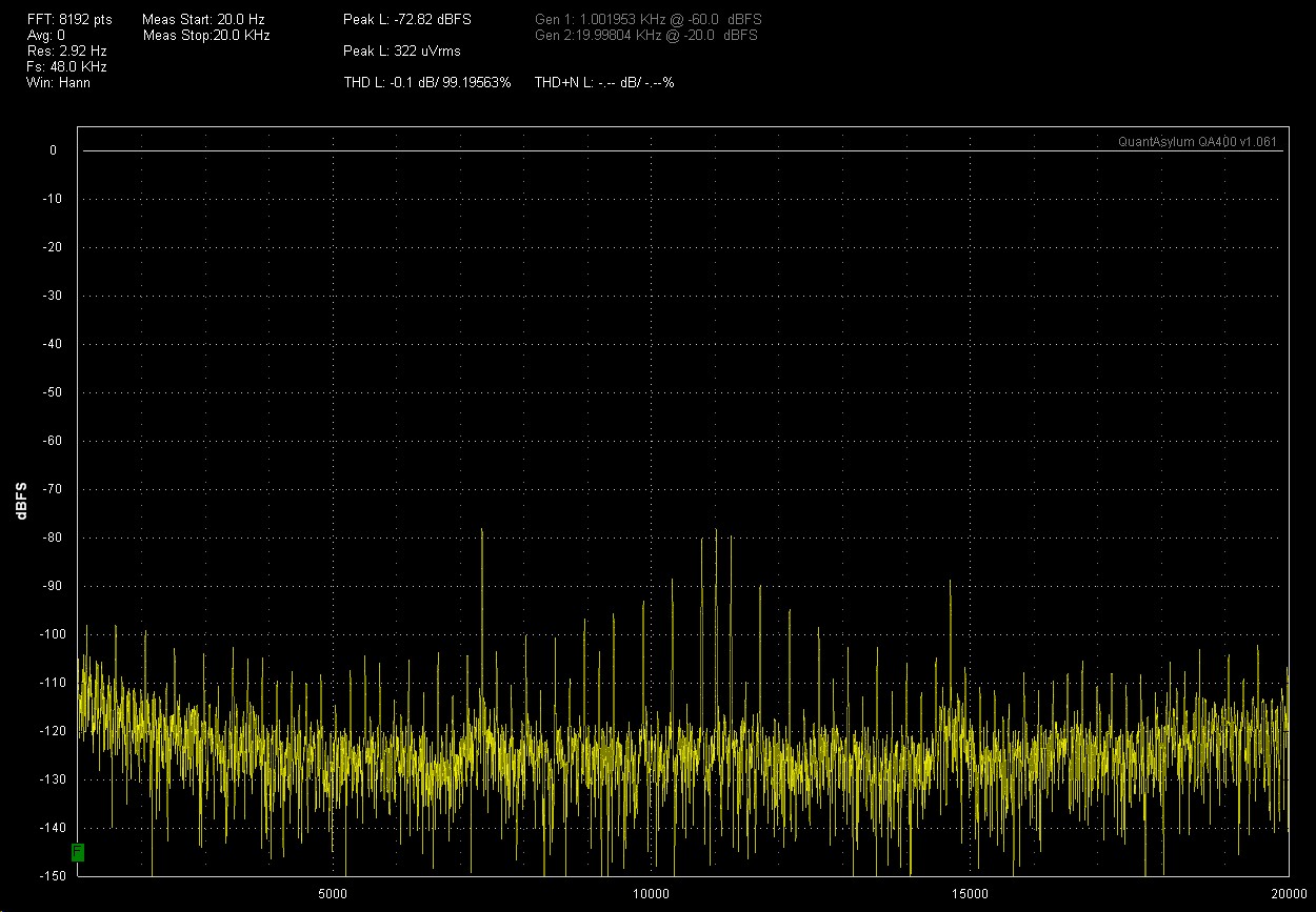

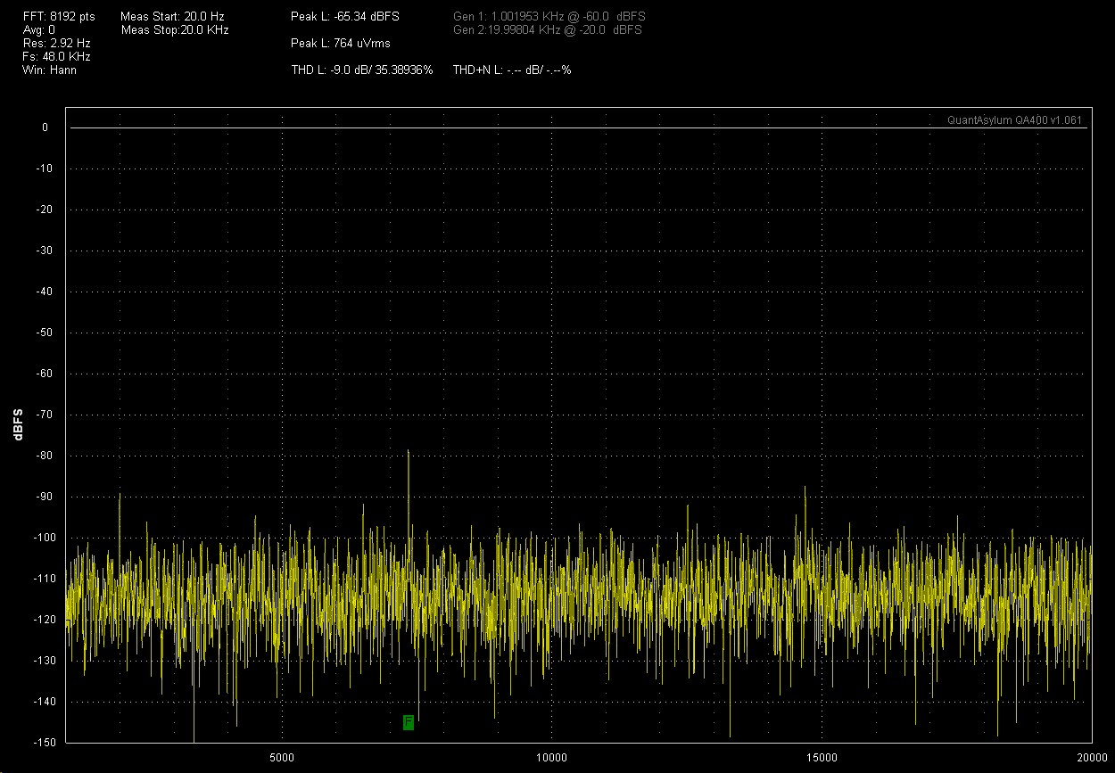

Here's what I measured in 2013 with the help of a Yamaha TX1000U tuner on one of the worst player I come across a Sony CDP-350, although it's jitter performance was OK, and I doubt I would hear any difference anyway.
Pictures: 1. CDP in "Stop" ,16MHz clock on the tuner output, tuner tuned to ca. 97MHz.
2. CDP with a 16MHz clock plays 1kHz -15dBfs track ,the clock seen on the tuner audio out.
3. CDP plays the -3.5dBfs Jitter test track ,observed on the tuner output.
4. same, but -9dBfs Jitter track.

Beside the artifacts in the first picture, in picture two the 1kHz is visible affecting the oscillator, so does in the two last picture the jitter track, and the dBfs level.
Getting quantifiable reading from this is a real undertaking. I would not make the effort even with a calibrated FM source. However you can get a glimpse of the relative performance as was visible above. Another challenge is making sure you aren't getting feedthrough from some other mechanism like grounds.

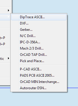

What I will do is to make a good PCB layout (most likely two layers) of a "no frills" type. I.e. in case the Wenzel circuitry is chosen it will be with "settable" jumpers and no relays or rotary switches etc.
I reckon this will be sufficient for a DIY'er as I assume the number of measurements to be made will be relatively low. It will also simplify the layout.
In case others here are interested the layout(s) will be available as pdf.s and/or diptrace files (or files types that may be exported from diptrace - see attachment).

Another story is the timing jitter of SPIDF signals. To measure this, you
can not use the crystal phase noise tester. But fortunatly a simpe digital
Osci will do.
A simple jitter experiment:
In the zip file are two 440 Hz 16 bits/48kHz sine signales with the spectrum
as in the picture.
The second has random jitter of 10 nanoseconds (not picoseconds) added to
the sampling clock.
I will bet the first one a beer, that can hear a difference using the foobar ABX test plugin!
as in the picture.
the sampling clock.
