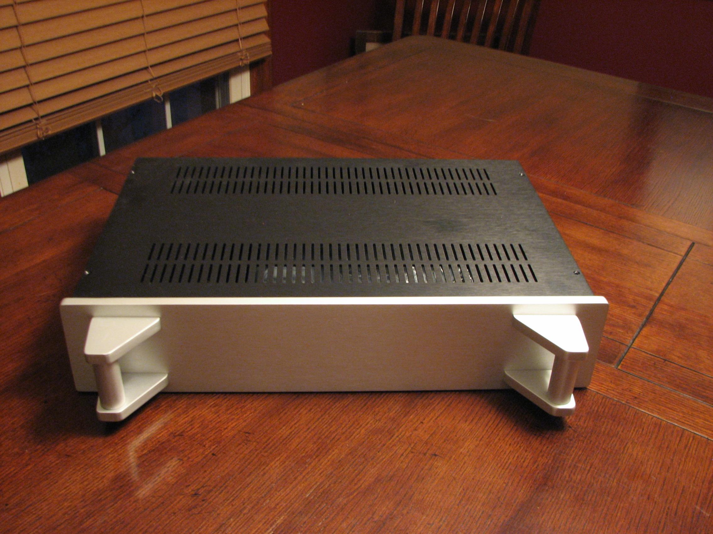

Hello FormosaWest,
How are you liking your Pearl? I'm still trying to get my boards clothed in a nice chassis. Your chassis is real nice looking. Where did you get it from? It looks expensive.😀

I absolutley LOVE the pearl 2. Im thrilled i managed to build onep and that it sounds so fantastic. Its only gotten better with time.
The cases are from HiFi2000.
Its an italian company. Their service is fantastic. They have several choices. The case is specifically called the "slimline" and it is the 2U height version. There is a 1u, 3u as well. The 2 unit one is the best heigh though. They have other cases as well. Different front panel choices are vaialable. I chose the 10mm front panel. I also got the interior base plate and the front fascade.
I used a regular bench top drill press, and regular quality titanium coated drill bits and bimetal hole saws to punch the holes. I used the slowest rpm setting on the drill press, and drilled patiently, clearing debris and lubing as needed to keep the bits sharp. I just used wd40 to wet/lube the drill bits. Square holes for the power input where drilled with a holes saw, and then filed square with a bastard file. I used a hand punch and hammer to start each drilling to prevent the bits from walking.
I used solid 24guage 99.999% silver for wiring, and stuffed it down teflon tubing. Woven Nylon expandable housing was used to protect the wiring and give it the pro look.
I highly recomend the hifi2000 cases. The company is fantastic, they have an english speaking representative, and delivery was actually fast.

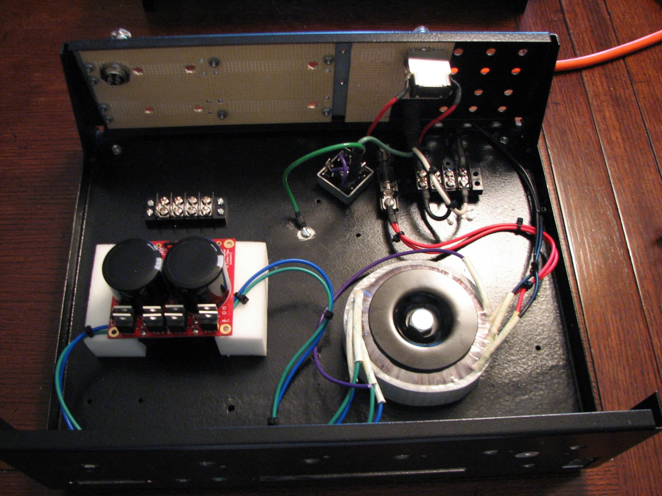

Tiny bit of progress on the easy part, the power supply. It is in its temporary home and generating proper voltages. Only need proper stand offs and some 4-40 screws and nuts to secure the other small barrier strip.
Looking good!
The purple wire from the transformer is the shield. Attach it to the chassis.

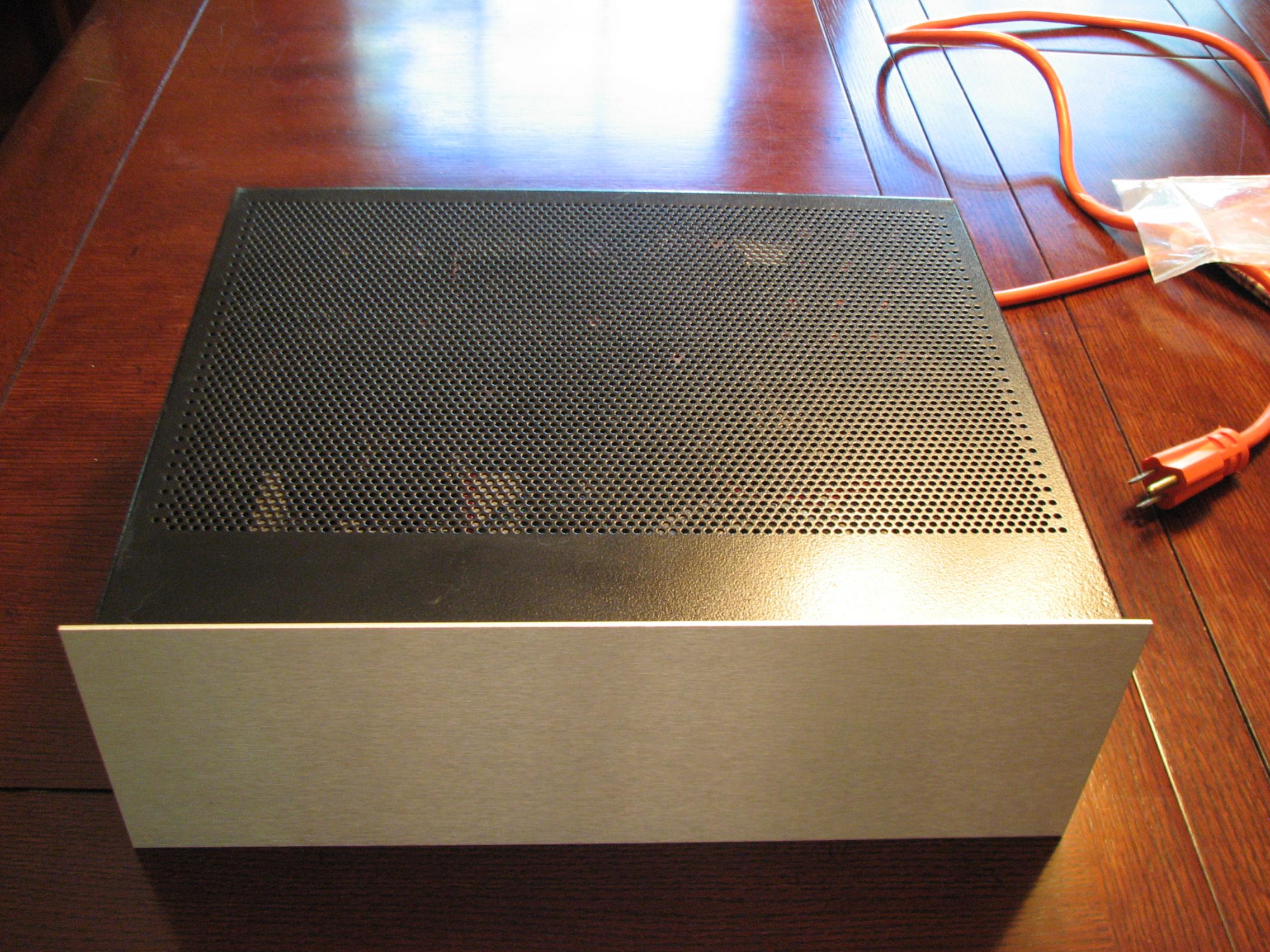

What's the old chassis? It looks great!

Its an old Dynaco Pat 5 case I bought from "Stereo Cost Cutters".....they bought all Dynacos parts, chassis, trnasformers etc when Dynaco folded back in the day. Had this thing for a long time! The faceplate is just a blank piece of brushed aluminum that came from the same place. I want to eventually put this power supply in one of the smaller store boxes, so it will match the store box I have for the Pearl 2 itself.

I got the rack handle for the Deluxe 5U box for the Turbo F-5, this looked to plain, so I added the handles. A box just like this but a couple of inches taller would be perfect for my Pumpkin Kit and boards, which are going to finally see a soldering gun, but not until Pearl2 and Turbo F-5 are done!
