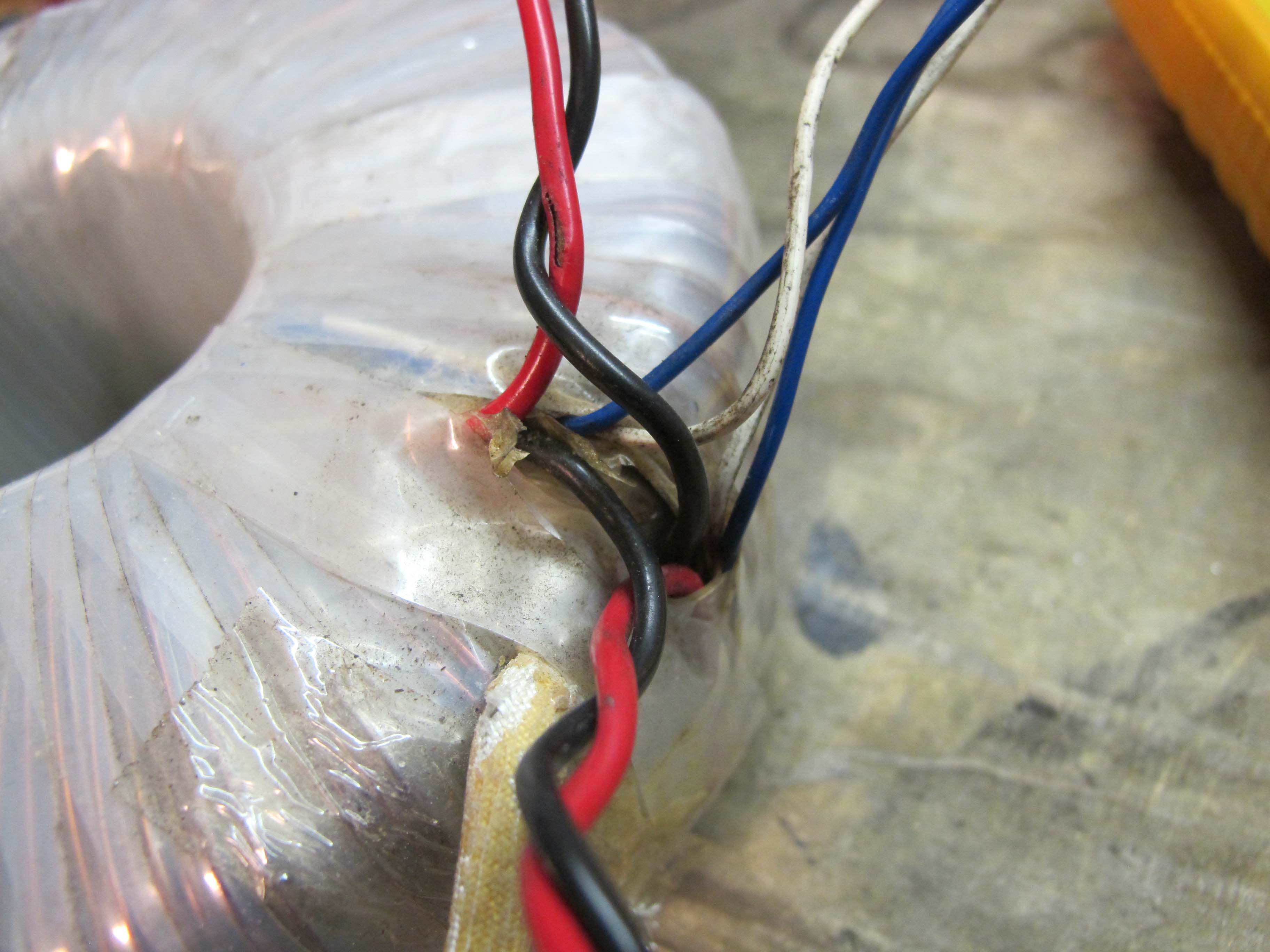

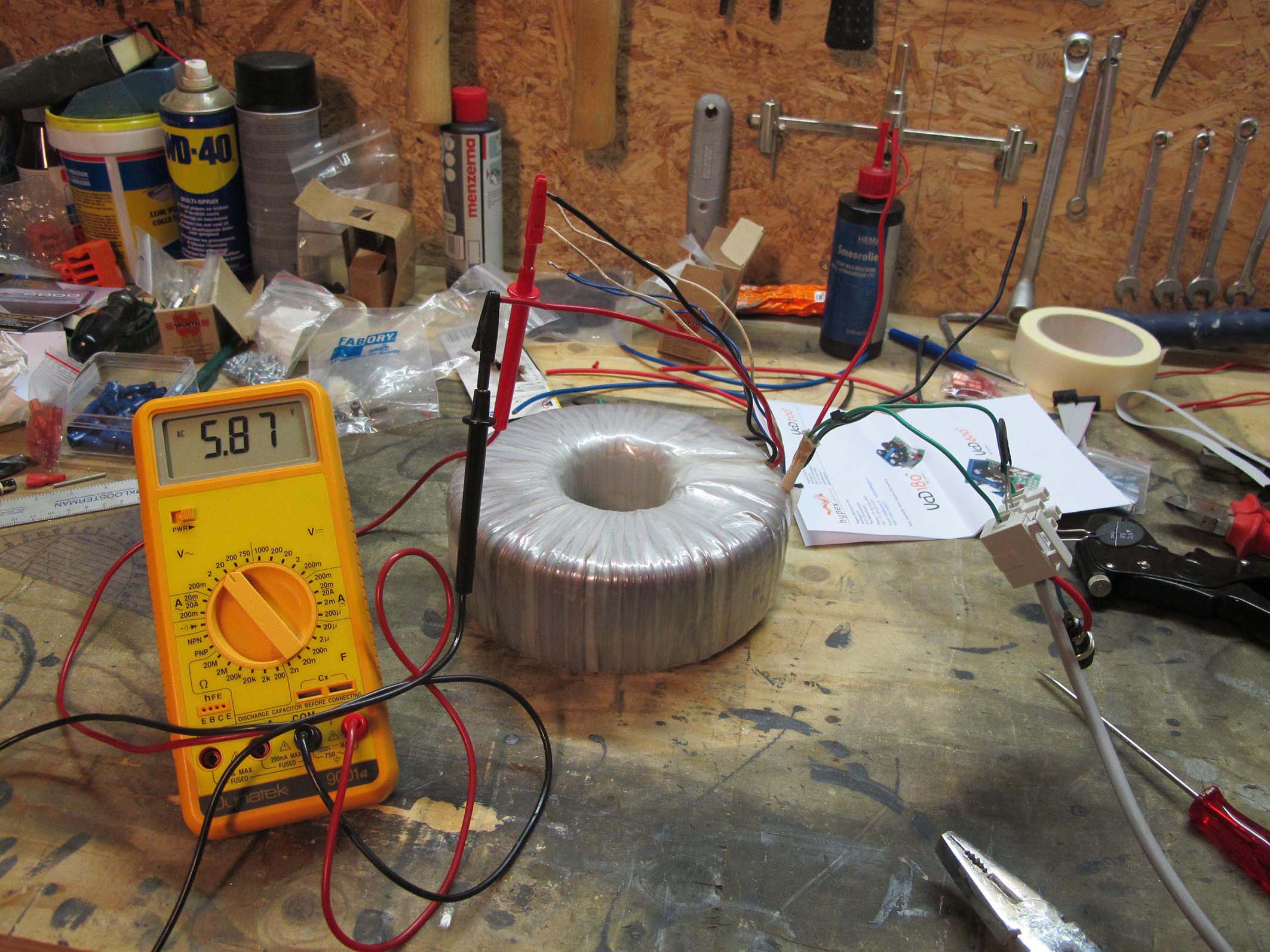

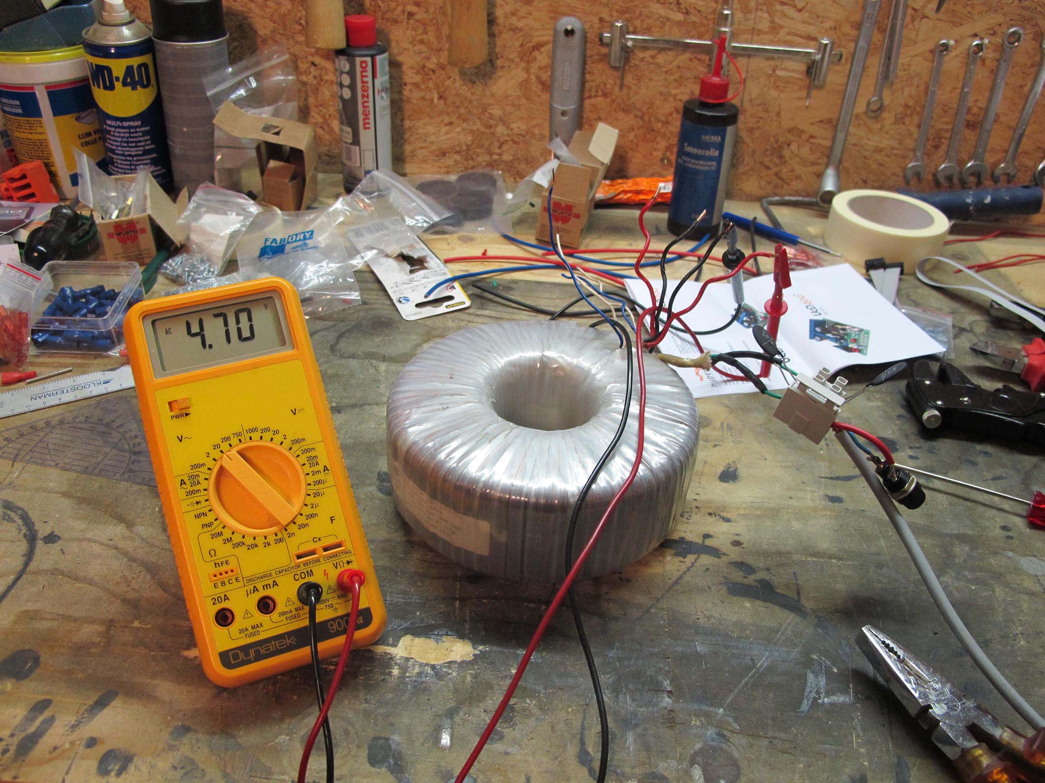

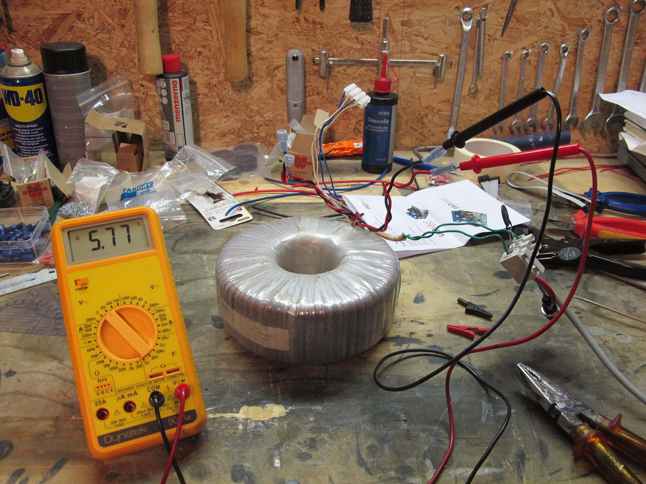

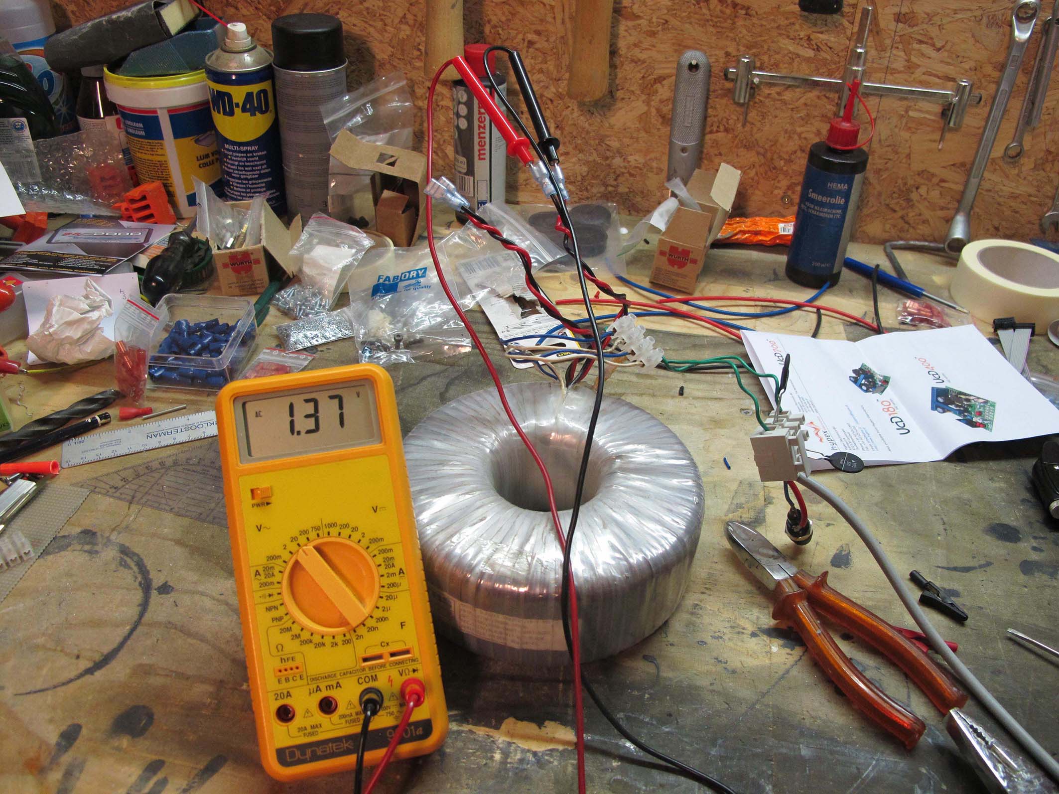

The transformer story...

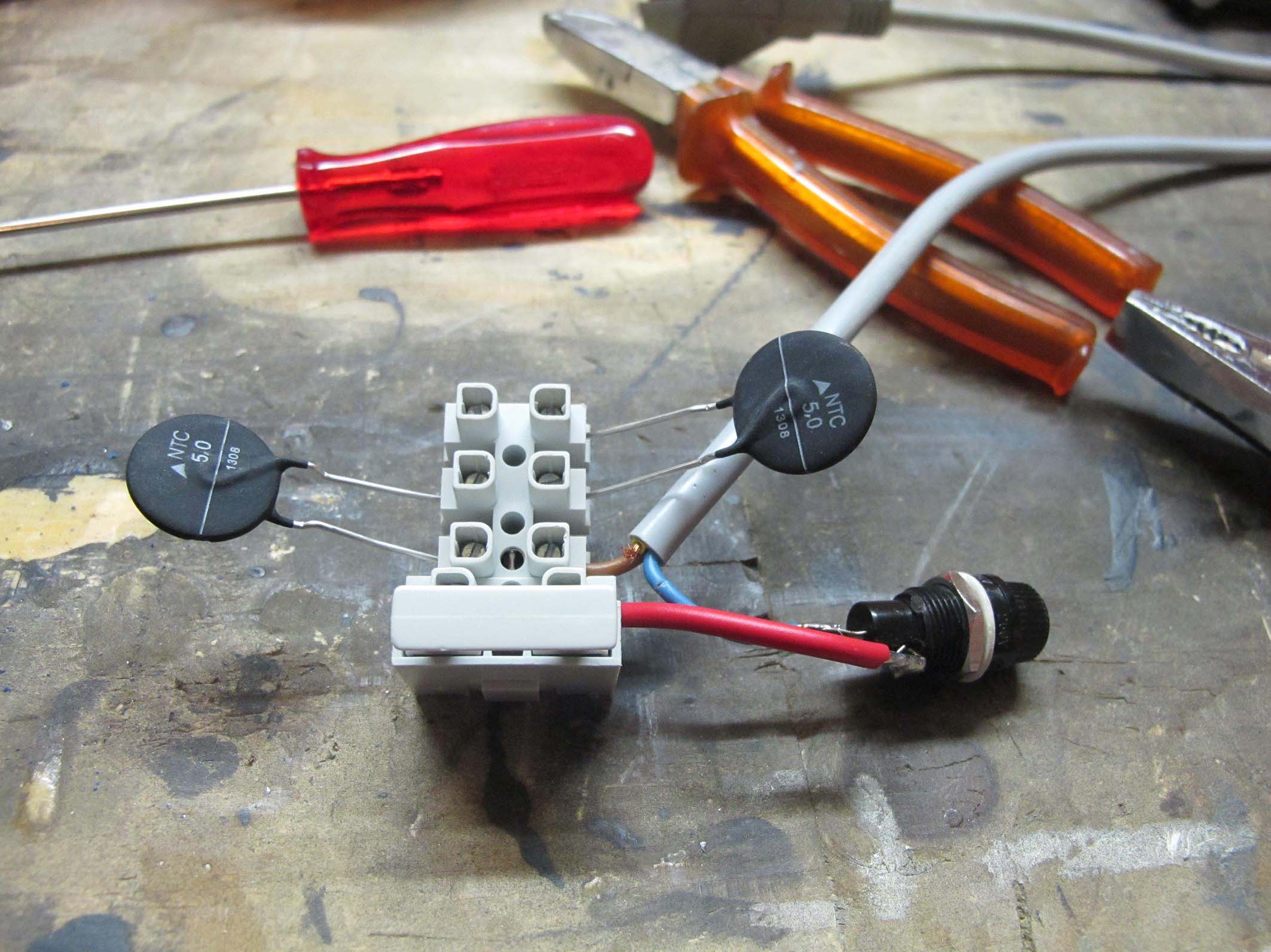

First pic is the set up with 2 NTC's.

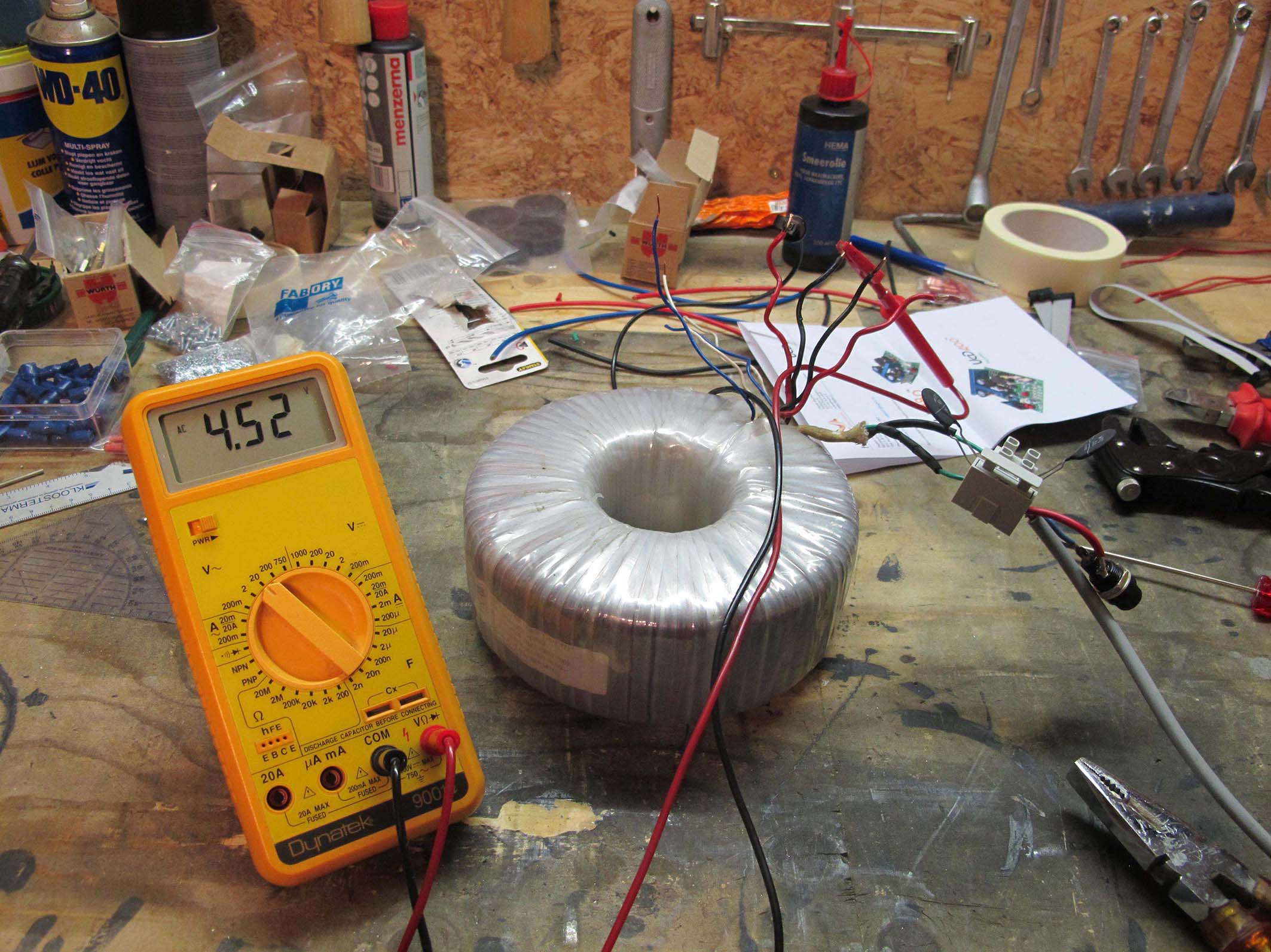

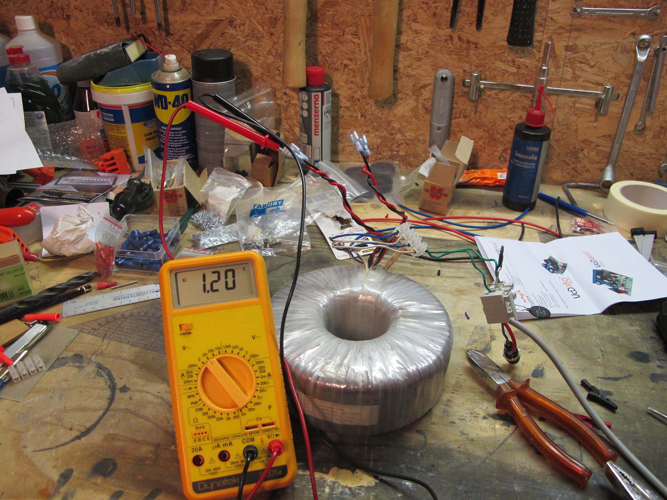

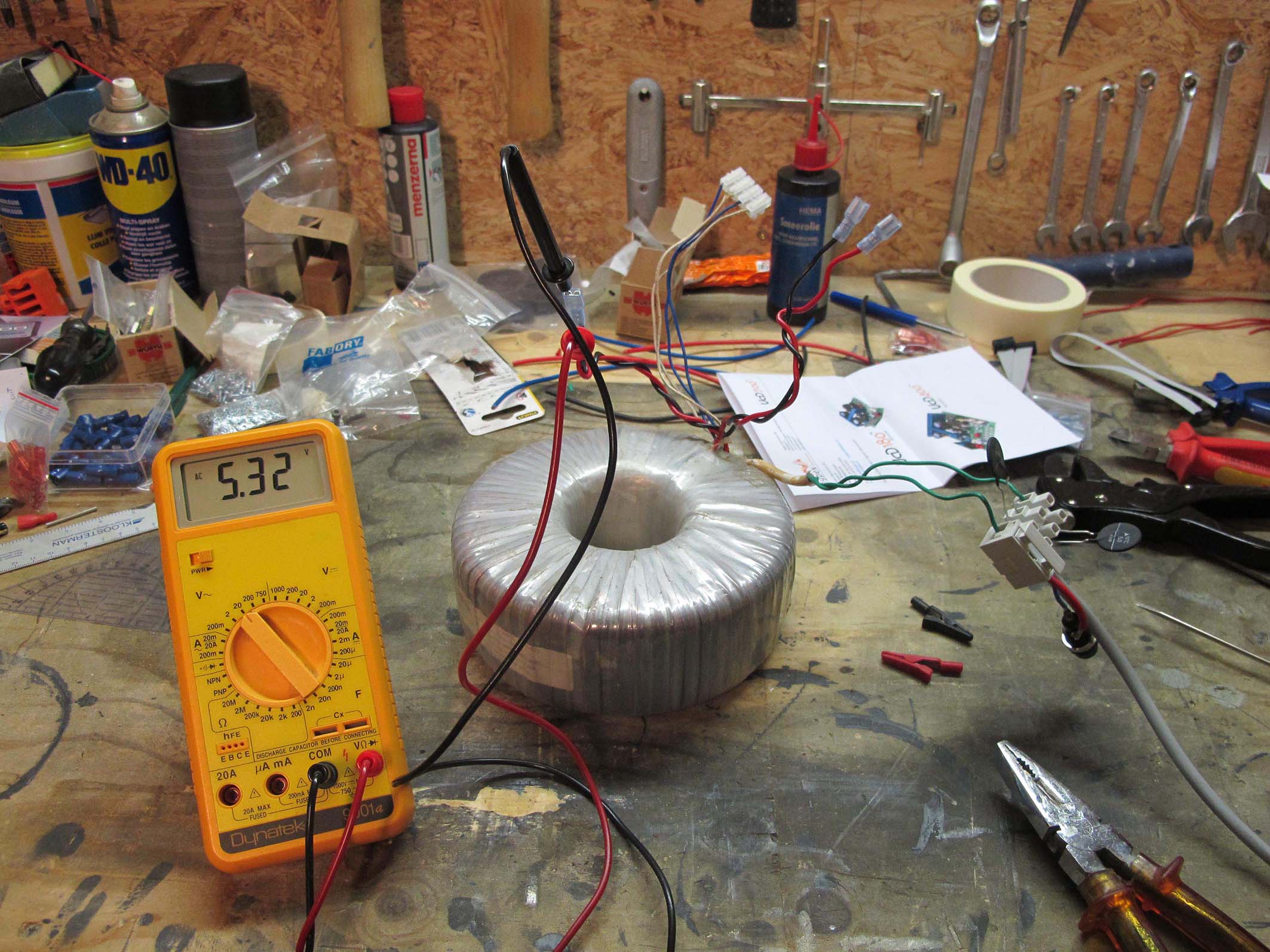

Then the multimeter is set in the 20VAC range.

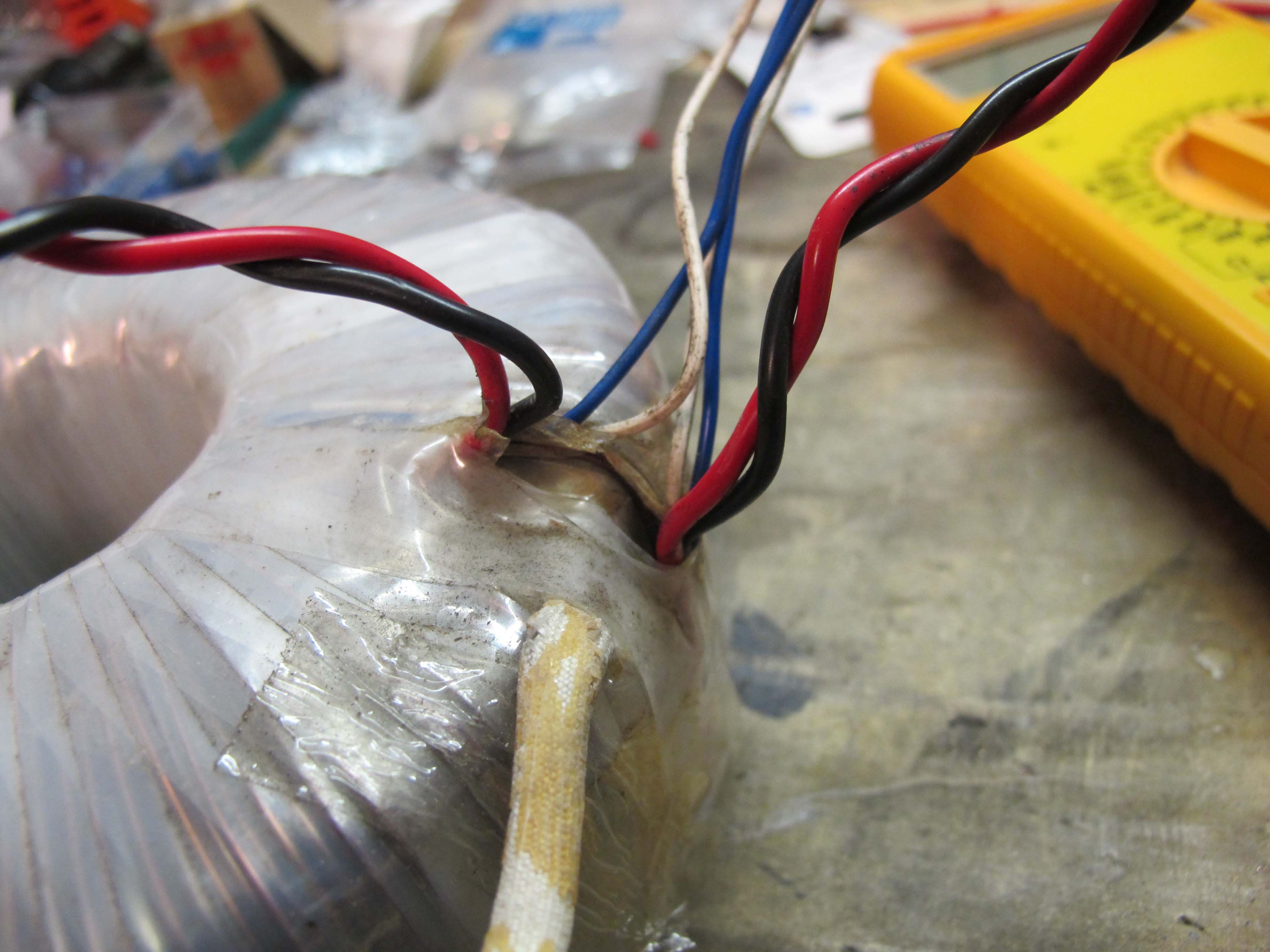

Pics of transformer 1 to 4. The transformers with the connectors were used in the amp and lived for a short while... One faulty transformer is rare. Four faulty transformers is a miracle...

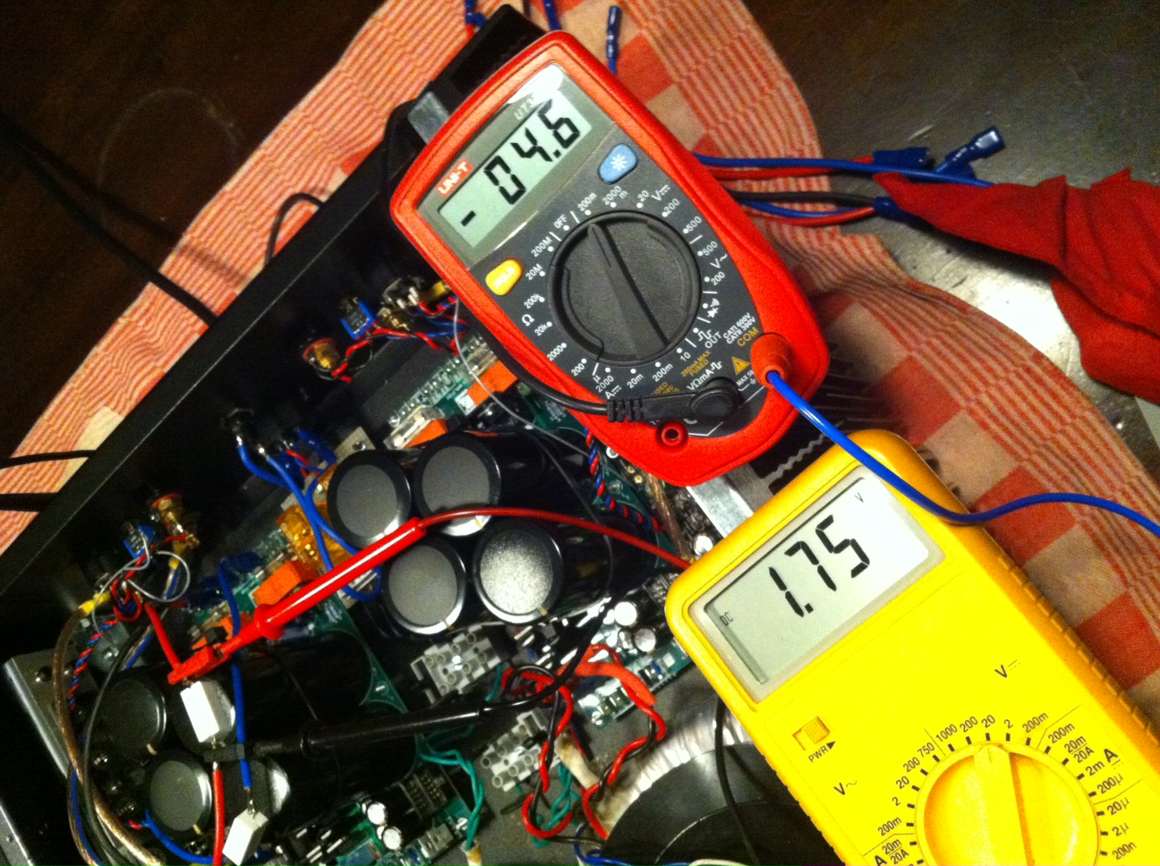

Biasing one channel. When turning on the amp I adjusted to 5 mV between source pin and speaker output and nearly 2V the 10 Ohm 5W resistor in the plus supply line. Picture is after 10 minutes. (- on the red multimeter is because I have the leads mixed up in the multimeter). After the amp stabilizes I will adjust to 5 mV (2V over the resistor) again.
