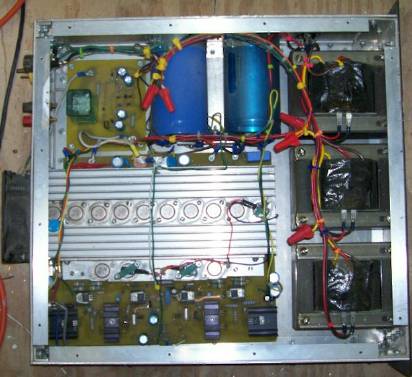

Adrculda said:
If i can squeeze 2 x 550W RMS @ 8Ohms, i would be more than happy 😉
Piece of cake. The old design will do THAT and sit there and laugh at you.

wg_ski said:
Of course it won't work in class A. I don't think the OP is considering that anymore - especially now that we know it's for PA bass bins. The +/-140 is for my 3-tier design. One of the earlier class B amps running on on +/-127 used a stacked S-Leach type OPS with the same number of devices as Project 117. And would happily drive 2 labhorns in parallel all night without giving a ...., at least until the plug melted off the extension cord. New cord, and the bass thumped on.
The whole idea of not making it a bridge amplifier is so that you can bridge it. 4K into 4R.
I was referring to Adrculda's amp and his +/-140V rails, as proposed in the opening post.
I sincerely hope he is no longer considering 1500W class A :hot:
Glen

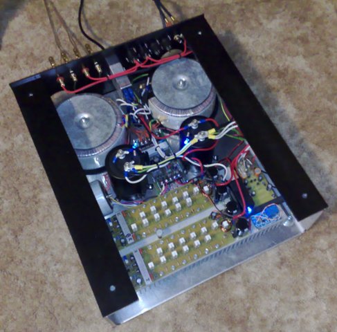

Quasi has a design for this sort of power here maybe some of this thread can be useful:
http://www.diyaudio.com/forums/showthread.php?s=&threadid=53264&perpage=25&pagenumber=18
I attached a pic of the one i built.
2 x 500W rms into 8R
Quite a simple layout with nice results.
PS, you may wanna rethink the amount of parallel devices used here
at some point the driver stage will find it difficult to cope especially at higher frequencies. although i hope you do build this amp with 140V dc rails good luck with your build!!!!!!
also in my sig line is a 1kW (2 ohm) amp design if you are interested.
-Dan

Did not. There are 2 versions of that +/-127V amp. Stereo and monoblock. The Stereo version puts out 680 watts per channel at 8 ohms. The monoblock (pictured) around 1100 into 4, 1500 into 2 - limited by the incoming AC mains. The 'replacements' should be tickling the 1kW level at 8 ohms.
