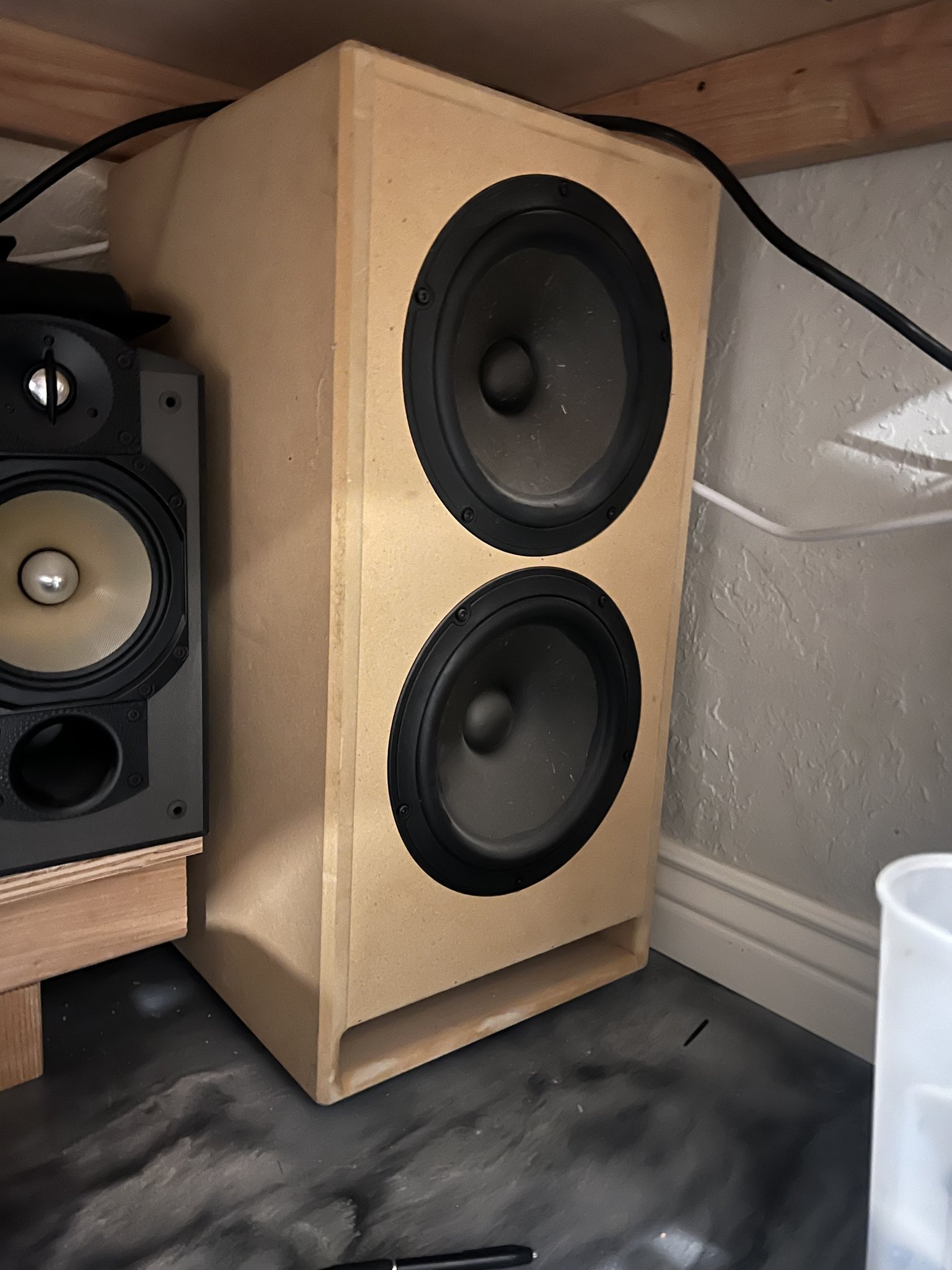

I built the midbass cabinets to a volume of about 0.68 cubic feet and stuffed them moderately with cotton/denim insulation. After talking with a couple of people I’m thinking I might take the midbass down to about 100hz to meet with the 15. I will need to model it a bit later when I have some free time, but thought I’d ask, what do you all think about the 251J reaching 100 hz in the cabinet? I’m guessing after driver displacement it’s around .55? I don’t know, I can’t find a spec on the driver displacement.
Is it possible that it could be faulty flat-ish down to 100 hz? I plan on taking a first listen on Wednesday or Thursday after my wife leaves for the coast for a few days.

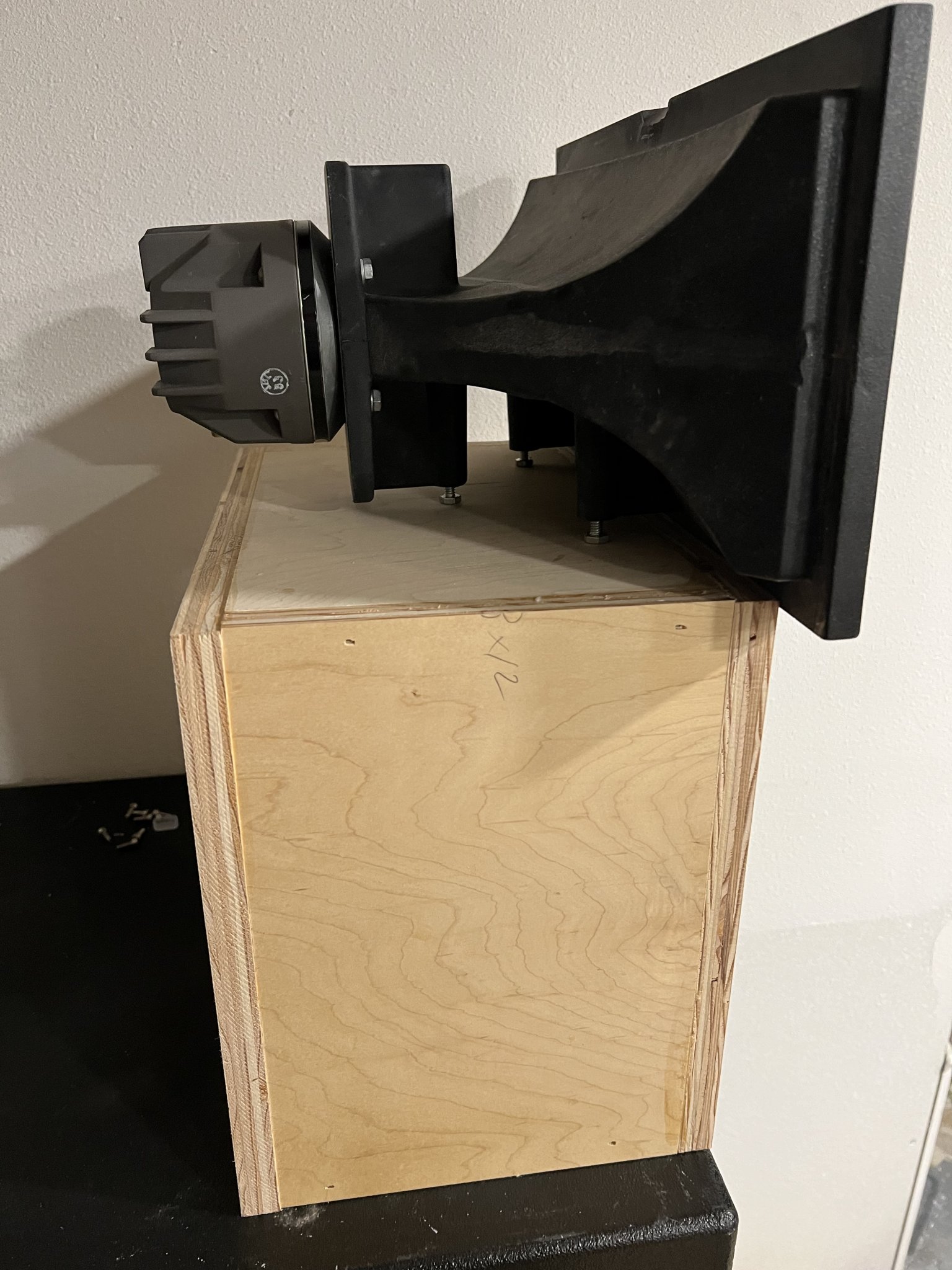

No judgment lol, these are literally just test cabinets to see how they do. The final cabinets will have a good amount of bracing, therefore be a bit bigger and size. If you want to make any suggestions to my stack please say so.
I need to figure out how exactly I’m going to get the 045Be to sit on top of the H9800 horn.

Just place the horn tweeter on the top and let it point at the same spot the large horn aims at. You may experiment with it's polarity and position when all other problems are solved. If you want it timed correctly, get rid of the passive x-over and use the DSP. As you use a 2x4HD per side, remove all parts of the lower high pass from the passive crossover and do it in the DSP instead. That way you are not limited to the 800 Hz point. 1.200 Hz should sound better with this horn as you reduce distortion that rises the lower the horn play's. 800 Hz is something you choose if a two way has too large a woofer, like a 15". A compromise, but nothing to prefer. It is not a crossover point you choose with that horn if you don't have too. You have got a very good 10" that will reach much higher without any problem, it should do even 1.800Hz just fine. Next, there is no advantage to let the 10" run too low. It should not have to bother with frequency lower than 200 Hz to get the best performance as a low mid. Low frequency increases the cone movement, which has a negative effect on higher content, reproduced at the same time. Try to write a letter inside a car while driving off road. The result has some similarity to bass and mid frequency reproduced at the same time.
The aim is to get the sweet spot of all drivers, that is why you go 4-way. So don't use a 2-way frequency.
If you measure distortion, you will see it by your self.
If you use a passive crossover, 12 or a maximum of 18dB/oct are usualy best. With an active one, your best bet will be 24dB/oct or higher without the degradation of sound quality and dynamics the passive parts brings you. Don't listen to people bashing active crossovers and DSP's or those that try to transfer all rules of passive design to active. Use the advantages a DSP has. Again, you will see yourself when you measure.
Setting up such a system is nothing you do on a single evening. Take your time, do some brakes in listening and reset your ears between sessions if possible. Don't drink while tuning the system. Even a little alcohol changes your perception of sound to a great degree.

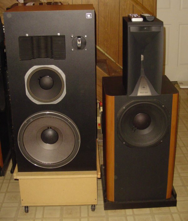

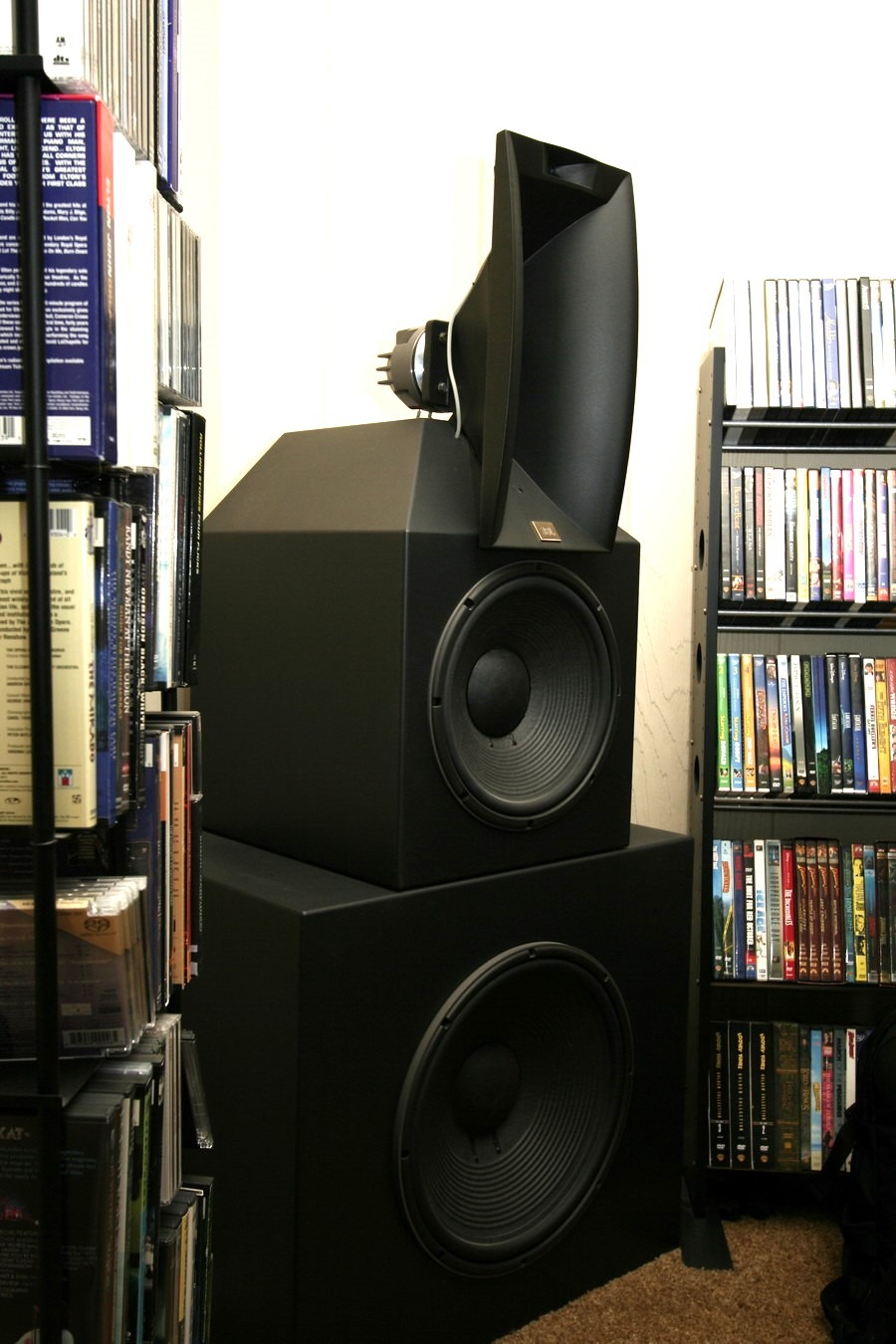

Some food for thought. When Greg Timbers did his personal home system he used 9800 horns and turned them on their side and placed the 045 up top. This morphed into how the Array horns were set up for production. It's an option you might want to try. I have a pair of 1400 clones with the same Be drivers and they sound very good and image much better than a traditionally oriented horn.
Rob 🙂

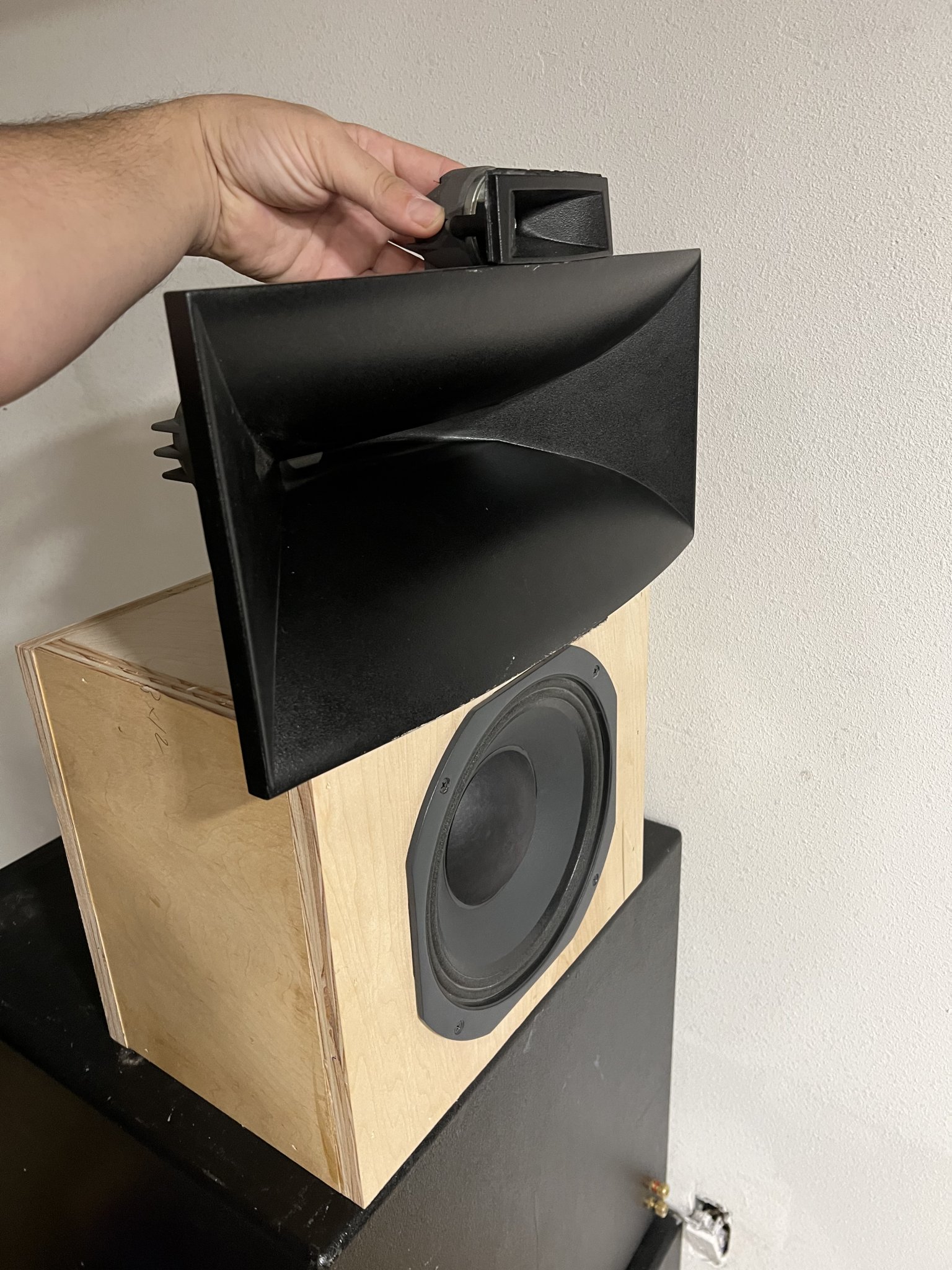

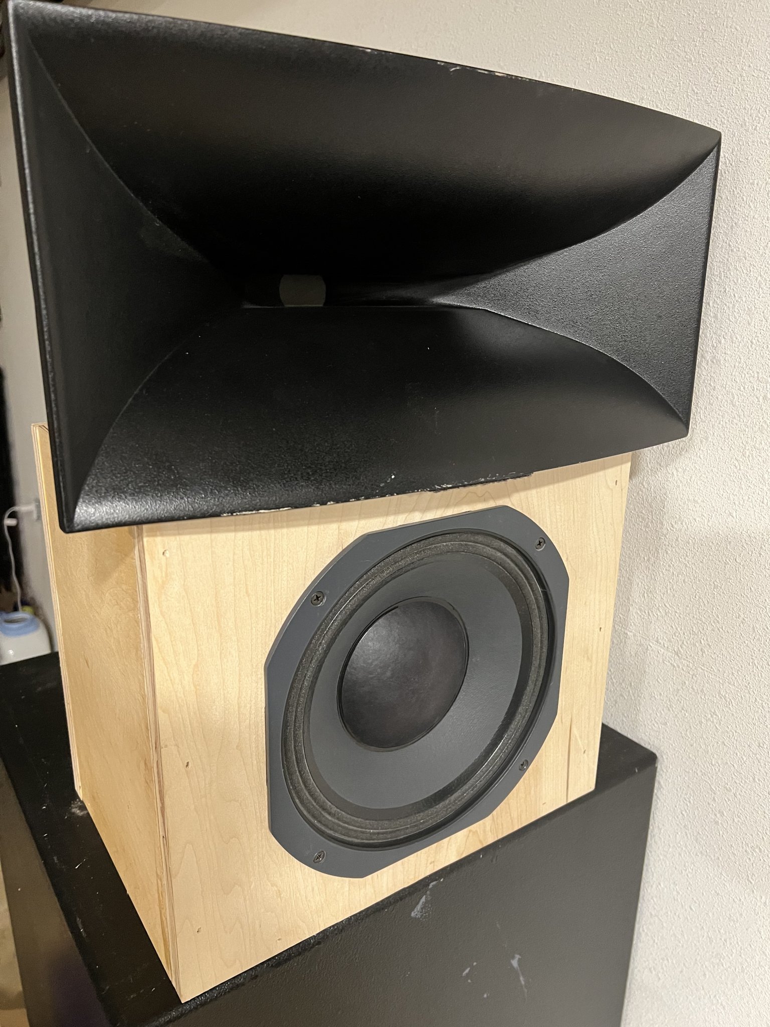

That looks great and the vertical orientation fits the speaker well optically. However, it seems your supertweeter may be too high, if I compare the driver sizes (15" and 12" I guess) and the CDs, records and shelves, which results in about 1,50m height? 1,60m? The tweeter should be at ear height, so either you're short and listen standing or you are probably 3m tall and sitting brings you to that height. 😀 No, seriously, how high are your supertweeters?
Dan
Since the mid cab was only a test, I’d place the super tweeter above the 10, below the horn. This will be your main vertical listening axis so best the HF content be within that window.
Also consider an Aperiodic enclosure for the midwoofer……..or in other words a resistive leaky enclosure. You don’t need the extended bass response and the leak will tame the impedance peak of the mid making for a much more consistent load for your amplifier. Not sure if you’re using any modeling software but most worth anything can simulate the leak and show you the effect on impedance and Q.
Rob 🙂

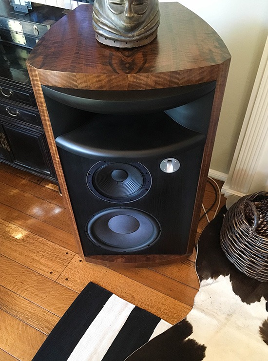

That is a fantastic idea, and I’ve actually thought about that in the past, kind of wanting to clone one of the array speakers. But with WMTMW design that will put this center to center spacing of the midbasses further apart, won’t that increase the comb filtering? I thought I would want them as close to each other as possible, is that correct? I do love the look of it oriented that way though. if you think I could get away with it in my design, I am 100% down to installing it vertically.

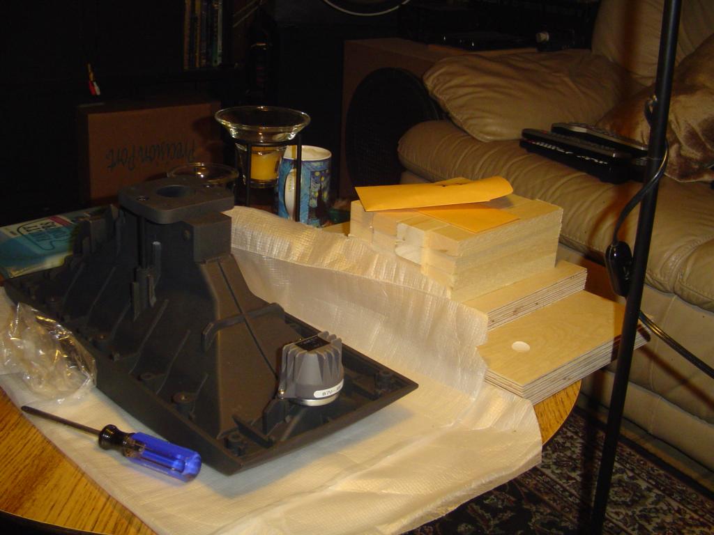

Here is a picture from 2007 showing the modified 9800 horn with the 045 integrated into it. You really want that slot vertical.
Rob 🙂
Nice, is that your setup? Or was?
Oh, wow, that’s a fantastic idea. I had not thought of doing aperiodic. I have never built one, only experience being with basically the Dynaco. What would you recommend? Drill like a 3 inch or a 2 inch hole in the back of the cabinet, staple in some screen material, and stuff the denim insulation up against it?
