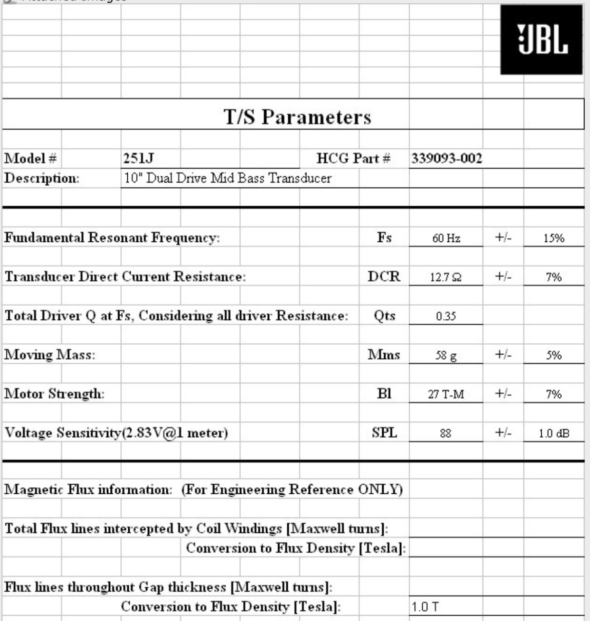

That brings me to the midbass drivers which are going to be 251J. These are a fairly rare and special version of this series of driver, they weren’t used into many designs, they have the aquaplas and added mass over the originals. For the bottom end, I’m going to be using 15 inch woofers that were used in some of their nicer subwoofer designs, though they have been used in three-way designs with much success, they are 1500 sub drivers.

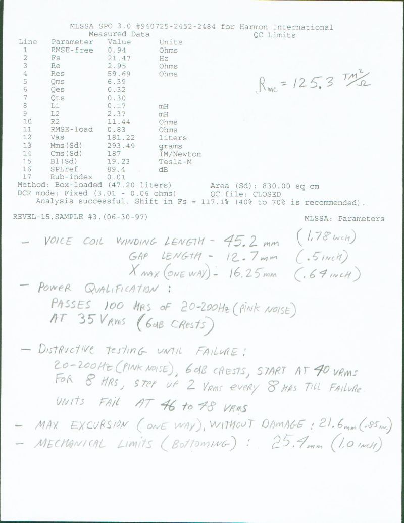

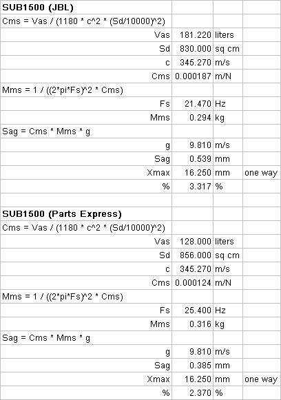

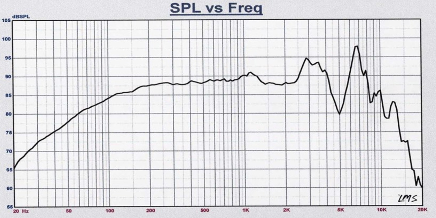

Here is some information on the drivers: the 15s are the 1500 sub drivers sold by PE awhile back. The same driver used in the Revel Ultima sub. From what I understand it is quite similar to the W1500H. I know it may not be exact, but I’m thinking I want to go all sealed cabinets to keep cabinet volume down plus, I don’t want multiple tunings in the same room if I port the 24s. I know they have been used with success in sealed cabinets ranging from 2 to 2.5 cubic feet. Some of gone slightly smaller, and some have gone slightly larger. I figure if I have DSP and realistically, I am only running them down to maybe 30 Hz listening to music I can get away with not going huge.
15” woofer
https://www.audioheritage.org/vbulletin/showthread.php?7113-Project-Array#9
10” 251J
https://www.audioheritage.org/vbulletin/showthread.php?11985-251J

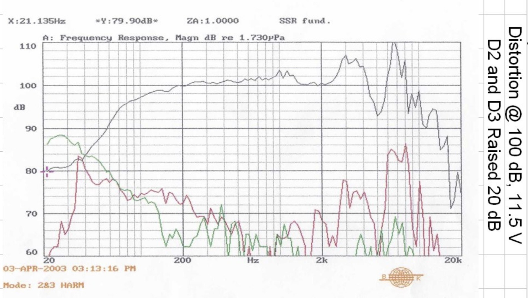

These are some parameters of the drivers.
What would you all do for the 10s. If I cross them as high as 200-300 hz I really don’t have to go all that large. Plus the original cabinets weren’t all that big, I was thinking maybe 1 cubic foot sealed? Maybe a little larger and crossing lower to the 15, I am wanting heavy impact in the chest.

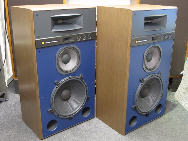

I used .5 cubic ft on my 2123's and if you look at he 4348 with a very similar driver to yours it's the same. Yours were used in pairs in vented enclosure no? Do you have the T/S for them? JBL also ran a pair of 2123's reflex as well. I would go with .5 sealed and see what you get.
4348 very similar to what you want to do.
Rob 🙂
https://www.audioheritage.org/vbulletin/showthread.php?17053-4348

Awesome!!!! Thank you so much. That indeed looks quite similar to what I am wanting to do. I will go with 1/2 cubic foot.
They were indeed originally used in a bass reflex and there were two of them. I forget the exact frequencies, but one of the drivers was crosses at like 120 hz while only one was allowed to meet up with the horn.

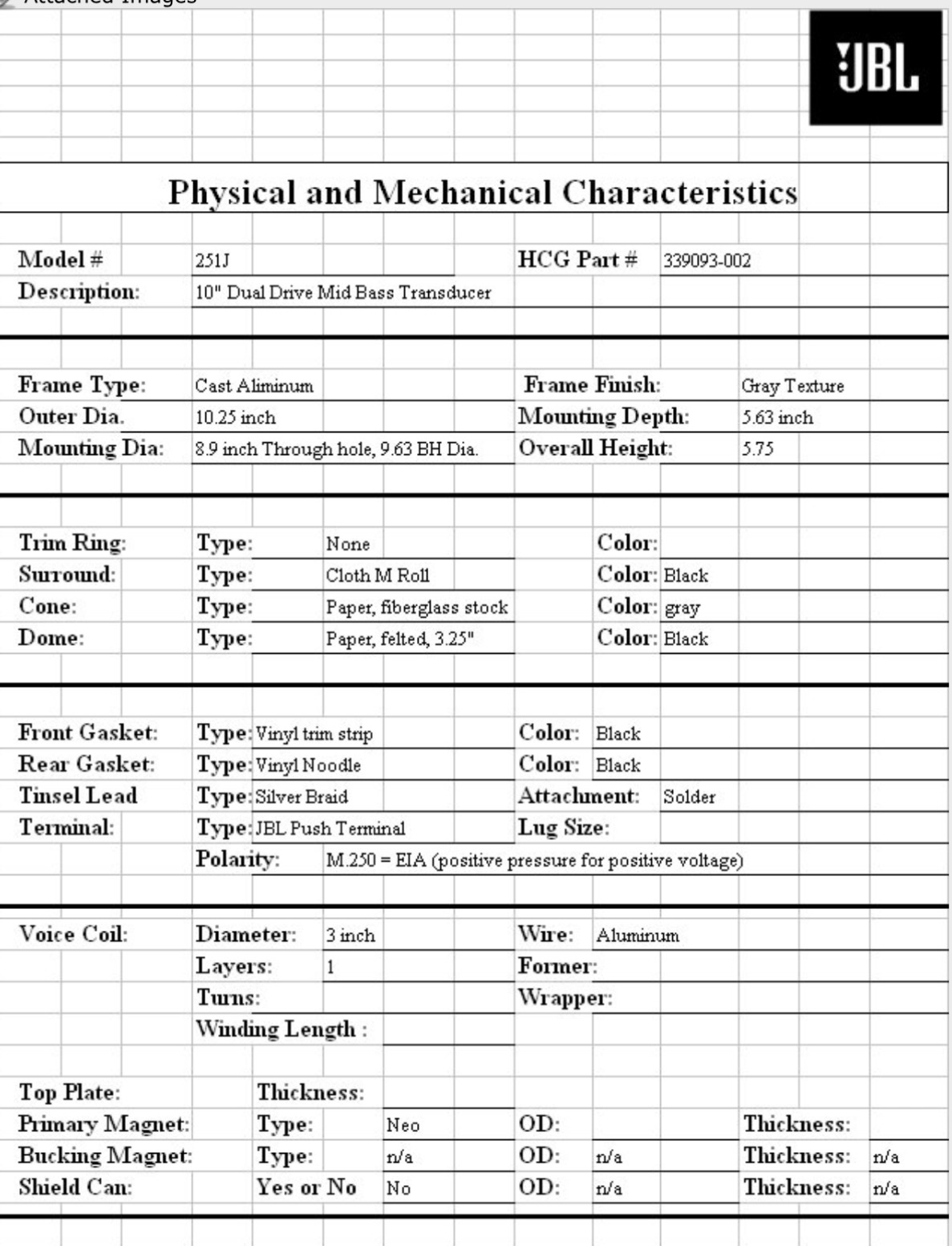

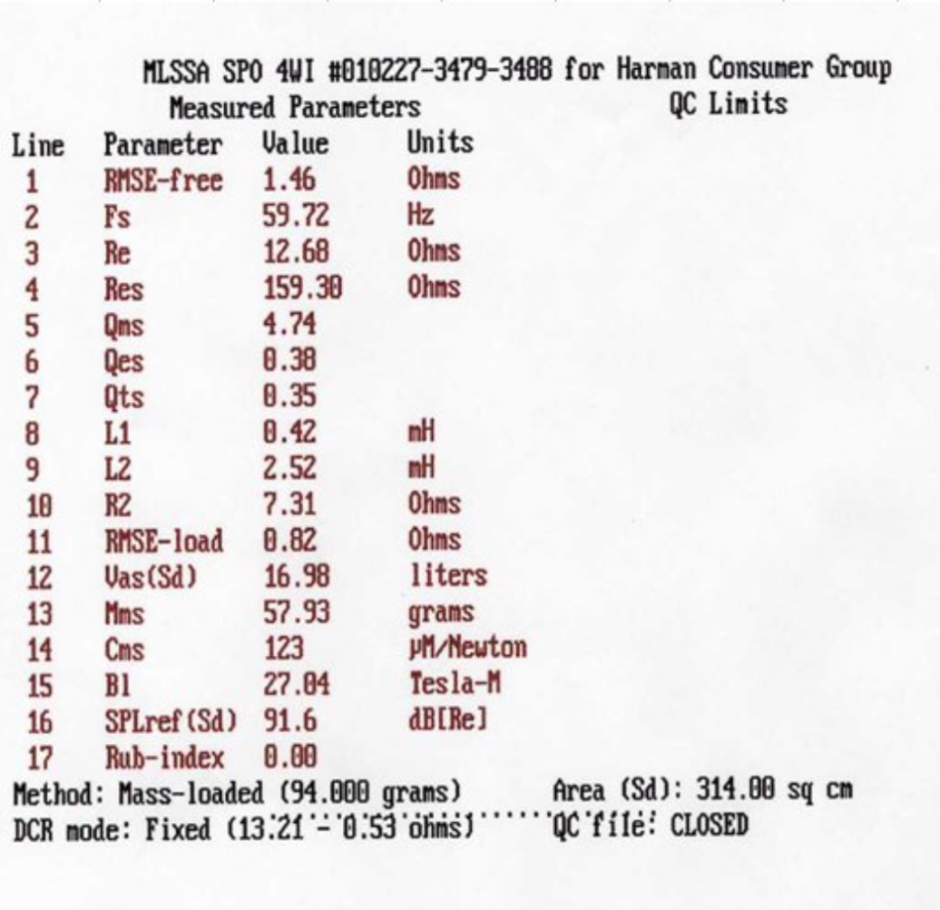

Here is the info I have on the 251J.
My other option is to do an exact clone of the K2-9800. It uses the same horns and compression drivers I have, but then I wouldn’t be able to use the tens. Also, I would have to find a third 1500AL-1 woofer in order to make a center. Otherwise I guess I could use the 1500ALs I have on the two mains for music and then just use one of the sub1500s I have for the 15” driver on the center. I’ve been going over that in my head for a while, but I think my initial decision would be better overall for home theater probably.

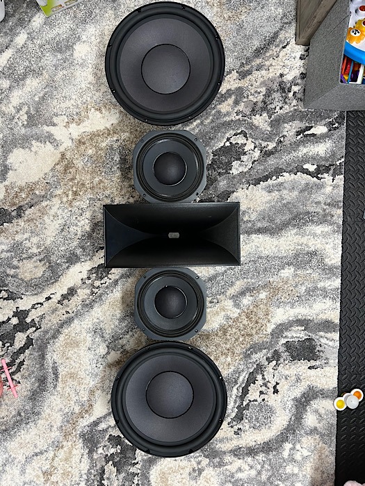

As I mentioned earlier, if this works out, I’m going to have the midbasses and woofer about in a WMTMW type of arrangement, like this
So far the plan is that the upper cabinets would be supported by 1 inch all thread, nuts and washers. Realistically, the smaller the cabinet the better. There will be 6 of these 15 inch woofers in total up front. Do you think ported is the best way to go? Revel used it in a smaller sealed alignment. I’m not completely against it, but the benefits would have to greatly outweigh the sealed for me to go that route.

I had not found the parameters of the driver and wasn't sure which one it exactly is. It's not a bass, it's a subwoofer driver. If you want to use them with the bigger subwoofers, build their enclosure sealed, that makes it a lot easier to create a DSP setup because it doesn't have the strong phase shift. Sealed will also have a lower group delay and will sound cleaner, so it's indeed a lot more promising.
Reactions: saabracer23
Excellent, I would really much rather go sealed. I’m absolutely certain that they will provide me with more than enough low end even without the subs for music.
