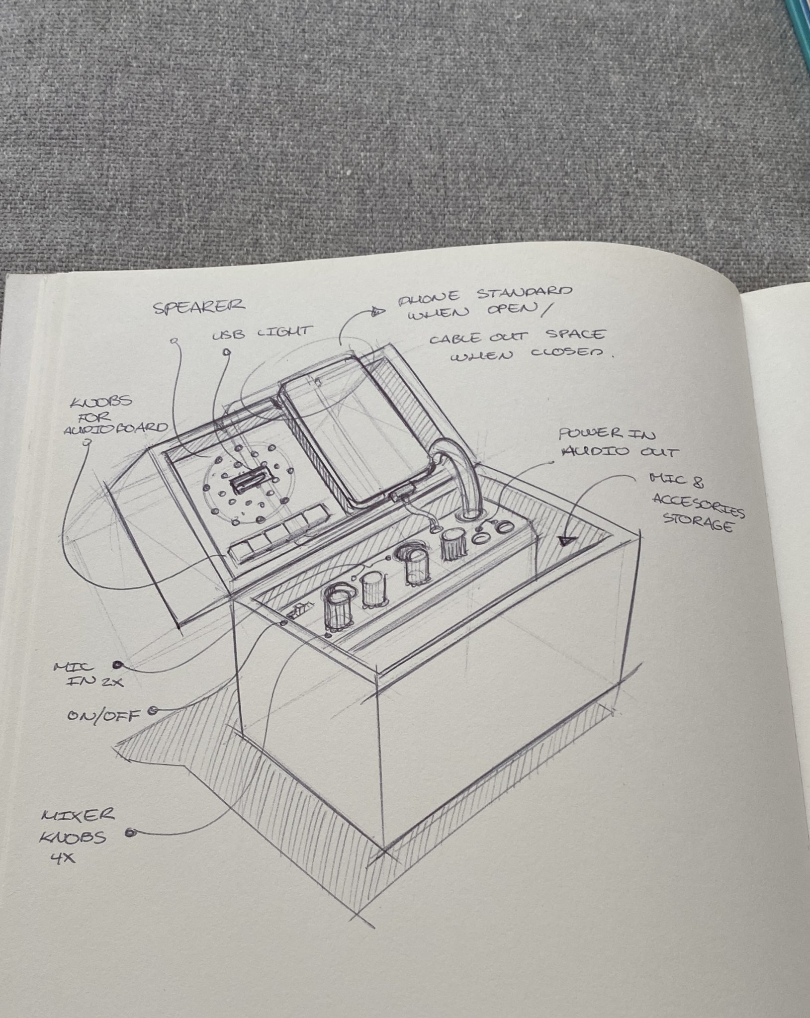

I'm excited I can finally move on to making the enclosure now, however I have a question about the final piece of circuitry I like to add. I want a slideswitch with a led to power the system on and off. Since the current of the rest of the circuit has spikes up to 2A, I was thinking of using a MOSFET for switching the high current circuit.
