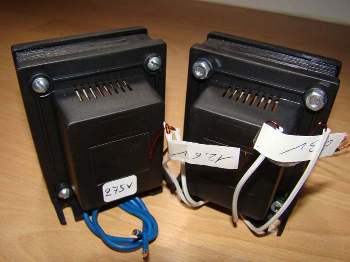

Just got my custom built transformers. Very happy with them indeed.
Take a look.
1st tranny:
0-275 200 mA
2nd tranny:
0-12.6 V 4 amps (6N1P,5687 heaters)
0-6.3 V 1.5 amps (for 6X5 heater)
Thanks. (just 45 bucks for the 2 🙂 🙂 )
Yes they are rather big, no problems as I planned to place them externally on the top anyway. I like to see them.
I guess they will dissipate the heat very well. Also the heater tranny has lots of headroom with 4 amps for the 6N1P and 5687 tubes.
Will the placement of the tranny's have any effect on the psu and main board?
I mean if they are close to the tube and other components could there be any unwanted side effects?
I'm thinking I could build a base for the tranny's totally separate from the main board and psu to isolate them otherwise they will be very close to the circuitry.
Brit,
Xformer placement won't have much effect on the Mobo or PSU board. Not likely to affect the rectifier tube either.
With the Xformers exposed (up top) that should be enough to mediate their flux effect on the Mobo.
If you are using a choke input on the PS board it will effect the choke dramaticly. Here's how I figured my Xformer / choke layout:
Being cautious not to short the secondaries, apply power to the primary side of both Xformers, set them approximatly where you would want them to live. Clip the leads of your Ohm meter to the choke's two wires and move it around the Xformers.....watch the meter move magicly. When you have found the location that effects the least and your happy with the look, bingo, your done.
Make sure to set Xformer windings at 90* to each other if they are close. A great explaination of this procedure can be found in "Building Valve Amplifiers" by Morgan Jones.
Very nice looking Xformers BTW.
Ron
