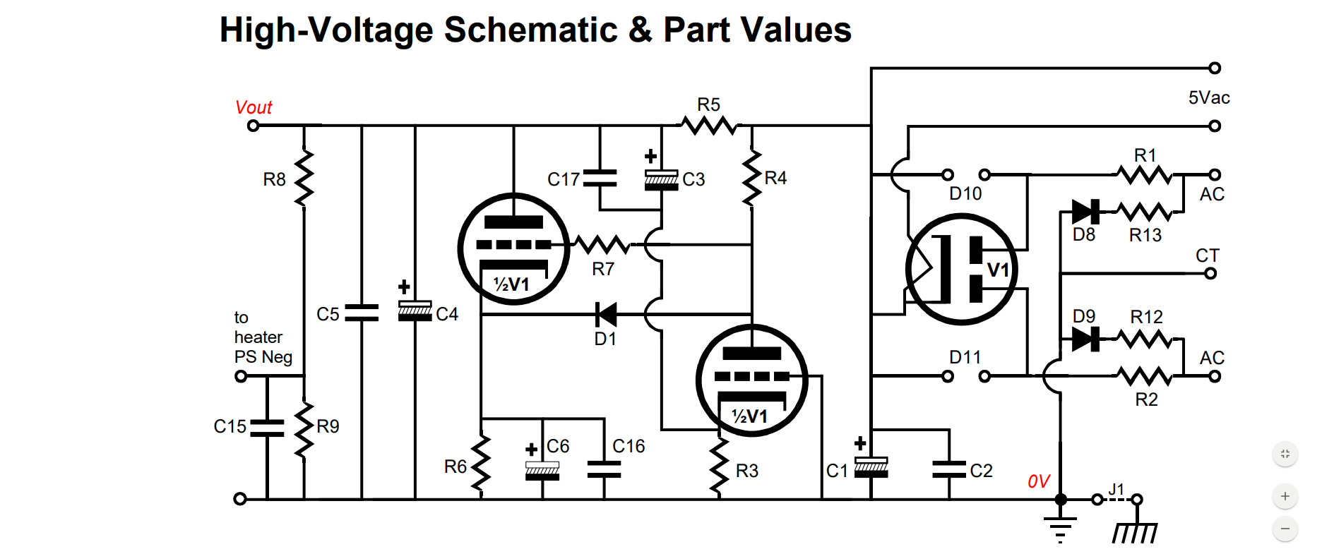

Hello everyone, I'm starting to build my aikido, I bought 2 9-pin mono cards, I would like to use 4 e80cc tubes, so I should also understand and choose which power to use, one that I would choose is that simple aikido all in one, with the addition choke, or the janus shunt, which one do you think is the best choice? Or is there any other option?

I have built a 9 pin all in one with the SS PSU, and a dual mono using two Janus PSUs. They sound remarkably similar. The dual mono might have the edge, but it is more complicated and expensive, not sure it was worth the extra fuss. Both sound very nice.

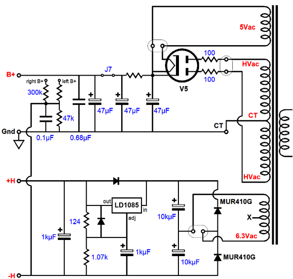

OK, so I built the Aikido all in one Noval - with 6N1P on front end and 6H30 on back years ago - sounds nice!...
But something has always annoyed me - I hooked up the Hammond tranny (way overkill, but all I had when I built it) and have the 6.3v - 6.3v secondaries for heaters to the Aikido and after its regulation, the heaters are only seeing 5vdc. The losses in regulation circuit drop the heater voltage (duh) - and when I re-read the instructions it recommended 7v - 7v+ secondaries for the heaters, so the regulation can drop to somewhere around 6vdc.
I know Broskie proclaims 5vdc is sonicly ok and will lead to longer tube life...but know many disagree...and I wonder if I should just plop in another transformer, or just pull the regulation transistor for the heater circuit...

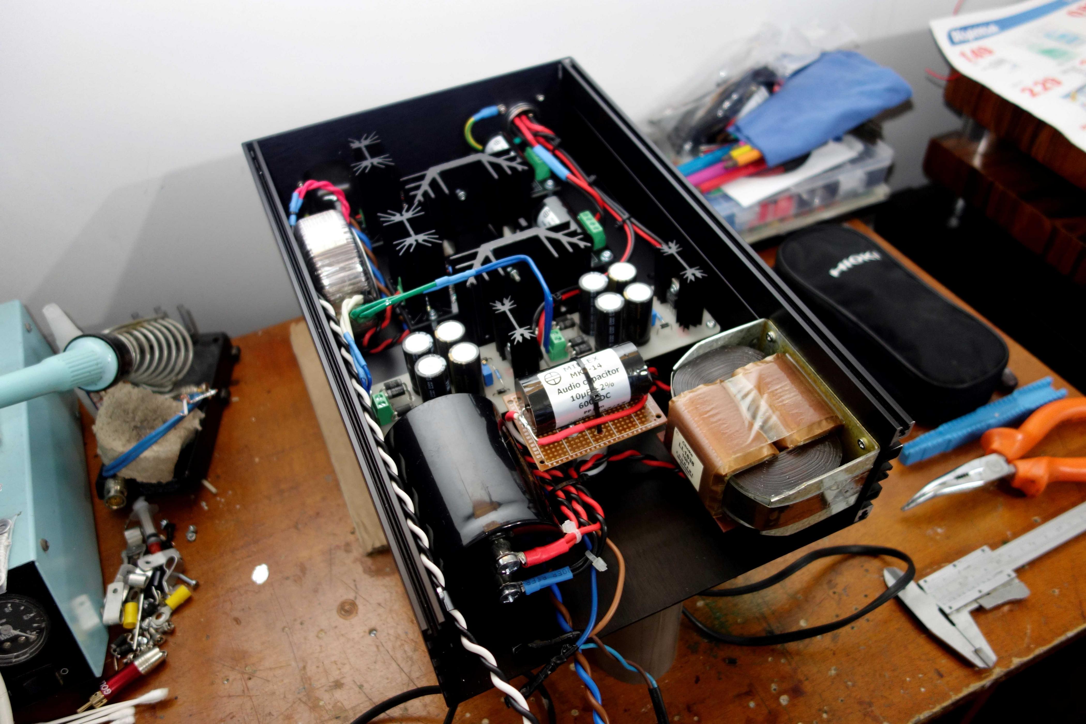

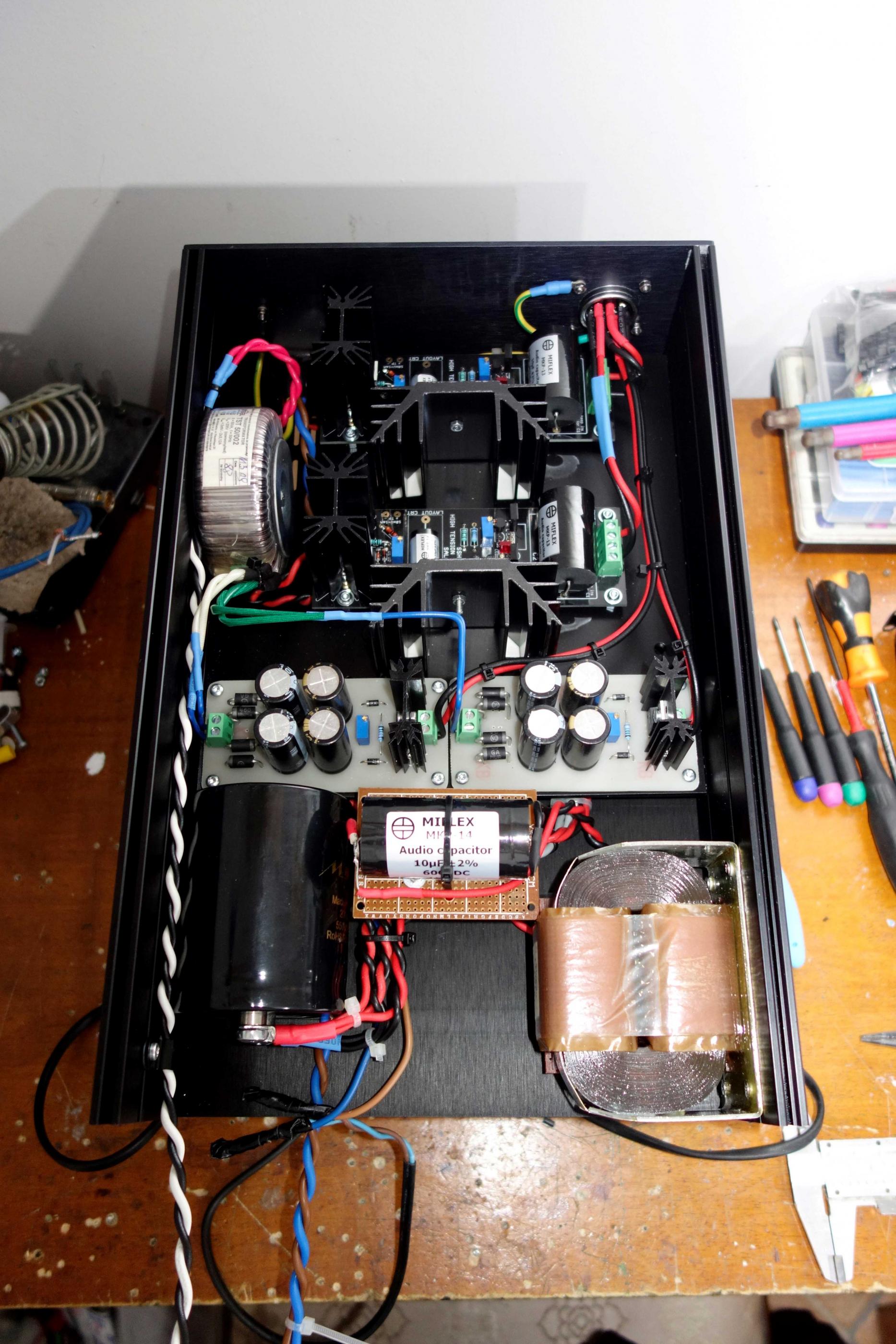

My configuration is as follows: tube power supply with rgn1054 telefunken, separate transformers for B + and heaters, voltage filtered by capacitor and cocke lundalh and then stabilized with 2 Salas shunts, one for each single channel, aikido have 6dj8 and 6cg7 valves powered at 200v B +

I am not sure what heater voltage sounds best, but if you want regulated 6.3VDC off 6.3VAC winding I see two options
- valve rectification into voltage doubler and then regulate down to 6.3V - this is the approach implemented in at least some of Broski's boards
- shottky (low Vf) rectification into low drop out regulator
First approach obviously needs double the current from the secondaries. Second one is kind of more expensive in parts cost
Doubler might be the answer...
You'll get more than double, ~2.8x actually, because of the peak of the sine wave not the RMS.
From Broskie: V dc = (Vac x 2.8) -2V diode
No free lunch though: I out = I ac / 3.6
A voltage-doubled 6.3 will have a lot more than 12 volts so there's lots of headroom for the regulator.
Here's the thing, connect both 6H30 filaments in series (12 volts @ 0.9A) and both 6N1Ps, (12 volts @ 0.6A) so only 1.5 amps of filament current needed. So if the fil trans is rated at 5.4 amps or better, you're good to go. (1.5 x 3.6)
If it's a Hammond with a 5 volt winding that's not being used and the HT winding is under-taxed (likely) the 6.3 volt winding is probably good for a bit more current.
The other way, even with fancy diodes, a LDO reg. needs a bit more than 1 volt headroom, which you might not have.
Cheers, Steve
