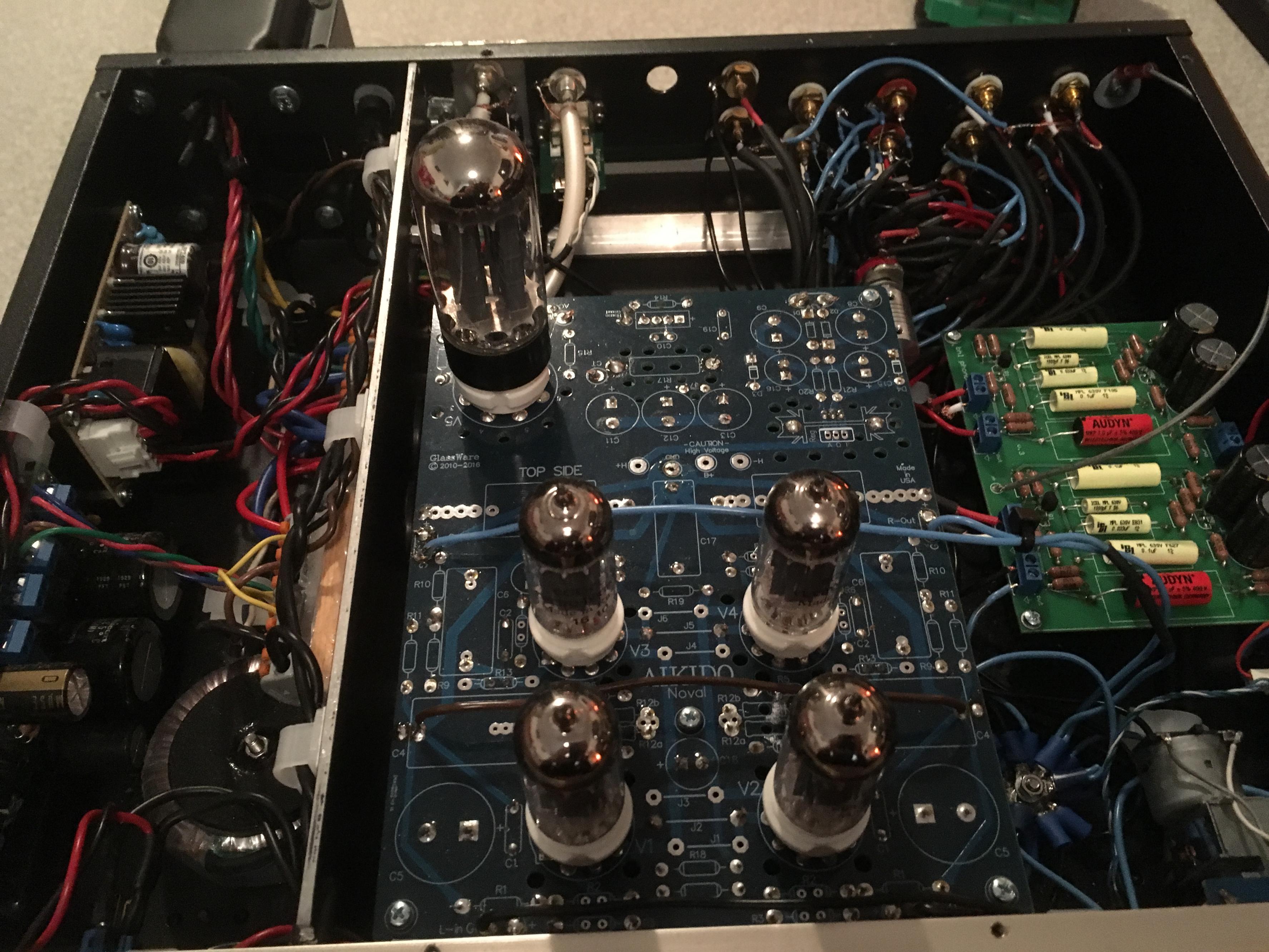

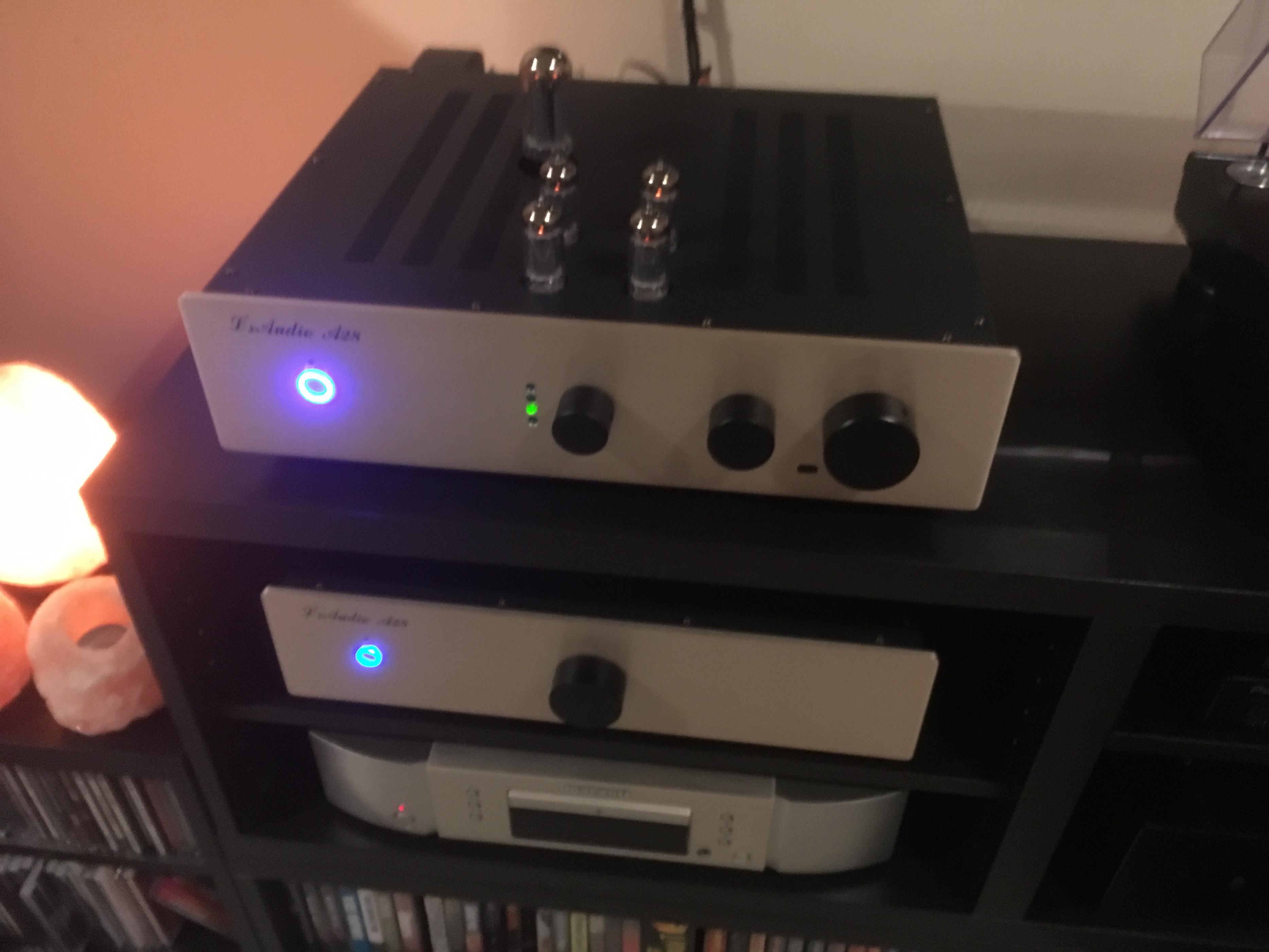

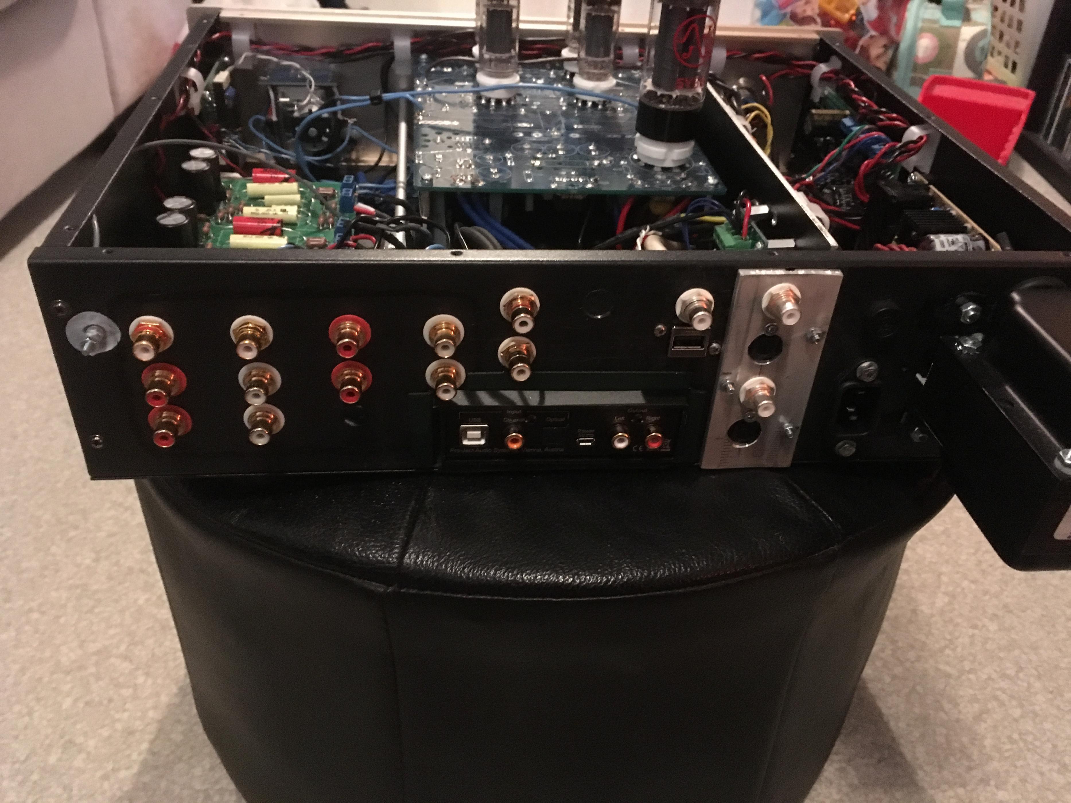

Here is my Aikido All In One preamp. The same box features Boozhound Riaa, Twisted Pear Audio 4: 1 Mux / Demux digital switch module, Pro-Ject Dac Box S2+ and engine-powered volume : D

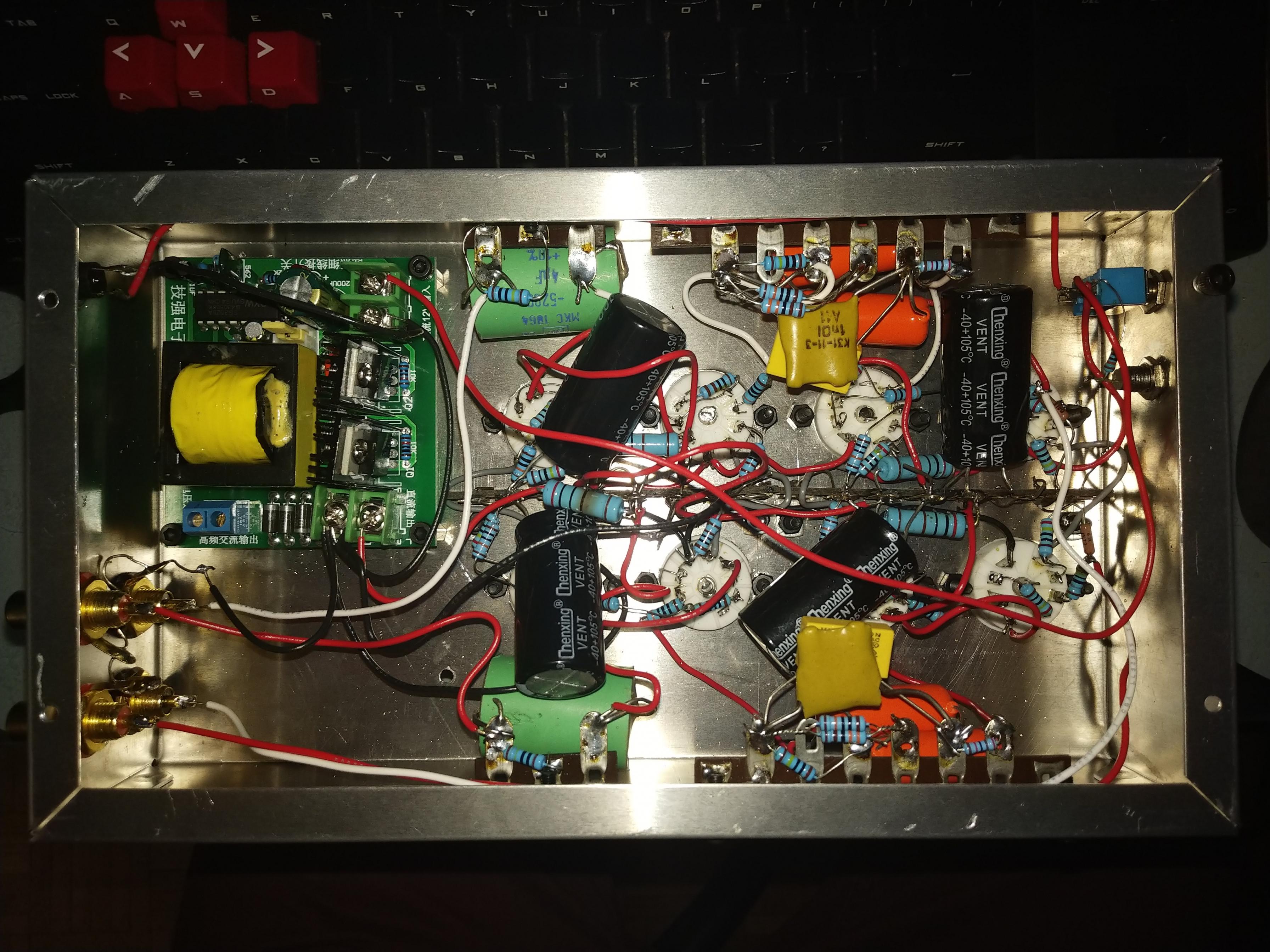

Here's an aikido phono stage I built. It's powered from 12V by a boost converter.
Kimmo, that's a very fine build you did. How does it sound?
BillWojo
Thanks!
It sounds very good, I had a bit of grounding problems, but now the device is okay.
The power amplifier I have a Hypex UcD 700 HxR and as speakers are Finnish 15" "Piste"-coaxial-Diy-speakers
