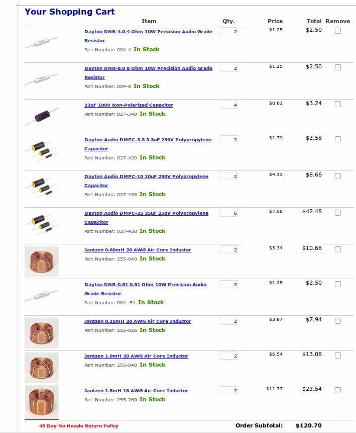

Not bad IMO....
The sim includes resistance of the inductors as listed in the cart. If the OP is willing, I would suggest upgrading "low L1" to the 15GA option from Jantzen. The rest I would just use the 20GA units.

That's $180 worth of drivers and $120 worth of X-over

What type of crossover is this? There are 4 crossover diagrams there so I'm not sure what the differences between them are.Not bad IMO....

All 4 diagrams are the same exact x-over, the first shows it with the tweeter with polarity flipped, which is going to be the way you want to run the system normally, the other 3 charts show each of the drivers being taken out of "normal" polarity from the rest of the system in order to show a proper droop that confirms that there aren't any glaring phase issues with the system when wired correctly.
I have been lead to believe that confirmation of the "dip" when wired out of phase is an important design aspect for speaker building/simulating.
The x-over is a 2nd order on both the mid and low drivers, and a 3rd order on the tweeter. Impedance correction has been applied to the mid and low frequency drivers (zobel) in order to improve the effects of their low pass filters.
I should re-arrange the diagram so it's easier to understand the wiring. I'll try to do that if you want?
