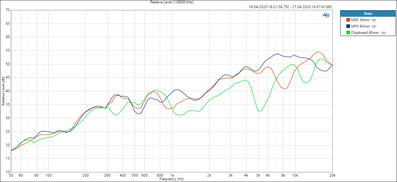

Is there a reason you're using Ply rather than MDF?
Its better. Way better for a woofer since you want to push box resonances up in frequency. MDF is a bad material for subs.Nite that if you were planning on 18mm MDF, you can do better with 15mm quality plywood. And if you mount the drivers push-push you could actually get away with 15mm ply.
If you use 18mm MDF you probably need twice as much wood as you would with 15mm push-push. I showed that clearly with the push-push SDX10 i showed in an earlier post, 15mm, i’d double the top now.
dave

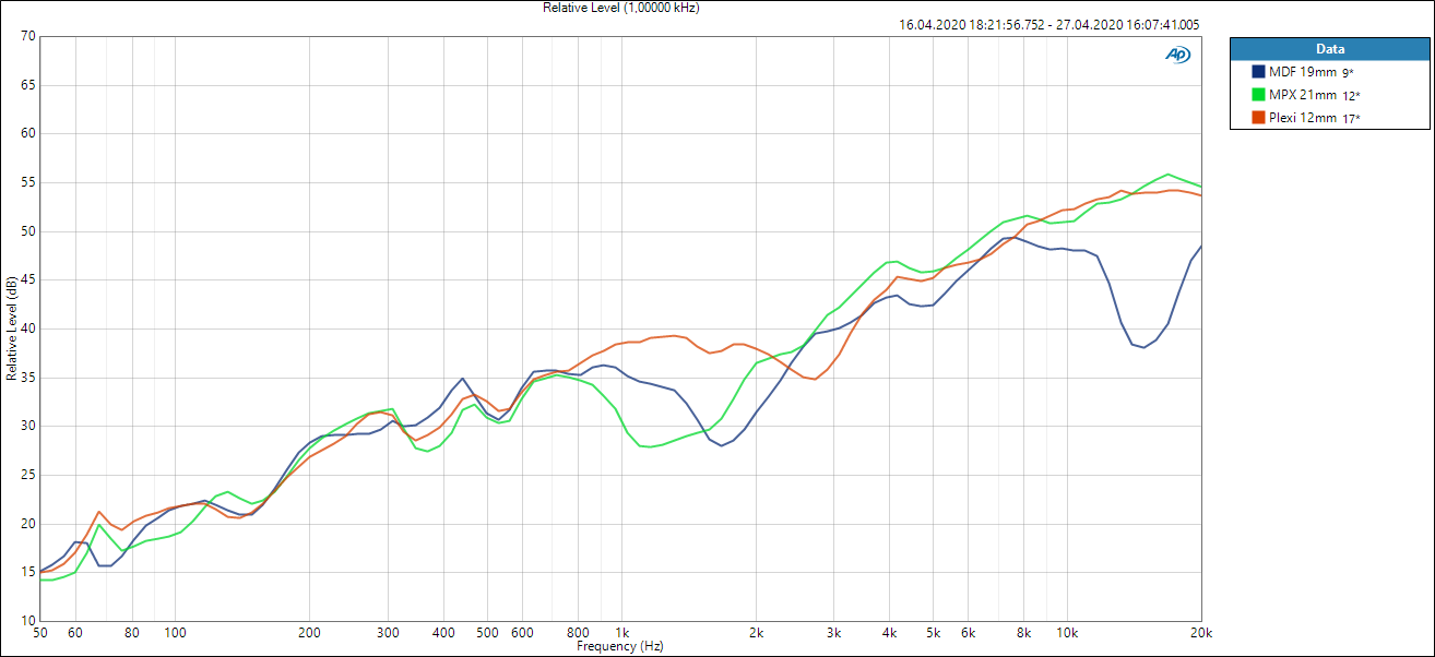

Plywood is a way nicer material to work with. And way more sturdy when things get wet or thrown around (PA). But in terms of acoustics and sound transmission ... look yourself:
These materials are way more similar as different.
"Impulse compensation" works very well, way less vibrations on the cabinet. Even when not done perfect (= connect the magnets) it helps to reduce vibrations significant.
