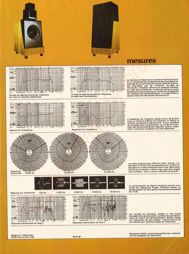

https://www.audiovintage.fr/leforum...cs.net/pics/226606kef105212001600vertical.jpg
Seems to have good low extension but falling of slowly. Understand that you want more level there.
Is this a closed enclosure or Reflex? (Tube at the bottom?) Looks like closed but frequency response falls to steep for that.
Do you have a measurement microphone? I would start with analysing what you have now - a good way to learn about acoustic measurements which you need anyways for a proper sub integration.
These speakers would also be perfect to redo as semi/active version. You can use your amp for mid/high and an active module for the low frequency driver. So you can adapt the frequency response to your room and likeing and get more precision and get rid of the lf frequency divider parts. Or get a 2 way module and feed both with the same amps. From the measurements it seems like there could be a little to much 1kHz in the room but looks pretty good everything else - worth a try. And of course you could do proper limiting to protect your speakers.
