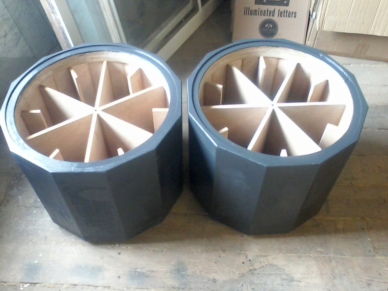

A great choice of driver and size, and enclosure type and Qtc. Instead of starting with the worst-shaped box possible (cuboid) and 'fixing it' with bracing, you could save yourself a huge amount of time, money, materials, and weight by building a multi-sided box. This pushes the resonances way higher than your passband without adding lead lining, which simply pushes them lower - the last thing you want...

Do you mean something like an extruded hexagon?
18" subs, 55l, reverse mounted drivers for cooling. First major panel resonance is above 400Hz and entire speaker can be lifted - just! - with one hand. The enclosure is invisible, acoustically, to my ear compared with the cuboid prototype.

@MrKlinky those enclosures in your pictures look fantastic, but they also look like a level of skill and time went into it that I am not sure I have posses right now and it's basically a totally different design. Did you document that particular build? I'd like to read about if it you did.

All the work on these Mark II's was done on a Triton workstation using only a 9" circular saw and 1/4" router and a couple of simple jigs; I suppose about a couple of weekends and a couple of weeks of evenings. Once a few tricks were learnt they are really not that difficult. I did not document the build but will dig out the few photos I took of the build. I'm very lazy in documenting stuff...
The Mark I's were kerf cut plywood cylinders which I was never happy with and the 12-siders are easier to build in most respects. I am also building 4 x 21" versions using RCF drivers which will have a face width of 150mm and a length of about 600mm built in 18mm ply. I used 1" ply on the 18's pictured which was complete overkill, and the six new Mark III 18" enclosures using B&C drivers are made in 15mm birch ply which still has its first major resonance over 400Hz. Each of the ten subs has its own dedicated amplifier.
