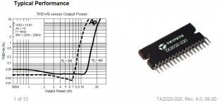

Basic tripath, with some decent components

Running the tweeter and woofer together will net approx a 4 ohm load, and will output 15 or so watts per channel. Even at 8w RMS that is only a 3db decrease which is above my 107db requirement 🙂

Just curious, can't you get same woofers (or equivalent) in 4 ohms versions?
That way you'll get 15W RMS out of each of them.
Note: if you want more usable *clean* power, you may add , say, a TDA2003 chip amp and biamp a "real" (meaning VC and magnet) Tweeter.
I do exactly that in my commercial "Callejero" ("Street Guy") amplifiers, powered from 12V 7A batteries.
Loud and clean .

About size, with a single TA2020, and 2 x 8 " , each in a ported box of about 20 l (2/3 of a cubic feet) Amplifier and battery in the middle. Battery charger external. Goal is something around 75 x 25 x 25 cm (30" x 10" x 10").
