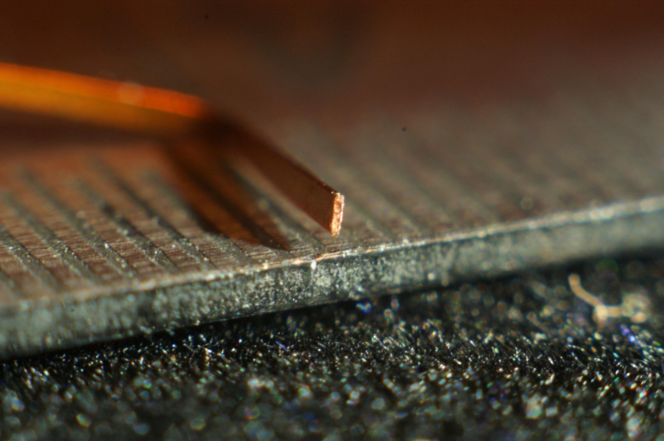

Ok, the wire showed up this morning. It is a 4:1 ratio flat enameled OFC copper, 30ga.
I got a whole 11ft of it - all they had.
It looks very promising.
Okee dokee. Sony A350 DSLR in full manual mode, m42 adapter, pentax SMC 1.4 Super-tak stopped down to 8, with 3 extenders and a 2x multiplier, with intense direct lighting.....that's what it took to get a shot of it. The markings on the ruler are 0.5mm.
Even on it's longest diameter, it is no greater than about 24ga (0.511mm, in width, which means the skin effect region is north of 100khz), and in the other axis, well, 36ga or thereabouts, so 1Mhz+. What this means is a stable and wide complex z bandwidth, that round wire or Litz cannot hope to match. I find Litz windings, multi-strand windings, or any multi-ga windings to be very..uhm..grainy sounding, at best. Not counter-intuitive, just not generally well thought through.
We are looking for complex harmonic systems to be presented with a low z, of wide stable bandwidth, with the least disturbance and most linearity in all complex aspects of 'in situ' expression. Round or litz both fail in comparison.
This moves more toward 'best simple approximation of a complex ideal', which all others cannot hope to match.
