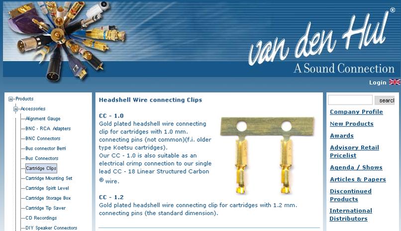

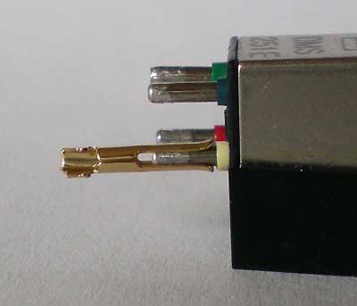

What is the required pin diameter for a phono cable cartridge clip ?
Any DIY clips project available ?
Best regards,
Bins.

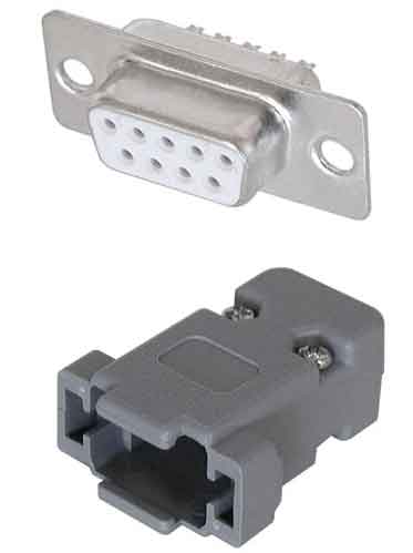

boyz at Vinyl Engine gave one good tip - find any D-sub (female ) connector - 9 or 25 oin , dismantle it , and you'll have plenty of cartridge clips .
tip: old printer or mouse or serial port ...... I can't even remember which one is female :rofl:
Hi Zen,
Is that of the standard size ? Will that match all the carts ?

yup
pic from VE
I tried - works like a charm

I searched a lot on the D-sub (female ) connectors. Found some really promising info on that. The pins are directly available for purchase: CINCH
Is that the one that is really needed ? Please suggest...
Best regards,
Bins.
maybe is faster to find any old cable with this ( or 25 ) ;
in 25 ones you'll find several unused pins ...... with unused - I mean clean , not soldered .
they all have gold plating

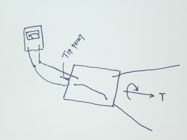

talking in home make tonearm cable, I didin in different way, and don't cost much money too. I use Belden silver coated hook up wire 24 awg (7x32 stranded) cut the length 10% longer than the cable you want to make, similar item from other brand's make also ok. take the teflon tube off and separate all the conductors (you will have 7 conductors of 32awg) take 4 of them and use fingers and nails to make it straight.hang them up and add some weight at the bottom ends, coat them with clear polyurethane, thin coating with more times is better and make sure coating is around of the wire not half side. after complete dry check with multi meter of the isolation. next step is twisting, but make a small tool first, a piece of card board as show in the picture, drill 4 holes and add a tip indicator in the front centre for moving each twist in same distance. hold one end in the table and hook up with multi meter for checking no shortage in each twisting also with a lightly tension too. after two pair is done twist again with the twisted final wrap the piece up with thin teflon tape which you can buy from pumping supply, before for use it need to break in load the out-put end with a 2K resistor, connect the in-put end to a radio line out,use radio signal 24 hours a day for a week or two will be enough,I did mine in 4 feet long, direct from cart to phono amp's in-put as long as the twist is tie enough there will not pick up hum and no shielding is needed, you will find this project give your system a big jump and only with little money.
happy trying Tony Ma
