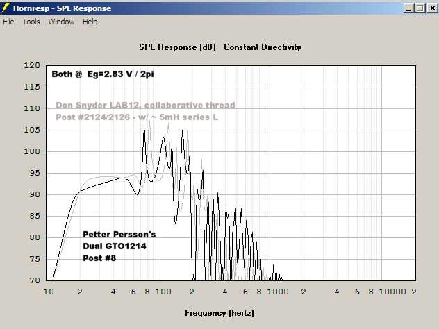

The JBLs have a lower resonant frequency at 28Hz VS the DD 30.3Hz which can cause issues. Also the sensitivity is 5dB lower at 85dB VS 90dB of the JBL (at 2.83 volts) Since DD did not put the sensitivity spec at one watt, I am assuming it is 2.83V. It won't go as low or be as loud as the JBL at the same power input levels.
The Kraken is tuned at 18Hz which is very low for a DD to be tuned, I'm sure it can withstand being pushed that far down but the cone travel will be used up trying to get the same SPL as the JBLs.
Another option to entertain is what would a JBL GTO 1514 do with the design as a single woofer. It has the same output as two 1214's and the 15 incher has a Fs of 25.1 Hz. Could the design of the Kraken be modified to run a 16 Hz tuning with a single 15" JBL? It would have to be wider which would help with stability but I'm worried about compression on the cone. The 15" version looks spec wise about the same as the 12" with the same voice coil diameter so the compression ratio might need to be dropped down.
One of my games with Horn Response is to play with the Kraken design--if I'm going to modify something, knowing that it works at a very high level is a great place to start. Model a single 12" and a single 15" and calculate size/weight and see if the 15" could handle a 17 or 16 Hz tuning. I was not smart enough to cut wood before the cold weather came so it's a good excuse to become proficient with Horn Response while the cold winds blow and freeze my wood working area.

What is the compression with the Kraken series? I plan on playing around with Horn Response this winter and will attempt a 16Hz tuned single 15" version. Since 12 inch woofers can handle twice as much compression, I'd like to cut that in half while playing with the Horn Response sliders. The single GTO 15 has the same efficiency as two 12's and a lower Fs--a 16Hz tuned Kraken could be possible (in theory) but I'm worried about the compression on such a large cone.

As far as the LAB 12 VS the Kraken single, the LAB is slightly shorter but deeper and not tuned as low. It would be louder than the Kraken single but I want the lower tuning for pipe organs and the like--the LAB 12 won't do that. If I need more output, just build another Kraken single--can't tune a LAB 12 lower so I'm going low first and will add more when (if) I ever feel the need.
