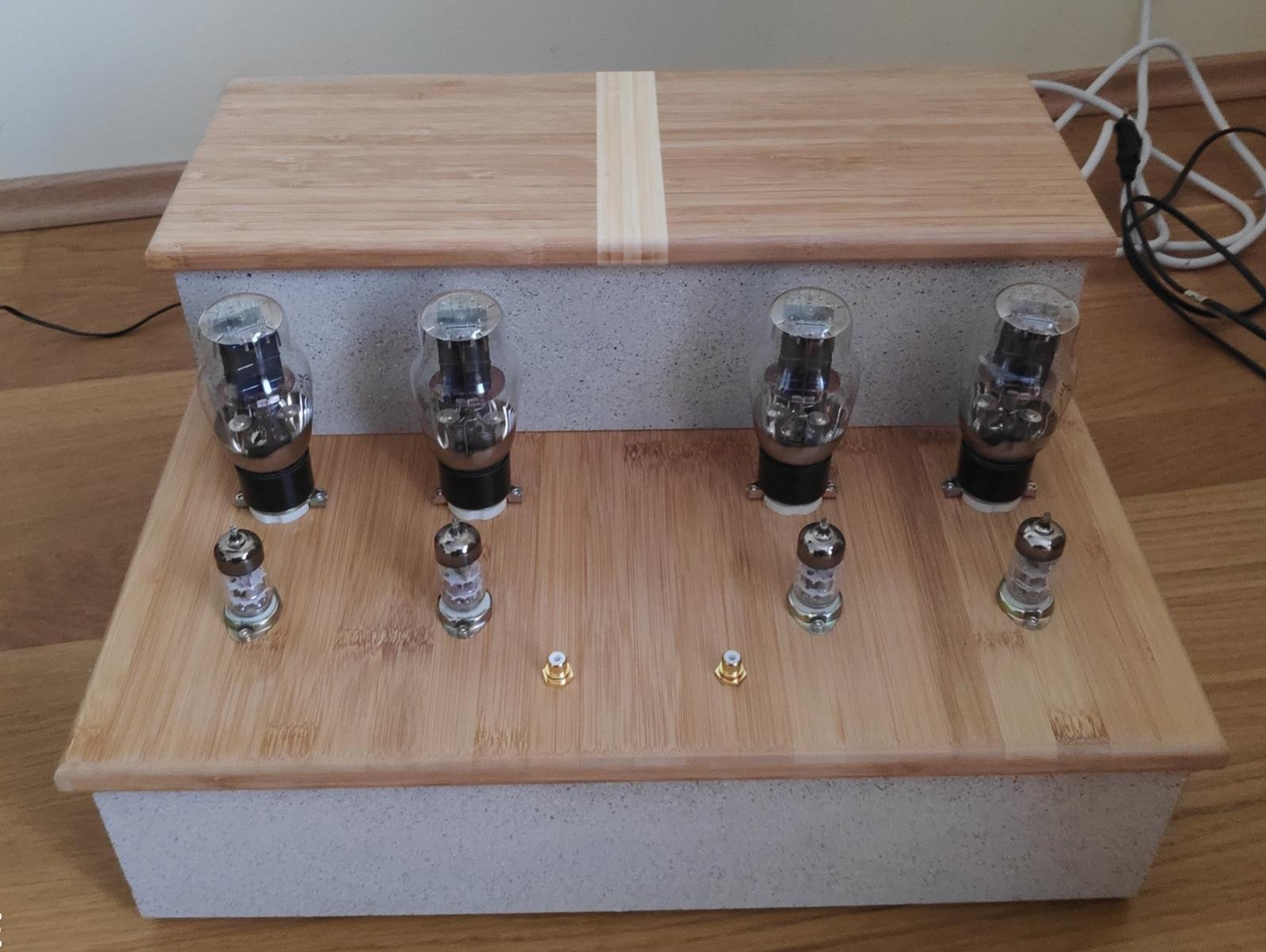

Hi all, I was wondering if there are any serious tube amp builders out there in Europe(i'm located in Belgium), who accept build to order for push pull amps? I have a pair of Tamura transformers I would like to put to use! Much thanks for any info! cheers!
Hi, Thanks!
fairly new here, since i got some time on my hands, i would give this a go! 🙂
i was thinking about a 2a3 in push pull
i have some Tamura transfo's (f-7021), those are 5K if im' correct
and i have a preference for "less is more" 🙂
cheers, filip

I see no reason why the owner can not use 2A3 tubes in push pull to drive the Tamura F7000 70 Watt output transformer.
At least it will not saturate.
And at least with 5k plate to plate, it can have a damping factor of about 3.5, even without negative feedback, when used with the 700 Ohm rp of a 2A3.
5k/4, then /350 = 3.57
