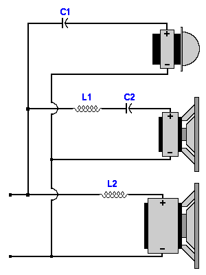

I want to raise the frequency at which the mid takes over, as it's really just a big tweeter and not a fully purposed midrange driver.
Since you haven't made your order yet, I'll change the component values to suit 2,500Hz and 6,000Hz crossover points. Remember that first order crossovers have shallow slopes so allow a degree of overlap between the drivers.
C1 = 3.3uF; C2 = 8uF; L1 = 0.2mH; L2 = 0.5mH
I stress that this is very much an ad hoc crossover arrangement! Should it prove to be unsatisfactory, you can revert to the original crossover arrangement, but with the advantage of now having different capacitor values to experiment with. 😎

For crossover points inductor values would be L1 = 0.2mH; L2 = 0.5mH.

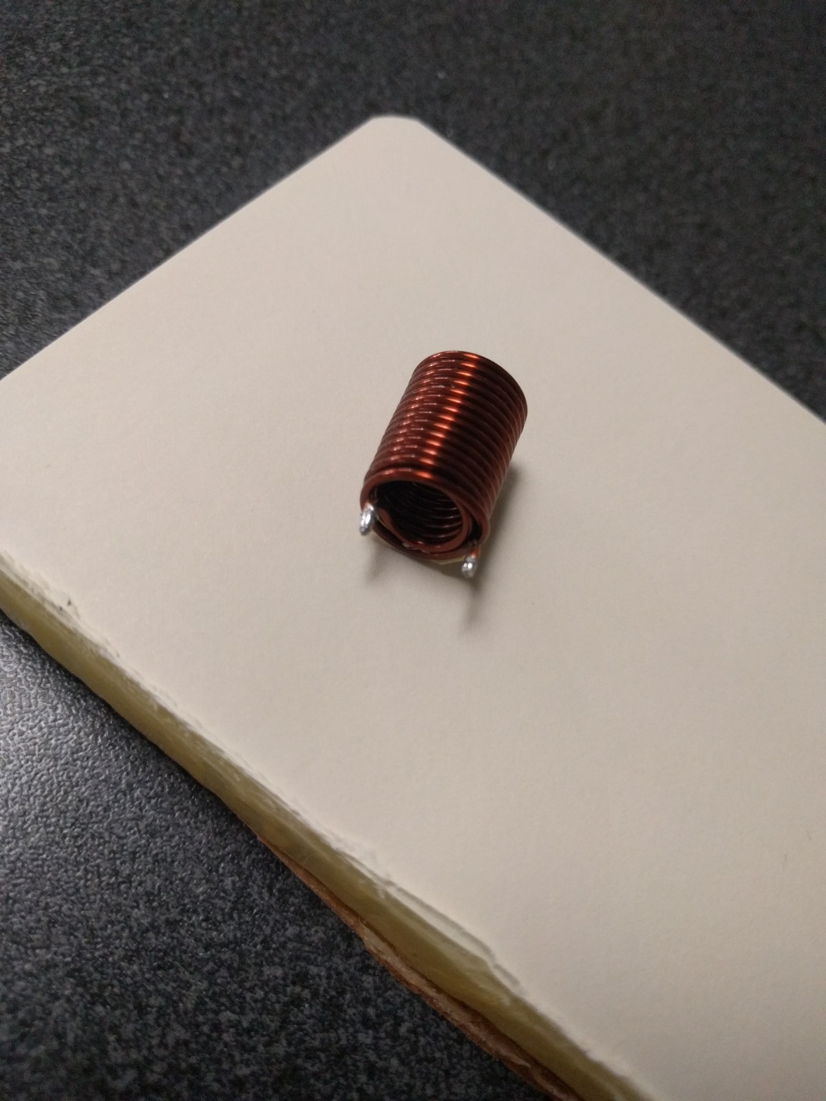

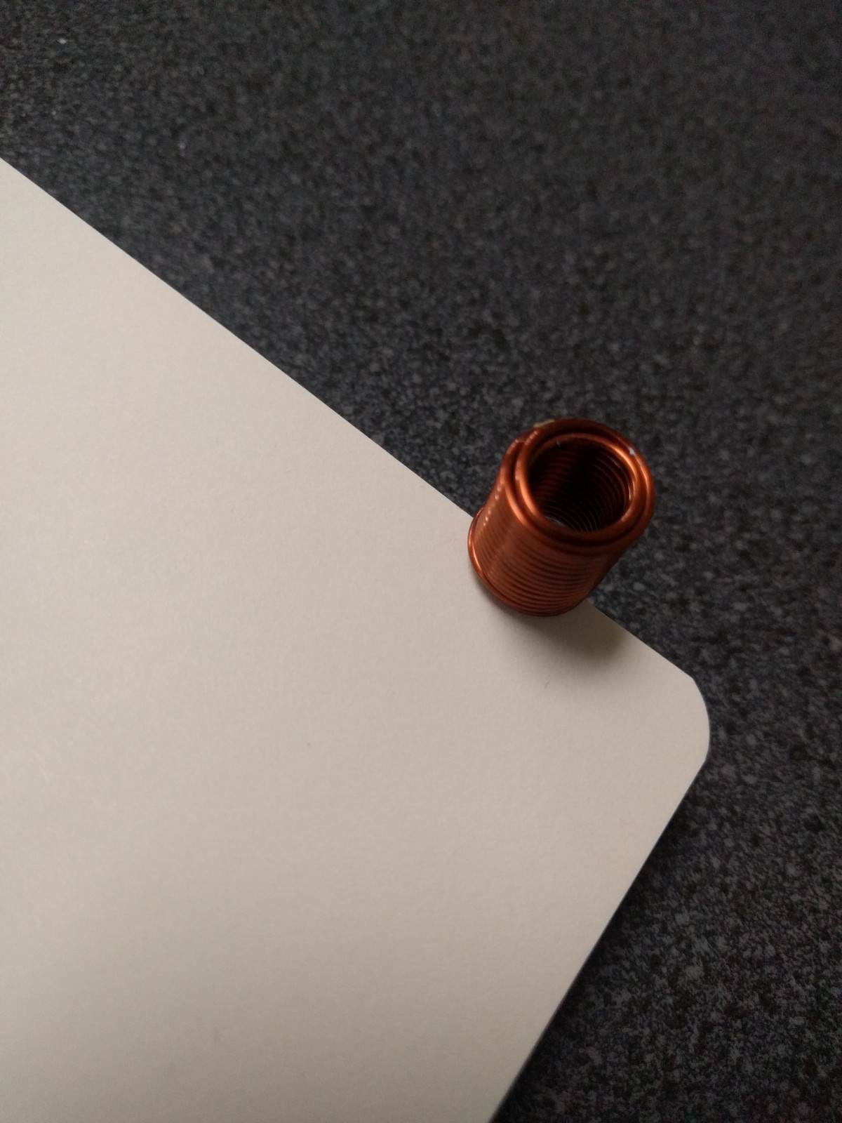

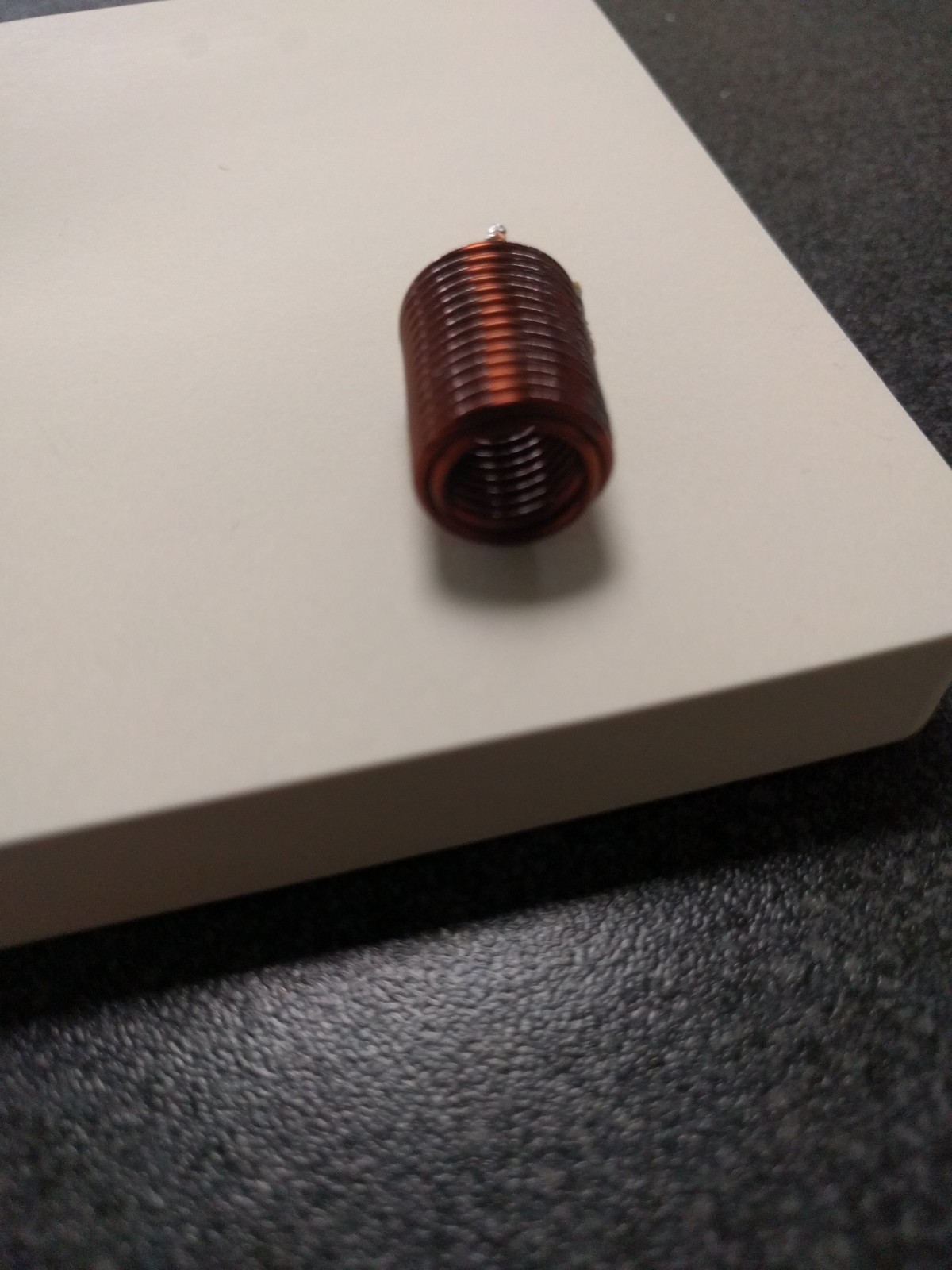

I've held off so far on purchasing the parts because, I needed to assess my cap & parts needs for 3 other sets of speakers, and I was only able to recently harvest some air core inductors from written off Amp.
My meter may not be up to measuring Inductors.
It thinks they are resistors and returns an average value of 0.26 Ω
Is that insufficient in assessing these Inductors?
thanks Cliff 🙂
You got these inductors from an amplifier? 😕
These are unlikely to be the same type of inductors as used in loudspeaker crossovers - perhaps you could supply an image?
If your meter correctly recognises known loudspeaker crossover inductors, then the components from the amp may not be what you think they are.
P.S. For this particular renovation, I would purchase inexpensive components such as NP electrolytic capacitors and ferrite cored inductors. These particular speaker drivers will not benefit from expensive crossover components. Besides, we are only experimenting at this stage, so cheap components are the order of the day.
Here are some photos.
These are 17mm high with a 12mm diameter.
I already have the caps.
Poly caps came to aud$40 but already in my possession
Air core 21awg Inductors would be a further aud$19
Leftovers from previous projects.
Is $59 too much to tip into the Silcrons?

The inductance of those inductors is so small that it is not registering on your meter. They are probably in the microhenry (μH) range.
They are therefore not suitable for use as loudspeaker crossover inductors which are in the millihenry (mH) range..
Until we have arrived at a crossover configuration that works satisfactorily with your drivers, you should only use inexpensive components.
Once the final component values are arrived at, you can decide on whether you wish to use better quality components.
I'm regarding this renovation as an opportunity to educate you on how simple crossovers work. Some alteration of component values may be required when you try out the crossover in practice.
Lay your expensive crossover components aside for now.
