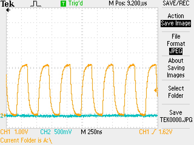

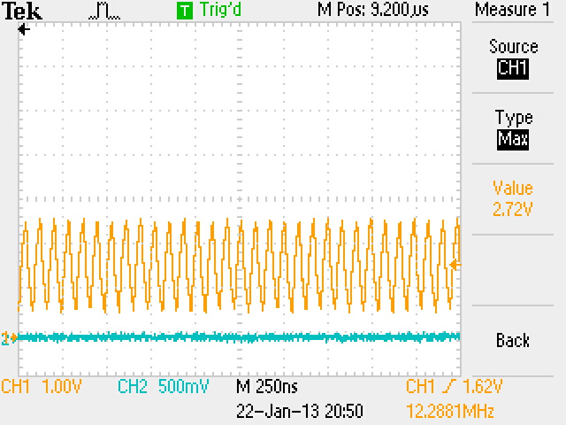

Fed a 1.9V 5MHz square wave with 2V DC offset to the CLK input of FF, output from Q. That prove all wiring correct. But still not output when connect to oscillator????

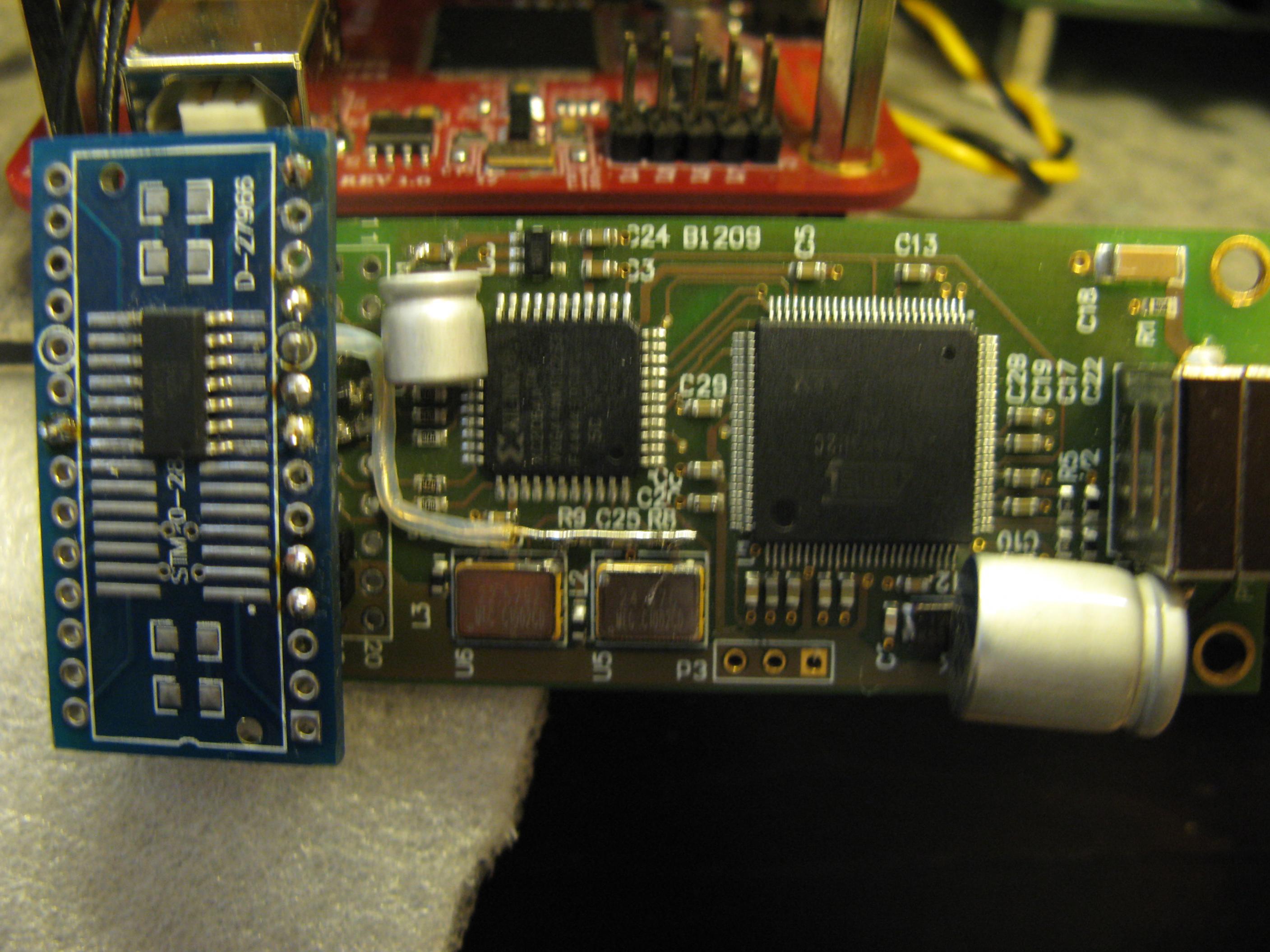

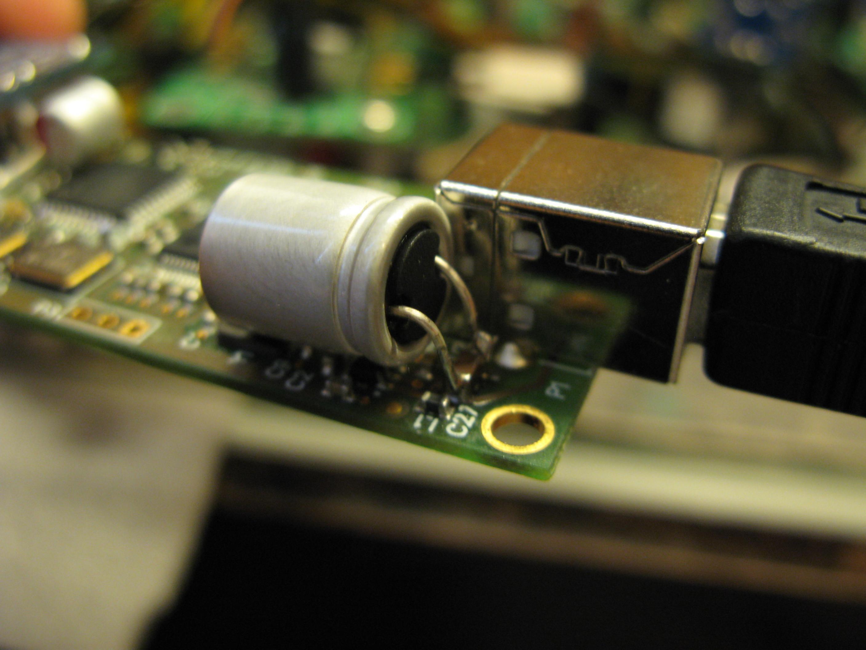

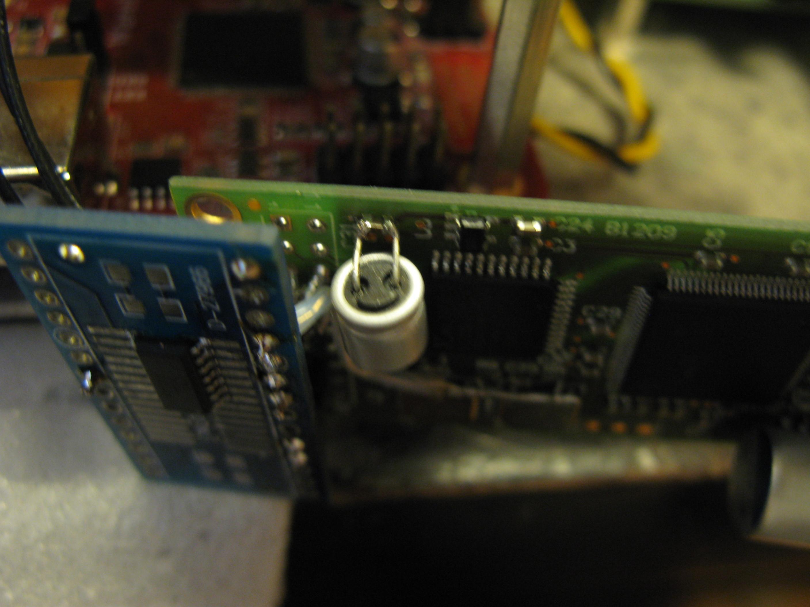

I've measured the 3.3V and found very high level noise. Followed your Mod and added two capacitors at the input of the LDOs. Noise reduced significantly and SQ also improved. But the FF still not work😡
Good to hear about the caps. But sorry to hear that the FF is still not working. Have you measured the clocks without the FF connected? There is no way the clocks have such low voltage if VDD is 3.3v
The clocks are the same with and without FF😕

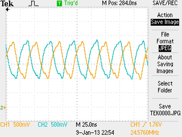

Checked the SPDIF with scope and all I2S outputs have signal with either USB through backdoor or optical. The frequency is much higher when input from backdoor. No data output from FIFO when switched to optical.🙁
Attached are the SCLK signals at SPDIF output.
Please show me waveform of all three SCK and WS and SD signals form S/PDIF board I2S output port when you switch to optical input.
