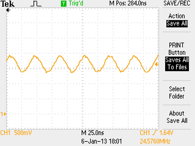

I follow HiFiDUINO to mod the clk of AmaneroAmanero USB Synchronous Reclocking H i F i D U I N O
The only different is I use 47R instead 220R connecting to the oscillator. No output at the Potato 74 FF. All the wiring are correct and when I connect the CLK pin of 74 to Vcc, Q has output. Seems the swing of the oscillator level is not enough to trigger the 74 FF. Can anyone advise what goes wrong?
I've tried 100R and 1K resistor and got the same result.
Is you VCC 3.3V?
According to spec, you need at least 2V in the signals to trigger...
How can that be? The clocks operate at 3.3V and output should be at least ~ 3.0V. Are you measuring the clocks at the input of CPLD?
