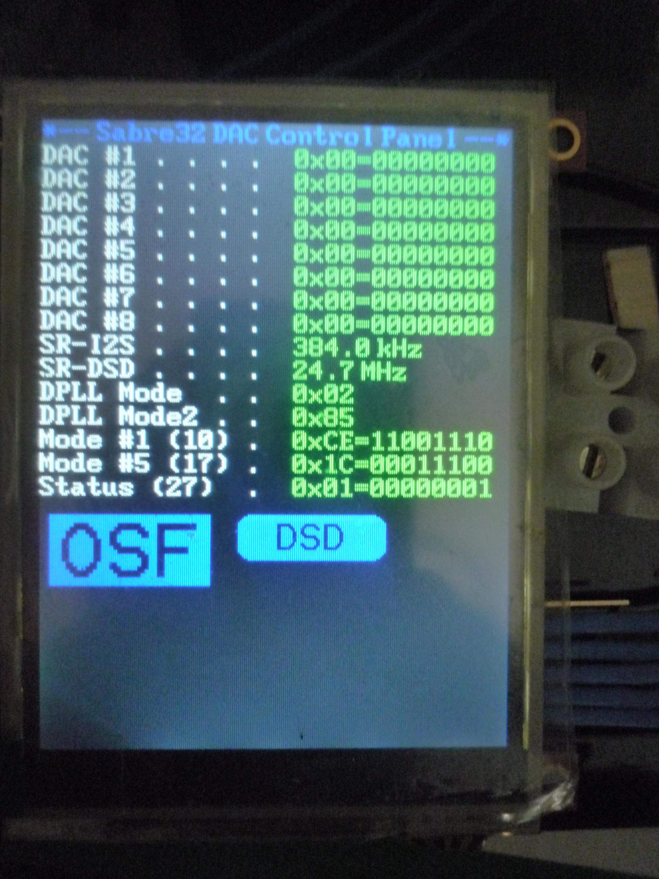

having an epson x-tal of 75 MHz and feeding my DIYINHK via an Amanero I've played my 1st 384 track just to see if it would lock on to it and play in the end and YES ... it locked, loaded and played instantly although at the end of the track it started to generate a lot of digital noise but that disappeared and stayed away as soon as another track started to play/stop.
I got the impression those higher rates (here 18432 kbps, 384000 Hz in foobar) were only possible with a 100 MHz clock ... seems it works with 75 MHz as well ... and sounds really good as well ...

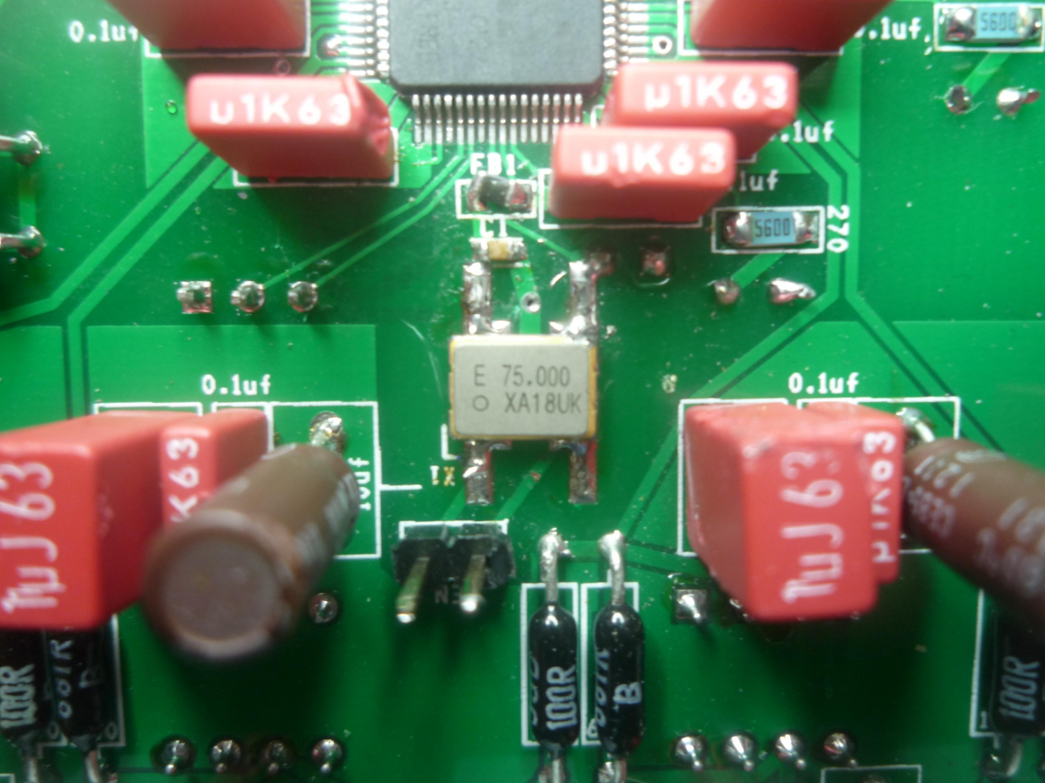

To those who manage to get a lock with Epson Saw 75MHZ oscillator, my build only manages 96khz and doesn't lock into a 192khz signal let alone the 300's. I don't have any termination resistors but am using a ribbon cable from the Amanero with ground conductors adjacent the signal.
If the issue is termination resistors, where have you installed these as there is no space allocated on the board for these.
Any other suggestions appreciated.
my board is using an Amanero with no resistors just some very short flat cables (appx. 2.5 cm) and DOES lock on to anything I have as a S/R. that is ranging from 44.1 to 384 and even DSD 2.8 / DSD 5.6.
It is recommended to keep the wires as short as possible ....

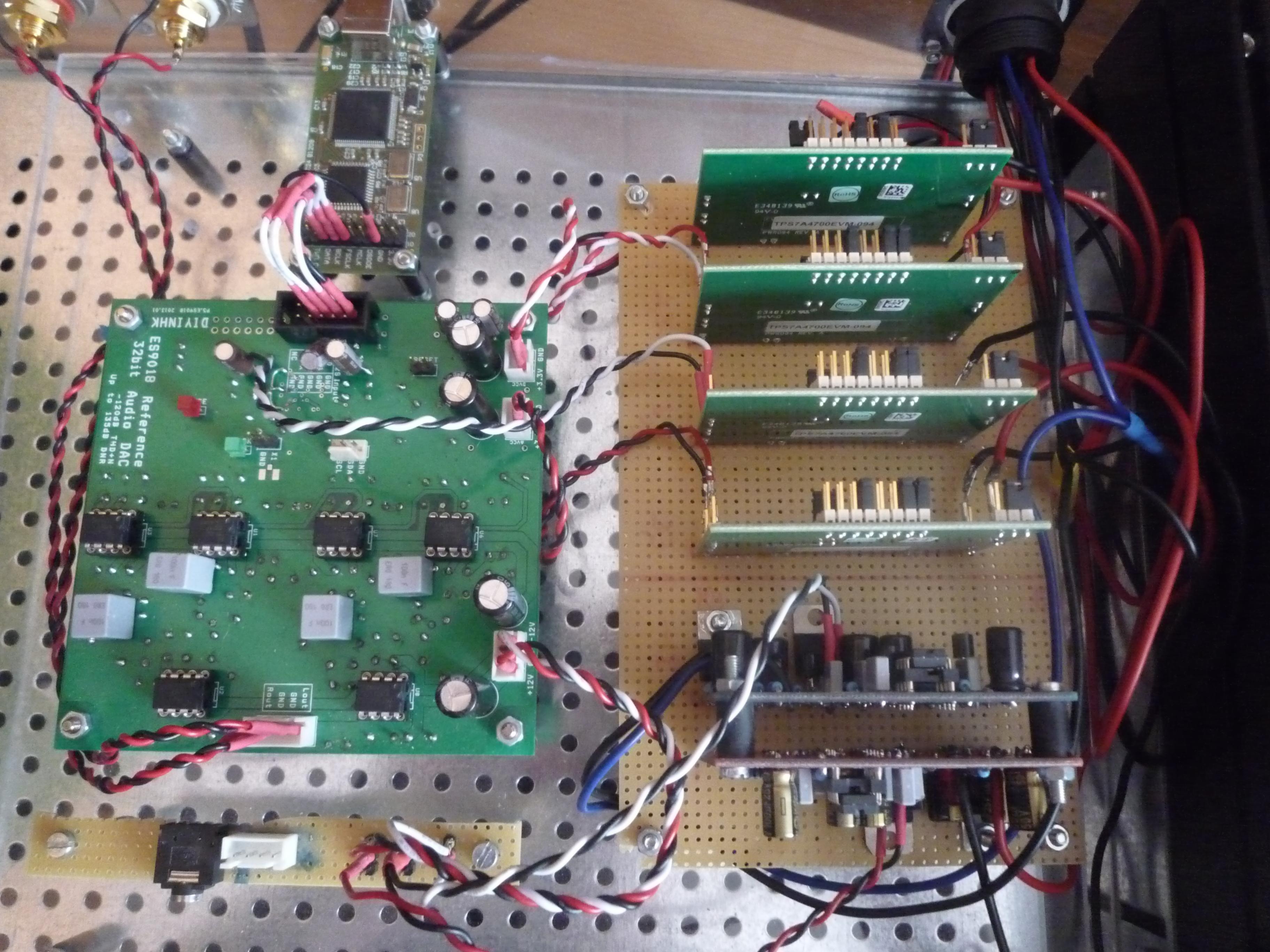

... using a epson saw 75 MHz as well ...
Plus, having a separate PSU for the A/V opamps, AD797 from transformator to super regulator for +12.41 and -12.40 V with 4x4700 uF in the rectifier units. As a super regulator I have chosen the SSR01 and SSR02 from Sjoestrom Audio.
Plus, a separate PSU for the digital part, again from transformator to the TI regulator TPS7A4700, using again 4x4700uF in the rectifier unit.
And modified the DAC board to separate the Left and right analog section to be able to supply again separated PSU units for left and right to the analog parts in the chip.
I have still a separate PSU channel unused, this is for a future expansion to separate the Amanero from computer USB. Plus for an MCU controlling the DAC chip using I2C and taking commands through BLE .....
I believe how well this board will behave is proportional with how clean your power supply and your assembly layout are. I have had very good results with Salas LV regulators(3x3.3v and a +/- 12v) after 2 LT1764 based pre-regulators. Similarly I used 3 TPS7A4700s with equal success. Your cables should be tightly twisted, flat cable to Amenero (or Diyinhk's) be at most 10-12cm.
I tried several opamps, and settled with all LME49713HAs. They exceptionally satisfy my taste..
Thanks Guys. I use Jung type super regulators (ALWSR's) in conjunction with TPS7A4700 for both DVCC and AVCC so it is a superclean supply. I can't see this being the issue with my locking problem. The I2S connections are 10cm ribbon cables with parallel earths so pretty clean in theory. Could it be that my Epson Saw 75MHZ has been damaged during soldering (too high a heat?). I have not connected a Arduino to this so the DPLL bandwidth settings are the default values. From the pictures there are no controllers in the set-ups you have so using default DPLL bandwidth settings too?
