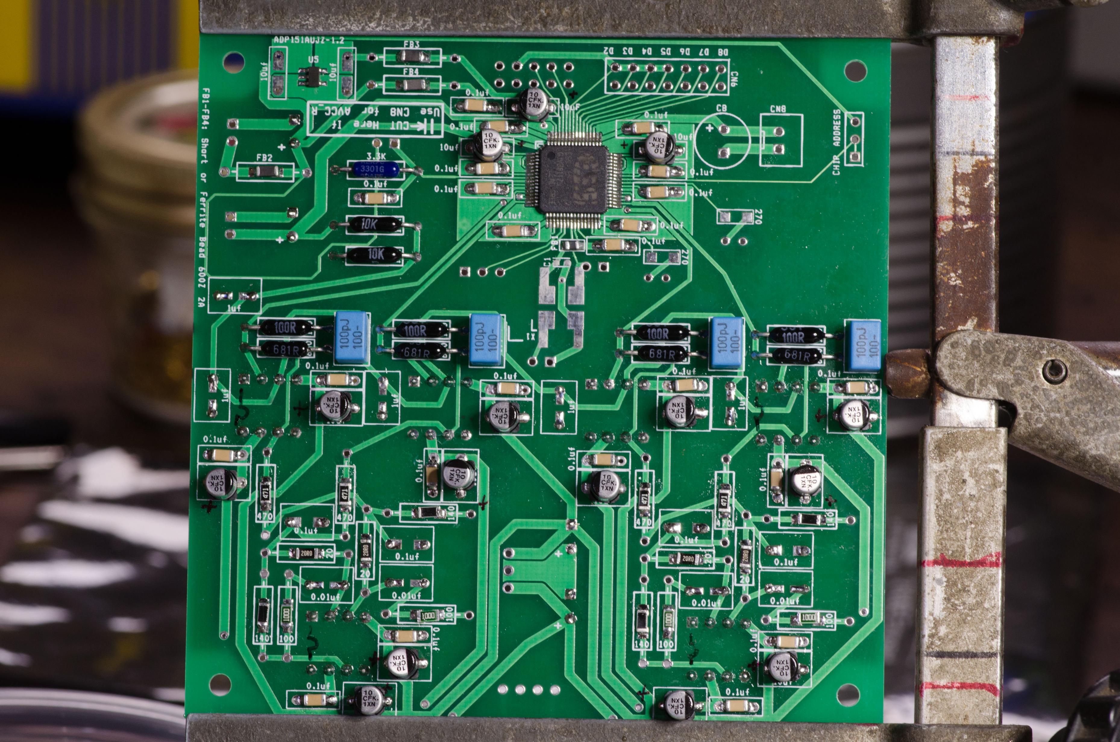

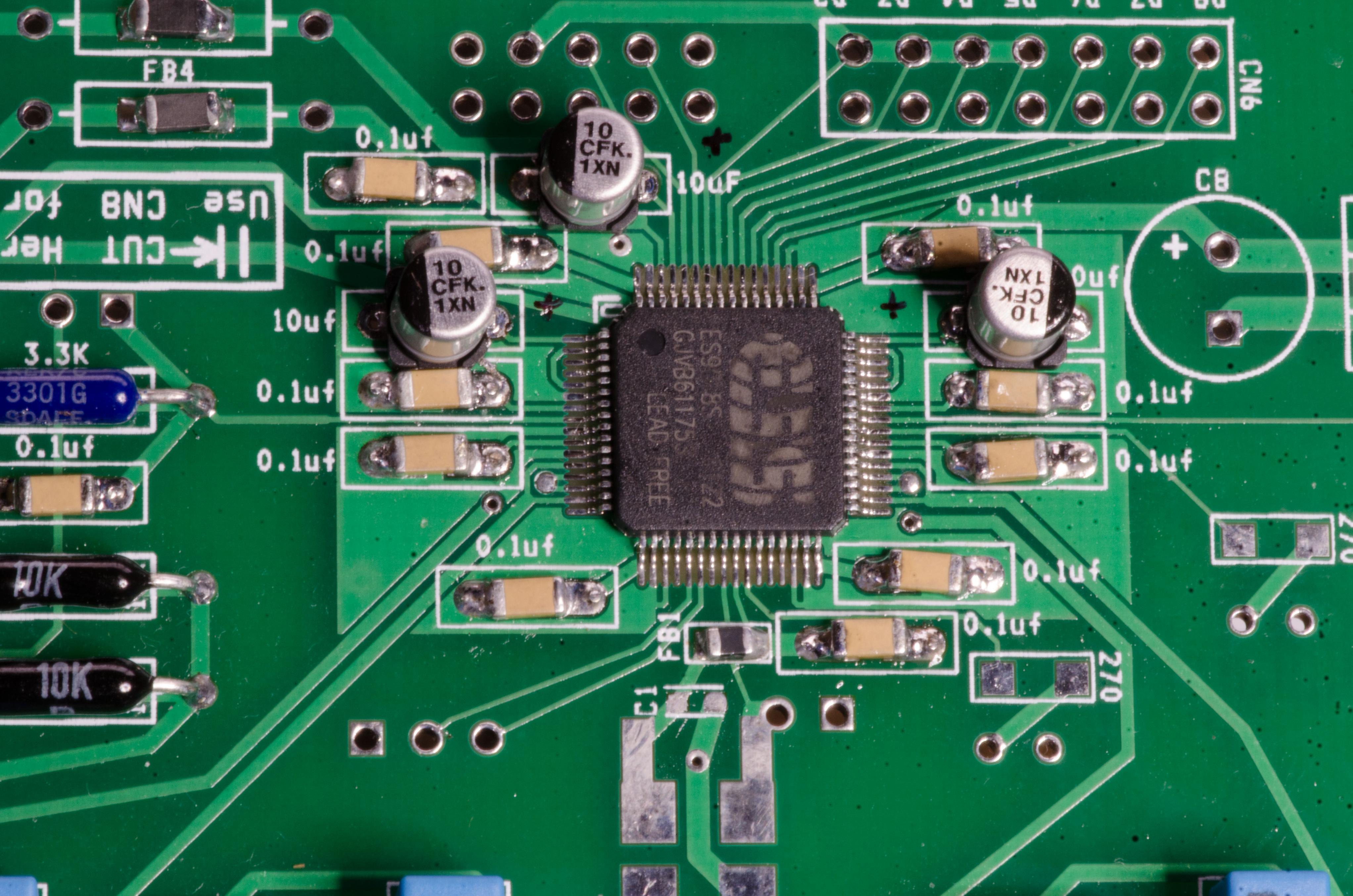

1) What are the polarities for the two 10uf caps to the right and left the 9018 chip ? (when looking at the chip/board printed side up)
I'm assuming these are bypasses for the two +3.3v psu's....so, negative to ground, for both...correct ?
2) I am also assuming the 10uf cap immediately above the chip is also a bypass for the +1.2v regulator....so negative to ground there too. (?)
I've figured out the cap polarities for the opamps...
Positive power pins..... (-) to ground.
Negative power pins.....(+) to ground.
I'm using some SMT package 16v/10uf electros' that will fit everywhere (4 mm Dia. x 5.8 mm L x 5.5 mm H)....even next to the 9018 chip. >>>>except for the ADP151 regulator, where ceramics are specified by the manufacturer.

.....checked the ESS schem.......my above assumptions are correct.
My fault for not seeing that.

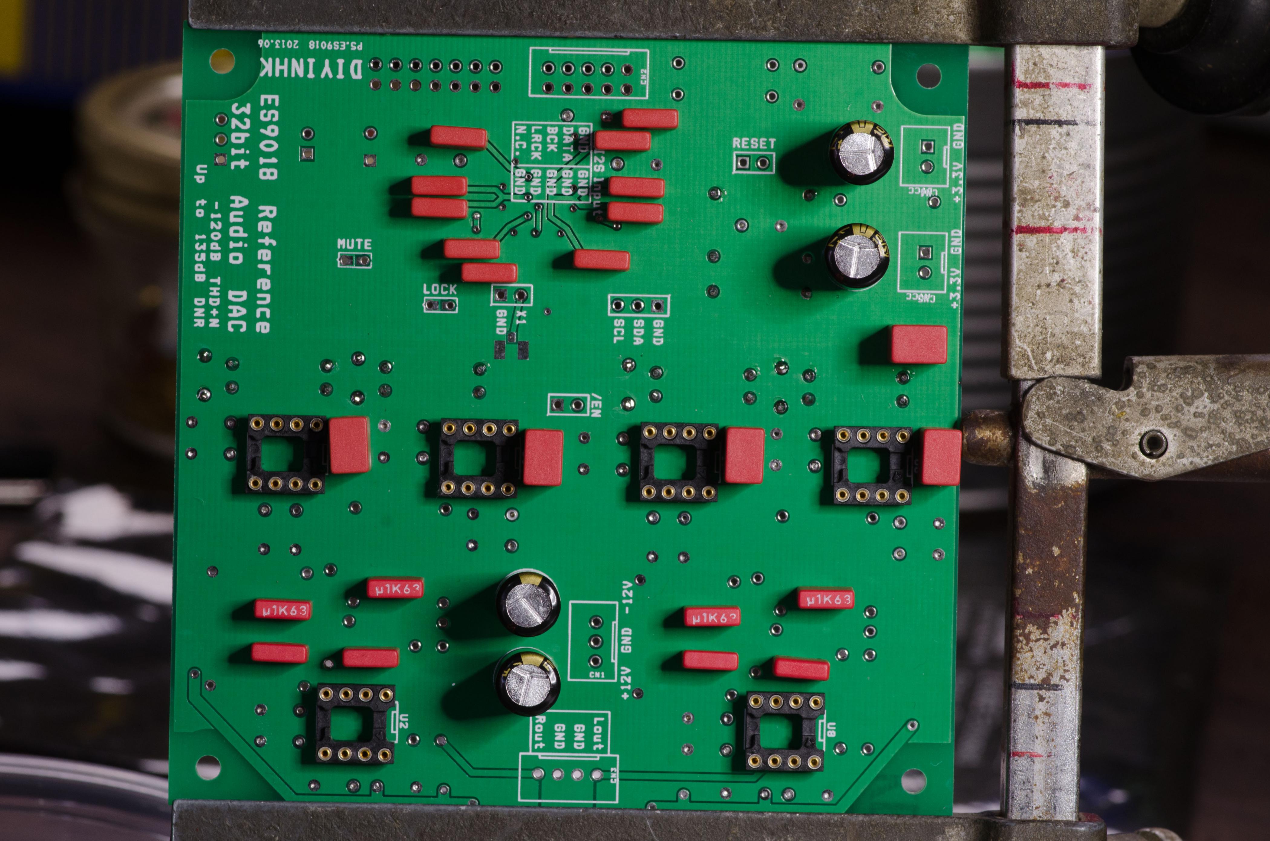

I've stuffed most of the board (see pic).

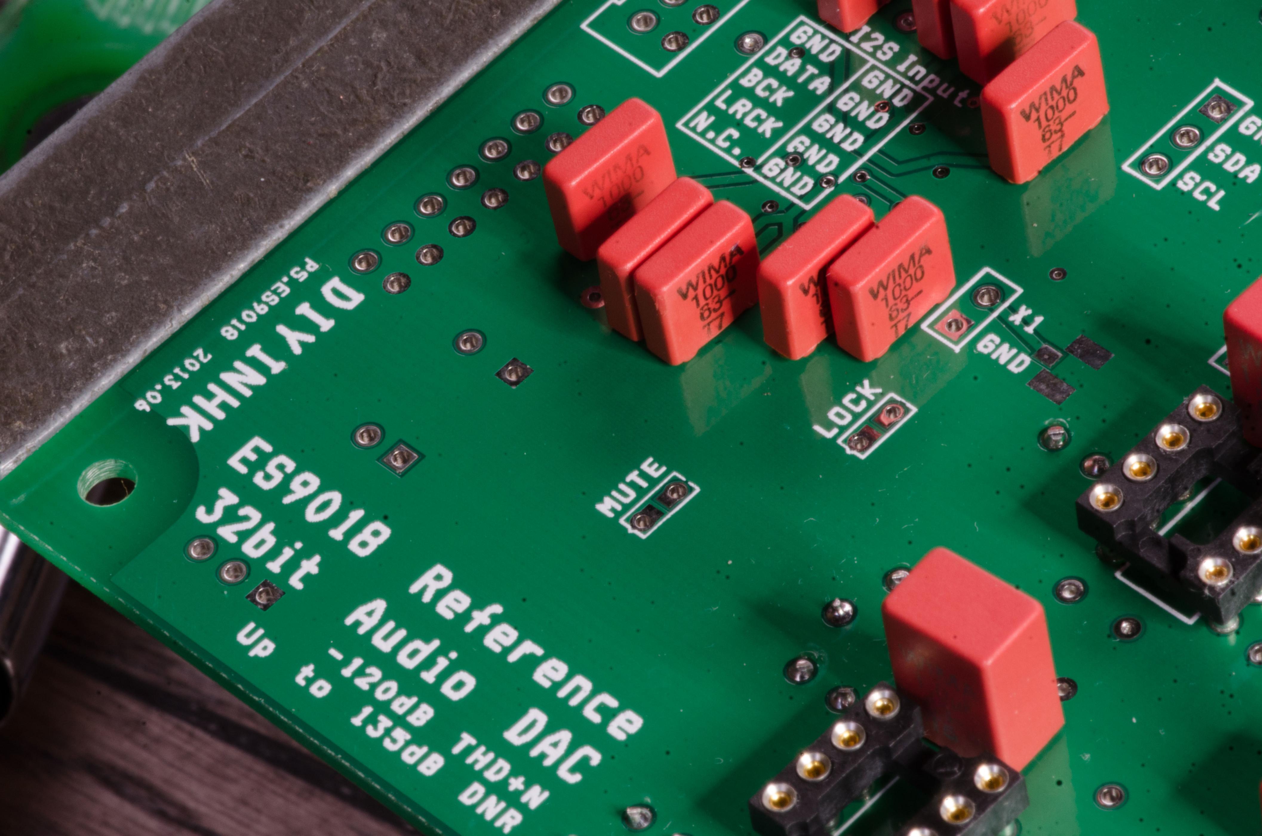

Not "stock" (tweak) are the 10n WIMA caps paralleled with the 100n SMD bypass caps (opposite sides of the board, around the chip) see pic.
(btw....this is my first time soldering SMD parts)

hello
i am building also the sabre 9018 from diyinhk.
i have befor the dac, a dsp with I2S connection,but there are a lot of connection,with other desciption,
so my question is can somebody help me to tell me the right connect,from my digelaty dsp I2S to the diyinhk dac I2S ,it can only
four connections be right.
i am beginner in dac and i think this is not the lightest dac .
i took a link on this post and so you will see.
the I2S is J5
i hope someone can help me
regards mennezoe
connect I2s right
ok glt
i am to stupid to copy the shematic,i can also write it.
cs dac -pic1
v+ -12v.
mos pic2
gnd gnd
spiclk pic3
mclk
dsp1
fs
dsp2
sclk
dsp3
data
dsp4
dsps
this isthe I2S connection of my dsp.
also another question.i read there are opportunities to connect,raw differential output, so may be some one can tell me wich points are the rights for left an right and gnd left and right.
so hope someone can help me
ok glt
cs dac -pic1
v+ -12v.
mos pic2
gnd gnd
spiclk pic3
mclk
dsp1
fs
dsp2
sclk
dsp3
data
dsp4
dsps
