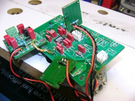

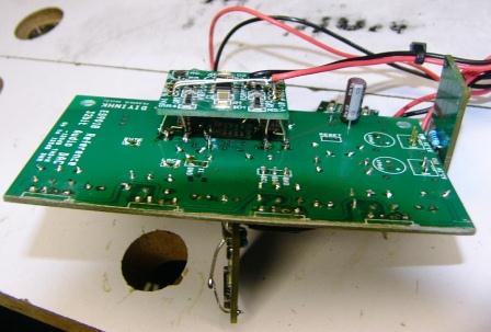

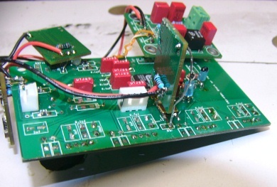

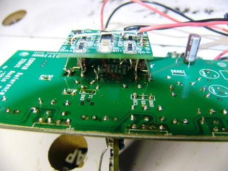

Here are some pictures of my V3 board using an older set of TP Tridents and AVCC module. I cut off the IV section since I am going to test this with a tube output stage using passive IV. I did run it with the stock IV for a while. It was pretty darn good for the money invested.
This has the AVCC separated as shown on HiFiDuino. Its not pretty, but it works for my needs. I am using this for testing before I risk doing any work on my BIII. Sorry for the lousy pictures, I am supposed to be working.🙂

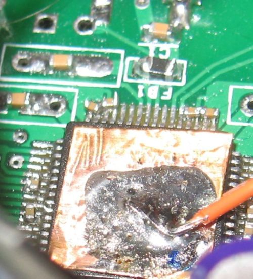

This is all hand soldered, even the 0603 C1, so excuse my not perfect soldering look ... the tip of the soldering iron was almost bigger then C1 ...

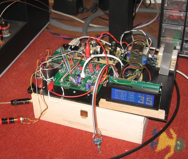

My Diyinhk es9018 + amanero + hifiduino combo is playing for a week. Digital power supply is LT1763 + LM317 (enhanced) as preregulator. It started with another LT1763 for analog power supply, but changed it for a pooge derivate with LT1963 as a prereg. The difference between LT1763 and pooge is quite big - former being hard and glassy in comparation. I started with current mode opamp output stage (ada4898+LM49990) but to my ears passive voltage out with Cinemag cmli15 output xfomers (1:1) sounded better so that's what I'm listening now. Oscillator is 100MHz SAW. 74hcu04 is used for spdif to ttl conversion. Good quality components are used but nothing special except 0402 smd caps directly on ps pins of es9018.
It sounds nice. 🙂
Thanks to diyinhk, glt & amanero!

Good job!, especially soldering those 0402 caps. Are you using this pooge:
http://www.andrewweekes.talktalk.net/pooge_551.htm ?
Perhaps diyinhk should have 0402 caps per-installed in all of the power pins in his next version of the board.

Everything is explained on glt's site.
I didn't use level converter for I2C connection, just 10k resistors on sda and scl lines. Tried ADUM isolator, but couldn't get it to work - as soon as I connected ground to dac side of isolator arduino would go berzerk. 😕

Yes, that's the schematic - I used 1n4148 for reference, jfet for simple current source (I know bjt would be better) and adjusted the values for 3v3 output.
0402 caps are a bit larger than pins spacing so it's really tacky job to solder them without shorting anything
