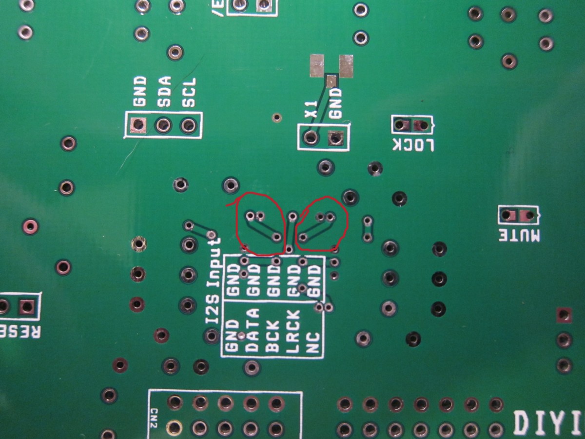

I don't know and maybe no-one will help, so, if you have checked the connections to the pins and the power entry, and it seems these lines are part of the routing, then cut them very carefully and see if they are. You should be able to repair them quite easily if they are not.
I would be interested in knowing too before cutting and testing the trace. With separate AVCC one can implement the opamp-based AVCC (in the ESS documentation) since most opamps are limited to about 50 mA which is enough to power half the chip at 100 MHz
I have not cut the traces myself, but based on the pin assignments, you will need to cut the three bridges on the right side to separate the right avcc from left avcc.

I'm building my board and I'd like to know if I can separate AVCC left and right cutting this connections?

can you indicate me on the picture what you suggest me to cut?
Looking the picture I've cutted the one on the right side without any result.

Hmmm... Cutting the right one you circled "should have" disconnected one of the corner AVCC pins. There are 8 AVCC pins: 4 in the corners and 4 in the sides/middle of the chip.
When you cut the trace, do you still have continuity?

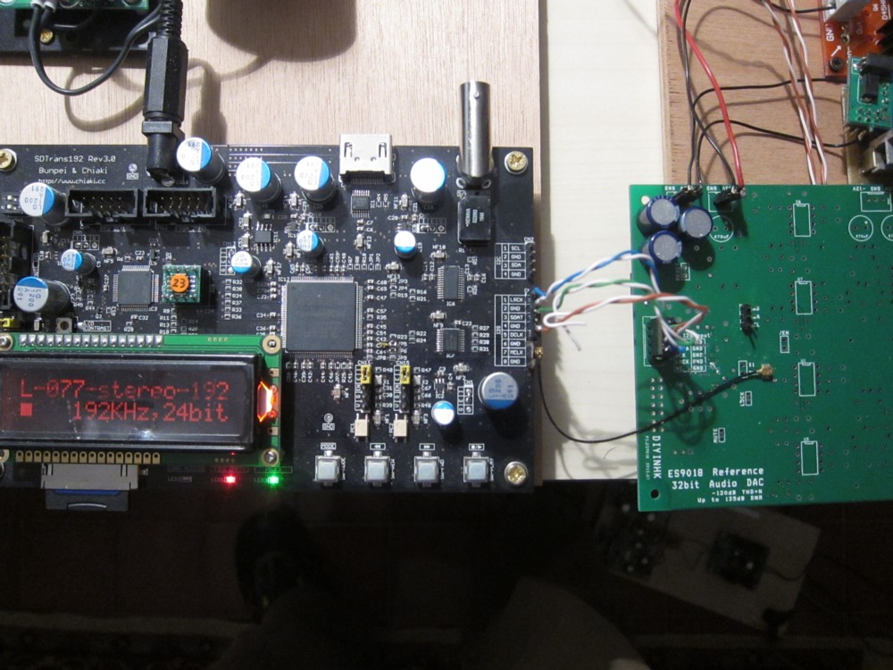

Another "discovery": it turned out that the C-Media Win XP DirectSound driver for CM6631 USB to I2S converter always converts signal bit depth to 16. It simply ignores any application settings. There is no control panel (I could not find one) to change this setting. All my previous measurements were made for 16 bit ESS playback and 24 bit EMU recording. But I have found workaround: I play RMAA test signal wav file using the foobar2000 and the C-Media ASIO driver. ASIO driver has small control panel for bit depth setting (default is 16 bit) which is accesible from foobar. Then I use "recording only" option of RMAA. This way I have full 24 bit measurement. It now shows that the noise level of ESS board is really lower than EMU ADC recording capabilities. Of course my previous results are still valid. Only noise level shown was too high. Power supply bybpass capacitor influence on harmonic distortion can be observed with this new measuring method too. My test setup looks like this:
and my power supply:

Impressive ! Getting closer to the theoretical limit for 24 bit.

Unfortunately, what we can see on my graphs, makes only -111dB total THD+N. It is around 18-19bit performance. 24bit in theory gives 144dB dynamic range. But now we are looking at my EMU noise floor rather than ESS performance. This C-Media driver bug was really a failure.
My power amplifier is capable of 90dB dynamic, so ESS board as a source is more than perfect for it.
