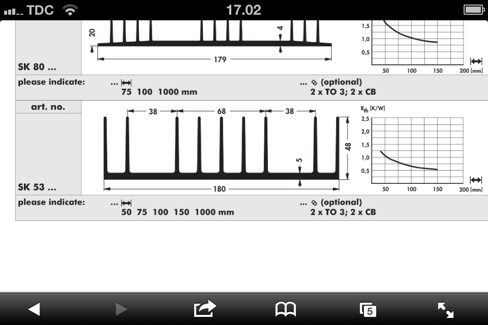

I am using 2 x Fischer SK53 - 100mm glued together (rated at 0,65k/w each). Perhaps I could buy 2 more of them and attach to sides standing up - so finns are pointing to each side like a normal amp case - you think that could work?

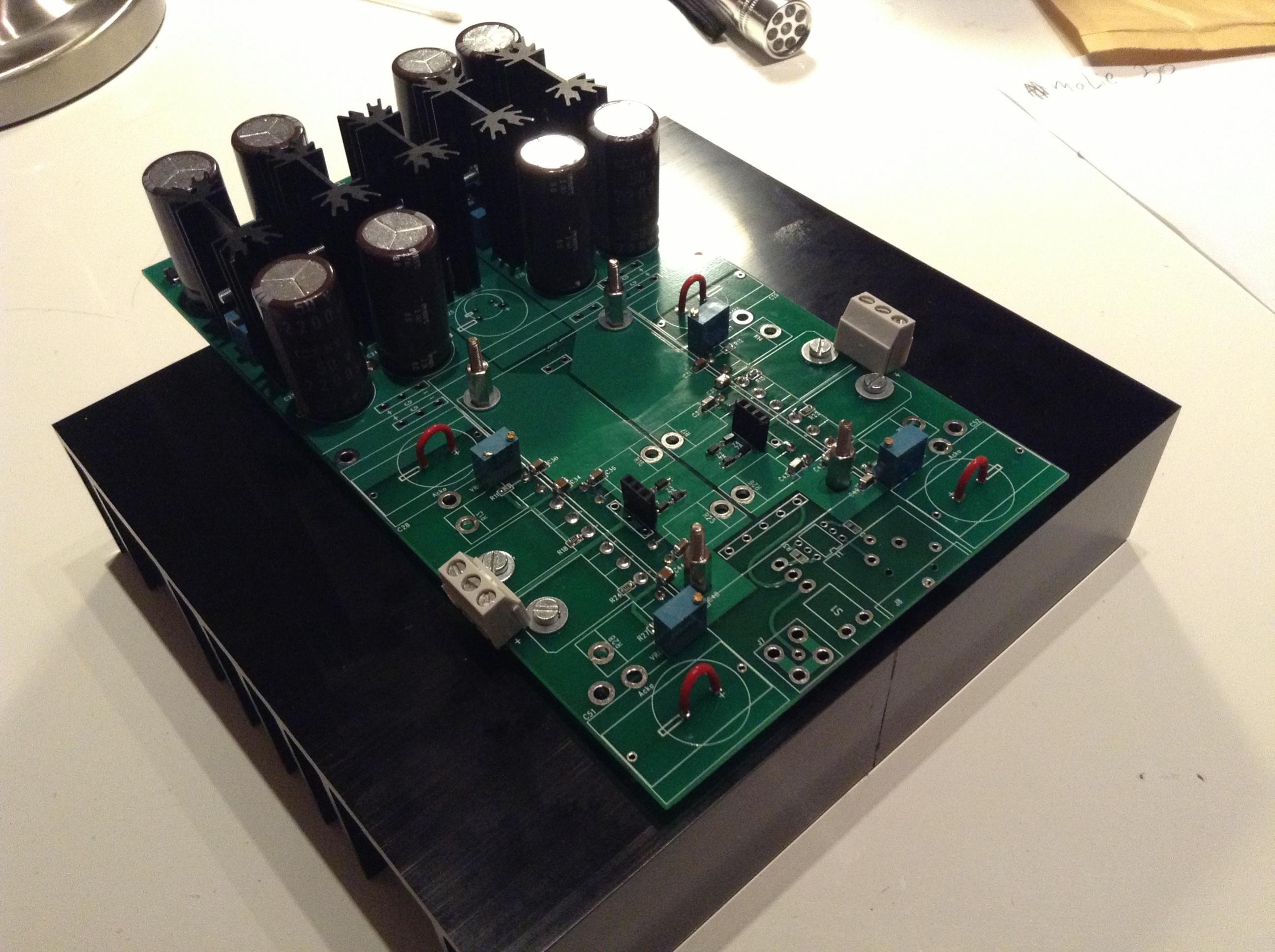

Soldering is done and board attached to heatsink - no broken legs on the z-foil 🙂
But ugh that wiggling of the board into position and getting the zfoil legs through the board was scary

you cant get a single heatsink the right size? you can only achieve it with 2? are you attching 2 more to the 2 ones you have already? this will not be very efficient, it may not help lower the temperature rise much at all, especially at the fets

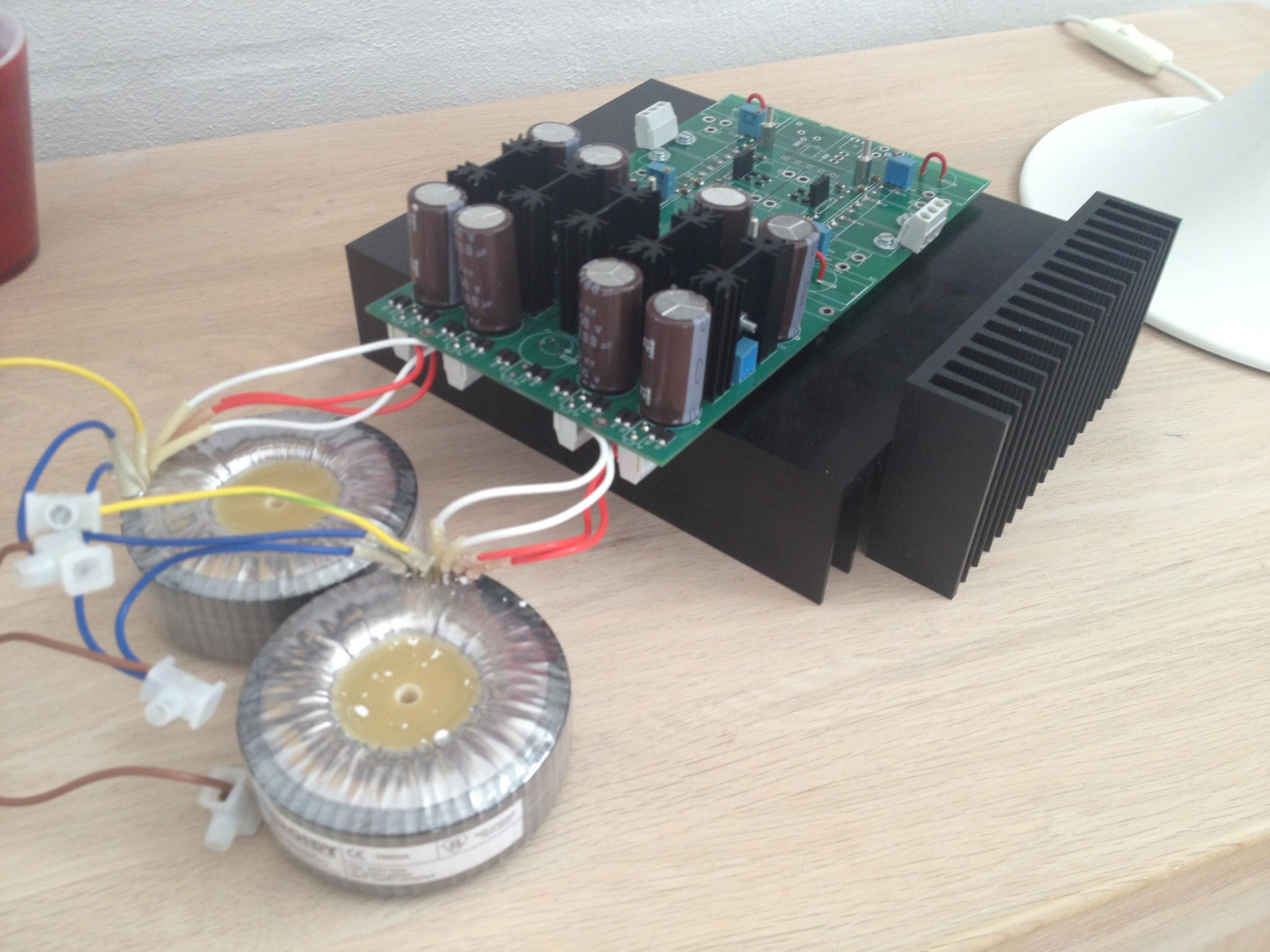

I was hoping I could buy 2 more of them and attach like shown on photo below - to avoid removing the board - but realize that this is not the optimal solution.

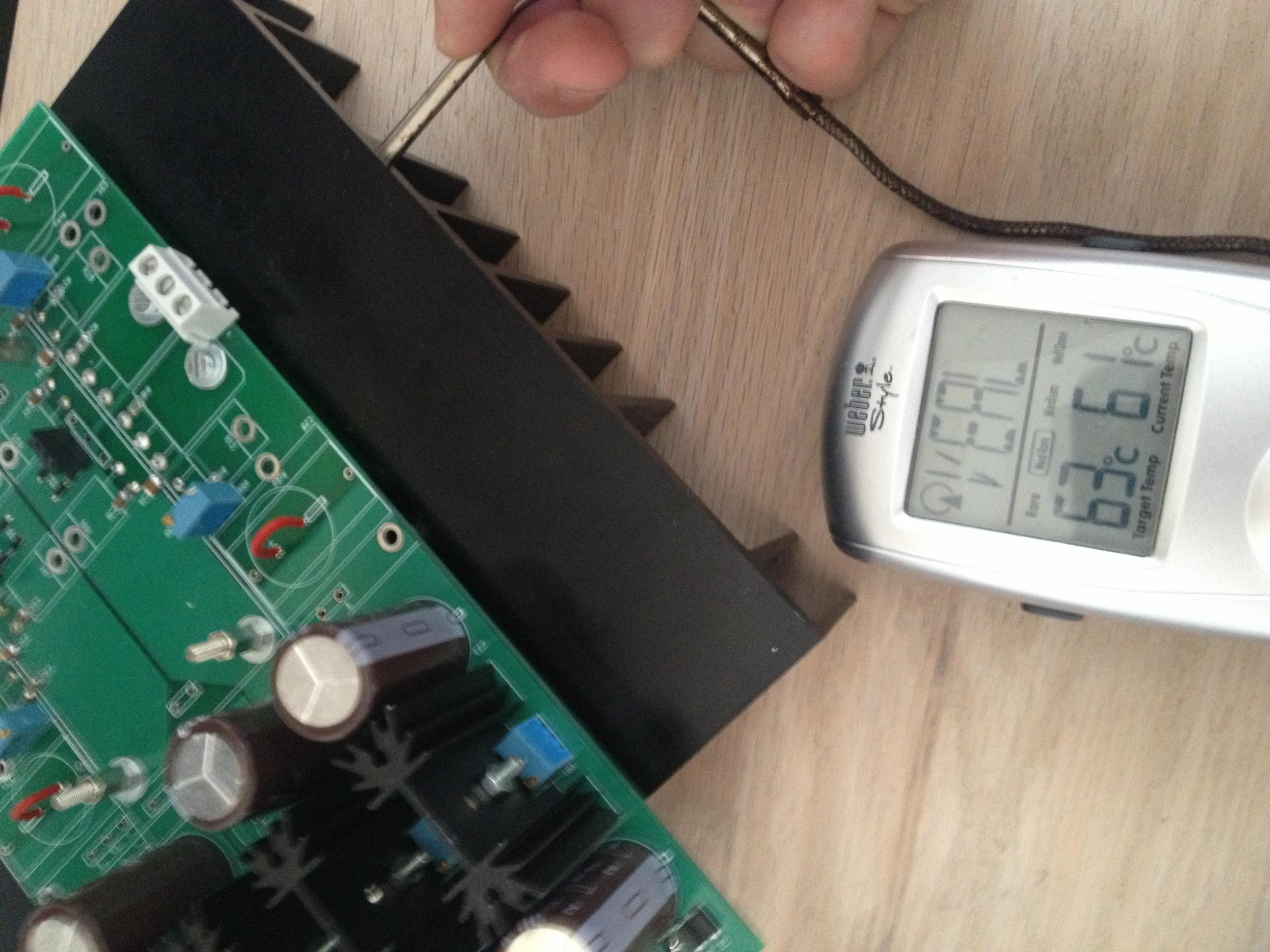

Today I will buy thermometer to measure the temperature - yesterday I only had my hands 😉 . What temperature threshold should I make sure to keep below before switching the power off - around 60deg Celcius?

cool, well that'll help out. on the side like that probably wont do a lot of good, as you wont get very good contact, so thermal impedance between them will be high. If you mount it like above, it will also block the airflow through the fins of the main sinks and that will negatively impact the performance considerably, so may even make things worse. the air needs to be able to take the heat away from the heatsink, the metal doesnt do that by itself, so not a good idea.
is there any way you can bolt them face to face on the flat sections on either side of the NTD1? use some arctic silver or something, or silver epoxy, thats if that wont screw up your layout. whats important is the ambient temperature inside the case, the ESS states a max operating temp of 70c. the fets and the NTD1 in general will be fine at considerably higher temp than that, maybe 80-90 depending on the caps you used. its a safe bet to say that it would get even hotter closed inside a case and if 80c builds up inside the case that would not be good.
Qusb I see your point in bolting the additional heatsinks to the flat surface with fins up to get a good thermal contact - and use some thermal compound between them. I will do it that way. I did not really think about enclosure at this point - that will come later
Ok probably not the most accurate way of measuring the temperature - but just to get an idea. Temperature stabilizes at 62deg celcius - I had it turned on for 30min - the remaining 10 min the temperature did not rise any further. I can put my hand on it for 5 seconds at this temp before it hurts to much
We can almost cook veal medium rare on this thing 😉
