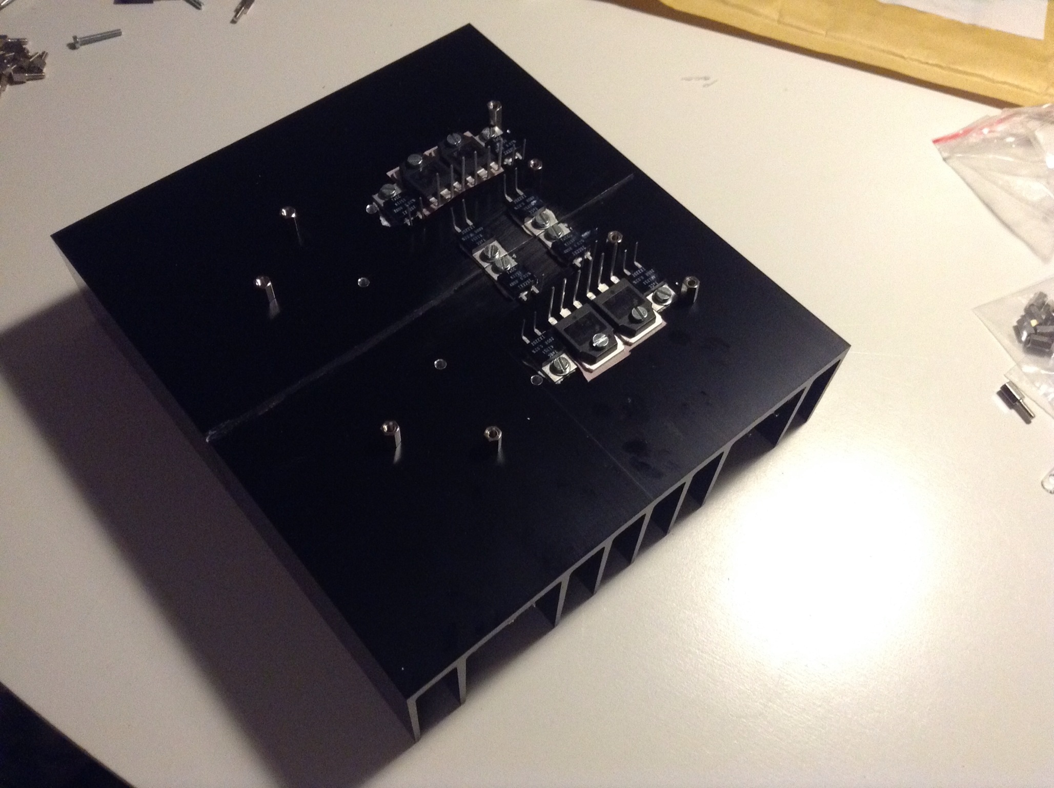

Ok finally I received all parts for my build 🙂 Started some drilling today and mounted the mosfets and zfoil resisters to the heatsink. Used the keratherm pads from Qusb under the mosfets. I don't need to isolate the zfoil resistors from the heatsink or do I? Just wanted to be absolute sure before continuing
