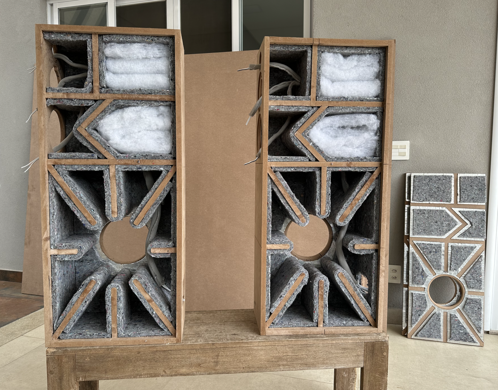

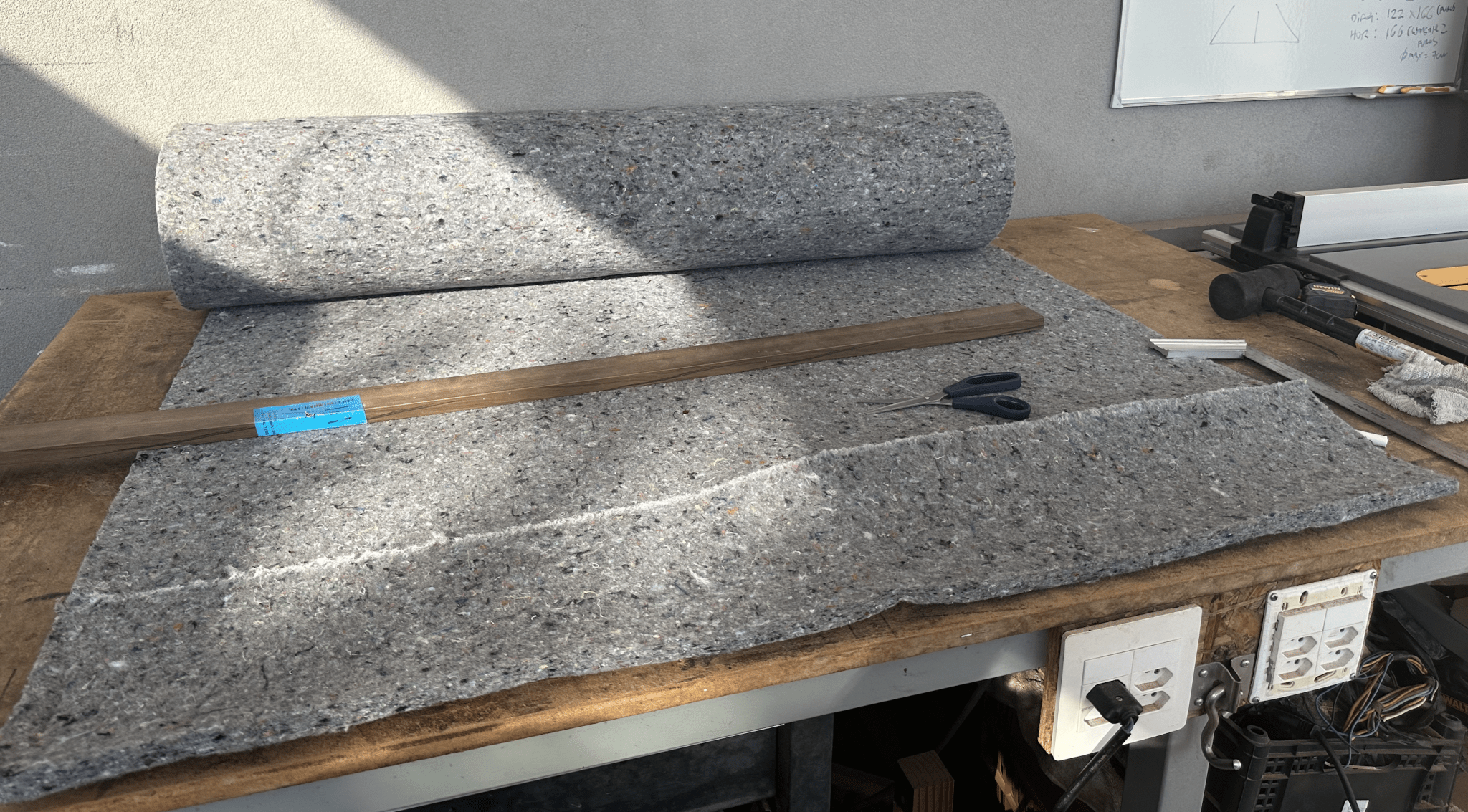

The boxes got a good quality 15mm thick felt lining. I know I may have gotten carried away and over-lined the interior 🤣, but I guess it won’t create any problem. The wiring (1.5mm OFC copper wire) is already in place. The wires will be covered with foam tape to prevent any possible rattling.

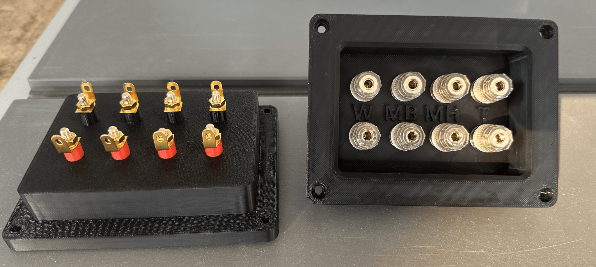

After a lot of reading and research, I’ve finally decided to go with a fully active crossover. I got a good deal on four Fosi Audio ZA3 class-D amplifiers (which will probably get an opamp upgrade - at least the ones driving the mids and tweeters). So, I reprinted the binding post plate to support four terminal pairs.

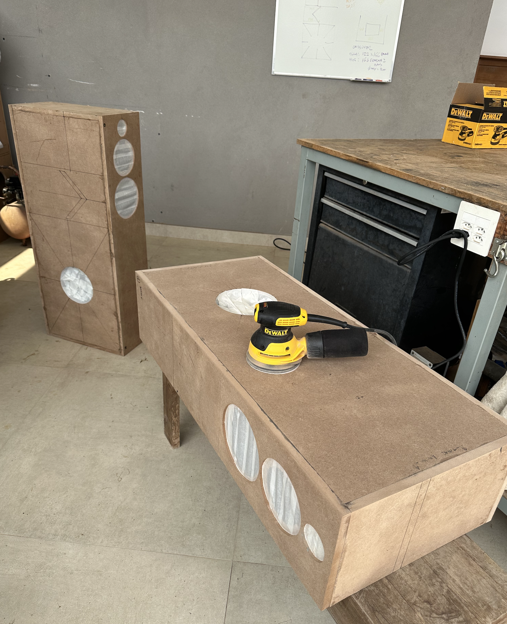

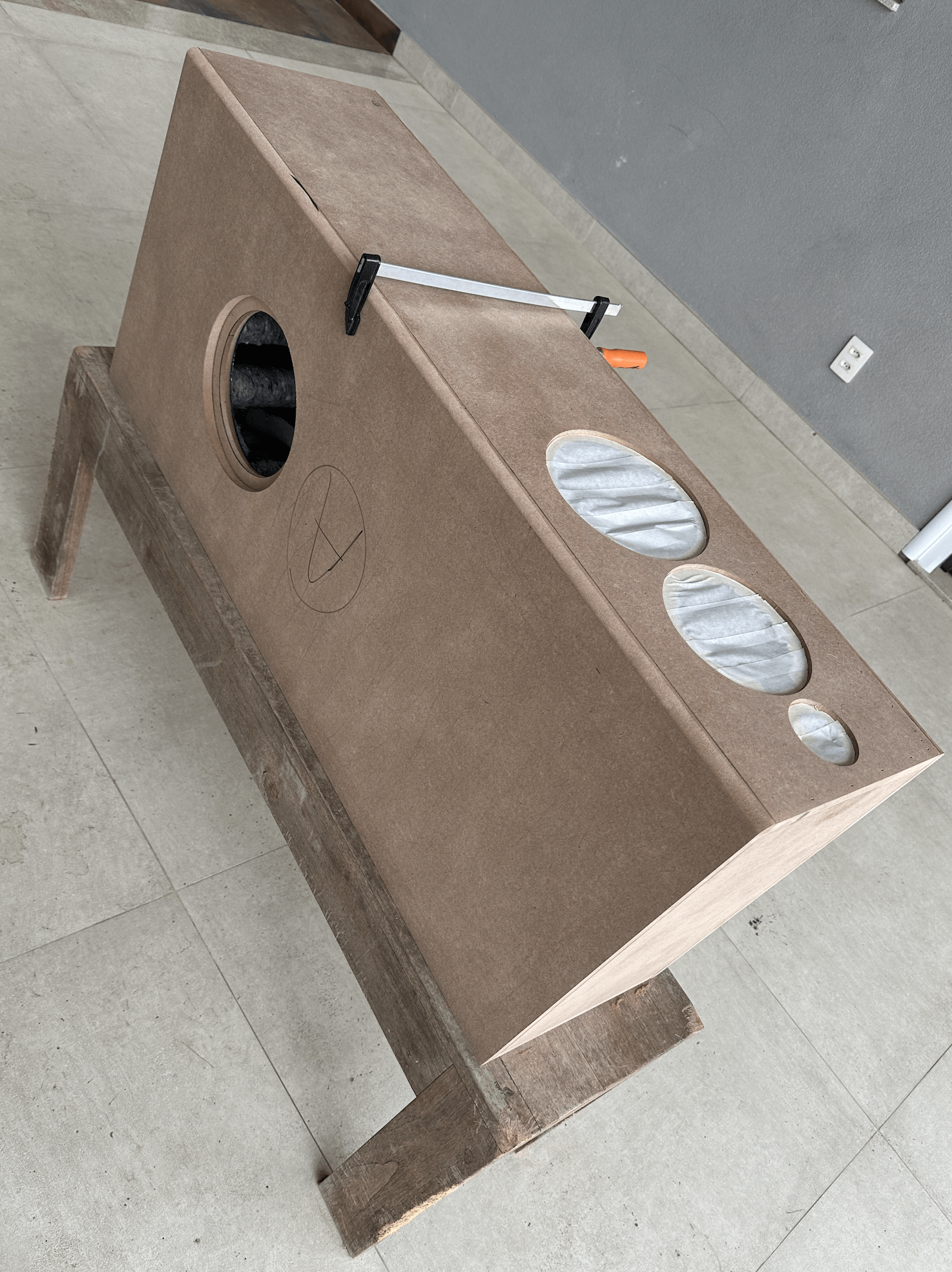

A bit more progress.
The wiring is covered with foam to avoid rattling, and the two top chambers that I can’t reach after closing the box were stuffed with low-density polyester fiber.
Then, after closing the boxes, came one of the worst parts of woodworking: sanding 😬. Both boxes were thoroughly sanded using 80-grit sandpaper.

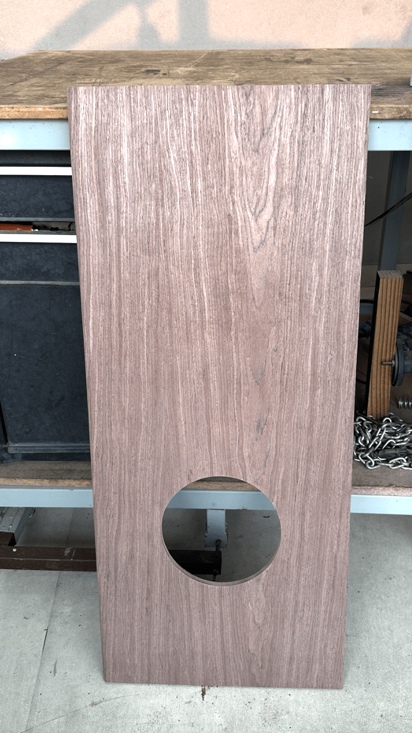

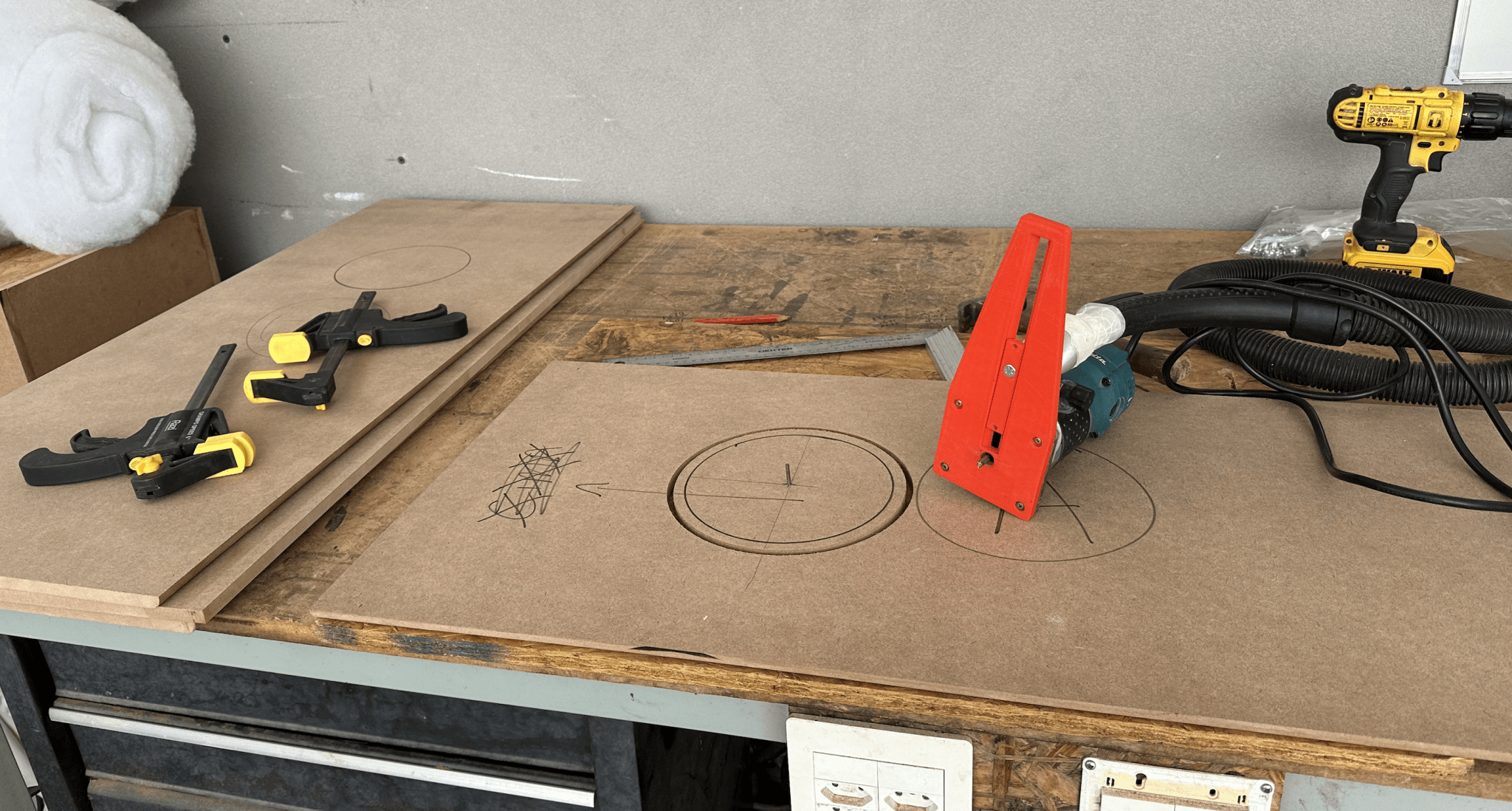

Next, all four side panels (12mm MDF) had the woofer holes cut, and the edges were rounded. By adding these 12mm panels, the sides will have a thickness of 40mm, and the front baffle will have a 10mm radius rounded edge on the sides. I guess the rounding won’t be enough to avoid significant diffraction, but at least it will have a nice aesthetic effect with the wood veneer.

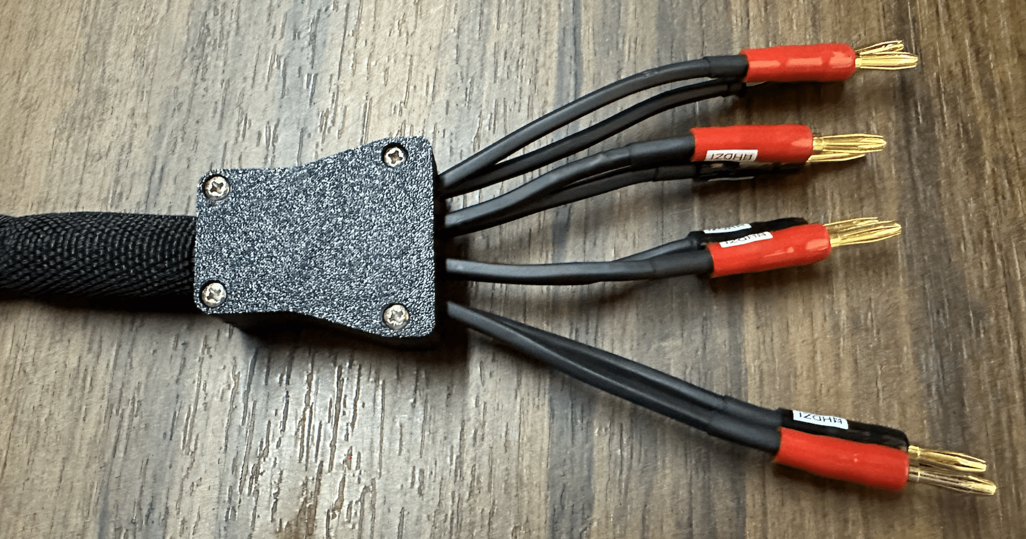

I’ve also started building the cables. I combined eight 1.5mm² OFC cables using braided heat shrink tubing and 3D printed a “thing” that will help position the cables behind the amplifiers. I got a nice deal on four Fosi Audio ZA3 class-D amplifiers—not very high-end, but they sound pretty nice!

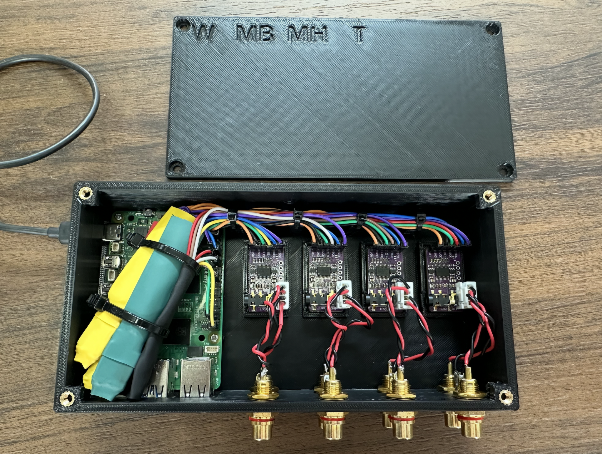

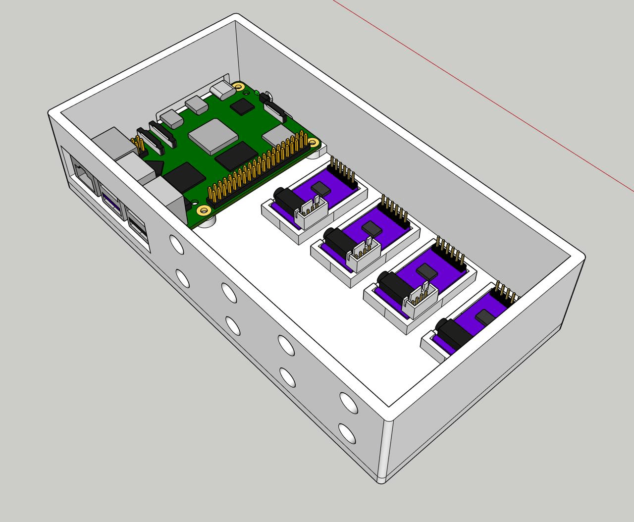

I’ll be using a Raspberry Pi 5 to run Tidal Connect, CamillaDSP, and, at least initially, four cheap PCM5102A modules from AliExpress (similar to a HiFiBerry DAC 8x). If I feel the speakers deserve it (i.e., if I don’t mess things up 🤣), I’ll get (or build) a better DAC.

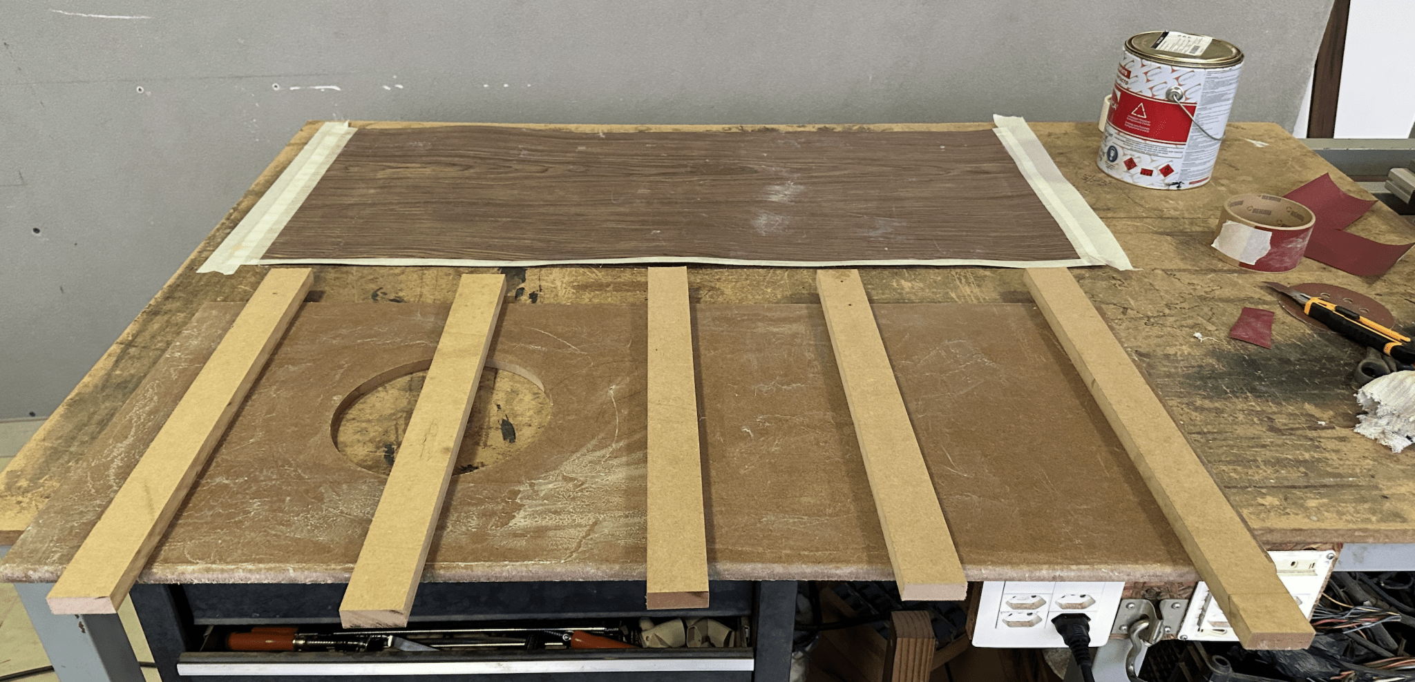

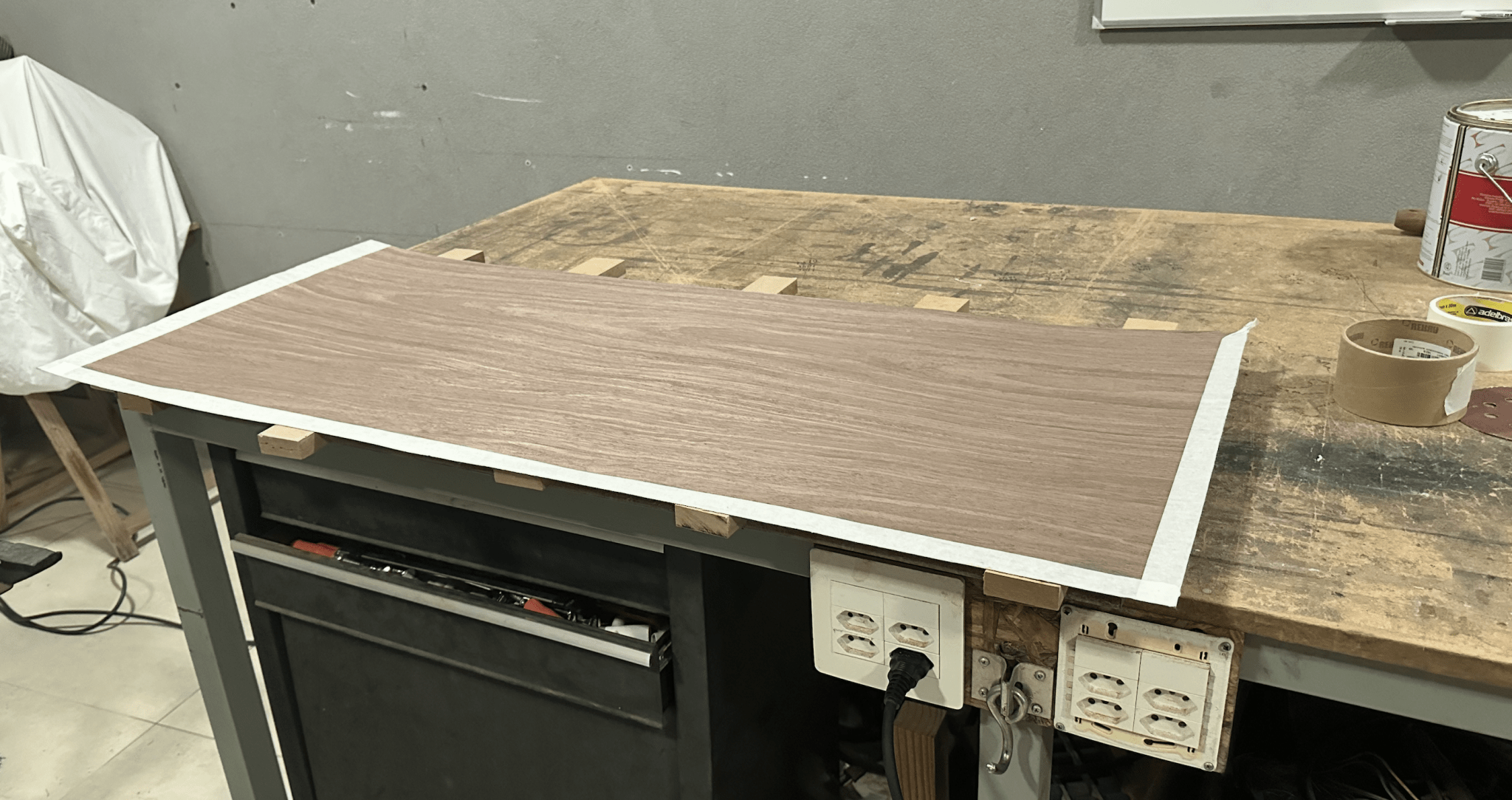

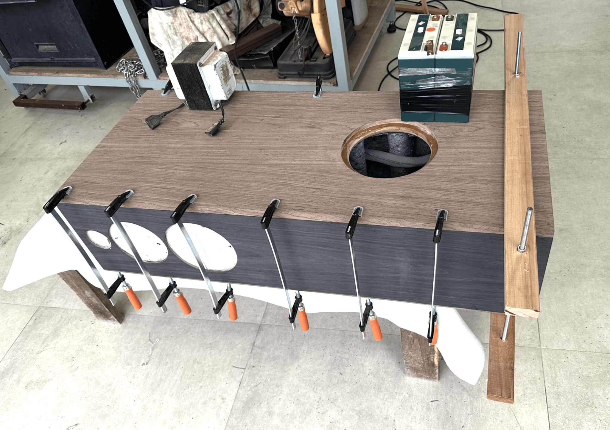

After sanding and preparing everything, it was time for veneering. The 12mm side panels and the bottom of the box were veneered with Imbuia (a Brazilian wood that resembles walnut).
1727301553471-png.1360511

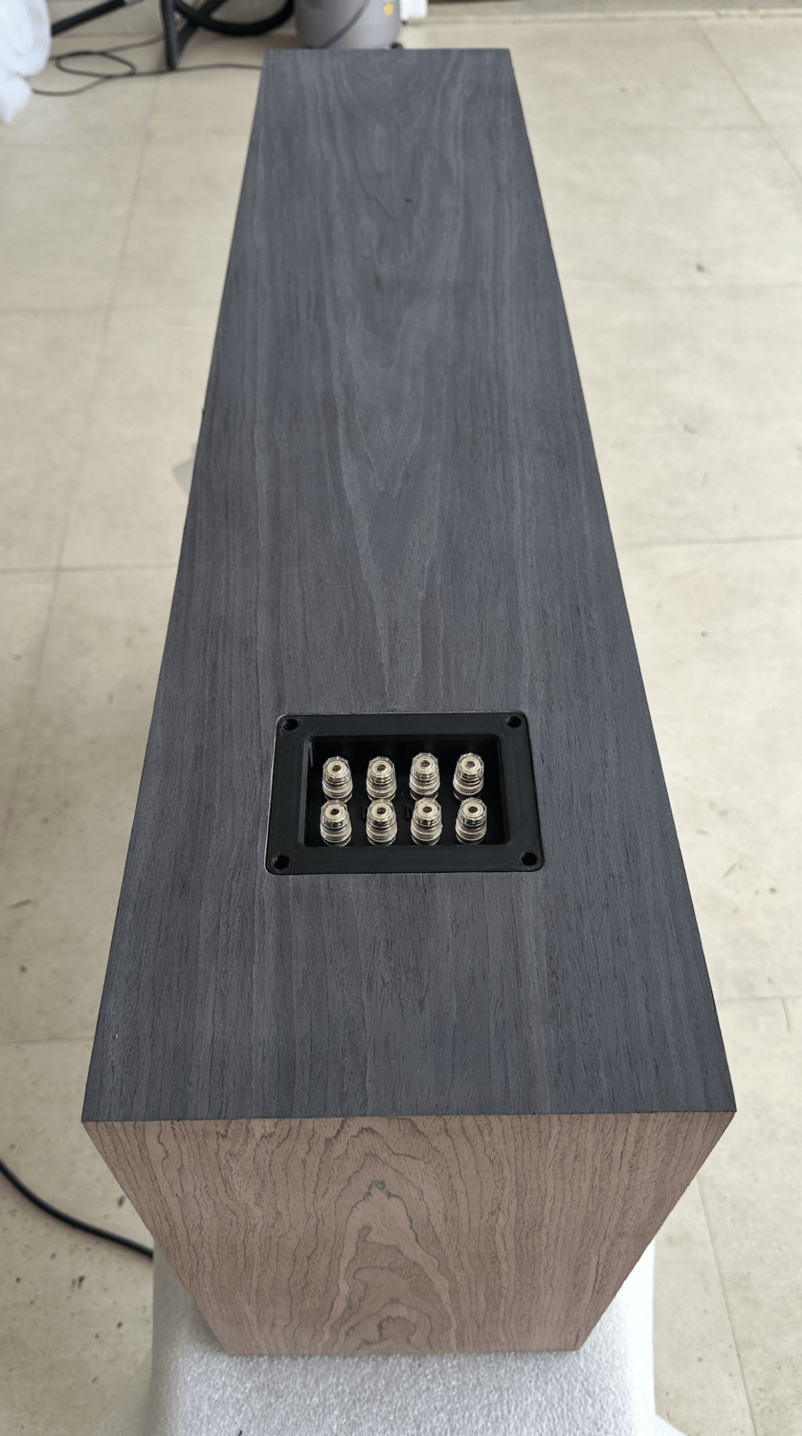

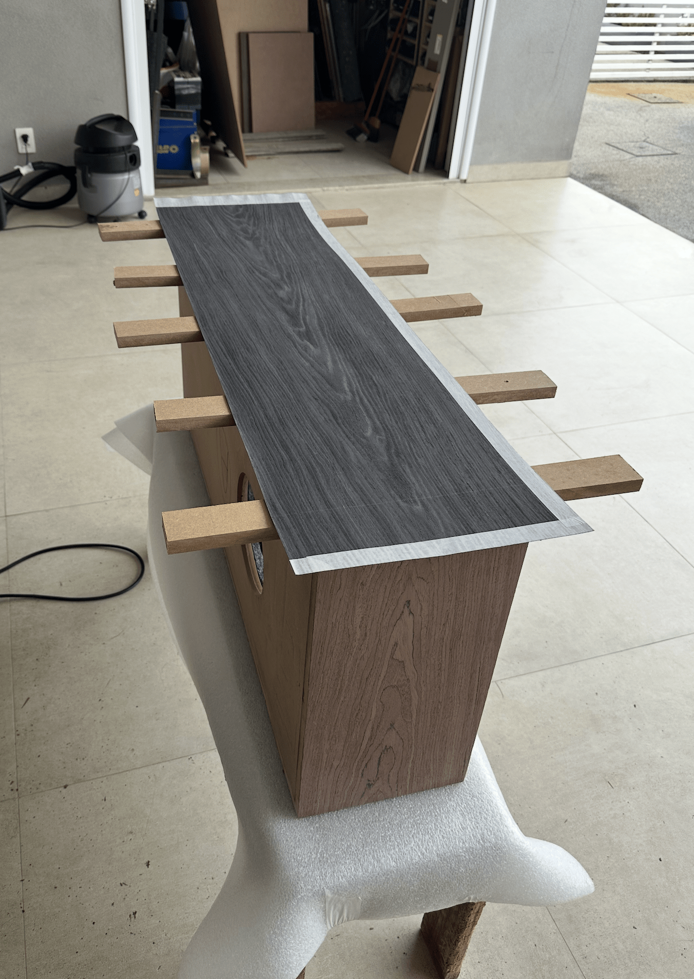

The baffle, top, and rear were veneered with an ebony wood veneer (I don’t know which wood it’s made from). It is dark gray, almost black when varnished.
The next step was to glue the side panels and the box together. It was just after the glue was applied and the parts were ready to be clamped that I realized I didn’t have enough clamps! Damn… Well, a little weight here and there, a threaded rod, and a few wood pieces, and everything went well.
Next steps are sanding (again!) and three coats of varnish.

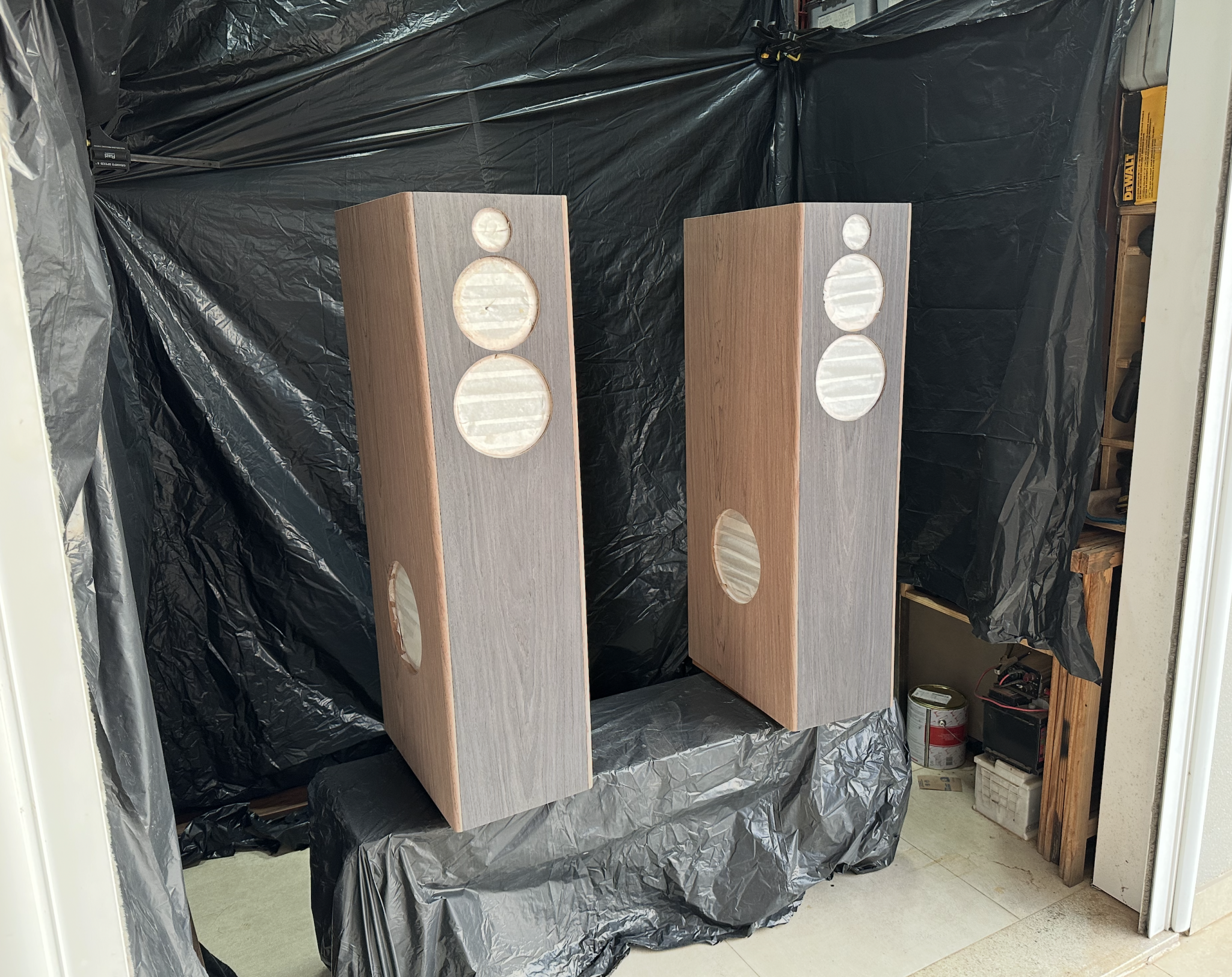

FInally the boxes are done!

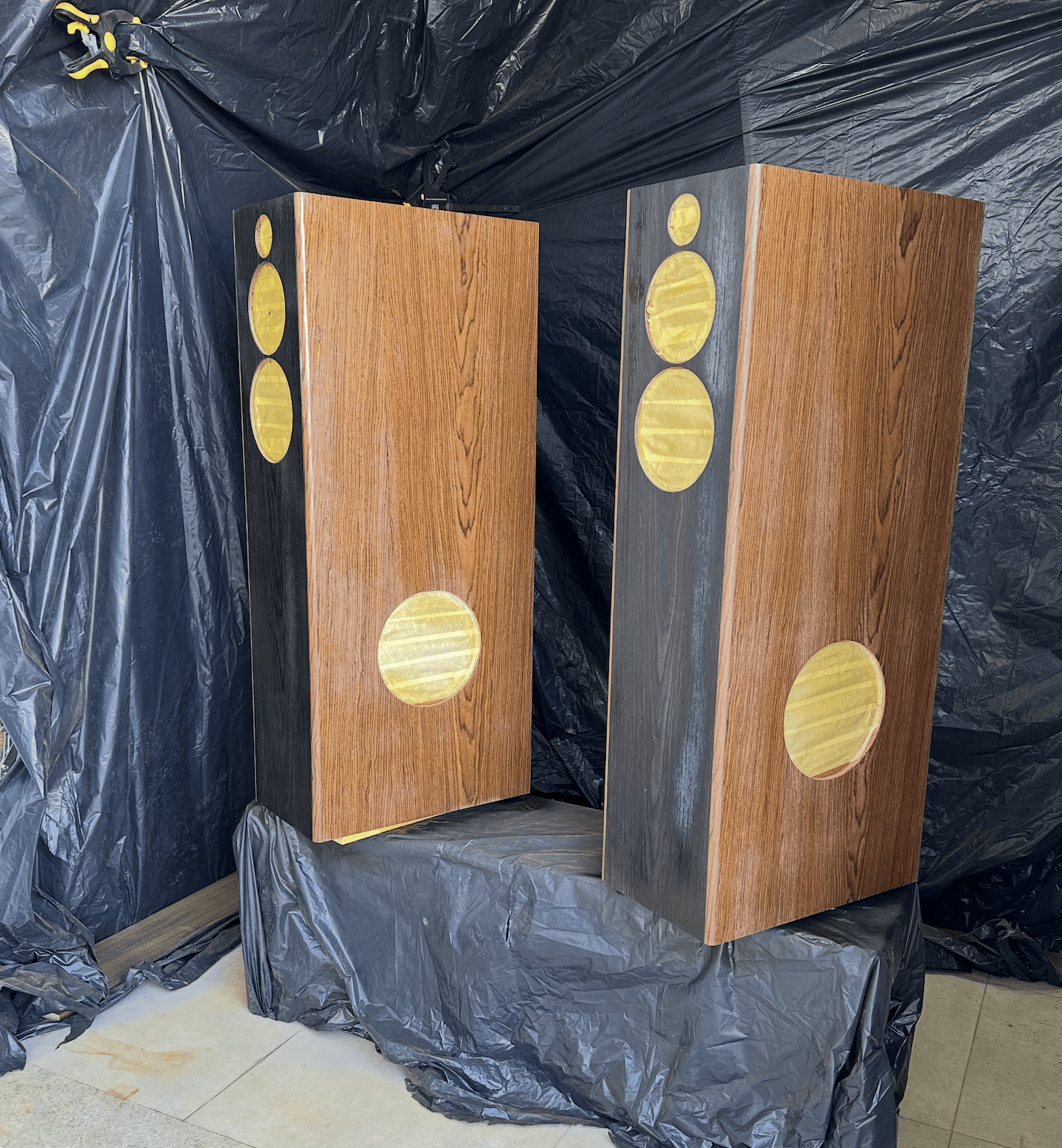

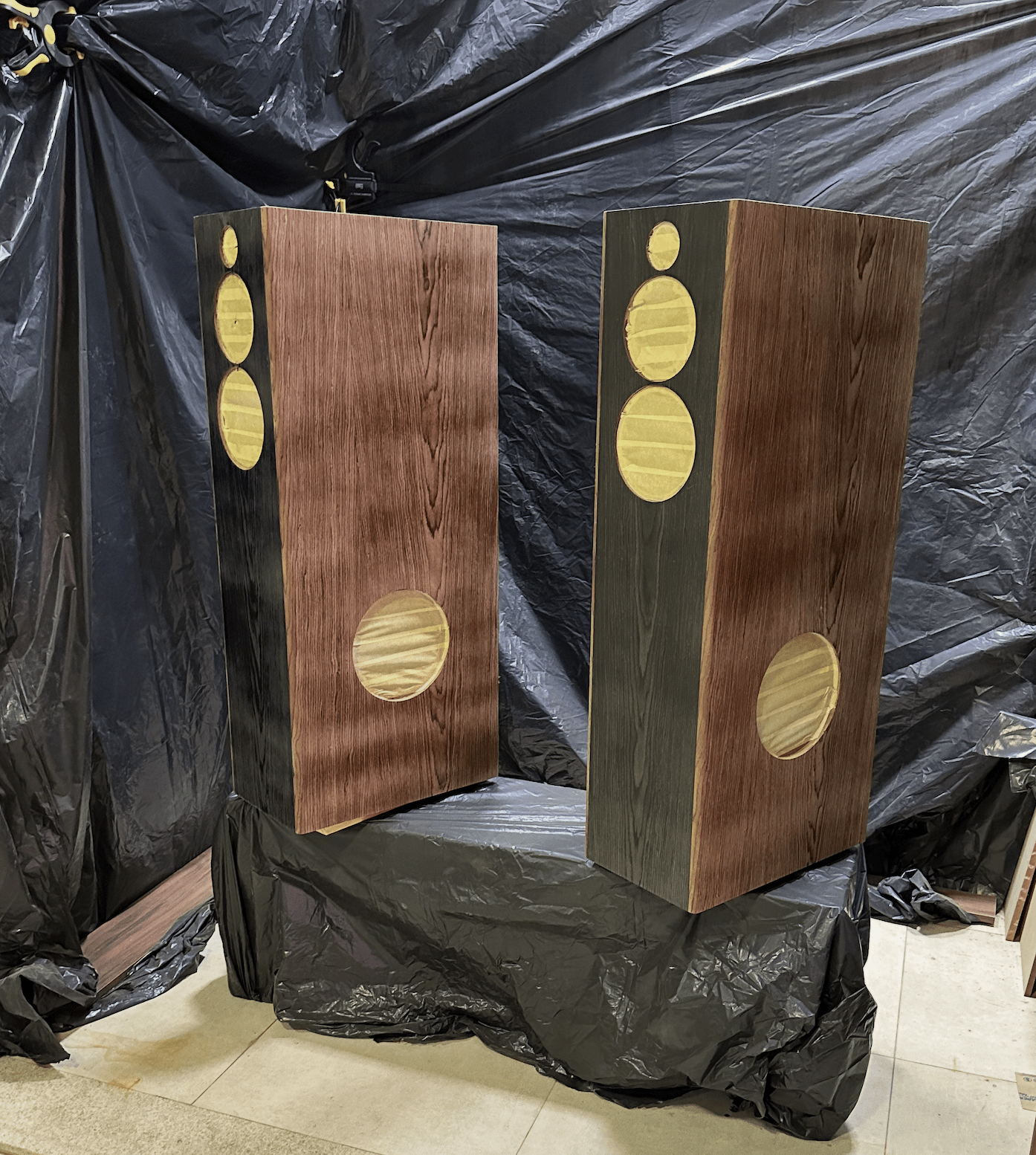

After veneering, both boxes were sanded with 180-grit sandpaper using a random orbit sander. I used my storage room as a paint booth to apply the varnish to the boxes. Note to self: Use white plastic next time. The black plastic makes it difficult to see what you’re doing, as it absorbs all the light.
Three coats of matte marine varnish were applied, with a 12-hour interval between coats. Between the first and second coats, I hand-sanded the boxes using 600-grit sandpaper.
First coat:
Second coat:

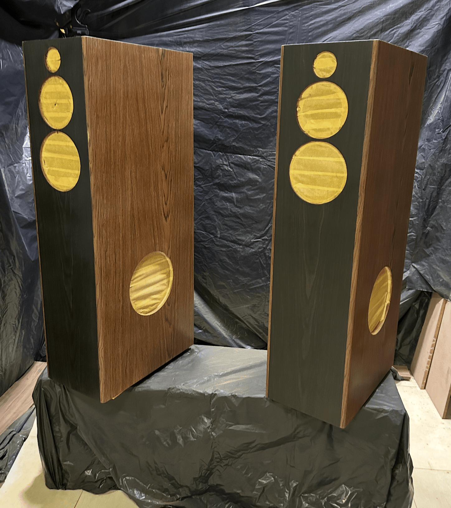

Third and last coat:
All pictures were taken while the varnish was still wet. I’ll have to wait at least 24 hours before handling the boxes, so I expect to have them assembled by the end of the week.
I am very happy with the result, especially with the Imbuia veneer. It looks great. Hopefully, it will sound as good as it looks!

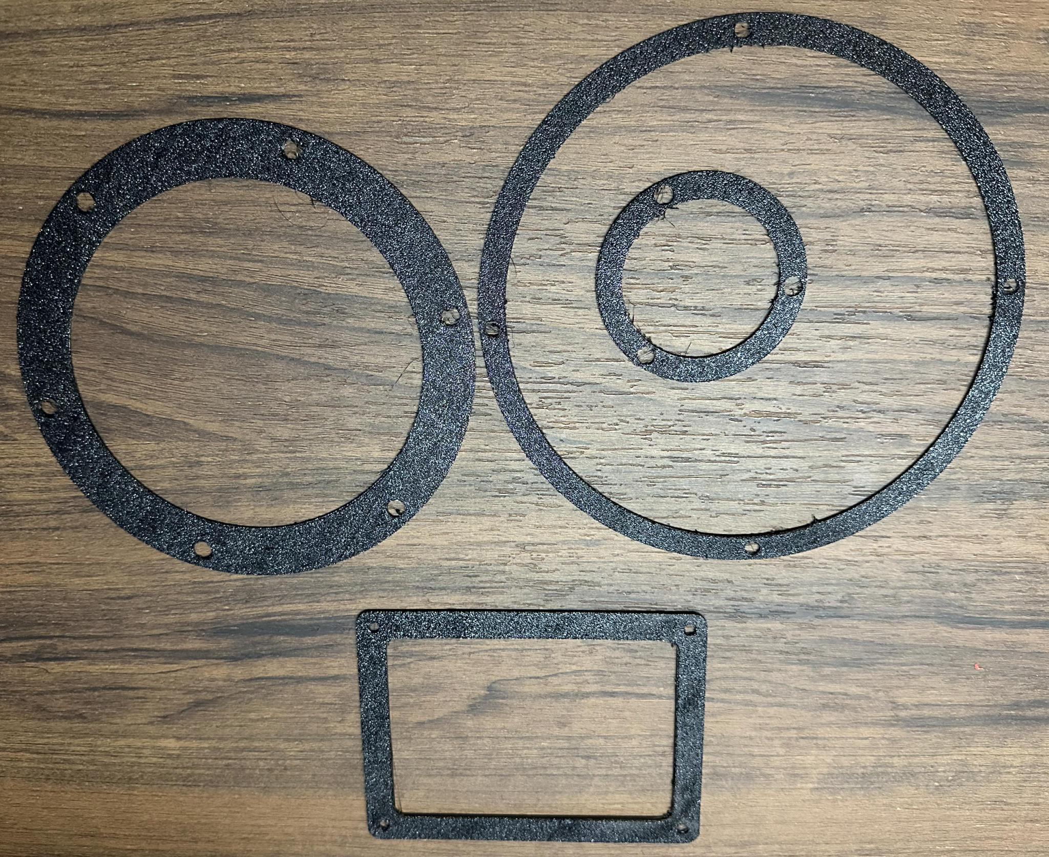

Before mounting the drivers and terminals at the back, I 3D-printed TPU gaskets for each driver to ensure they sit perfectly flush with the baffle (yeah, I really need to tune my slicer when printing with TPU)
The result was great!

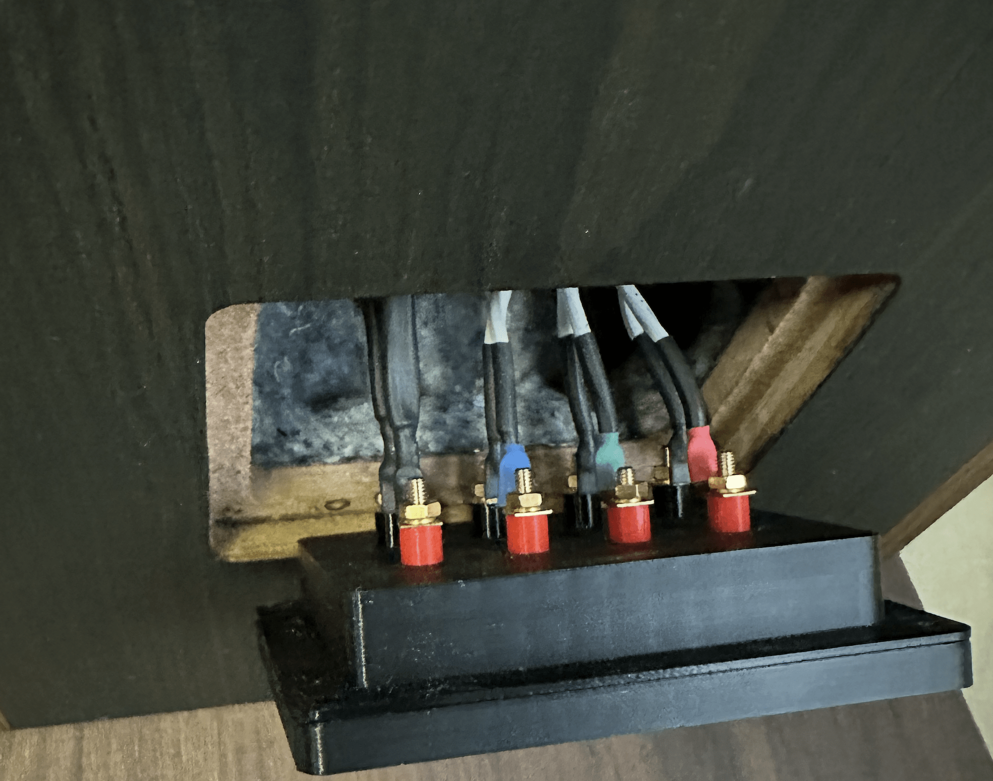

The wiring, color coded, was connected to the 3D printed terminal plate at the back

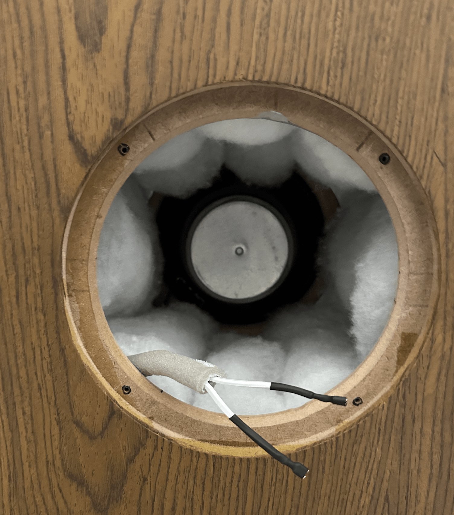

In the first assembly (I’m quite sure I’ll be doing a lot of tweaking with the stuffing), I didn’t add any filling to the midbass chamber. In the woofer chamber, I added Dacron around the perimeter, loosely filling all spaces except between the woofers. Of course there will be a lot of measurement work to tune the active crossover.

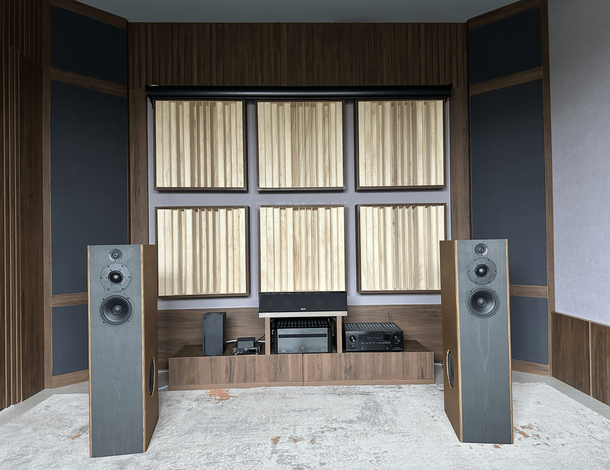

They’re in their new home!
Nest steps, hook up everything, configure Camilladsp and take some measurements.

CamillaDSP is running in a Raspberry Pi 5 and digital to analog conversion is being done by 4 cheap (2 usd) PCM5102A modules from Ali Express. I've designed and 3D printed a case to put everything in.
