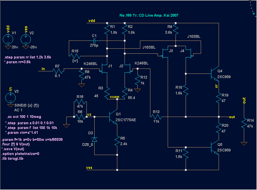

Mooly the only benefit I can find that is of value in having non symmetrical stages is the ease that one can have a desireable THD spectrum. This is difficult but not impossible to realise with symmetrical circuits.
Then again one has to question this desireable THD spectrum, as for example the cyrus amps, especially 3 and up, these are fully symmetrical and display non desireable spectrum but if you audition them they sound mighty good.
Thanks smart, Ill try using google translate in Japanese, Im interested because theres some spice models on the pages and some modifications made to them after the author physically measured real parts.
