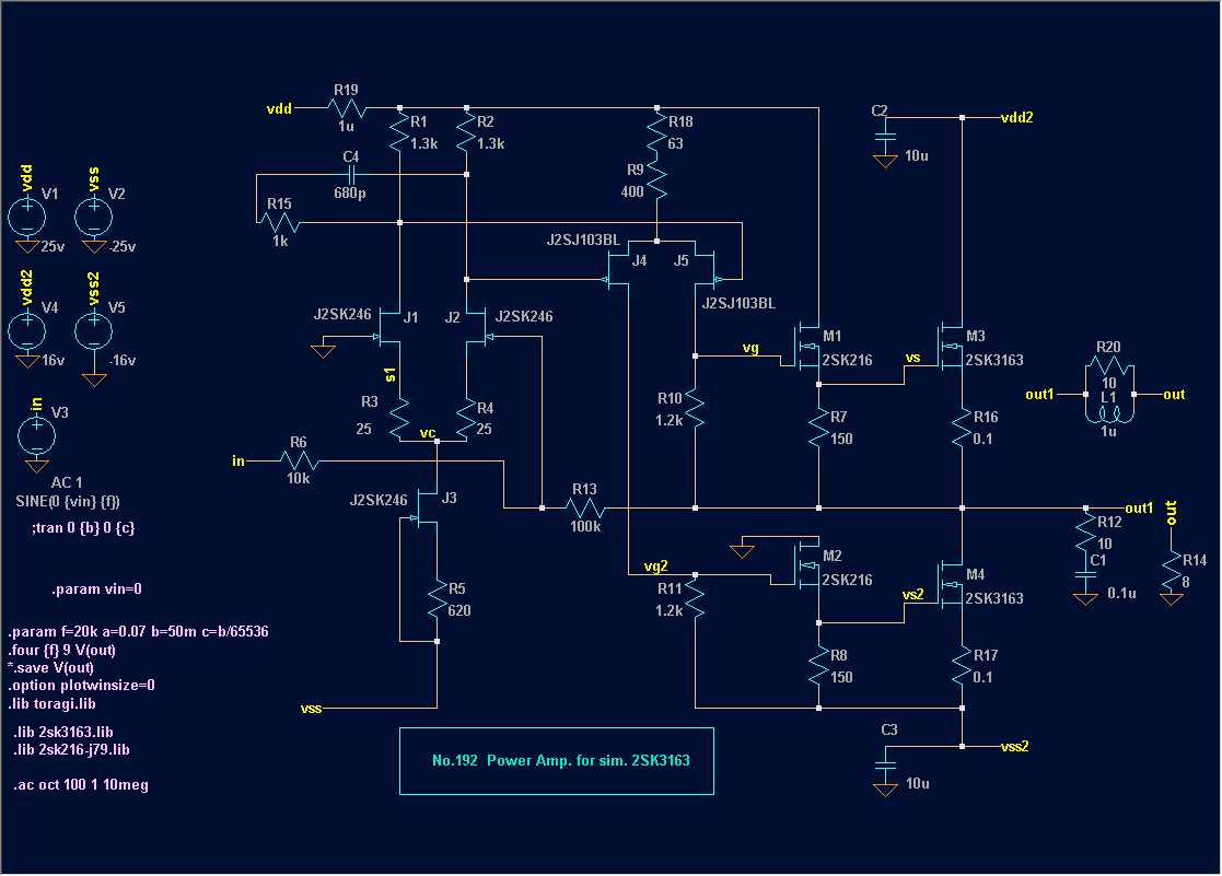

build this or not ??

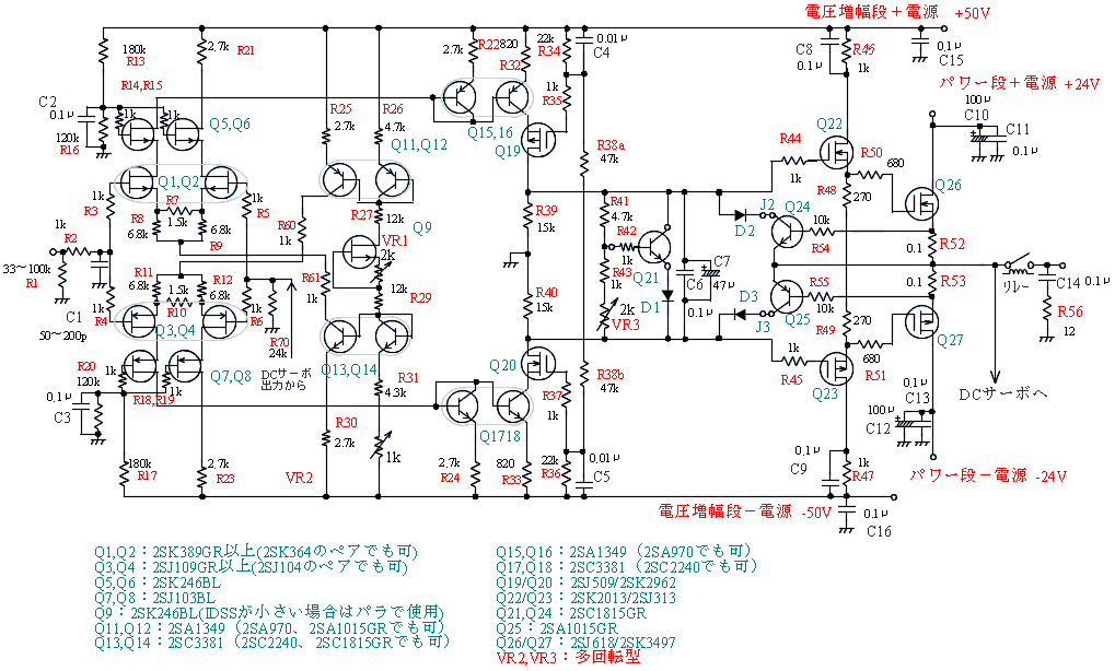

Thanks smart, Ill try using google translate in Japanese, Im interested because theres some spice models on the pages and some modifications made to them after the author physically measured real parts.

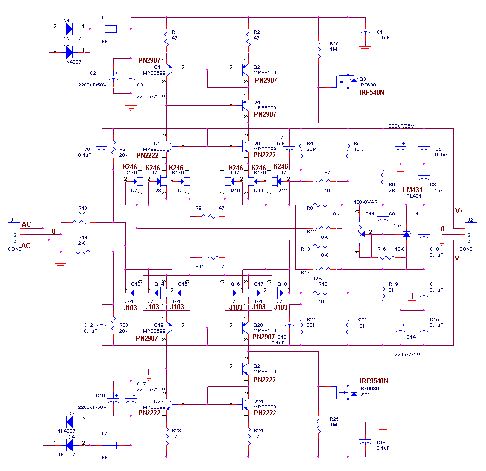

I'm fascinated by some of these... such as the above and the obsession with visual symmetry in circuit design.
its not only an obsession ...its an ediction ...and probably a few more other things especially for people that like symmetry ...
the point is that infections like that do you a lot of harm when you play the pcb game ...cause you like it the same symmetric then a with nice arrangements while "preserving " other design ruls and norms like star ground or feedback traces 😀😀😀

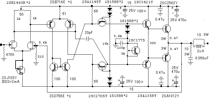

boys...😀😀 build this..sound good but not is special.
in the output put other 2sc transistors.
R9 adjust the bias (the value is more low)
Too no much power.
