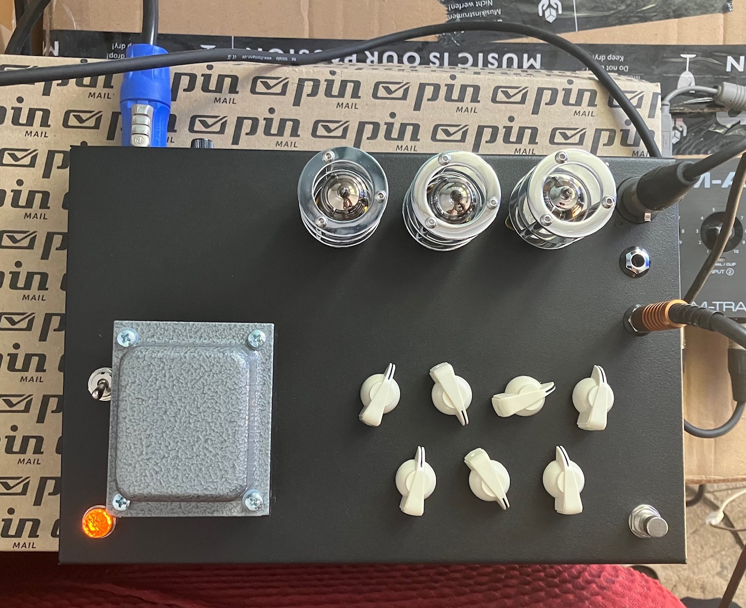

I just finished my first electronics build of any substance. I built a preamp off of Fredde’s plan...
Nice job - much better finished than my projects
I just finished my first electronics build of any substance. I built a preamp off of Fredde’s plan. Used a Genalex Gold Lion 12AX7 for V1 and V2 and. JJ 12DW7 for V3. My B plus was 435V so I changed the 3 parallel 22k resistors (net 7.3k) for 3 parallel 27k for a net 9k. Puts it right on the dot.
Preamp - Album on Imgur
Nice work, it's beautiful!

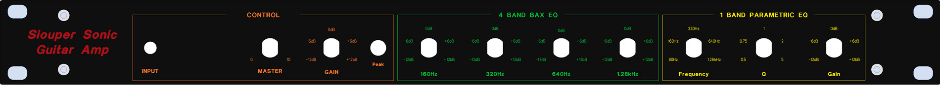

Very interesting & beautiful diy work. I like the baxandall tone control instead of FMV tone stack (I'm currently working on a 4 bands tone control with baxandall topology for GUITAR AMP but with AOP OPA1641). This topology is rarely used in instrument amp because you have a flat response (and because it's more expensive). I think it's a mistake . However FMV tone stack adds a color to the sound because there is at 50% pot a no flat response (so a color to the original sound). Most of time this is a cut in the middle. With a baxandall tone stack, I think adding a FMV tone stack WITHOUT pot but instead fixed resistors with right values. This could be carried this color to the guitar amp (I will use tsc to find the fixed curve I want) and after that have a really better control of bands because of Baxandall tone control 😉

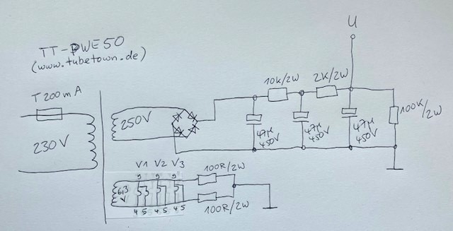

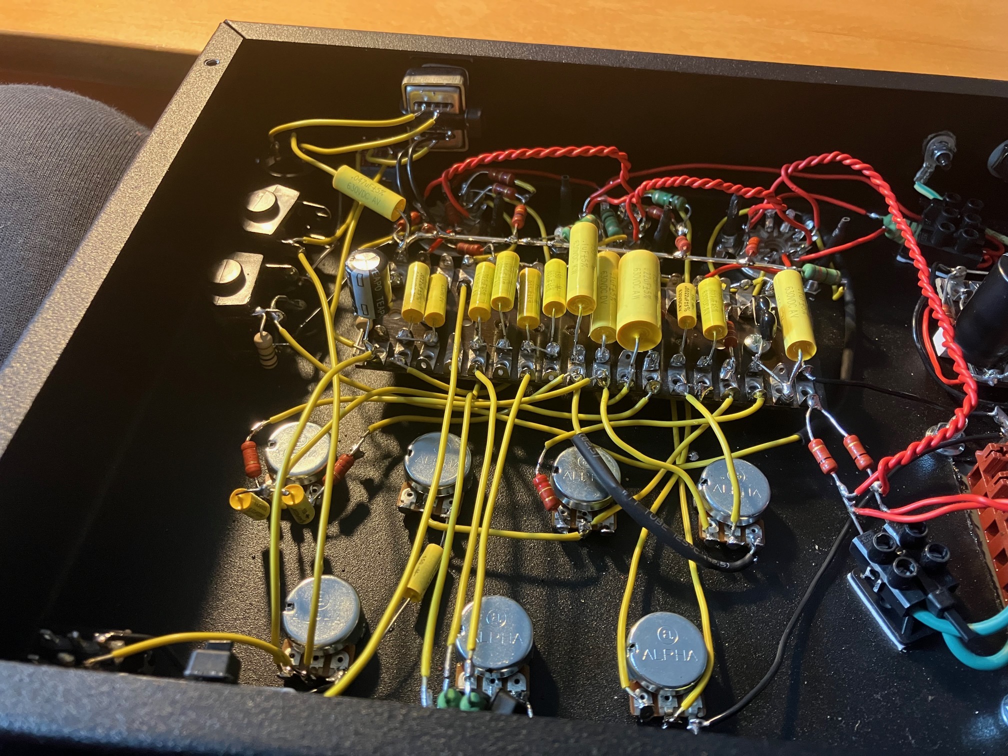

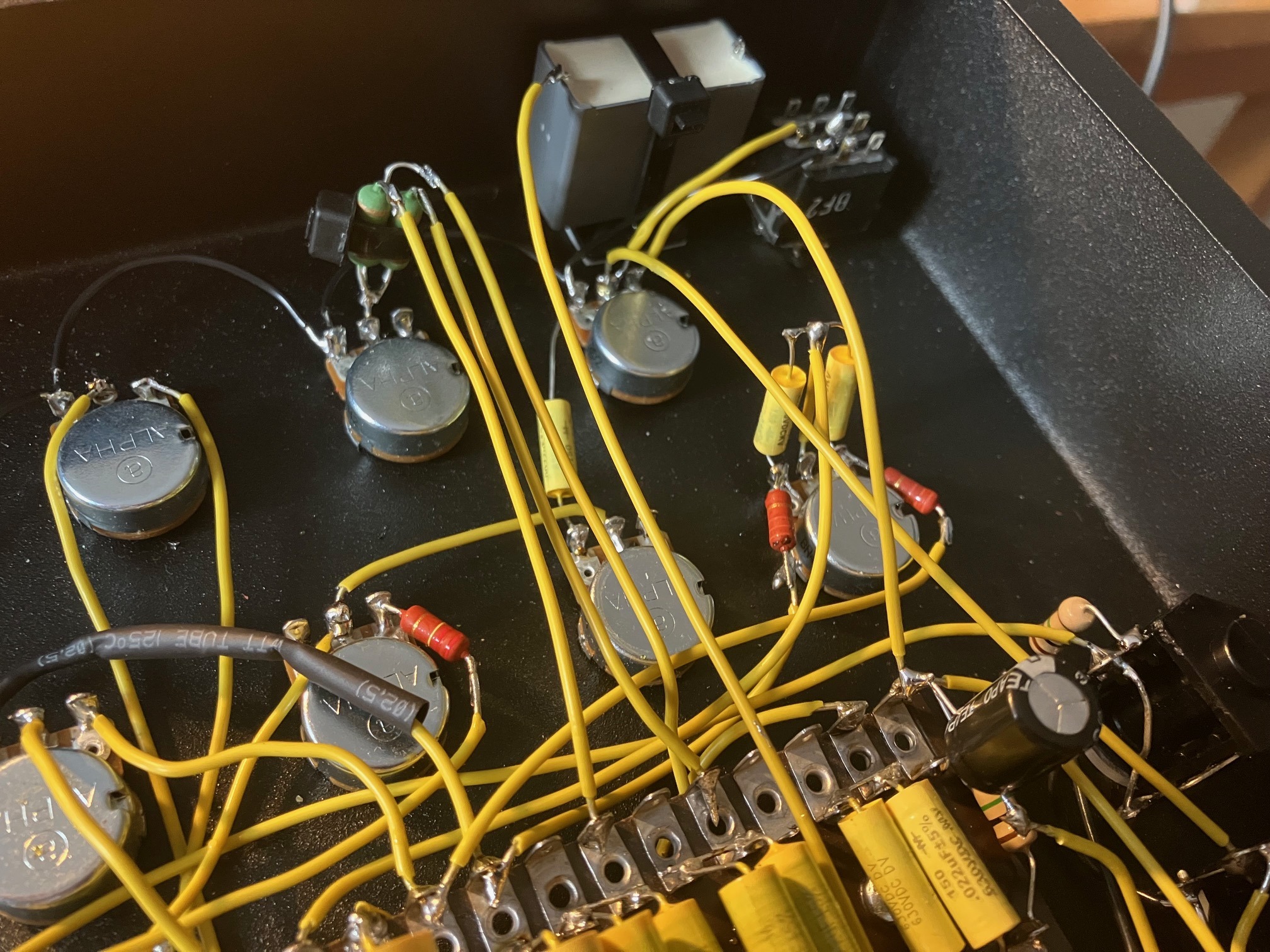

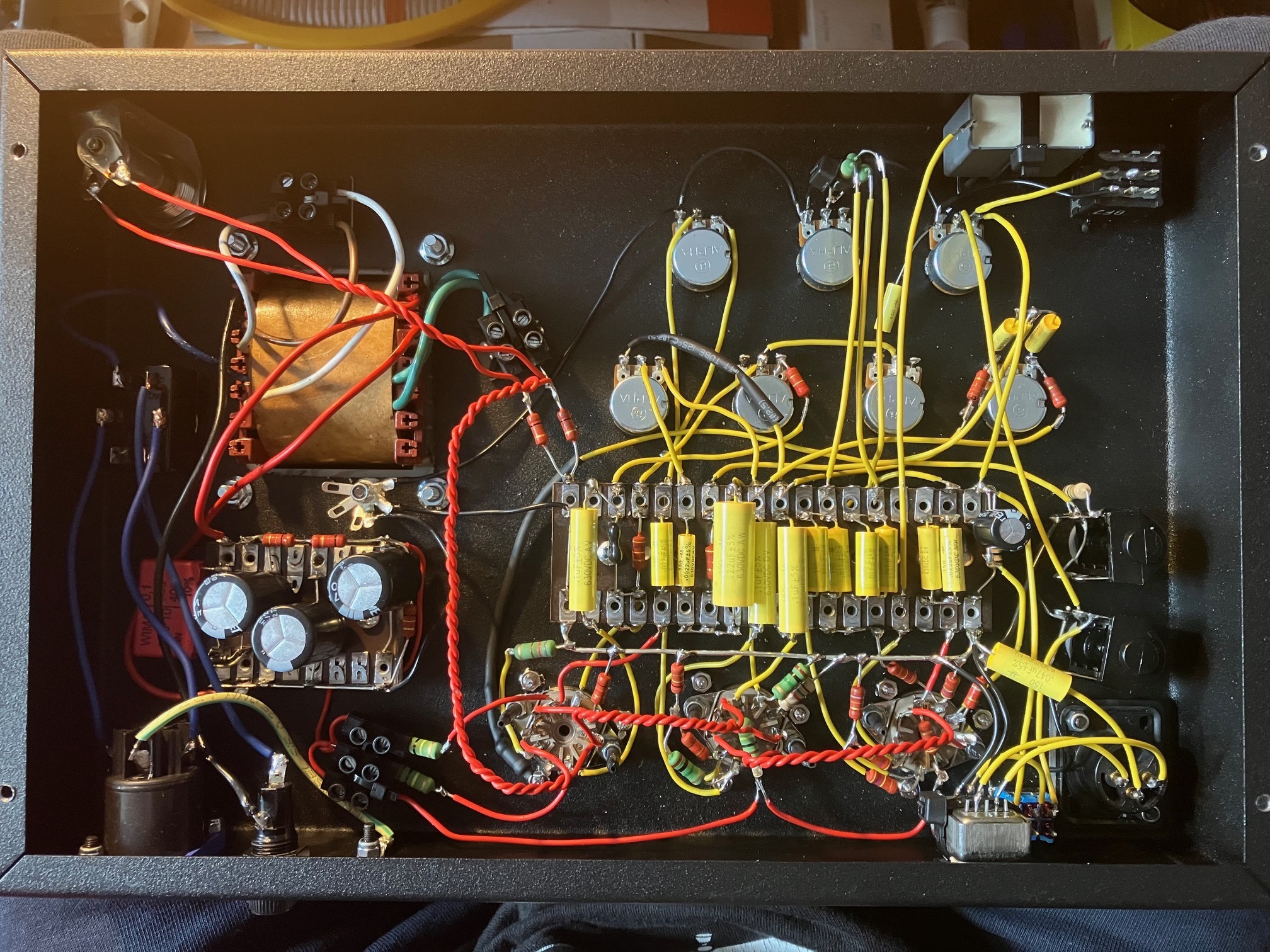

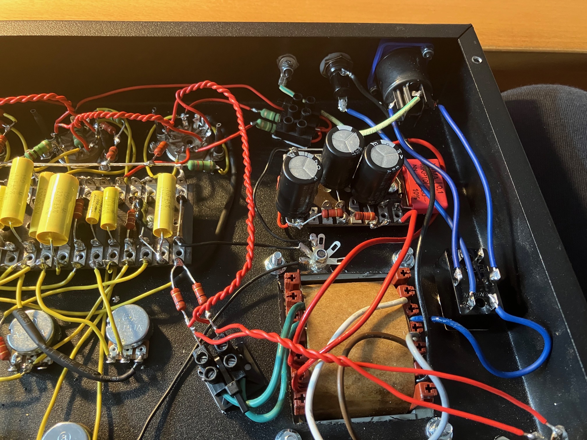

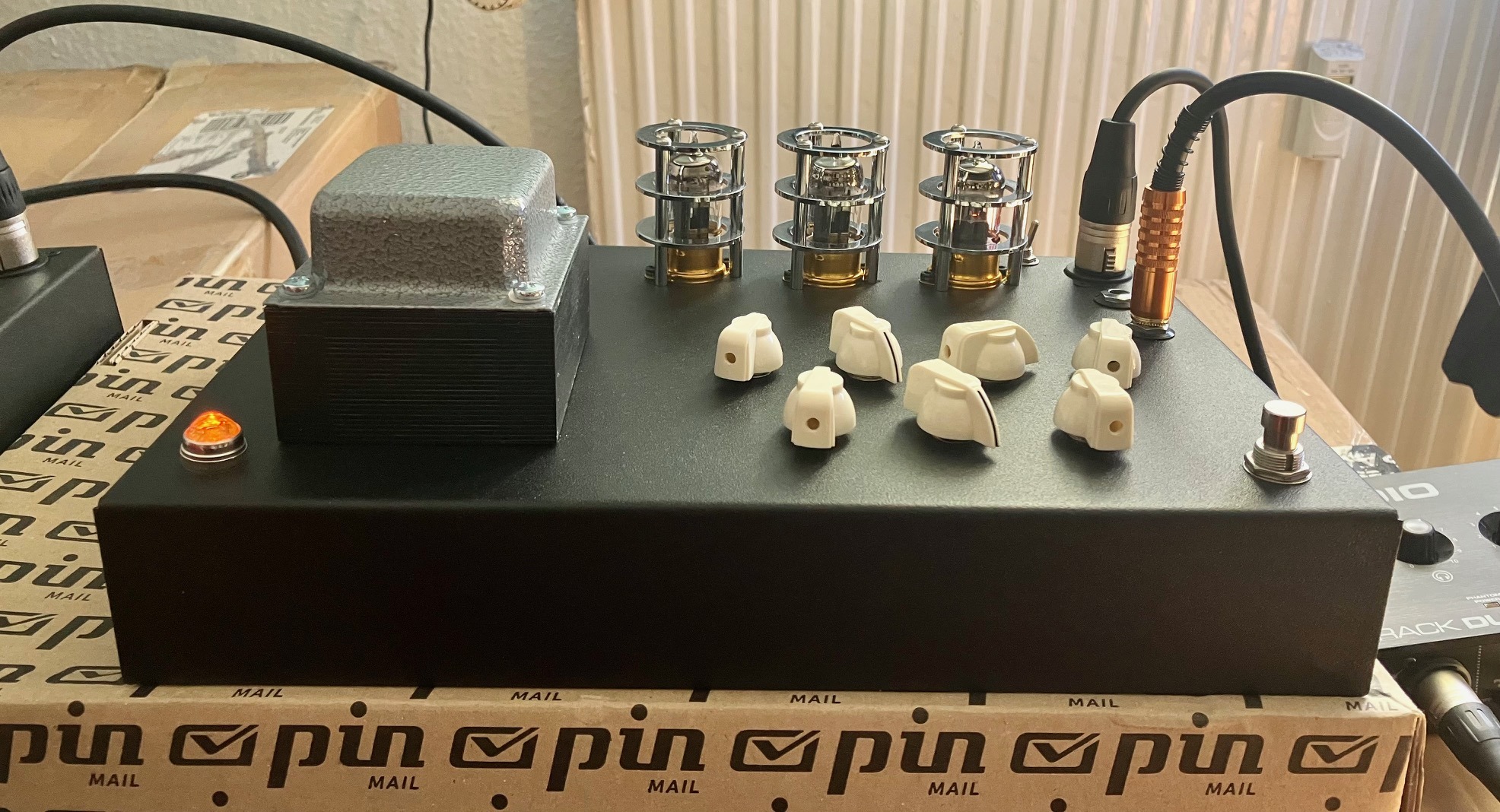

Hello friends of creative crafts, I would gratefully like to contribute something to the thread. Now I tried out the circuit and it works wonderfully. I just don't use the V3a. You can still see the wiring in my photos, but it is only intended to show what a preamp like this in my version can look like from the inside. The solder joints look worse than they actually are in the pictures due to reflections and annoying shadows. But hey, this is DIY and not a masterpiece that will pass an engineering exam. I connected the 10uF capacitor to the 25K volume pot. All 3 tubes are JJ ECC803 S. The transformer I used was the TT-PWE 50 from Tubetown, which can be mounted horizontally. By the way, Tubetown also has a toroidal transformer with the same specifications. The Hammond case, innards and tube protection cages are also from Tubetown. I once got the circuit for the power supply from a good friend, and this in combination with the transformer has worked well for all of my tube preamps so far. This means that I don't have to do anything that Freddie's circuitry provides for screening. Only the resistors for the anodes remain. No hum or noise. The transformer for D.I. Out for me is Neutrik NTM4. I deliberately placed the jacks on the top of my preamp. This is very practical when performing on small stages where it is dark and there is hardly any space. But I usually put it on my Markbass bass cube and connect the output jack to the return effect.
