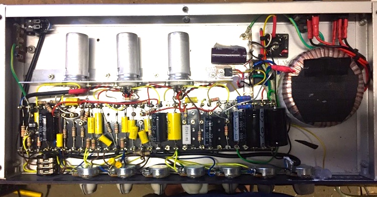

Hello friends of creative crafts, I would gratefully like to contribute something to the thread. Now I tried out the circuit and it works wonderfully. I just don't use the V3a. You can still see the wiring in my photos, but it is only intended to show what a preamp like this in my version can look like from the inside. The solder joints look worse than they actually are in the pictures due to reflections and annoying shadows. But hey, this is DIY and not a masterpiece that will pass an engineering exam. I connected the 10uF capacitor to the 25K volume pot. All 3 tubes are JJ ECC803 S. The transformer I used was the TT-PWE 50 from Tubetown, which can be mounted horizontally. By the way, Tubetown also has a toroidal transformer with the same specifications. The Hammond case, innards and tube protection cages are also from Tubetown. I once got the circuit for the power supply from a good friend, and this in combination with the transformer has worked well for all of my tube preamps so far. This means that I don't have to do anything that Freddie's circuitry provides for screening. Only the resistors for the anodes remain. No hum or noise. The transformer for D.I. Out for me is Neutrik NTM4. I deliberately placed the jacks on the top of my preamp. This is very practical when performing on small stages where it is dark and there is hardly any space. But I usually put it on my Markbass bass cube and connect the output jack to the return effect.

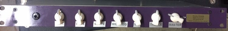

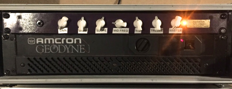

Hi Guys,
Some questions , bass player advice please.
I have 2 x Bass Quad boxes that I've been keen to do something with and this preamp seems to tick the boxes for the amps.
On the preamp - the control arrangement left to right shows
GAIN BASS SLOPE MID MIDSHIFT TREBLE VOL
whereas the JCM800
GAIN SLOPE BASS MID etc.
From a players perspective which is preferred.
