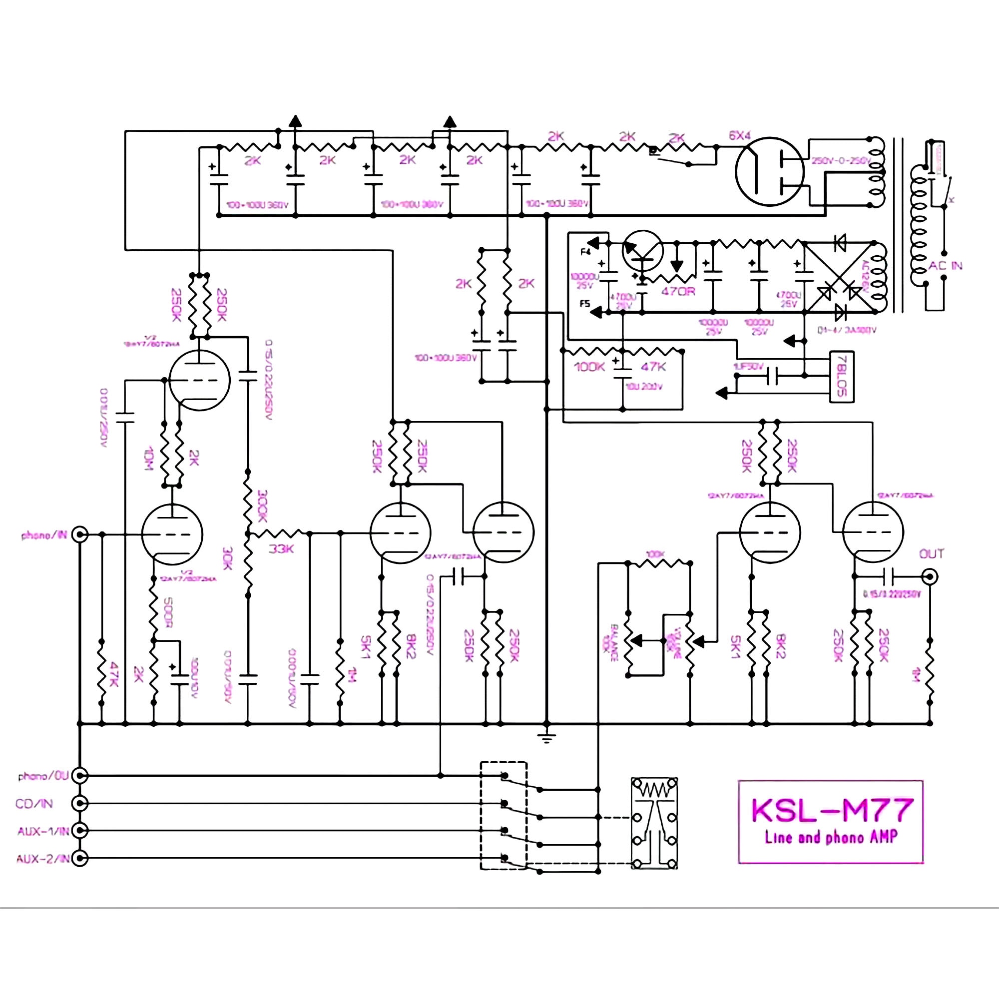

My starting point are the popular internet schematics of the M7 and KSL-M77, which have been built by many.

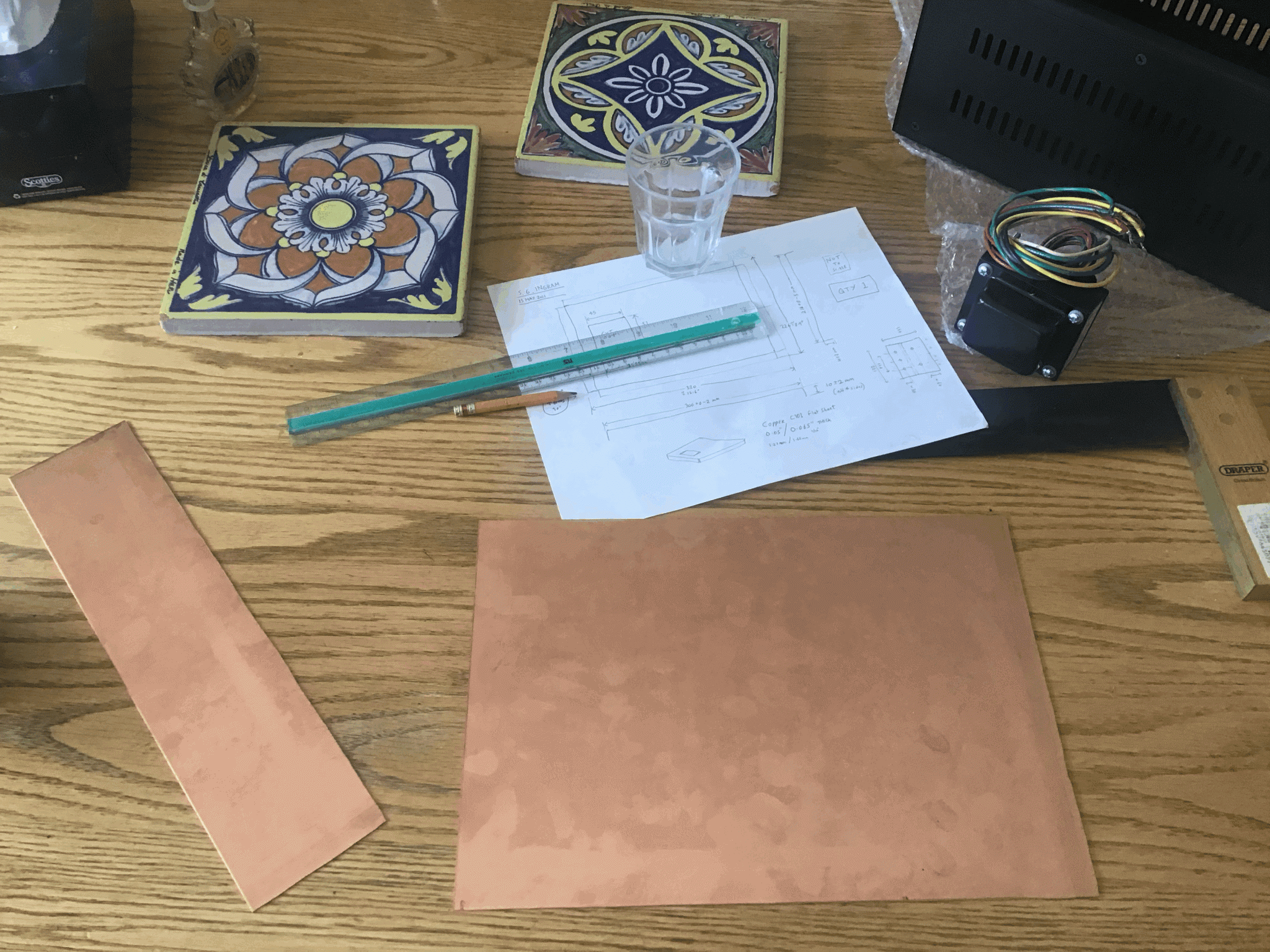

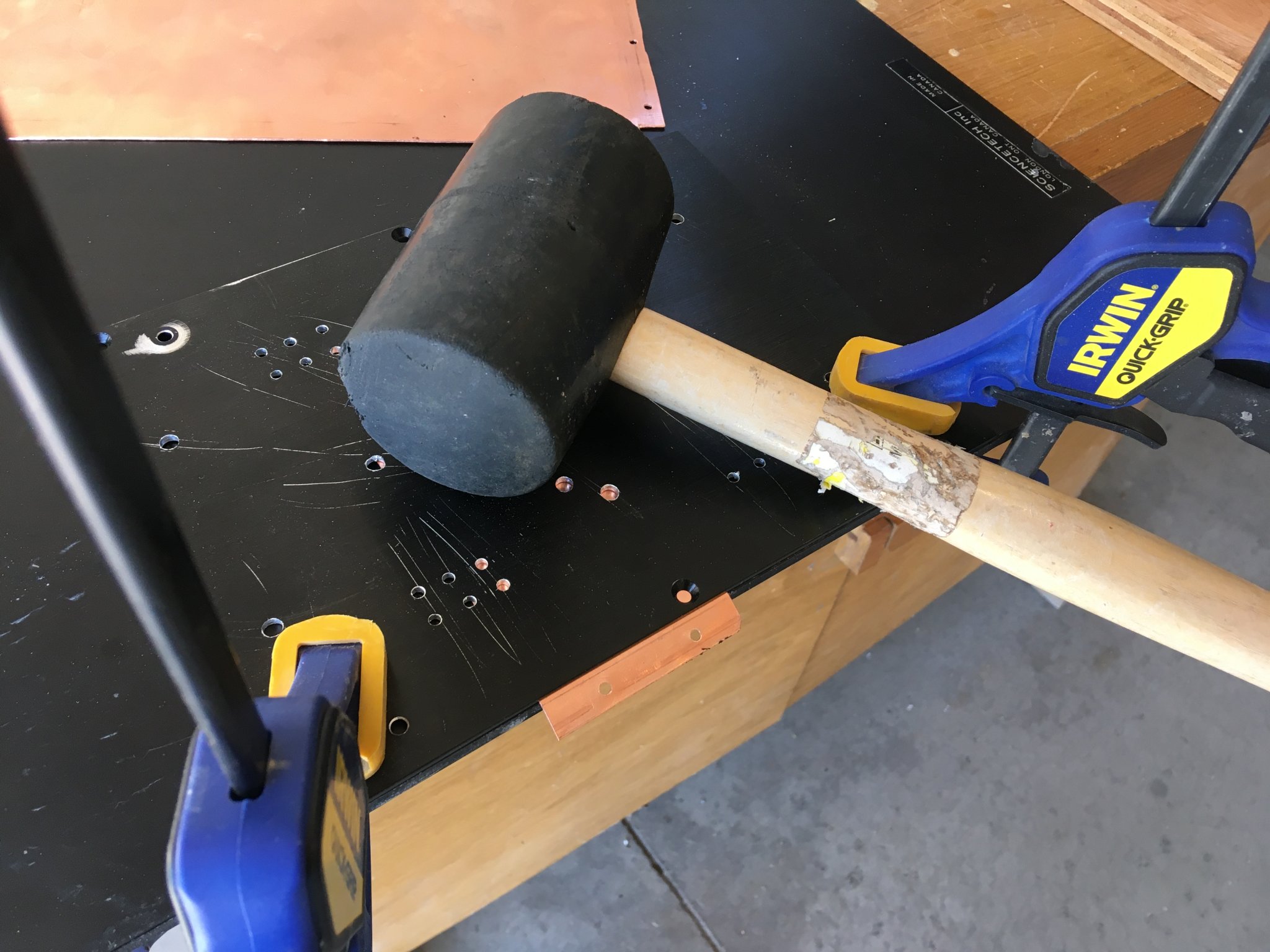

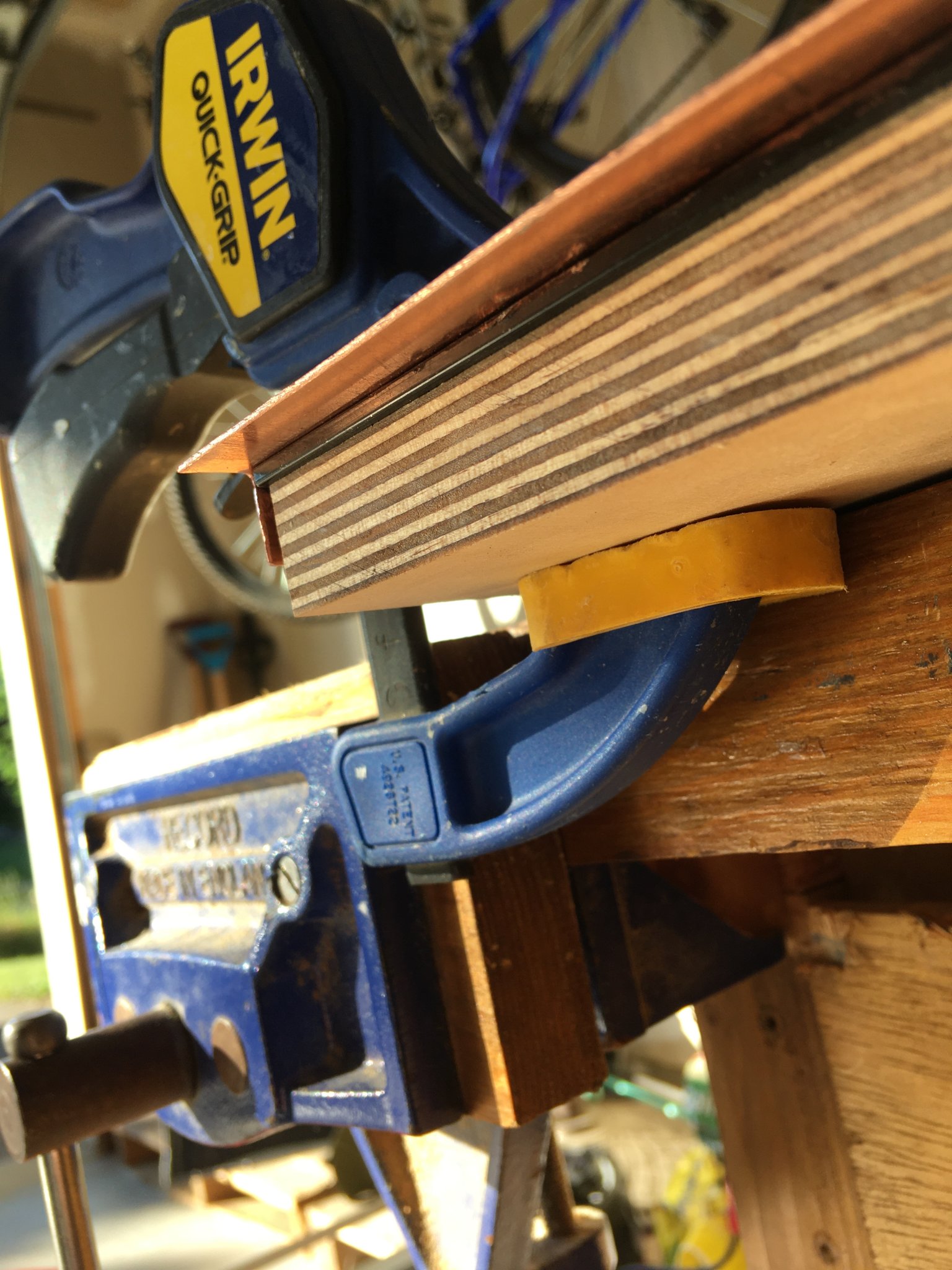

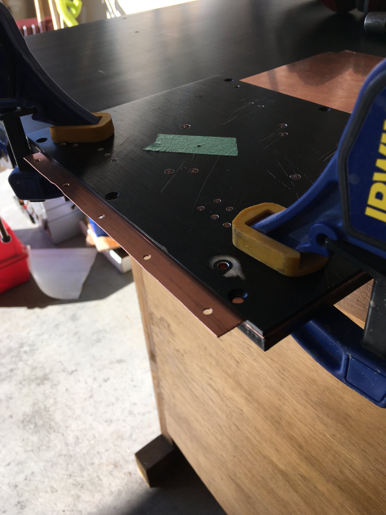

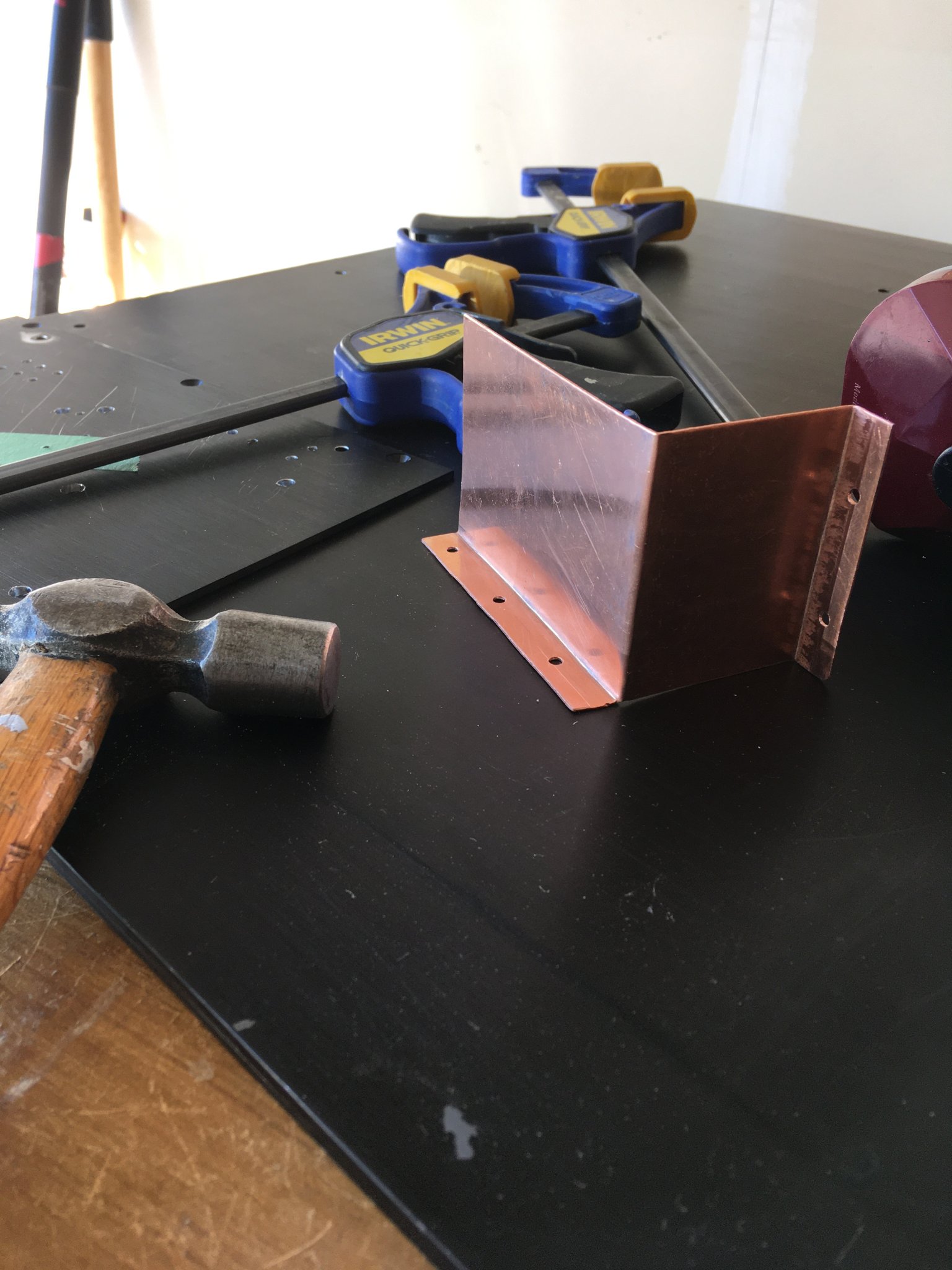

Cutting the copper wasn't too hard with a hand-held jig saw but I don't have a Brake for bending metal so this job is performed over the edge of my work bench with the aid of a rubber hammer ! I pre-drilled holes at the ends where the finished shelf will be screwed to the front panel and back panel.
It was really hard to make a clean job of this with the tools available, so it wasn't at all perfect.

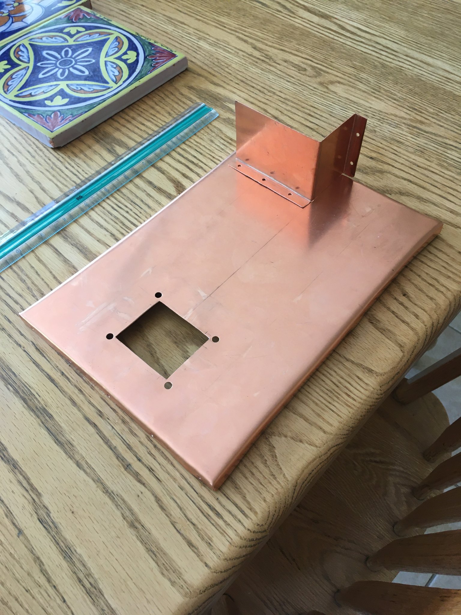

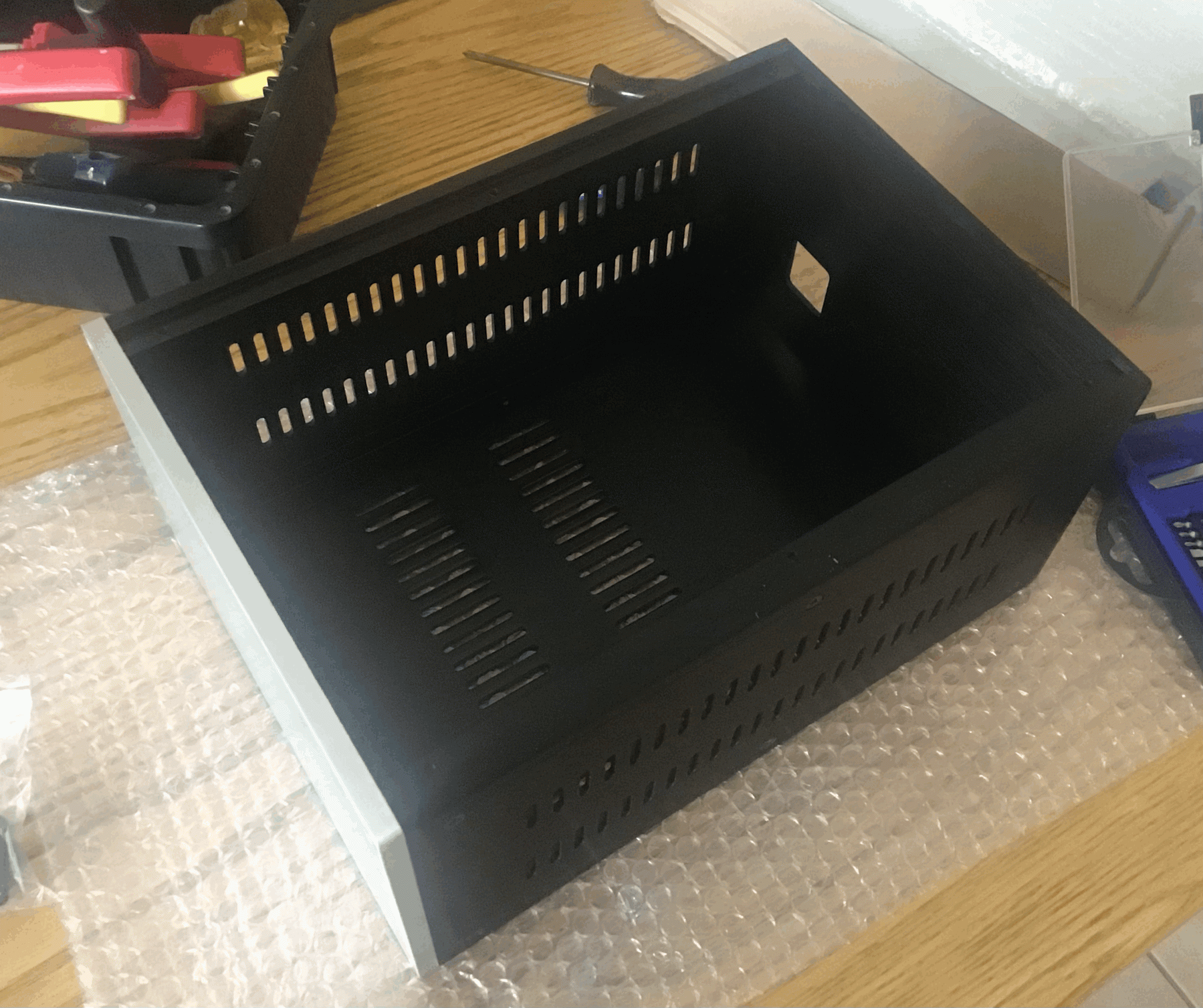

And here's the shelf, along with the bracket that will hold the input selector switch and act as a shield for the input RCA connectors at the back panel.
The transformer cut-out has been positioned to match the M7 as closely as possible, judging by eye. The cut-out has been sized to suit a Hammond transformer, an off-the-peg power transformer which has been designed for horizontal chassis mounting like this.

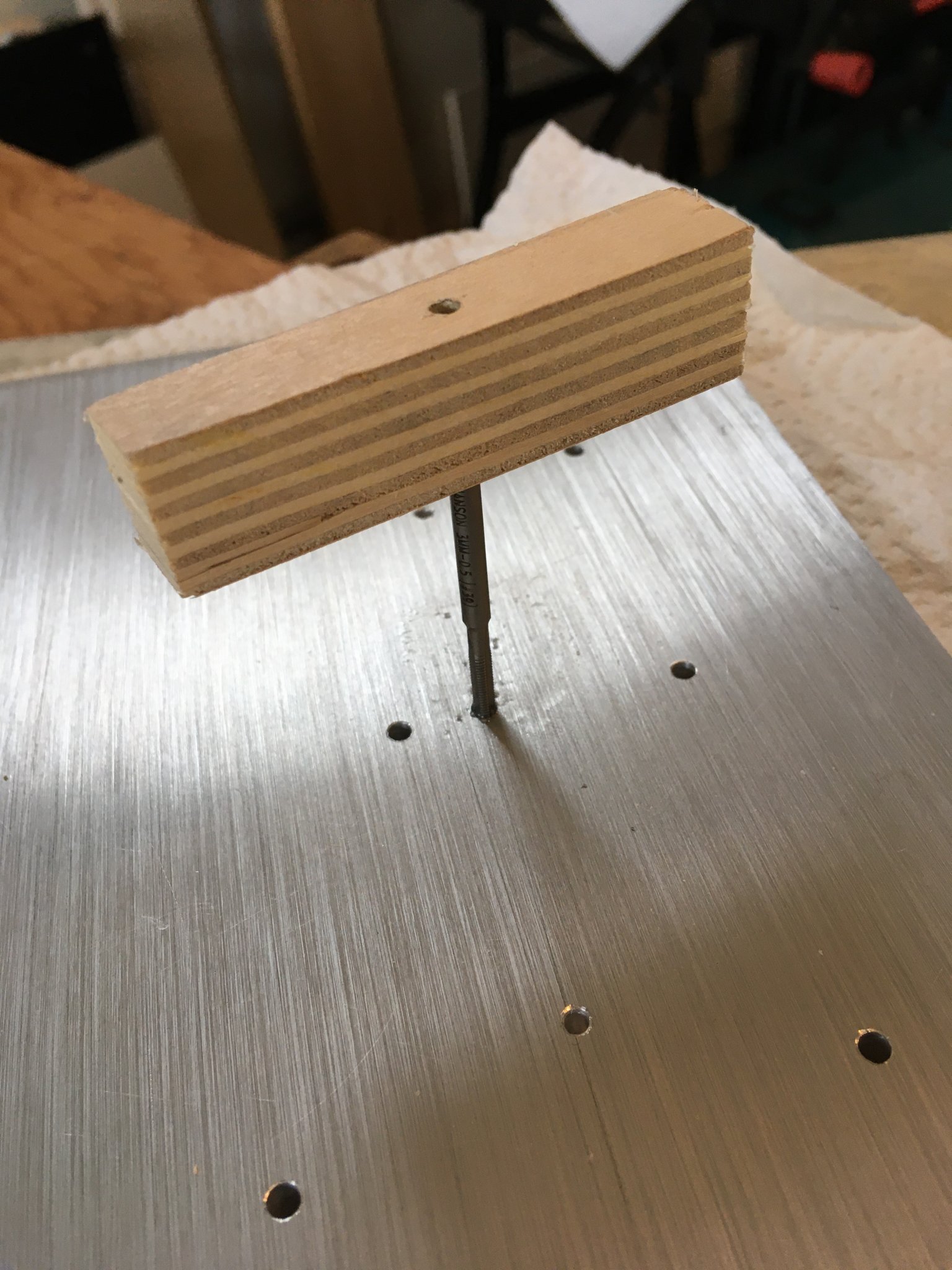

The front plate is drilled with pilot holes for the controls, trying to match their positions as closely as I can by-eye to the M7 photos.
The front plate is 8mm thick so nice to work with. And it allows me to create blind-tapped mounting holes on the inside of the front plate for the copper shelf to screw on to. I bought some taps but baulked at the cost of those traditional tap holders and instead I just made up something from an off-cut of birch plywood. This was perfectly fine for some careful hand work at a M3 thread size.

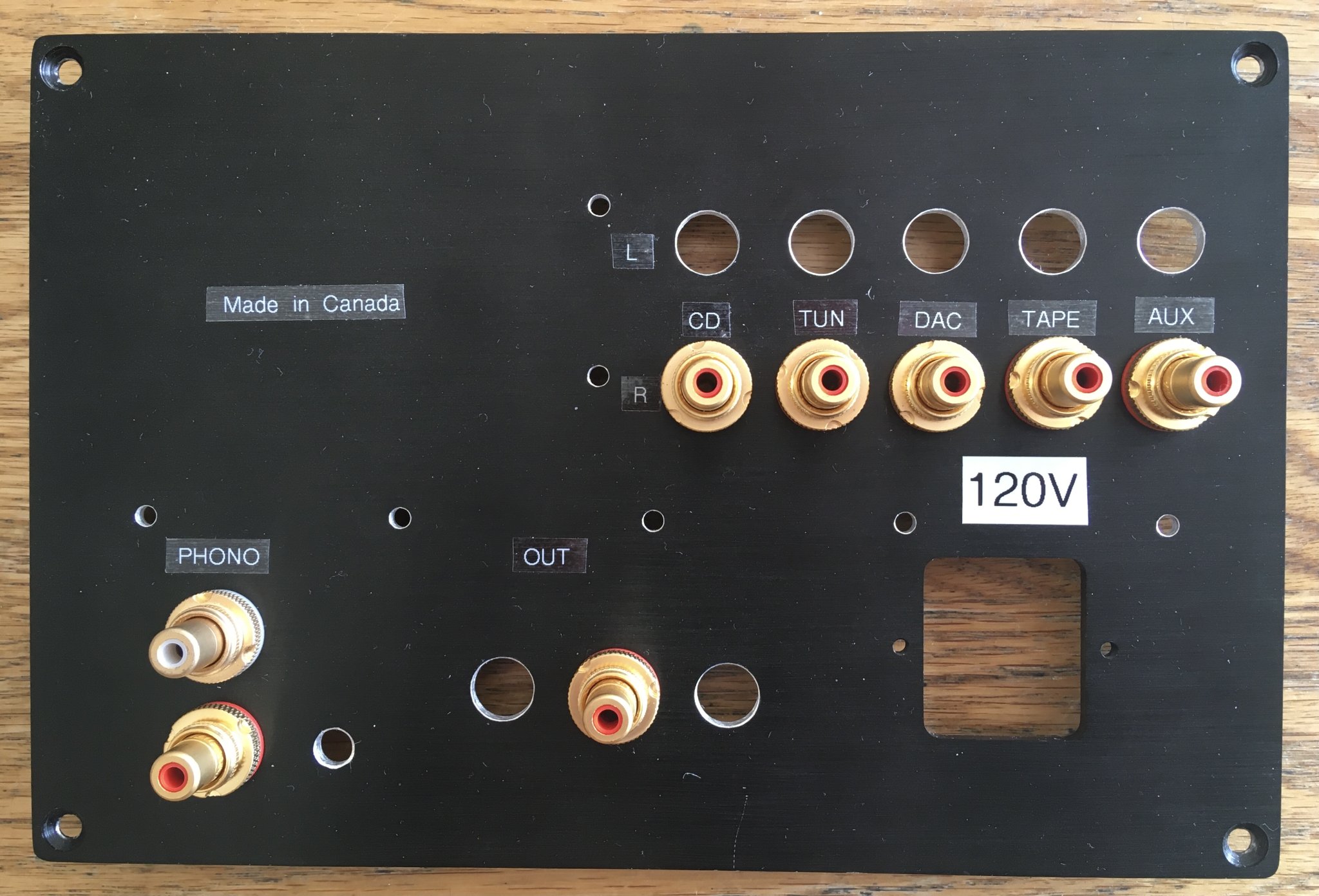

This is my attempt at reproducing it.
This is where a label maker comes in handy!
It’s not an exact clone but certainly in the same vein. I’m not yet decided whether to to install all the inputs because my build will be mono. I may just install some blank covers. Before you wonder why anybody would have stereo inputs for a mono preamp … it’s because there are options to choose, a) take the R channel, b) take the L channel, c) combine L + R channels. I haven’t decided which approach to take yet.

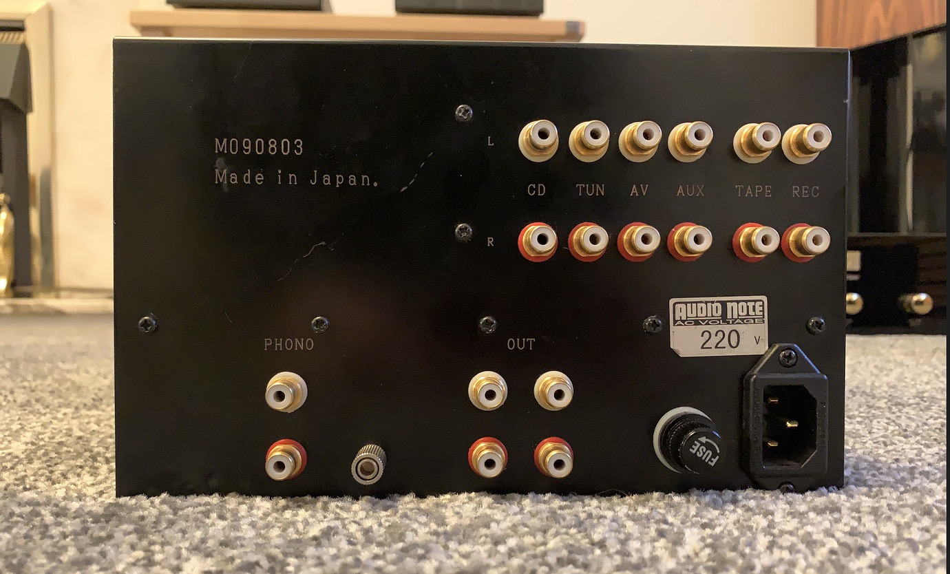

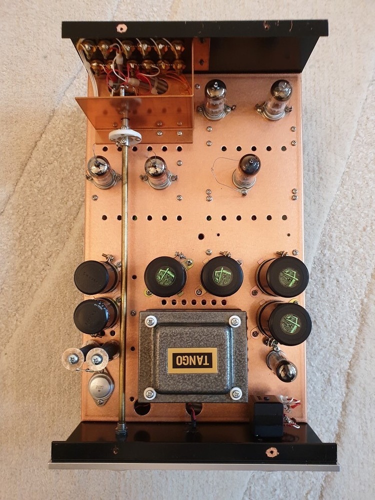

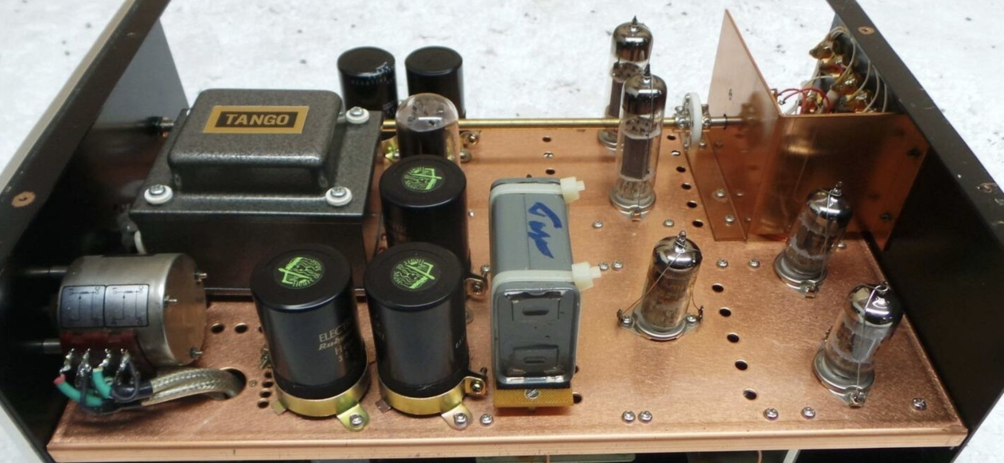

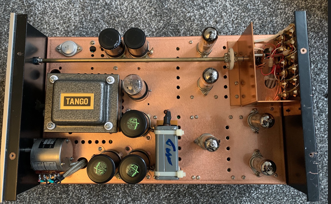

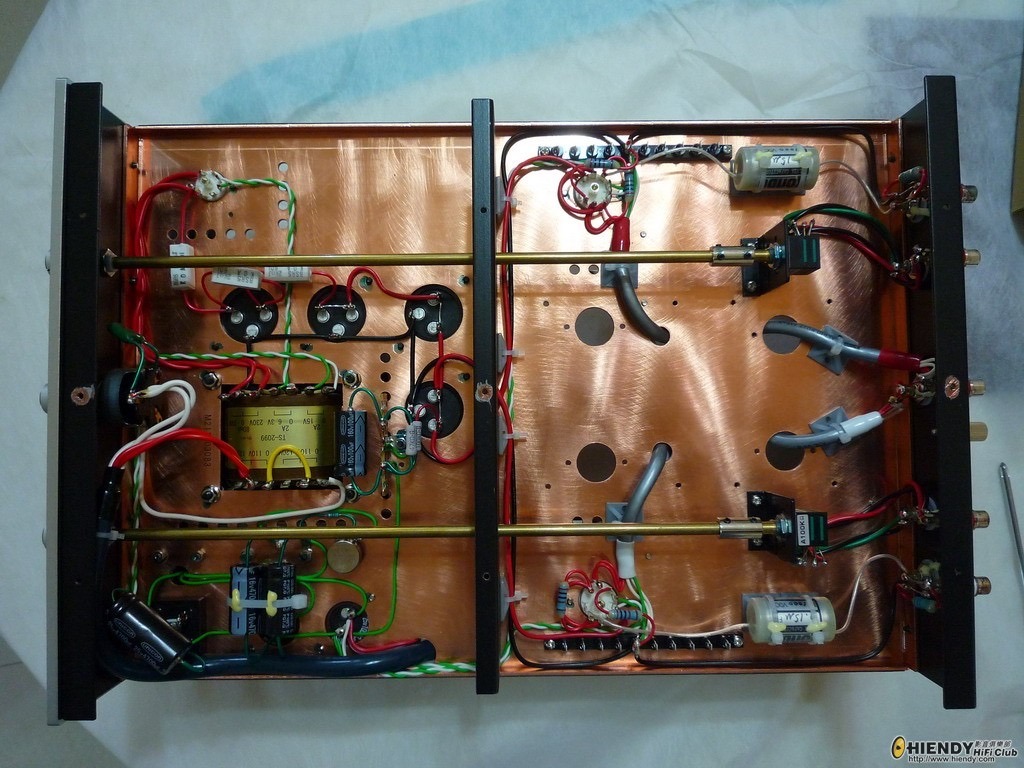

The wiring in the M7, as you might expect, is mostly on the underside. I am surprised though, at the apparent lack of use of rubber grommets which are usually recommended when wiring passes through holes in metal sheet.
The whole thing has that hand built look to it, which no doubt it was. There are instances of circuit boards being used for through hole components (mostly capacitors) but more out of necessity than of want to have any kind of pcb at all.
