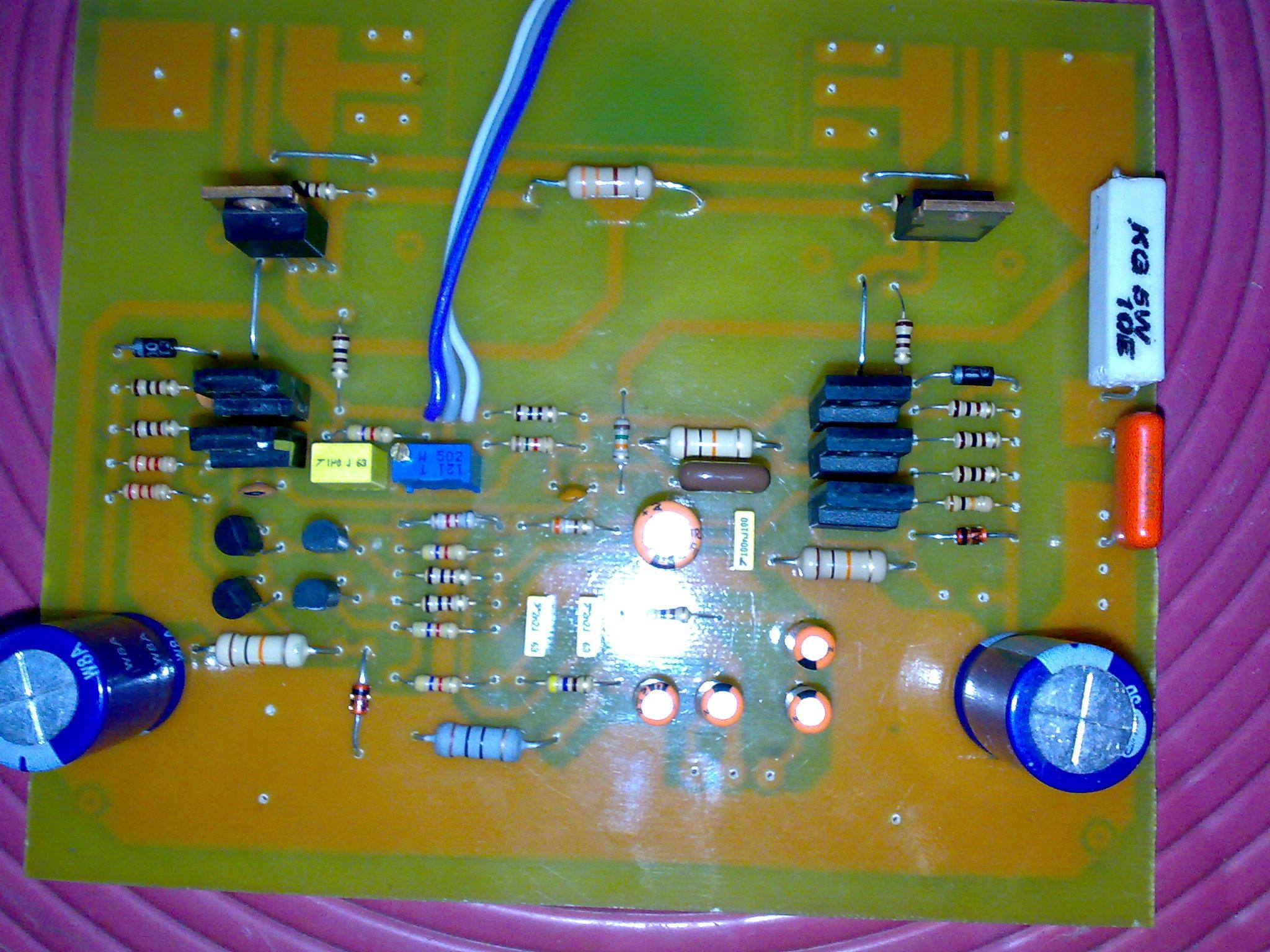

build NEW AV800 / AV1000 MOSFET AMP IRFP240 IRFP9240

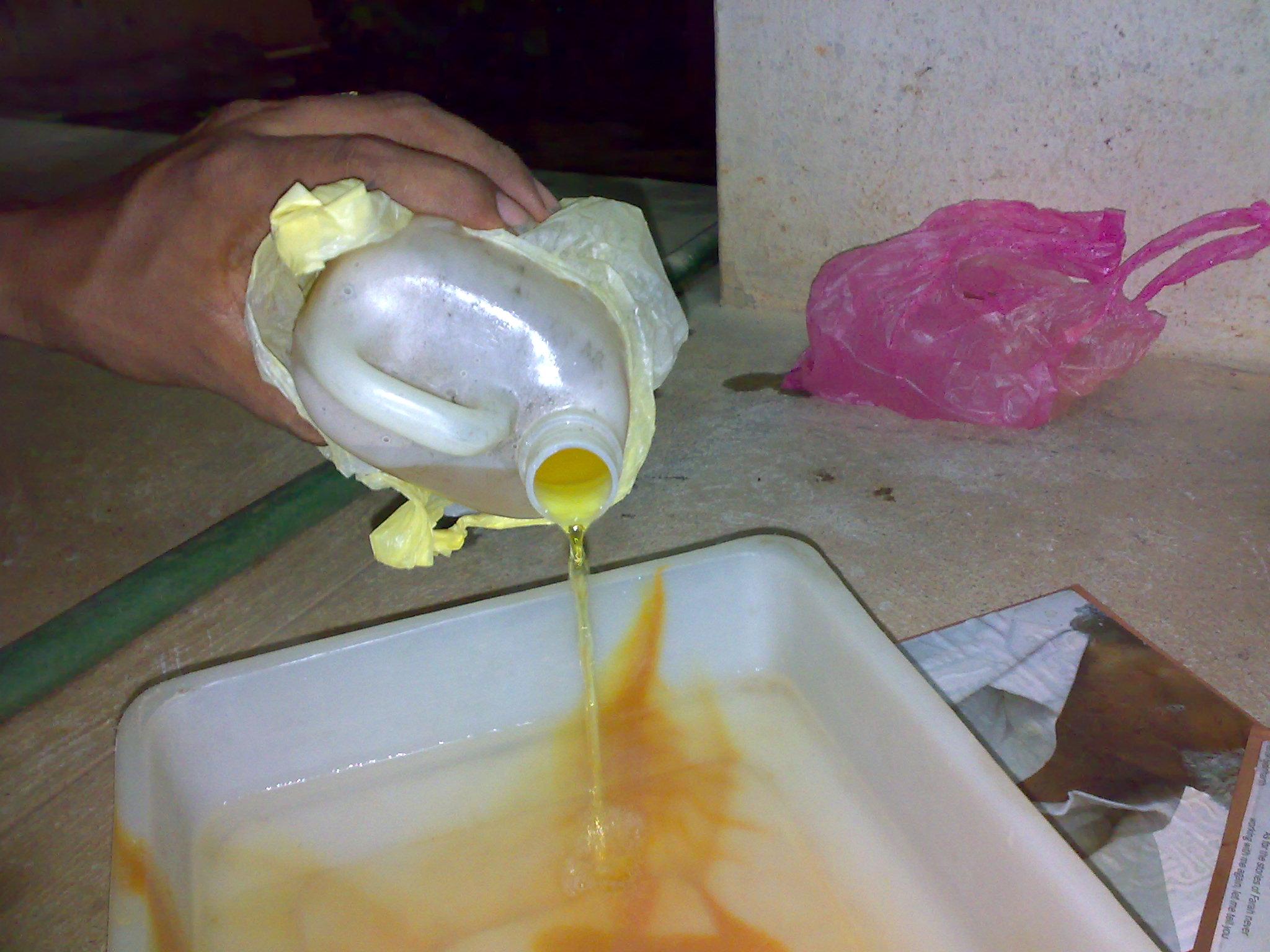

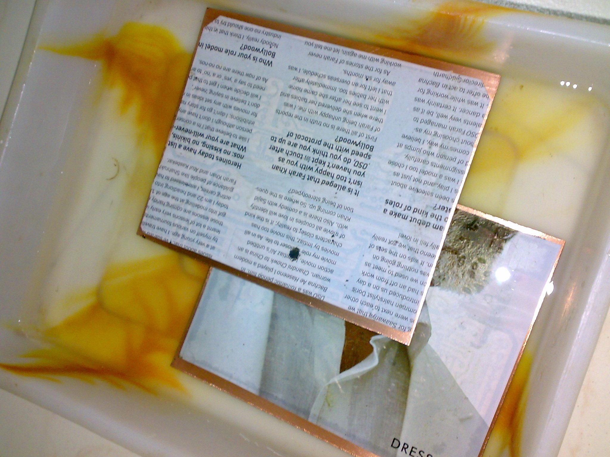

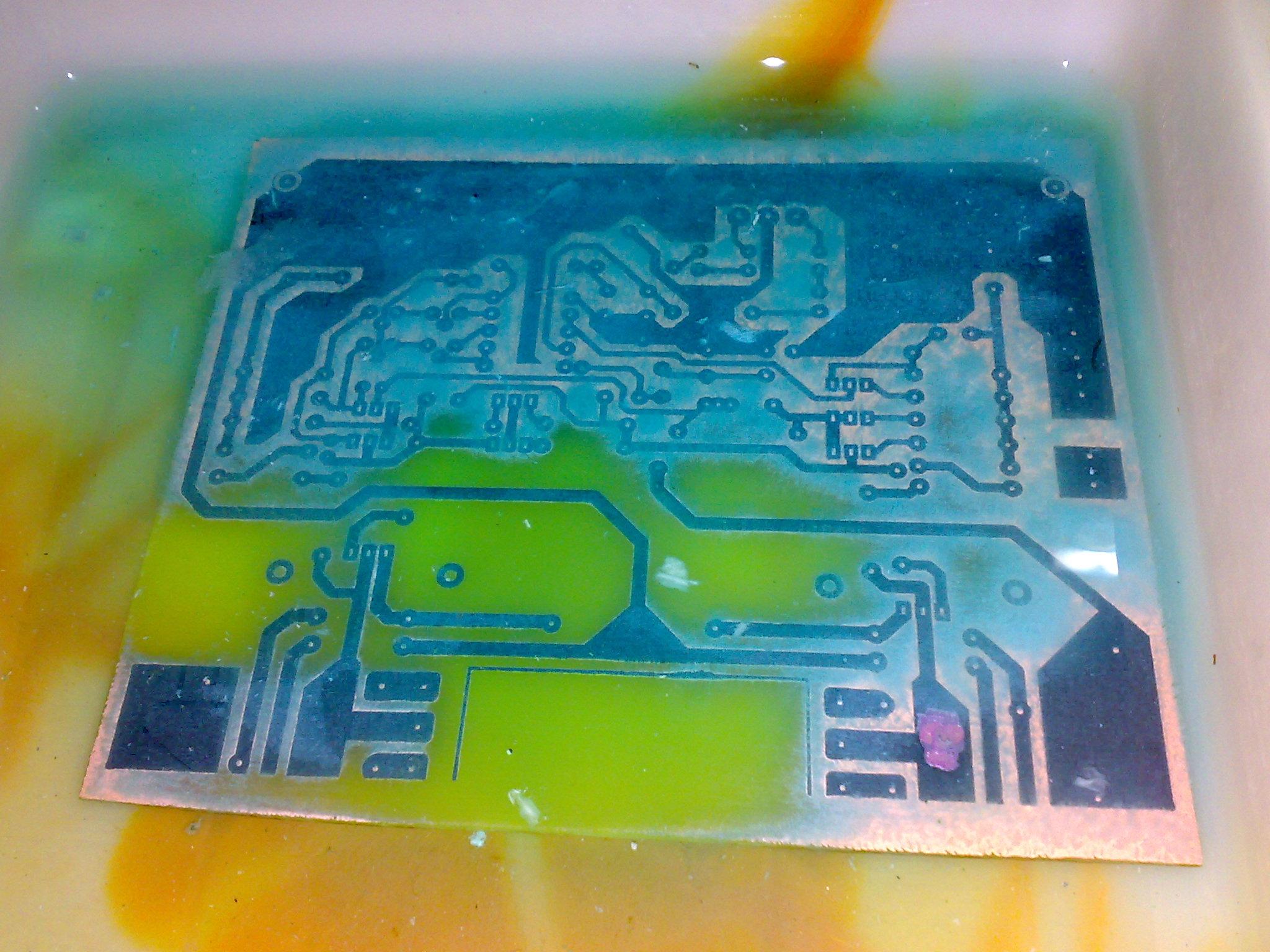

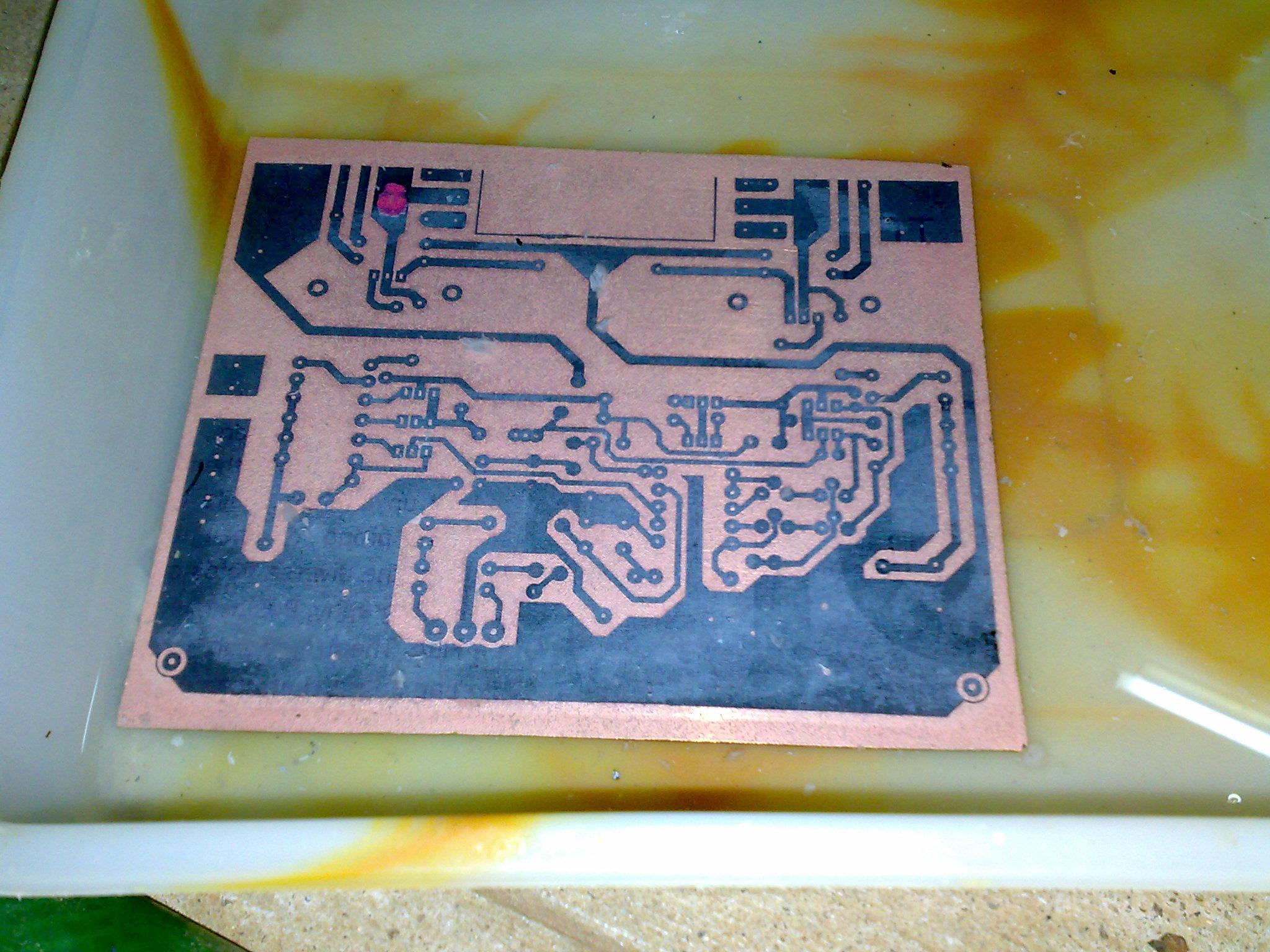

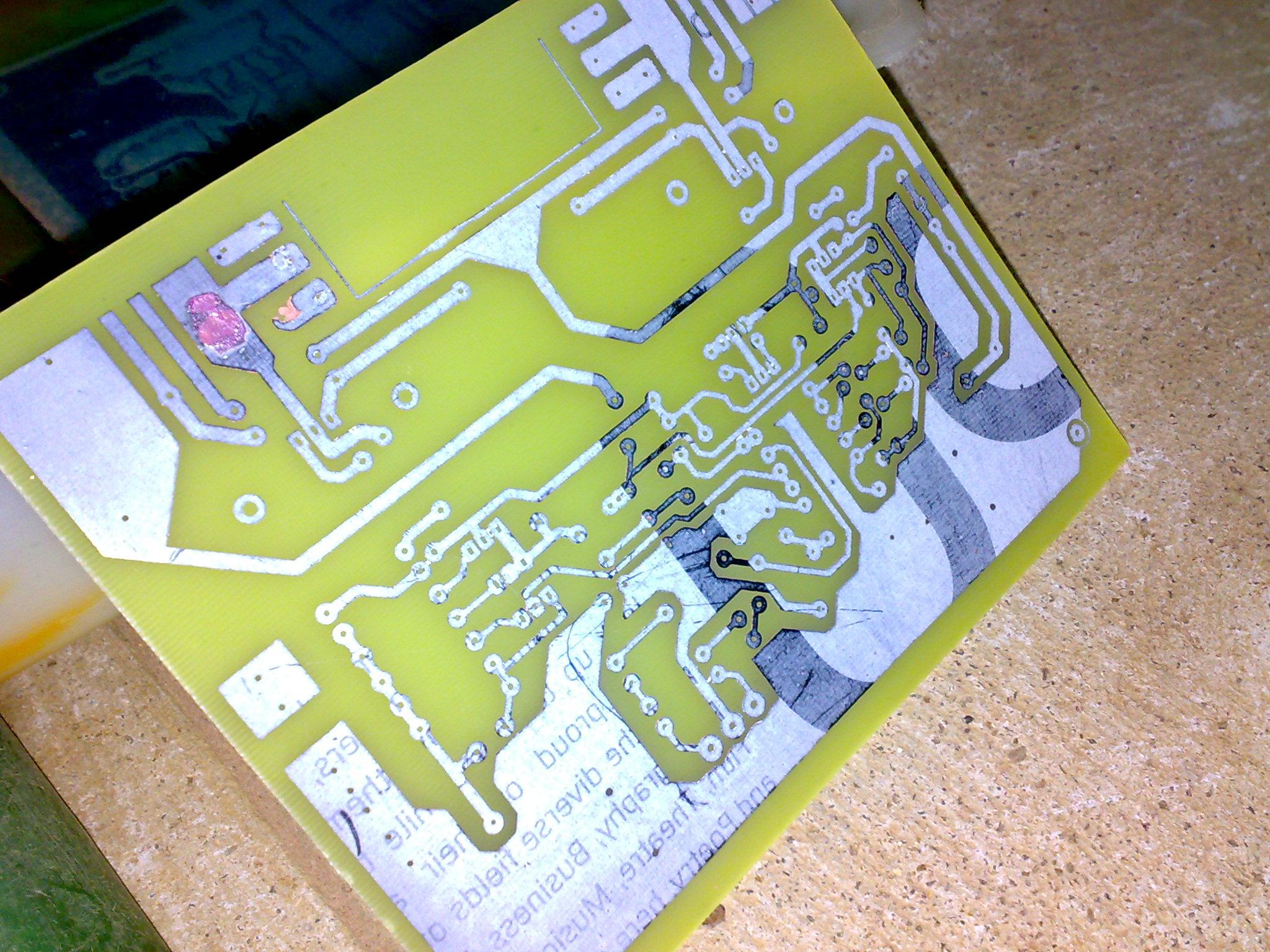

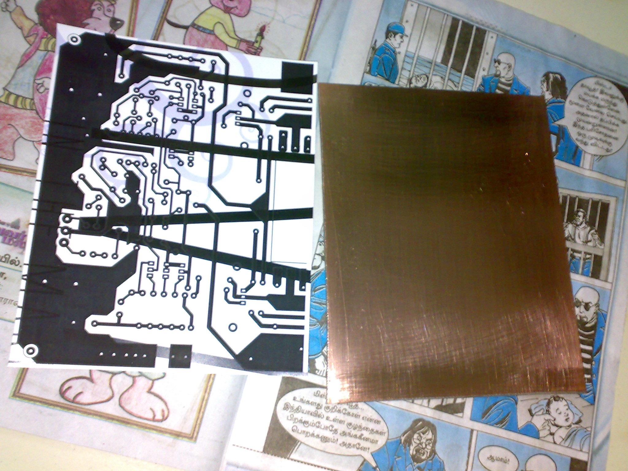

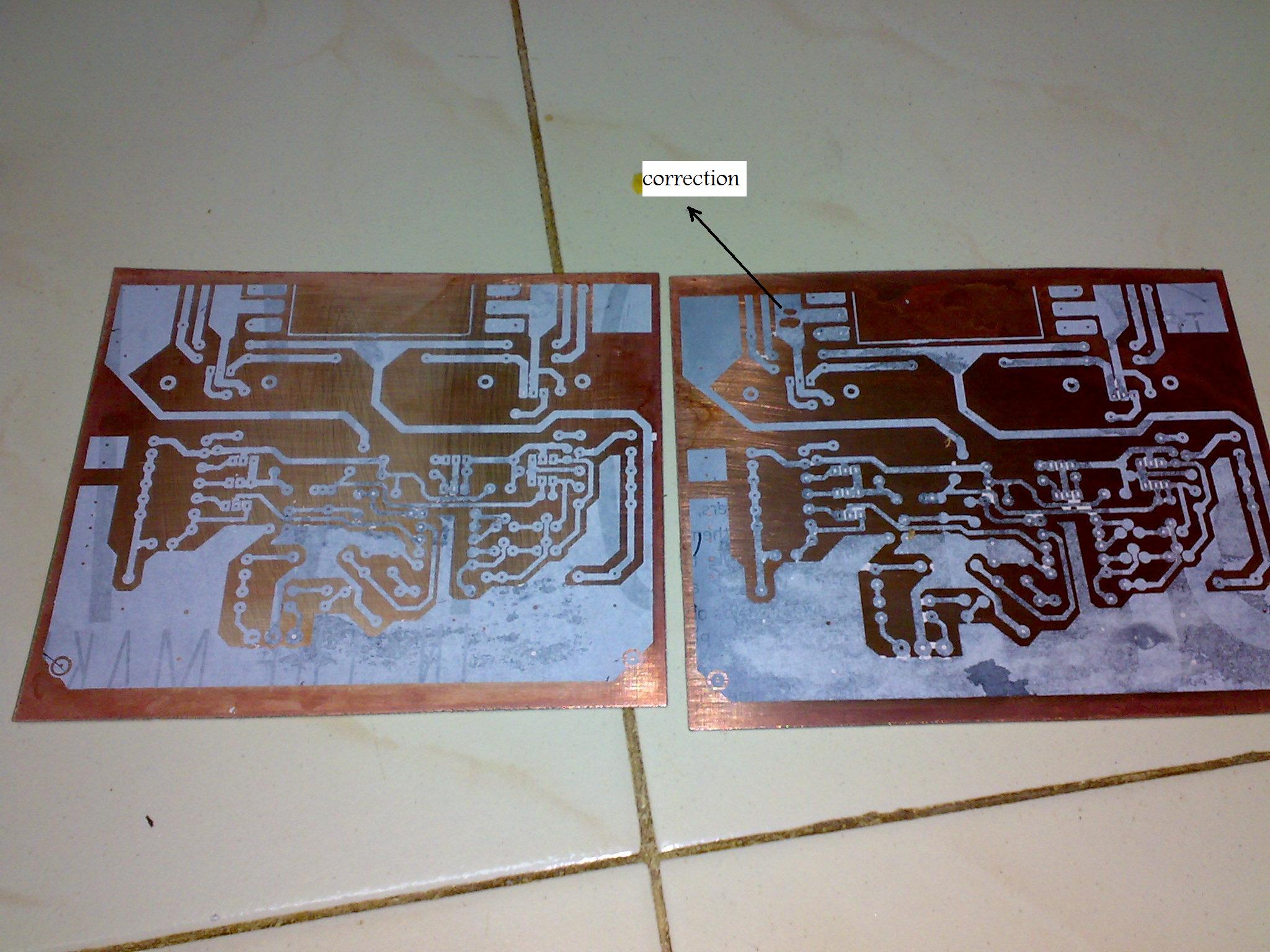

today i started my amp....

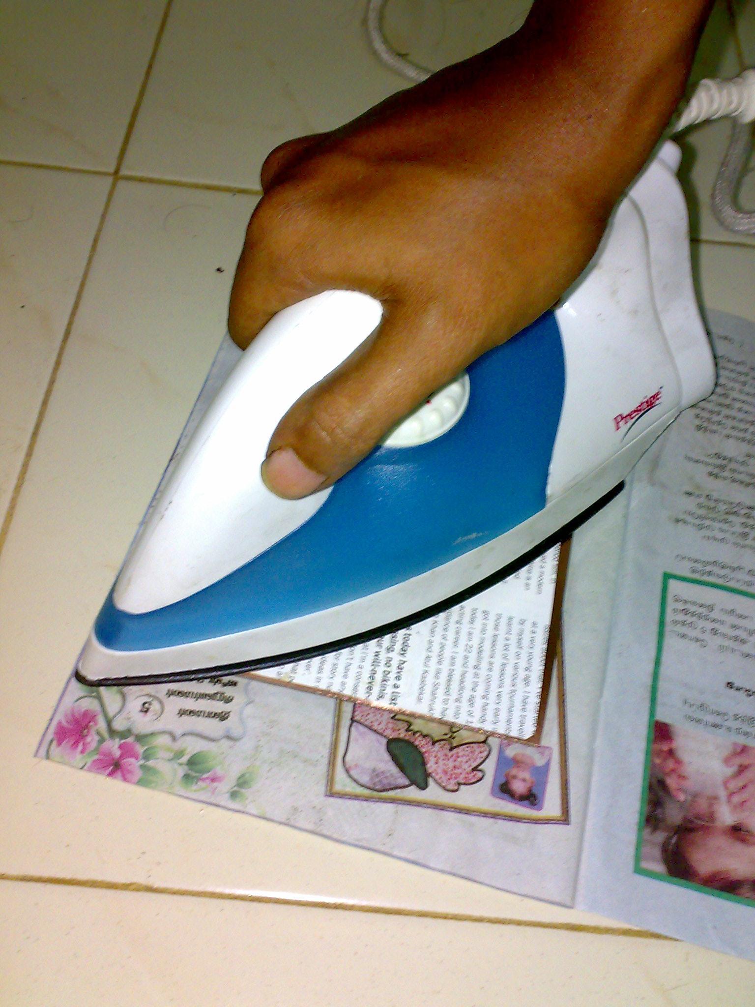

1) print file laser printer.
2) clean pcb board and paper to pcb use iron box with 10min over all press.
3) move to water....
4) mix acid and water to basin..

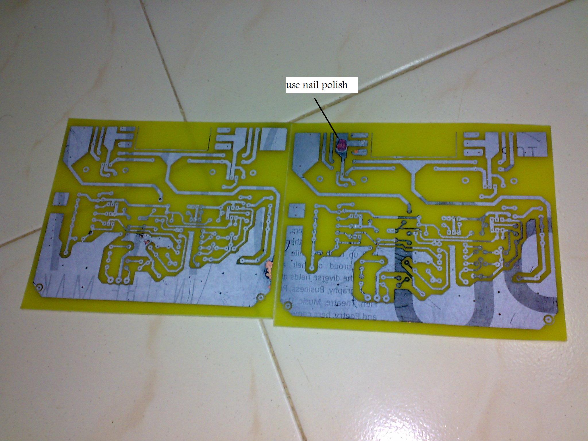

5) light touch pcb to mixed acid and clean with water and remove paper and touch with cloth and apply nail polish to use some print correction after etching...
6) and mixed acid etching...
7) finish pcb board..

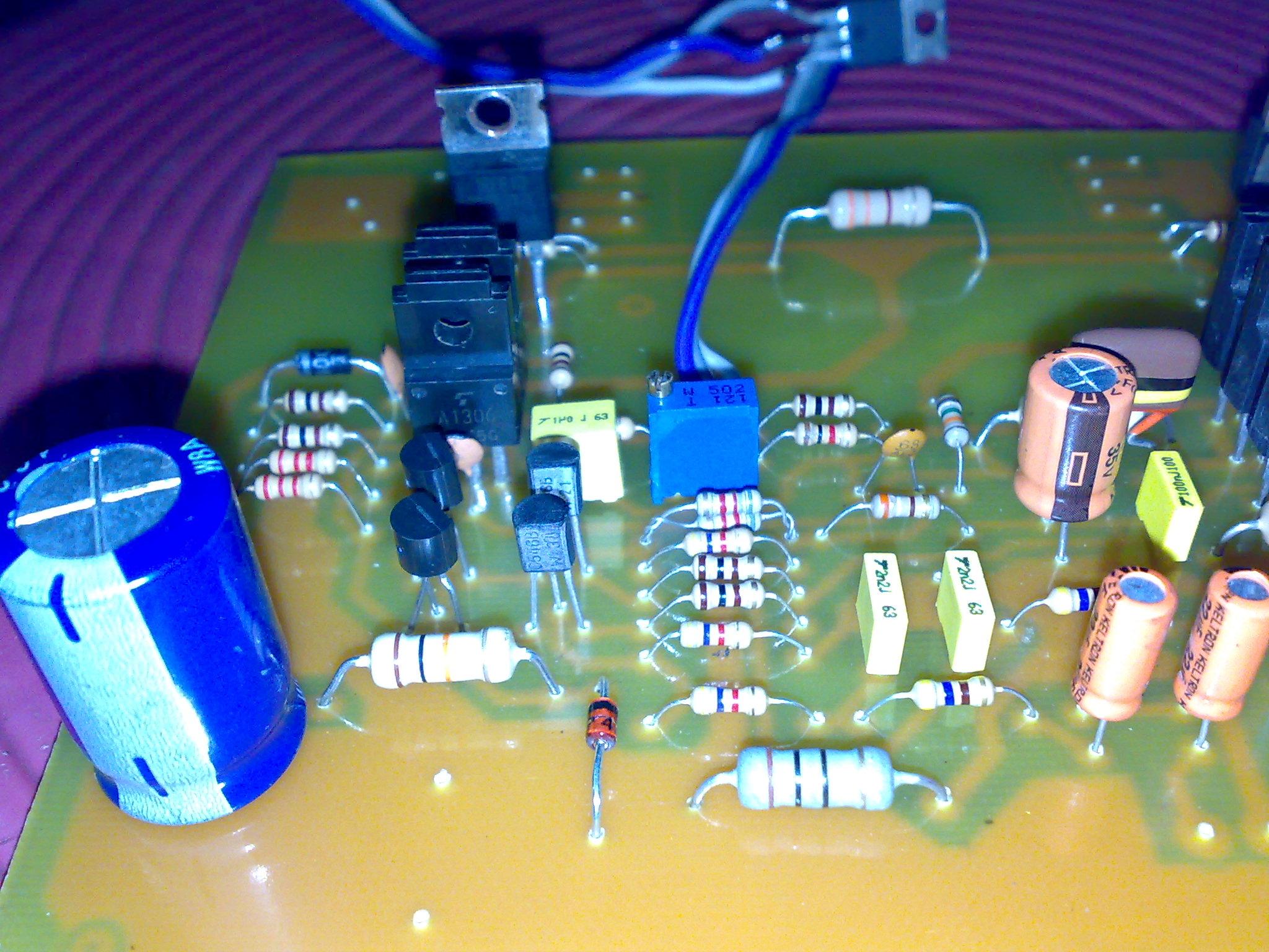

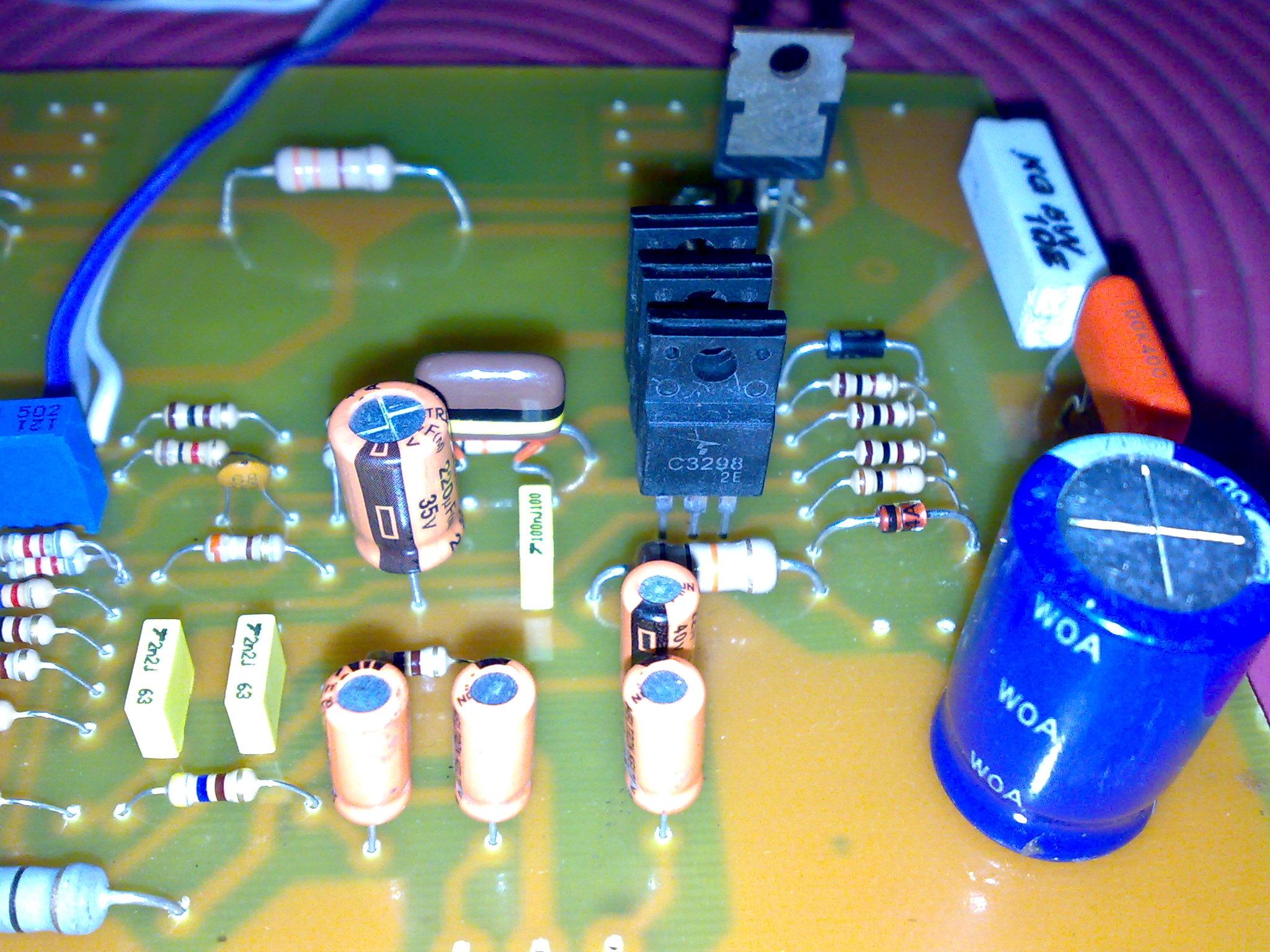

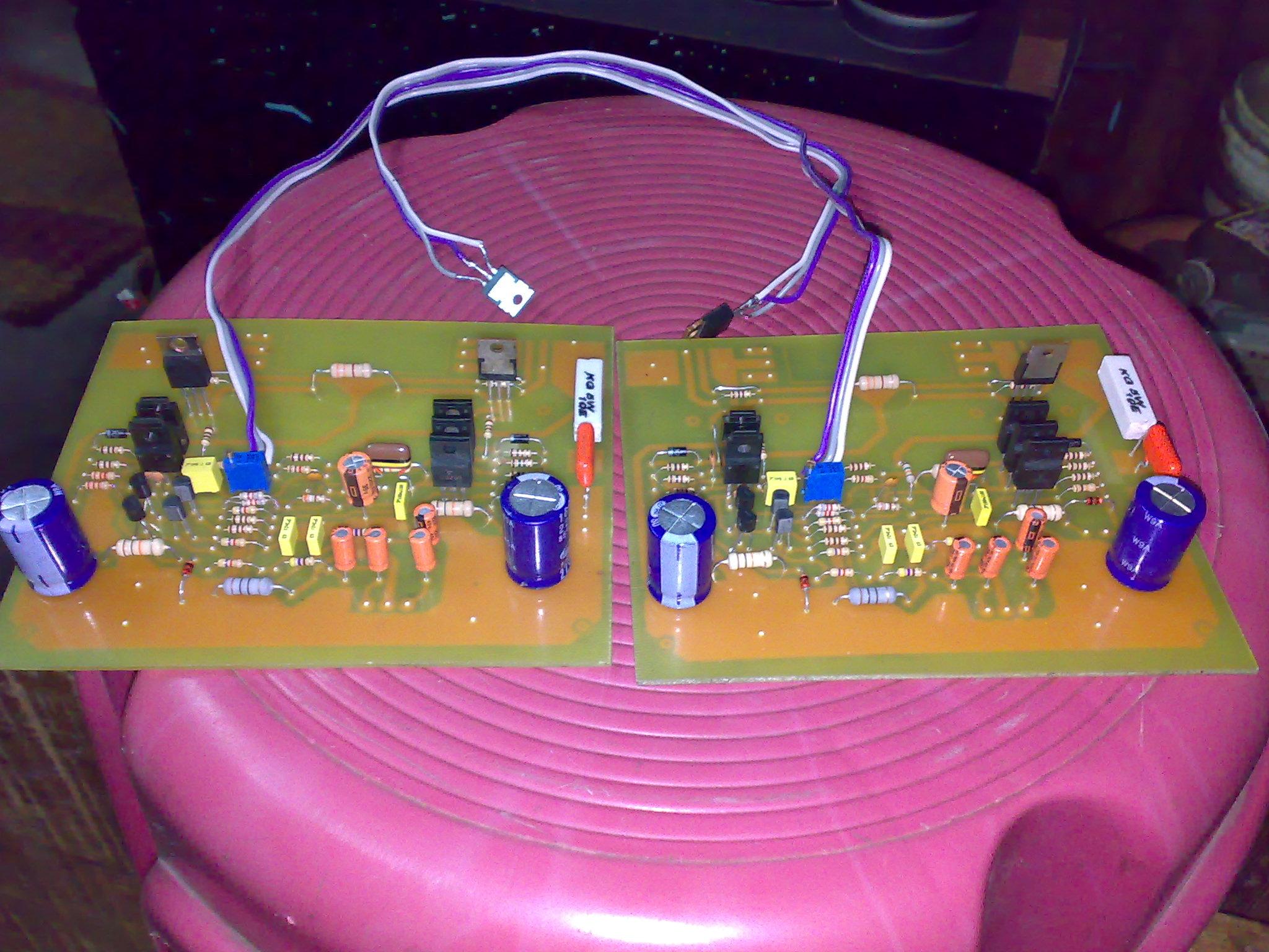

next drilling and component mounting...

hi ashok,
glad to see this.would you like to tell me that how can i get pcb print from the circuit.and also mention that mix which acid with water in basin.thanks
Report Post Reply With Quote
i used Nitric Acid.. Nitric Acid 1% + water 1% or 2%
and install pdf printer or install adobe acrobat to print pdf formad and many options
in acrobat.
use circuit pcb software eagle or sprint layout , livewire and more.....
