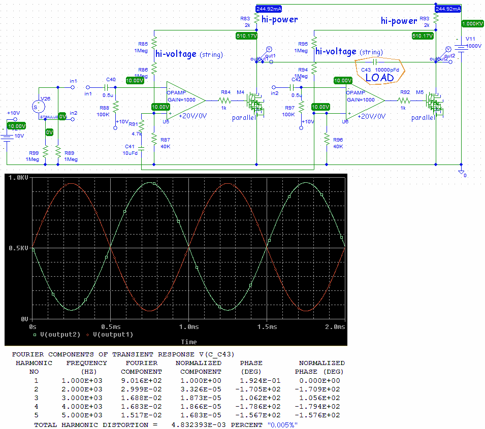

_IF_ you can define the load, the thing practically builds itself. Do not know what you are asking.
I have done exactly this (attached) for an oscilloscope, except at 1/500th the power.

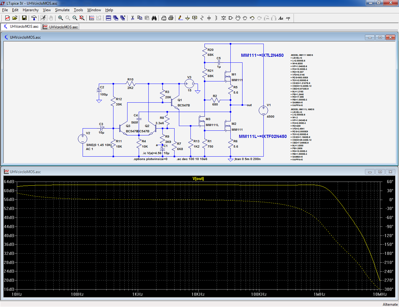

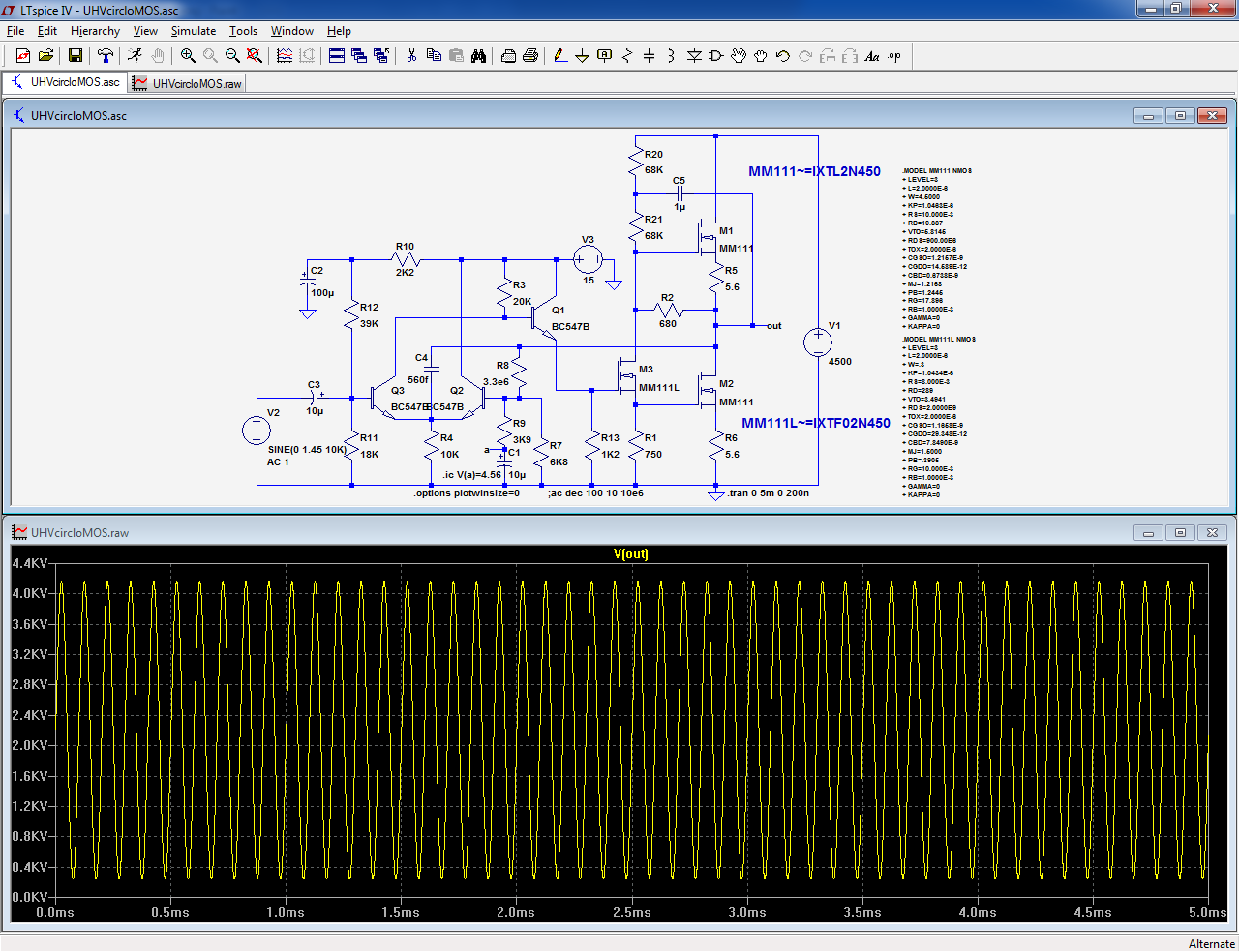

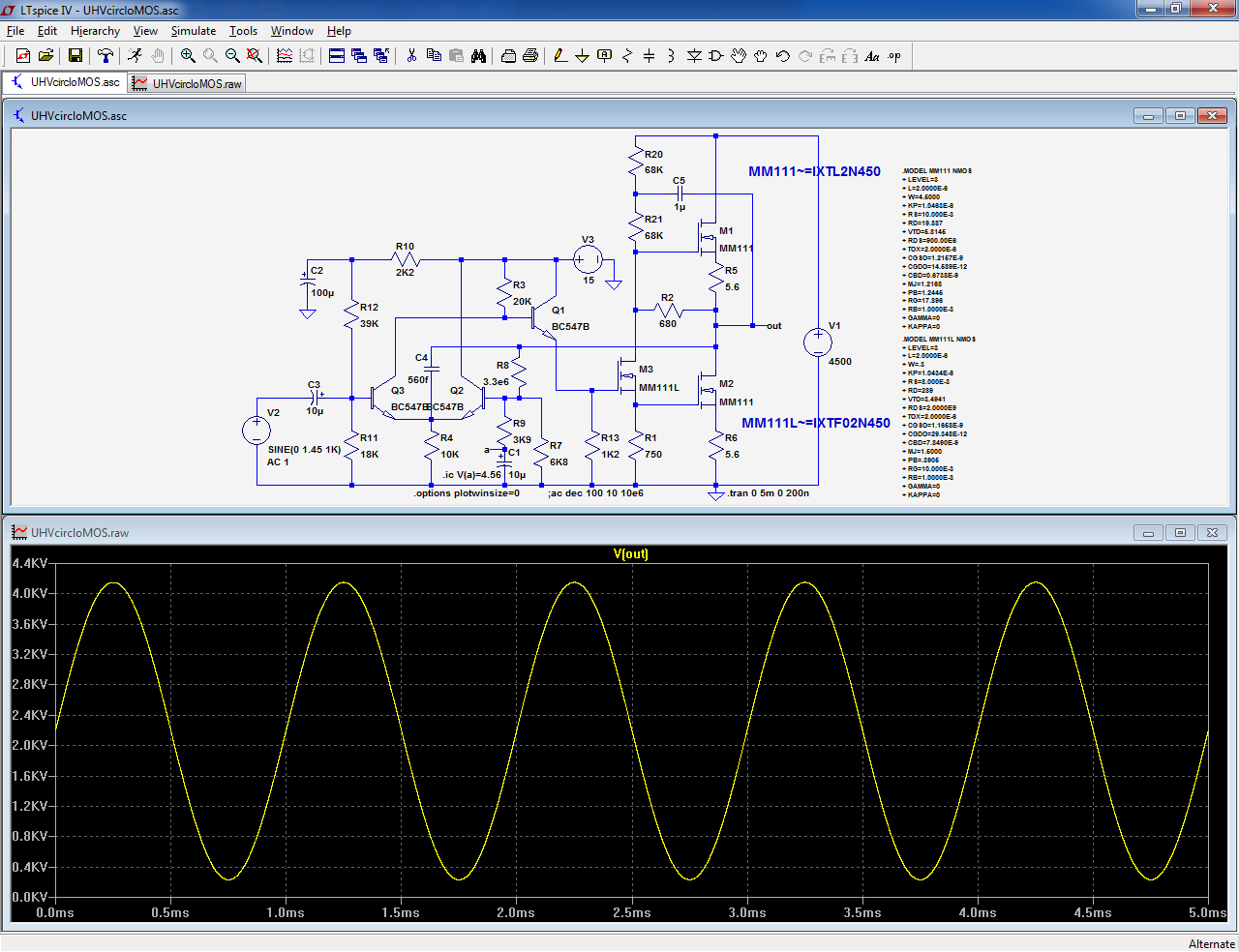

Here is a CircloMOS adapted for extreme voltages:
attachment.php
As the complete transistors models look awkward and somewhat incompatible with LTspice, I have used the internal MOS embedded inside the model.
This means no substrate diode, etc, but it gives a rough idea of what to expect.
The amplifier is capable of delivering 4kVpp, but only up to 10kHz, because the current necessary to charge and discharge the gates capacitance exceeds the driver's quiescent current beyond that.
attachment.php
Reaching full power at 20kHz would be possible, but the dissipation in the driver and bias resistors R20 R21 would become really significant.
A workaround would be a floating buffer for M1, but it would require its own, floating supply, which is not simple considering the voltages and frequencies involved.
Anyway, for real musical signals, a full power bandwidth of 10kHz is more than sufficient.
The small signal bandwidth is large enough:
attachment.php
  • UHVcircloMOS.asc
    UHVcircloMOS.asc
Single-ended is an option, of course, but a massive inductor is probably as unattractive as a step-up transformer, and probably even worse since DC bias has to be taken into account. The worst of all worlds...

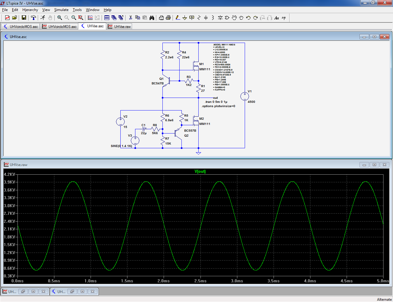

For the sake of simplicity, a semi version can be built, if minimalism needs to dominate over other considerations, like OP current capability, quiescent dissipation, etc:
attachment.php
This circuit looks pretty mundane, yet it includes one or two clever tricks...
Can you spot them?
The bottom part is ~ a half-diamond buffer, to isolate the input from the large MOS gate capacitance.
The interesting part is the top one: it is a CCS, but a floating one, because the main device needs to be of the N polarity.
This is achieved thanks to the divider R3 R4. This arrangement cancels the parasitic conductances of the circuit, but here, it goes further: it is overcompensated, meaning it can also compensate for the output resistance of the main MOS, and even for the load: unlike any other drain or plate load, this one actually contributes actively to the output signal, and provides gain and power of its own.
Here, because the load is not resistive but mainly capacitive, going too far in the correction serves no useful purpose, which is why the amount of negative resistance is limited, but it would be possible to use the same mechanism to compensate for a capacitive load, by including a capacitive network across R4.
In fact, this apparently single-ended circuit can work as an implicit push-pull, and it can do so for a variety of load angles, thanks to the weird properties of its drain load: it is an amplifier for which input and output are a single terminal
