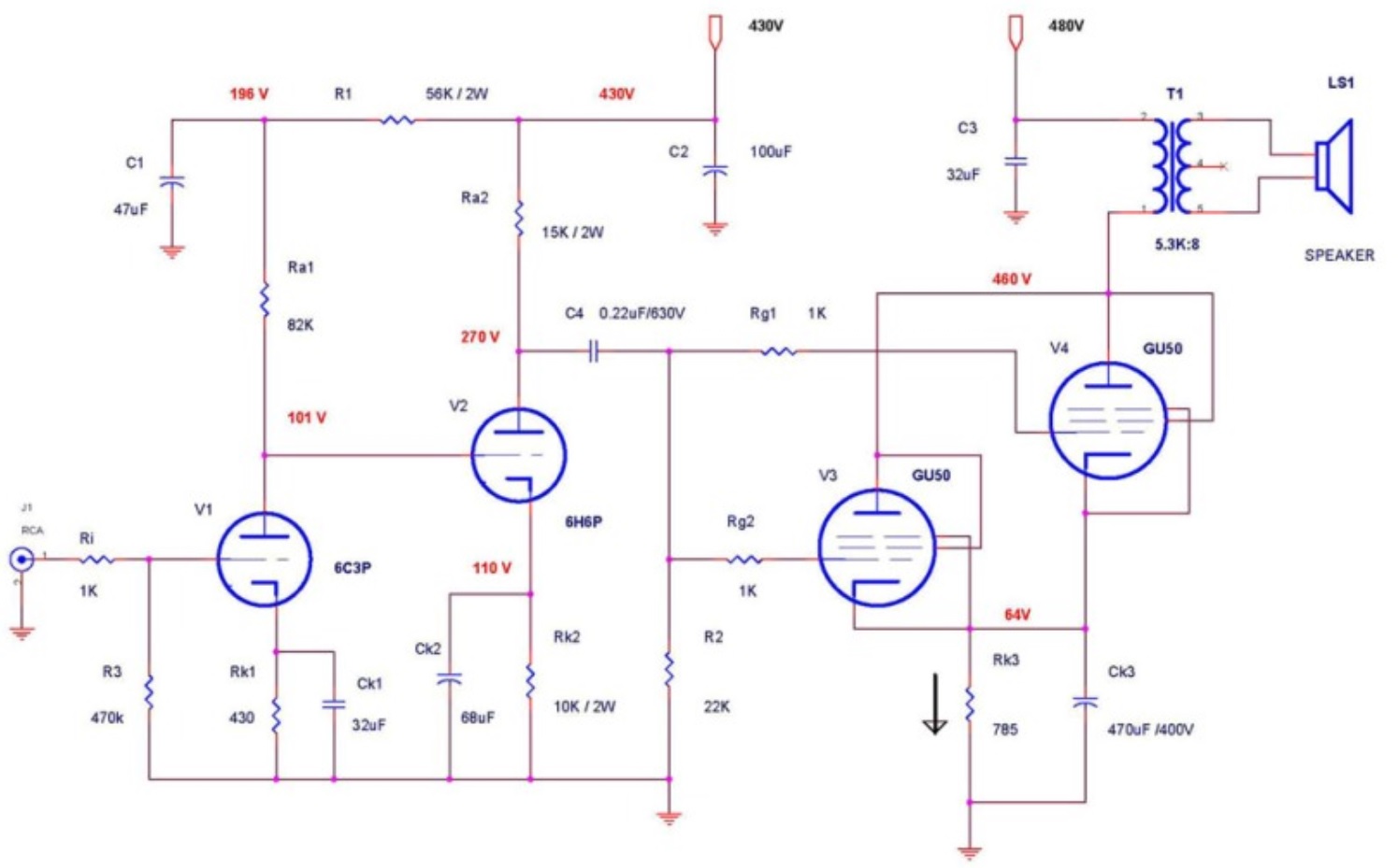

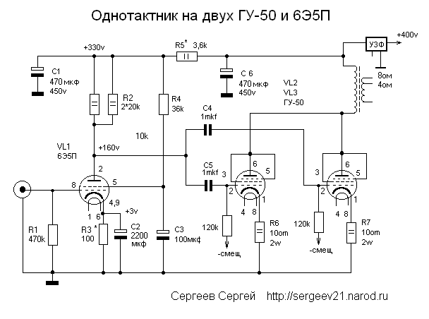

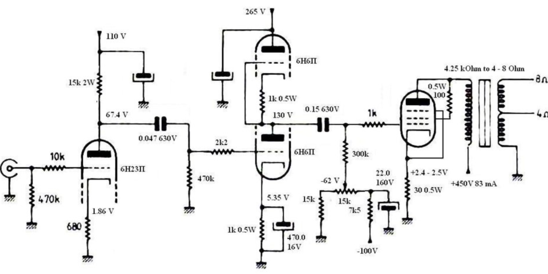

Thanks.Can you not use google, there are a view schematics.
I can't find GU50 PSE schematic.
i have no experience with gu50. But impedance 5k3 of the output transformer is a bit to high maybe 2k5 is better. i use fu13 and gu81 tubes.
In Post #2, I said: Search for a good and proven schematic of a single GU50 SE. Then I gave steps to make it a Parallel GU50 SE.
In some posts you have been given several Parallel GU50 SE schematics. Nice. However, the important words are: 'Good and Proven' schematic. But . . . Post #7 has 320V to 400V B+, 470 Ohm screen resistor, and both cathodes paralleled to 75 Ohms to ground. And there is no fixed bias either. I believe that with Only 75 Ohms self bias the tubes will cook and self destruct. We need to go back to 'Good and Proven' Schematics, I do not believe the one in post #7 qualifies. I do not really have the time to check out the others that have been posted.

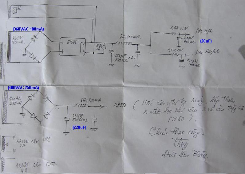

Thanks. I can do it myself, but can't analyze the schematic.TDHien59,
Have you ever built a tube amp from scratch? I do not mean build a kit.

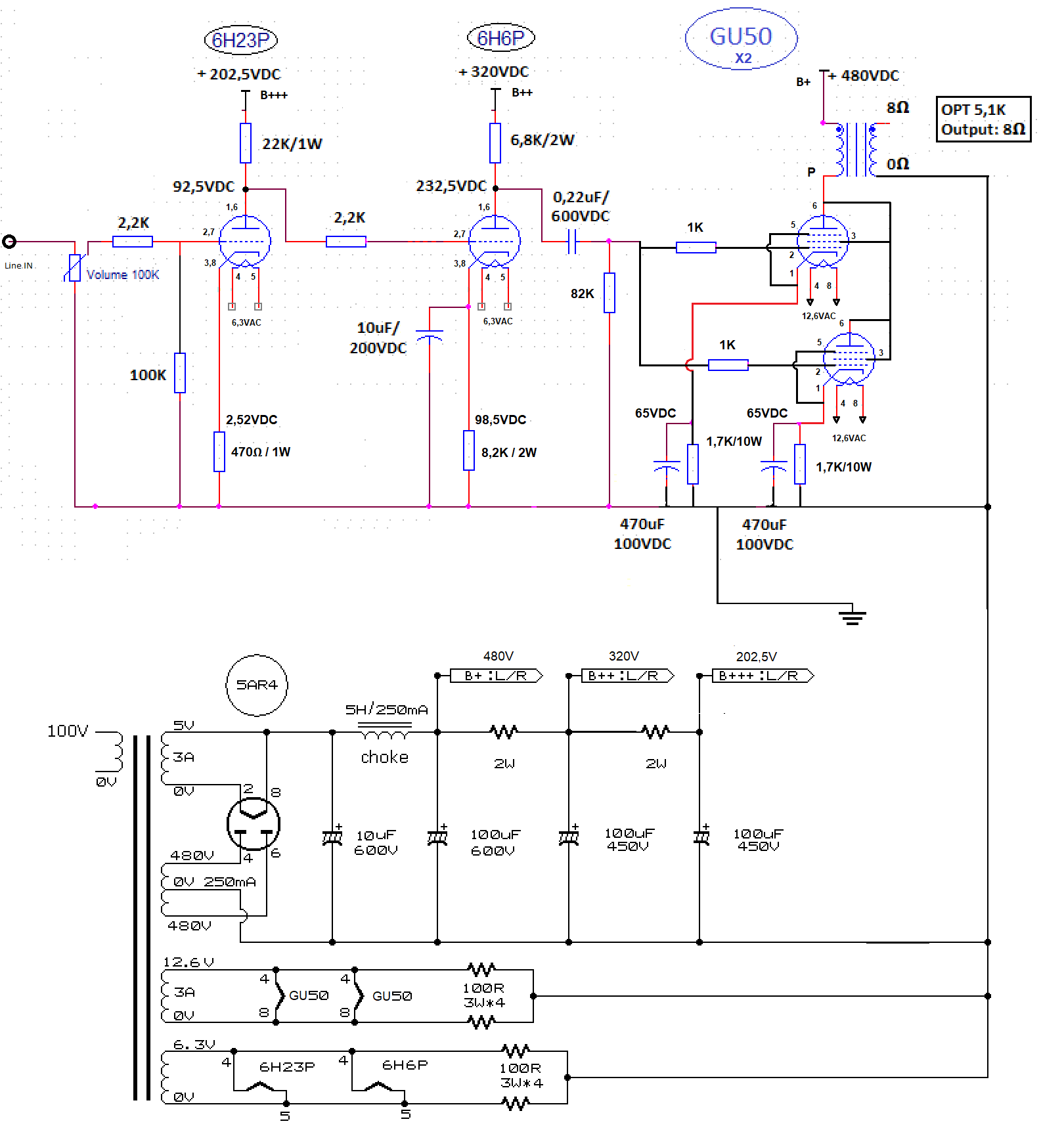

My amp is building, it is monoblock:
May be 10W or more. SE is not enough for me unless 845, 211... I have made EL34 SE but the power not suitable for my speaker.The GU50 is notoriousfor having arather large spread in characteristics. One tube will run hotter then the other using this schematic. I suggest looking at the biasing, perhaps going for a mix of cathode resistor AND adjustable negative grid voltage

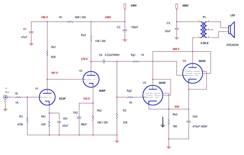

TDHien59,

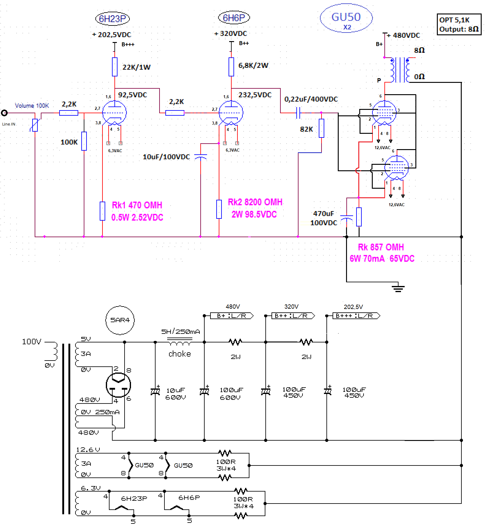

I found a few things I would change about the schematics in your Post #12. There may be some more changes that I missed to make the amp work reliably.
Schematics of Post # 12.
First Schematic:
The 6H6pi has 130V on the upper SRPP cathode. But it has to swing 62V more positive to get the GU50 grid to 0V (max power out). That puts the upper cathode at 192V peak. I could not find the spec for the maximum cathode to filament voltage. And the 6H6pi has 5V on the lower cathode. You will have to elevate the filament on the 6H6pi so that both the upper and lower cathode voltages do not exceed the maximum cathode to filament voltage spec for the upper and lower sections of the tube. This is one reason I do not like SRPP circuits. You may have to connect the coupling caps to the upper cathode, because of the input capacitance of 2 triode wired GU50s.
You will need a second coupling cap, and need to duplicate the complete bias circuit (have to have one bias circuit for each GU50). Then you need a second 30 Ohm cathode sense resistor for the other GU50. You need to change the output transformer to 2.125k Ohms (can use 2k). It needs to be 2 times the watts rating, and 2 times the current rating of the original 4.25k transformer. The only direct connections from one GU50 to the other is the plates, and the filaments. You need 83mA more current in the B+ power supply, to power the GU60. And you need more current for the 2nd GU50 filament.
Second Schematic:
Rk2 8200 Ohm is bypassed by a 10uF 100V cap. But the cathode is at 98.5V. Use a 10uF 200V cap. You may have to elevate the 6H6P filament voltage. I do not know what the cathode to filament max voltage spec is. Each GU50 needs its own grid stopper resistor. Use two 1k resistors. Connect each one right at the GU50 tube socket, then back to the 82k and 0.22uf cap. Each GU50 needs a 2x 857 Ohm resistor = 1714 Ohm cathode resistor Use a separate 1700 Ohm resistor and separate 470uF cap for each cathode (do not connect the cathodes together). This helps the current balance of the two GU50 tubes.
I recommend using two 100 Ohm resistors, one on each screen, the other ends connect to the plate. The GU50 and 6H6P takes some time to warm up. The 480V will be more than that at power-up, and so the 320V B+ may raise to more than 400V. So change the 0.22uF to a 600V rating.

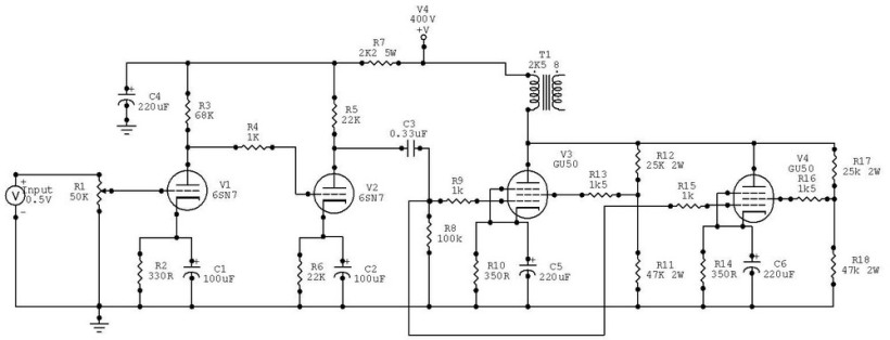

I follow your idea to draw the schematic second again:TDHien59,
I found a few things I would change about the schematics in your Post #12. There may be some more changes that I missed to make the amp work reliably. <snip>
