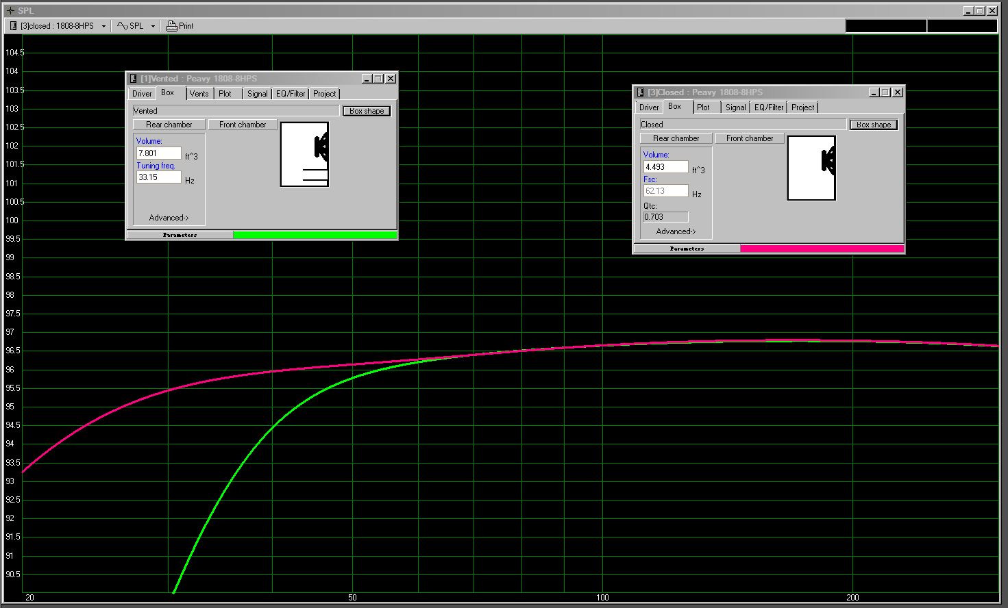

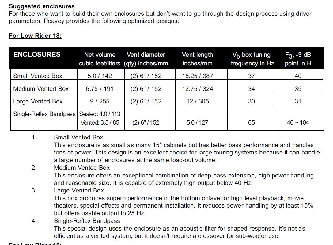

The first table of box designs is from the Peavy Low Rider 18 documentation.
The second SPL plot is from WinISD of a 0.707 ported cabinet, and a sealed cabinet that has an active Linkwitz equalization circuit set to 20Hz with Qts=0.7.
Sealed woofers with digital room equalization are becoming more popular for homes(small room relative to bass wavelengths), and clubs or recording studios where a flat response is important.

wow that sealed box is very impressive.

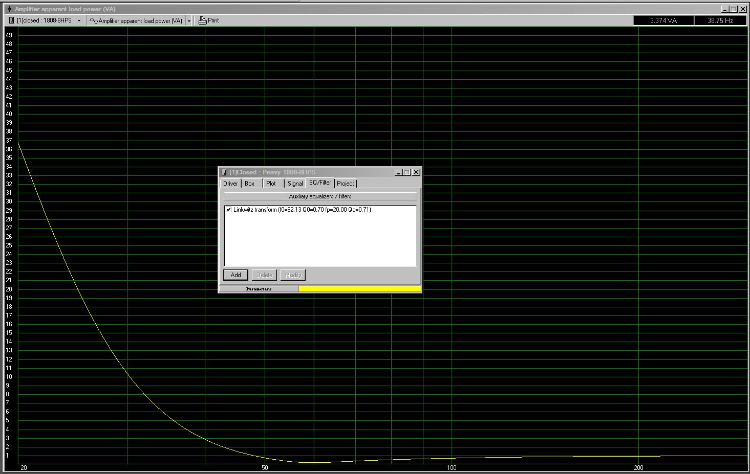

is that at 1 watt?
As the sealed box + Linkwitz Transform simulation illustrates, it takes 1-watt to produce 96db SPL at 50Hz, it takes 10-watts to produce 96db SPL at 30Hz.
A Linkwitz Transform equalization circuit uses large amounts of amplifier power to extend low frequencty bass when the speaker is in a modest volume sealed cabinet. A sealed box has the potential to produce better controlled bass with lower group delay and lower phase variation when compared to ported(bass reflex) cabinet, but it is less efficient. A ported box is more efficient and will deliver higher SPLs at equivalent power.
Sealed bass boxes are becoming popular for home audio for their "tigher" bass, and greater simplicity for digital equalization to cover: personal hearing needs, room eqalization, loudness boost (ISO226 FletcherMunson), complex Xovers.

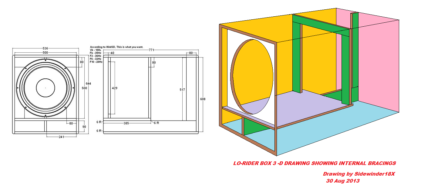

I had build quite a few boxes in the past for Peavey 18" Low Rider. (Kindly open attached folder to view plan). It performed very well. I had even compared it with original QW118. The results were quite similar.
I had even tried the dual 18 design, QW218. All I can say It was the best sounding Peavey lows that I had ever heard. I mean both the designs, single & dual.

With reference to the attached box dimension for the Peaver 18" low-rider in my previous post #12.
I had drawn a 3-d drawing of the box here again which might be of some help understanding the internal bracings and the port area.

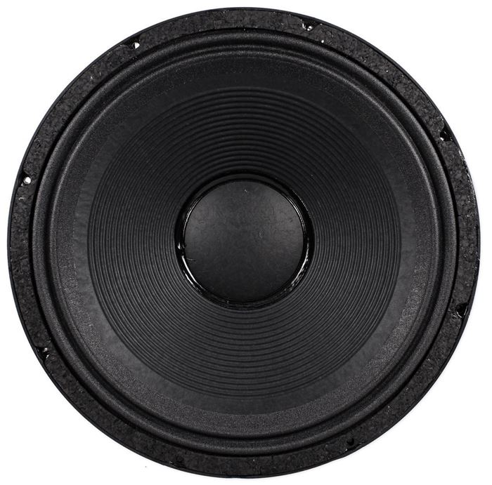

i will purchase 2ea Peavey 18" Low Rider.
Before you purchase the Low-Rider's, I would like to inform you that there are three generations of Low-Rider 18 produced by Peavey. All of these were marked with the same model no. (1808-8 HPS). All differ on the cones fitted with.
The earlier one had a Progressive m-roll surround / light weight composite fiber-glass smooth cone (American cone).
And the second one had a progressive two roll asymmetrical surround / heavy weight composite kevlar ribbed cone ( European UKM cone) . You can identify this one stamped UKM along with the cone no. at the rear of the cone.
Present generation Low-Rider 18 has a similar kevlar-ribbed / medium weight American cone like the UKM one. Both these ribbed cone sounds and performs better than the earlier smooth one.
As for my opinion the second one, the one with the European kurt-muller (UKM) cone is the best of all.
You can see both of these in the attached pics.

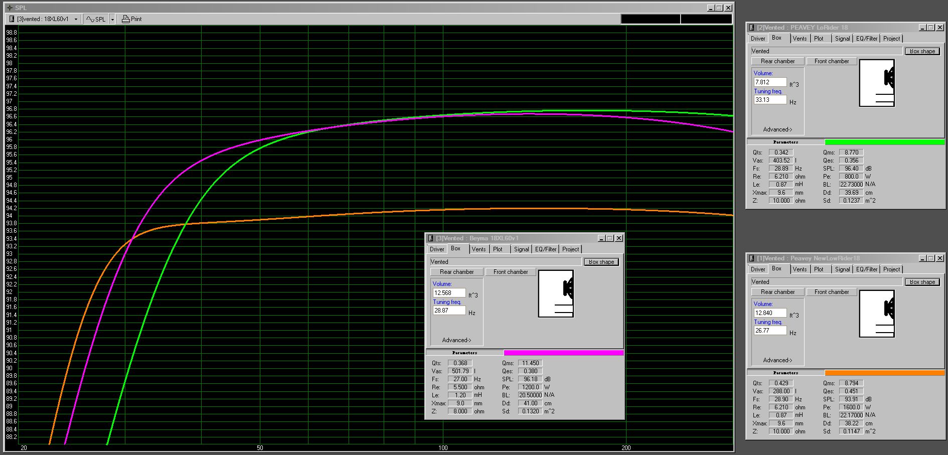

WinISD plots with T/S data:
GREEN: Early Peavey LowRider-18 with 163 gram Mms smooth cone. Note 7.8 ft^3 box.
ORANGE: Latest Peavey LowRider-18 with 198 gram Mms ribbed cone. Note 12.8 ft^3 box.
PURPLE: Beyma 18LX60v1 for comparison. Note 12.6 ft^3 box.
Typical comparison of box volume vs. bass F3 vs. SPL efficiency
