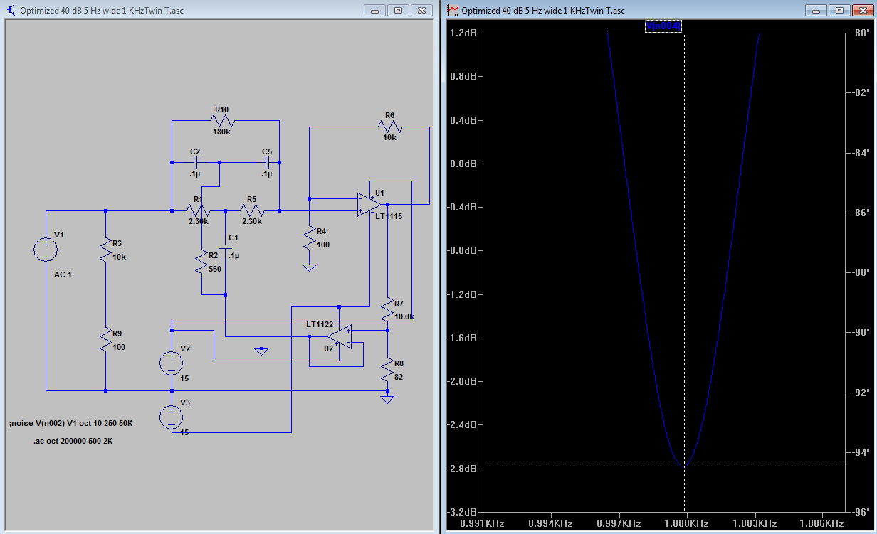

Here is an update on my progress with Jens notch filter.
Phase one was matching the filter requirements to the parts I have on hand. After working with the B&K I decided I needed to lower the impedance of the filter to get lower noise. In my collection of parts is an assortment of Tektronix caps. These are spares for some scope plugin. I have a handful of them. They seem to be hermetic polystyrene 1% caps. They all measure withing .5% of the marked value (after 30? years). I have .1uF X 3 so I started there. Then I used this tool: Twin-T Notch Filter Design Tool to calculate the resistor values. Its limited to standard values so I started there and put the whole circuit into LT Spice (asc file attached).
I tweaked it to get the following properties:
1) 40 dB attenuation at the center frequency (1KHz)
2) As wide a “flat” band at the center frequency as I can get, about .5% or 5 Hz at 1 KHz with about +/- 3 dB in the band
3) 40 dB gain at the harmonics, the net effect is boosting the harmonics by about 40 dB and still having the fundamental. This allows using a conventional audio analyzer with a 100 dB floor for distortion to have a -140 dB distortion floor (on paper).

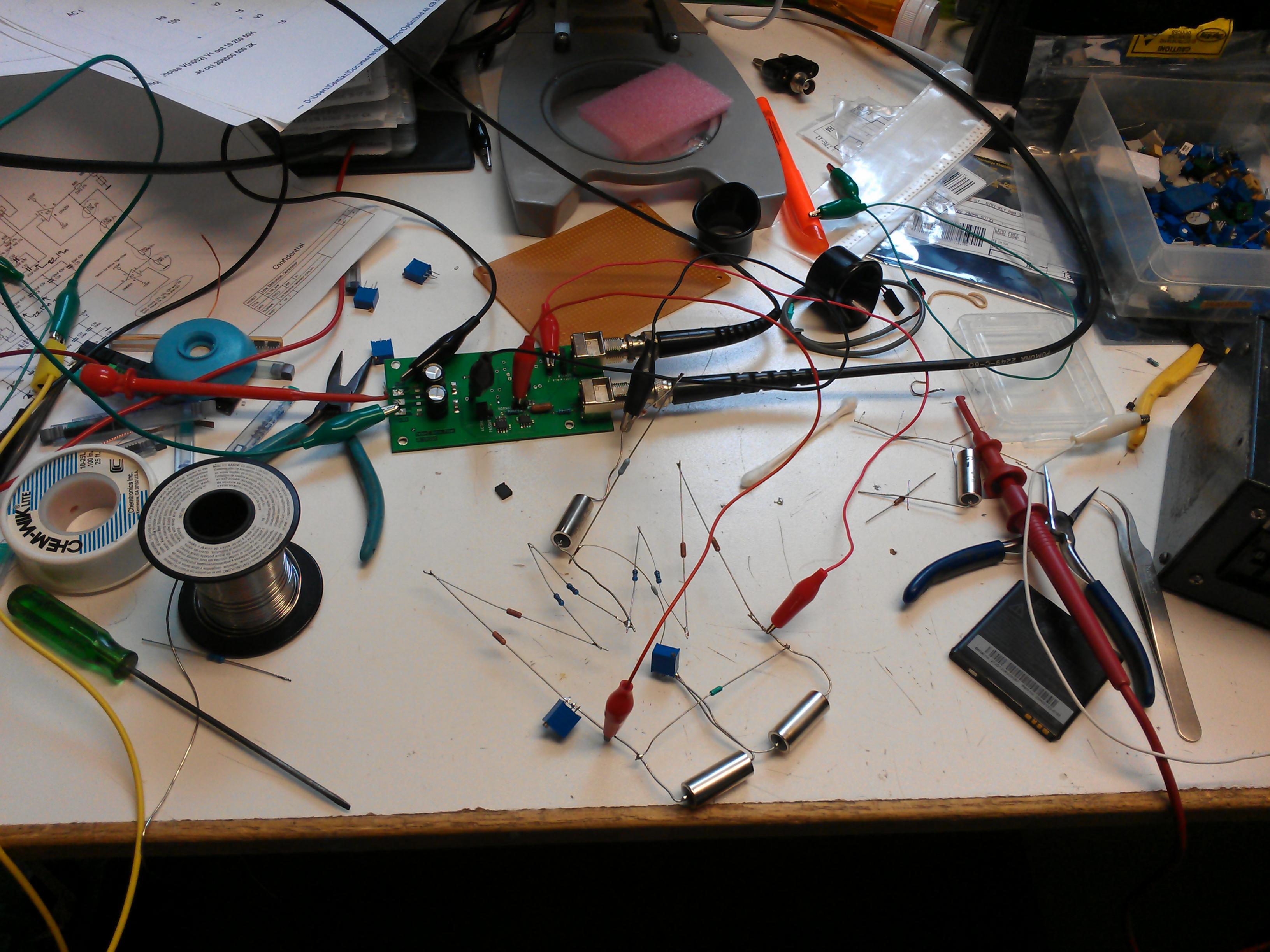

Assembling the board SMT parts is not easy for me at this stage, even with the microscope and tweezers I find these parts frustrating, Especially after the bigger parts are installed. In any case I got the active parts assembled on the PCB. I used an LME49990 for the main amp for its low noise and an LME49710 for the Q multiplier since I had it.
Other experiment- can I run this on battery power with no center tap? The answer is yes. I used 2 10K resistors, one from each rail to ground. The applied power from rail to rail and its all behaving quite well. There should be no DC at the output. The output can be AC coupled with no down side in fact.
I then made up the tuning network with all the parts exactly to value (you can see the strings of resistors with trimmers to get them on value in the attached photo) and tested the network. It all works as planned. Its really sensitive to external noise so it will need to be built on a tight layout on perfboard and all in a can to be useful. But the important part is that it all works. I verified the distortion measurement using a function generator I have. It has about .3 % THD. Through the filter it measures 30% or 40 dB higher.
With some focus this week I should be able to measure DavidA's oscillator by the end of the week down close to its noise floor. It already outperforms the Shibasoku 725 so I'll be using the 725 with this notch to get deeper into the floor.

You can probably get a lower noise level by using the LME49710 for the main amp and the LME49990 for the Q amplifier. In my simulation (in Tina TI) I get a noise over a 20.5 kHz BW, which is 1.25 dB lower. If you use the original OPA209 for U1 it is even lower, with a reduction of 1.75 dB. You may not need a lower noise floor, but it should be possible to do.
A passive version, with just the 40 dB gain (OPA209), of course has a much lower noise, but it is more difficult to work with, since the level of the harmonics need to be corrected in this case.
You may not need a perfboard. Perhaps you can mount some of the large capacitors on the back side of the PCB?
I agree that the circuit is sensitive to external noise. But there seems to be room for improvement in your test set-up 😉
Andrew- EssB
Its actually a balancing act between R10 and the ratio of R7 and R8. I tried a lot of small tweaks each way to get it where it is. Changing R10 affects R1, R2 and R5 altering the tuning a little so its back and forth to get it working. All the parts need to be very precise to get it to work. I'm sure there are other solutions that will work as well.
Jens
I'll try the OPA209 as soon as some samples get here. The odd part is that the OPA 209 has about 6 dB higher noise at 2.2 nV/rtHz and simulates with lower noise. It must be the current noise that is dominating. The OPA209 has about 1/4 the current noise.
I rescaled the network using 1 uF caps dropping the resistors and that lowered the noise some. Using the lower noise opamp for the q multiplier made a bigger difference. I think I understand but it was not obvious at first. The 1 uF caps I have are really large (the three would be the same footprint as the whole PCB) so I'll continue with the external network for now. It will also make swapping networks for different frequencies etc. easier.
Yes, the nice thing about the OPA209 is the relatively low current noise. With an impedance of a few kohm this gives a lower noise than many "super low noise" op-amps.
If you take the voltage noise and divide it by the current noise you will get a pretty good idea of where the optimum noise performance of an op-amp will be.

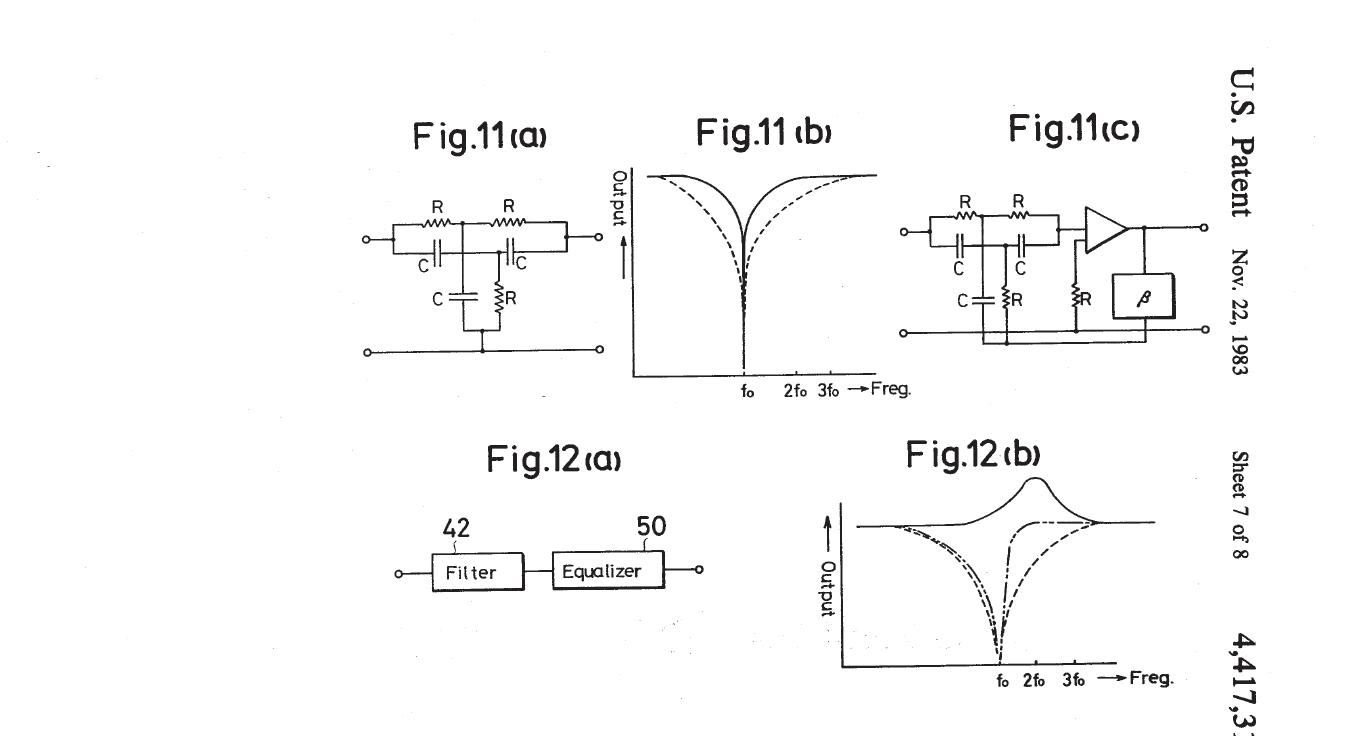

Here is an alternative to using positive feedback with a TT notch.
This is from the Shibasoku patent. Instead of using positive FB a post equalizer is used to multiply the Q. This can be done with passive circuitry avoiding the noise associated with PFB. It adds to the tuning complexity but the trade off of noise might be worth it.
See 12a and 12b
