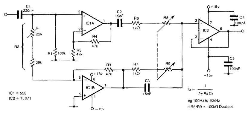

You can find schematics for the Twin T here at Dick Moore's web pages.
Active Twin-T notch filter

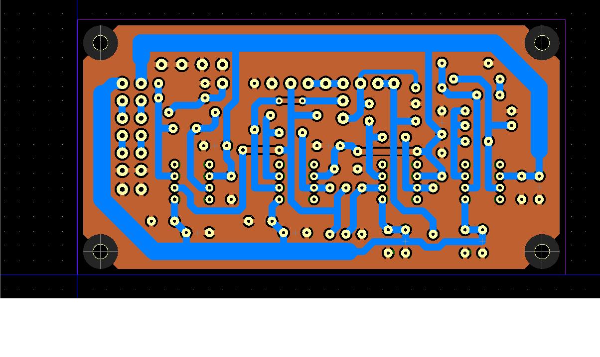

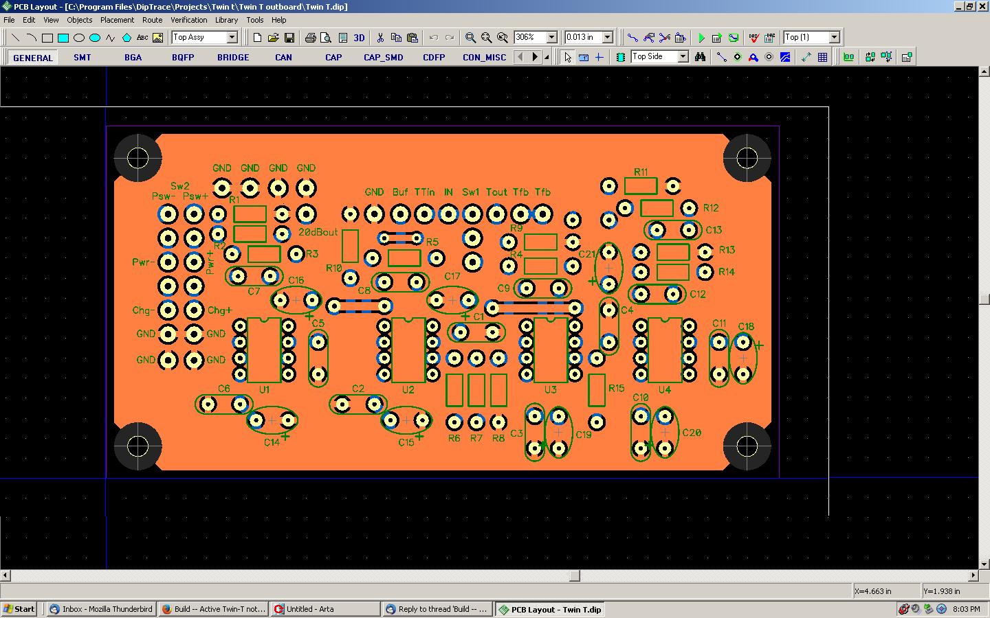

The boards don't have any of the tuning elements on them just the amplifiers. Both are DIP and through hole parts.
tantalum were used for bypassing but I had a lot of trouble with them shorting. I can change footprint to elec.
There's extra op amps for gain boost or other general use. If thet're not needed leave them off.
Hi David, I was aware and have been through that article, but thanks anyway.
The schematic from Dick is not one that can be used without some detailed parts and layout knowledge that I don't have. That was the missing link I was after. You now shared the layouts in a later post but without the matching schematic it's still a bit of a puzzle. They look very professional to me though! I'm not a layout wiz, let alone one for these highly sensitive designs. I'll give it a try on a prototype pcb board first, just to get it all working, then we'll see what needs to be done.

The layout isn't that fussy. A PCB is more a convenience. Dick did his on perfboard (Veroboard) and it works fine. I didn't see any improvement going to a PCB. It just looks nice.
I have just finished building the twin notch filter from the schematic posted by Dick. At first it didn't work at all but then I suspected that a possible missing joint of two connections (right after the input) in the schematic might be the culprit. After a quick question to Dick he confirmed that it was the case and his schematic was updated.
