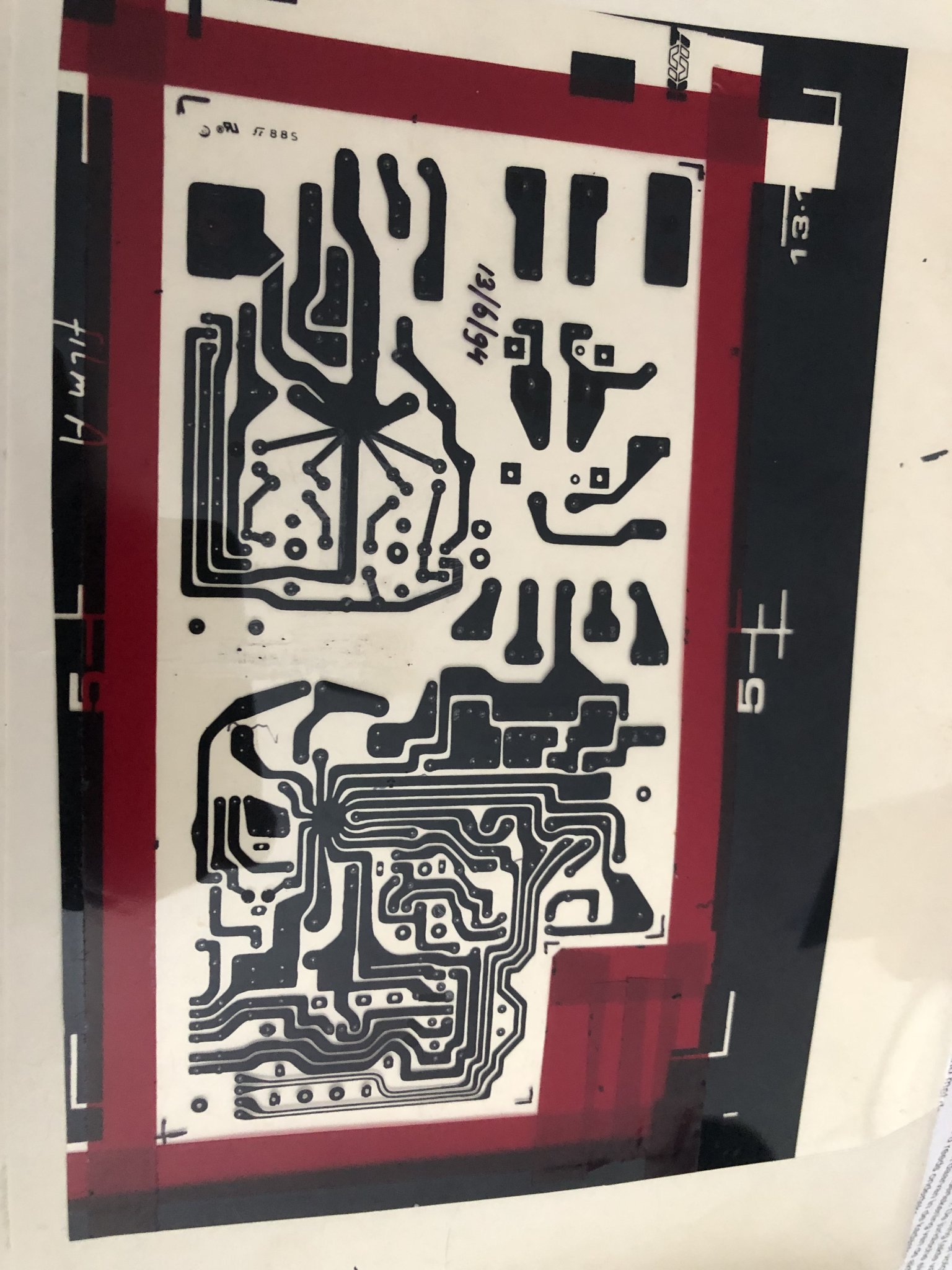

Look what I just found. As the power supply was inadequate and everything was connected to one regulator I separated sections in 2 x 15V and 1 x -15V with regulator ICs and normal decoupling which it totally lacked.
I recall the display having or causing issues that were solved with this board.
I only just check back on this thread... What is that pcb shown in the photo?
Are you referring to the AT93's power supply? What sort of display issues did you experience?
It is long ago but the power supply was mediocre. It fed too many sections so I split it up with a few regulators one for each section. I photographed the emptied original PCB and edited it to my likings. It was successful. Akai had a silly habit that time by not using any decoupling of supply lines.
I think the display flickered with the original PSU.

It is long ago but the power supply was mediocre. It fed too many sections so I split it up with a few regulators. I photographed the emptied original PCB and edited it to my likings. It was successful.

After it was very good but I liked Yamaha T80 better (I think). Its original PSU was maybe not even mediocre but plain bad. Totally out of line when looking at the tuner itself. AFAIK it had only one non decoupled Zener/pass transistor combo to feed the complete tuner. I made that film, edited it old school method and added a few 7815/7915 (forgot the purpose of the 7915 but possibly only a Zener diode was used to create -15V) with necessary heatsinks and decoupling caps and modded several AT-93. It was 1994 so 31 years ago 😊
The transformer needed a heatsink! This was a factory mod.
